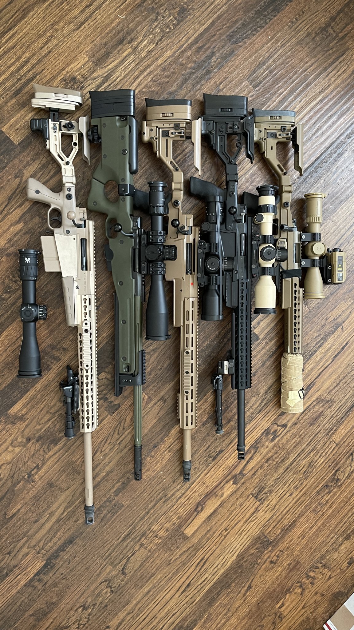

Please tell me they’re bolt guns … would love to see a photo if they are.
Not light weight but they do hunt.

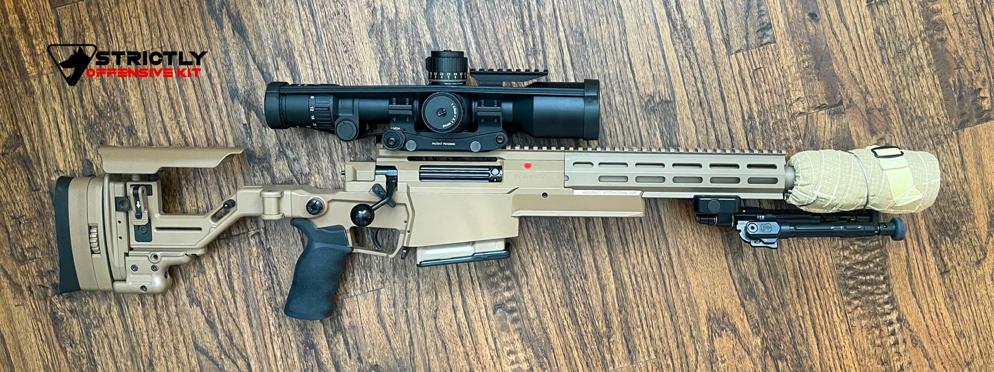

Here’s the 6.5CM in all of 12”.
11” 308 Win far right.

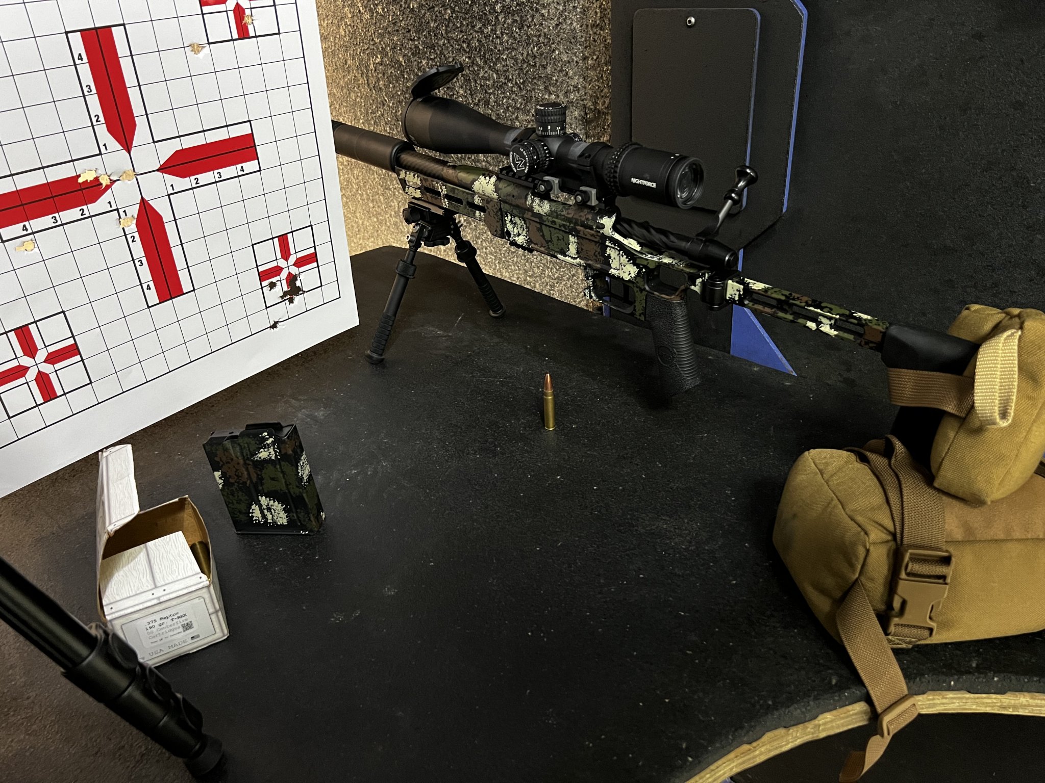

I have run my Sig Cross 6.5CM, 18" barrel, through a chrono and it gives the following on Strelok Pro when zeroed at 175y using Winchester Deer 125g. That round is very accurate and matches Strelok Pro out to 350y which is as far as I have had chance to test it so far.
At 300y - 2201 fps, 1345 ft/lbs & a drop of 9.5". At 600y - 1787 fps, 887 ft/lbs & a drop of 82".
Not suggesting it is the answer to what he is looking for but at least he now has something to compare the rest to.

@SkyScrapin - whats the details on that rifle/action?
Fact!
It's a Surgeon 591r Form1 rifle with Carbon Bartlein 11" 308winchester. Found a sweet load with 155hybrids and haven't looked back. Nice and handy, annnnd heavy.
