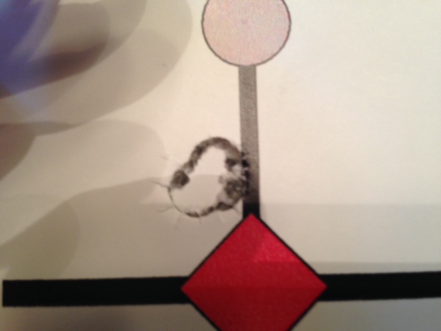

I've been using the load below with my .308...24" Heavy Barrel...1/10 Twist...and getting .5 MOA to Sub .5 MOA Groups...all 3 rounds touching at 100 yards. I hit a 4" steel plate at 1000 yards using this load.
IMR 4064 - 42.8gr
Once Shot, Fire-Formed, but Re-Neck Sized Brass, OAL - 2.010 (Remington Premier Gold Match Brass)
CCI Large Rifle Primers #200
Berger Long Range Target BT 175gr BC: G1 - .515, G7 - .264
COAL - 2.840
Muzzle Velocity - Avg. 2,675 fps

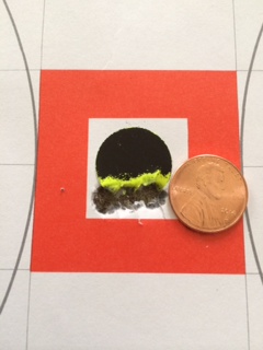

42.2 grains with a 178 Amax or 175 SMK gives me .5" accuracy and 2650fps on average.
42.9 grains with a 168 Amax gives me .5" accuracy and 2710fps on average.
This is out of a 24" 5R Savage barrel with a short throat so I am seating the bullets pretty deep, about 2.773" - 2.805", depending on the bullet.
