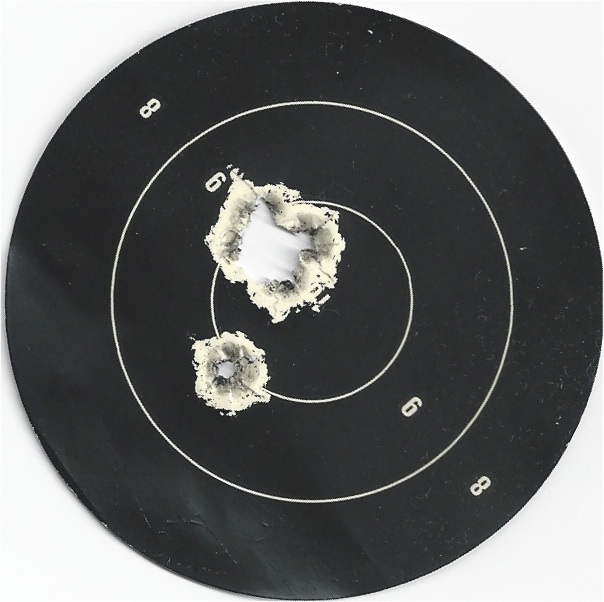

100 yds, 5 shots 2500 fps 175 SMK

Remington 700 AAC-SD 20" pillar bedded with Devcon in a McMillan A5, with SAS TOMB-mount Reaper suppressor.
Berger 168 Classic Hunter hybrids @ 2.210" base-ogive, 2.820" COAL
New Lapua brass
CCI 200 primer
42.4 grains IMR 8208 XBR
2600 FPS 12' from muzzle, ES 15/ SD 6
Never thought a factory barrel could shoot this well without even fireformed brass. Load developed using OCW method, never messed with seating depth.
5 shots at 100 yards below. Disregard the 3 stragglers, they were my attempt at shooting my 6.5x55 standing freehand.
