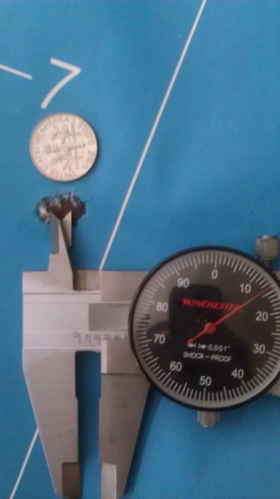

The pic below was taken 2 weeks ago out at my local range under the most "controlled" conditions I could manage. This includes shooting 5 shots with 210M's over the chrono (Magnetospeed) and then shooting a 5 shot (left target) group with the chrono removed. Then I reattached the chrono and shot a 5 shot group over the chrono using the Tula's, then removed the chrono and shot the 5 shot group on the right.
I should note that I shot 10 shots on the top target you cannot see in this pic to confirm zero, let the rifle cool for 15 minutes, then commenced the test with a 10 minute break between "tests". The idea behind that method, was to have comparable barrel temps for each of the 2 "tests".
I have a weather meter, and the conditions were extremely stable during this test. It was just before noon, so the temp had pretty much stabilized and was 76.4* F as indicated on the image. The entire "test" was completed in under 30 minutes, so I think that is about as good as it gets.
As indicated in the image, the group on the left with the Federal 210M primers shows POI roughly 1/2" high and slightly left of POA. The target on the right using the Tula primers was damn near perfect for me, and represents about as good as I am capable of shooting on any given day at 100 yards with a 308.
Needless to say, the Tula primers I have are performers, particularly with my powder lot, brass and bullets.

Nice to see the "numbers" and group for the Tula primers. I was able to pick up 5k of them before they started making them out of "unobtanium" and am almost out of Fed's. Too lazy to rework my loads yet for the Tula's :)
