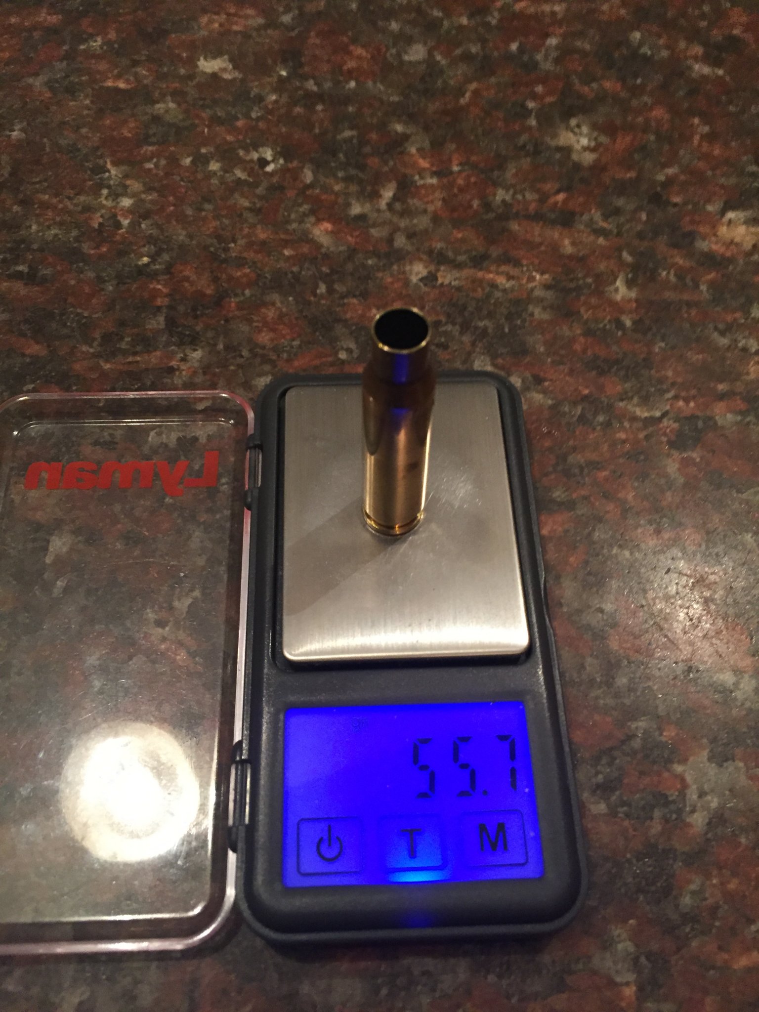

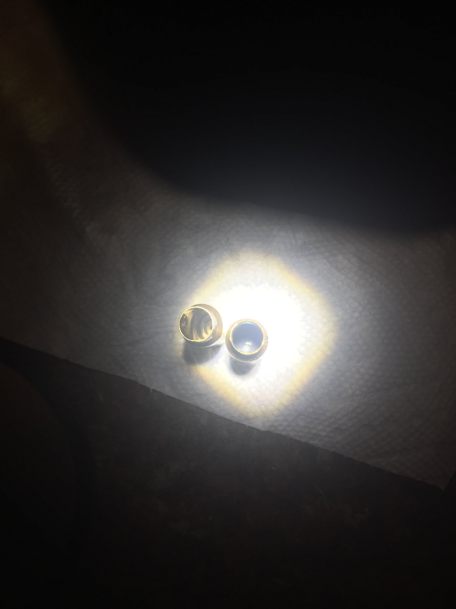

Guess who made Black hill match brass ……..Winchester!
It’s hard to see, have not cleaned the black hills but the Winchester is the piece on the left and Black Hills is a piece on the right. Winchester has a recess on the inside around the flash hole and the Black Hills is completely flat. Visually there is some difference.
They weigh about the same. 157 grains.

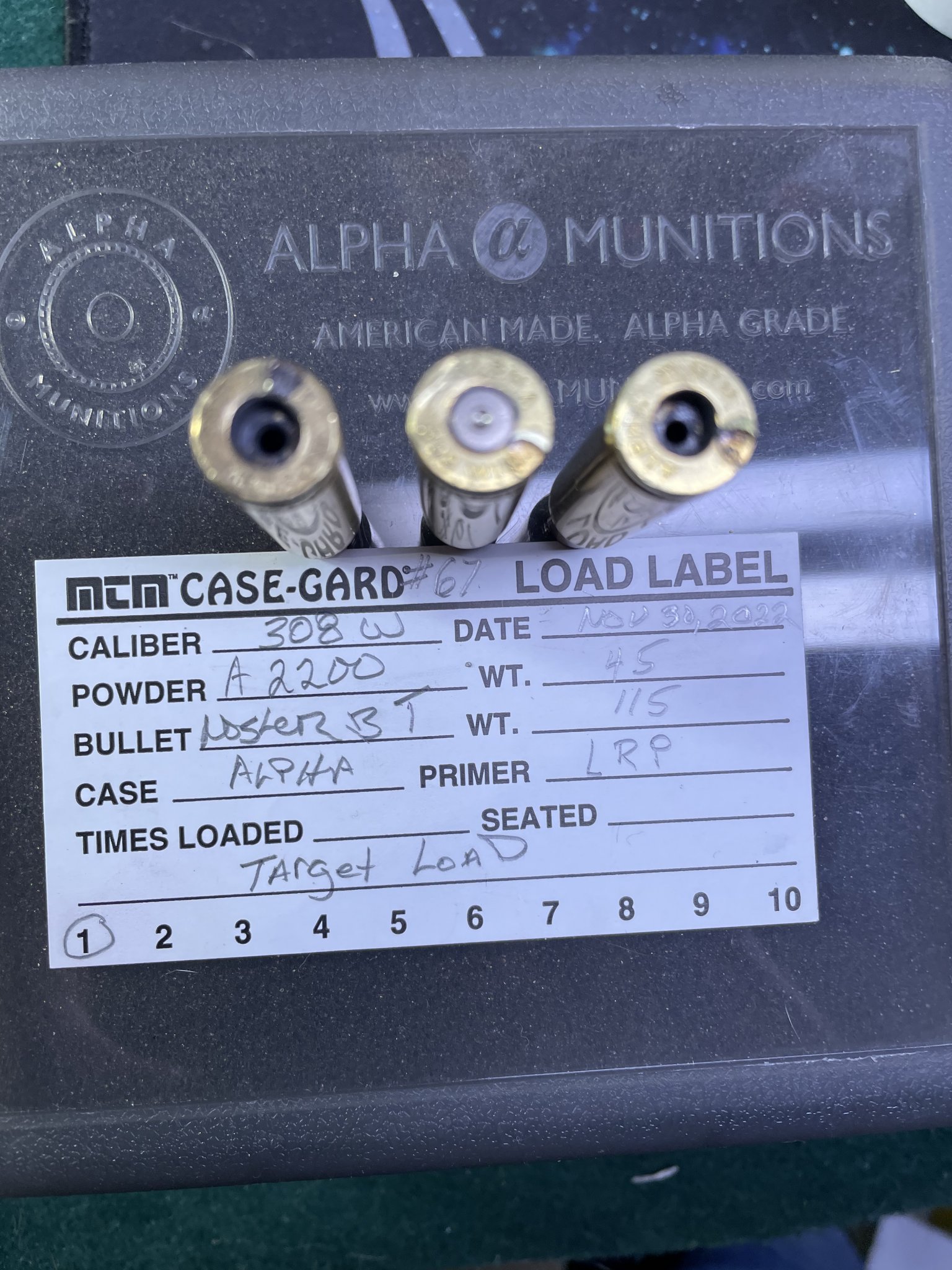

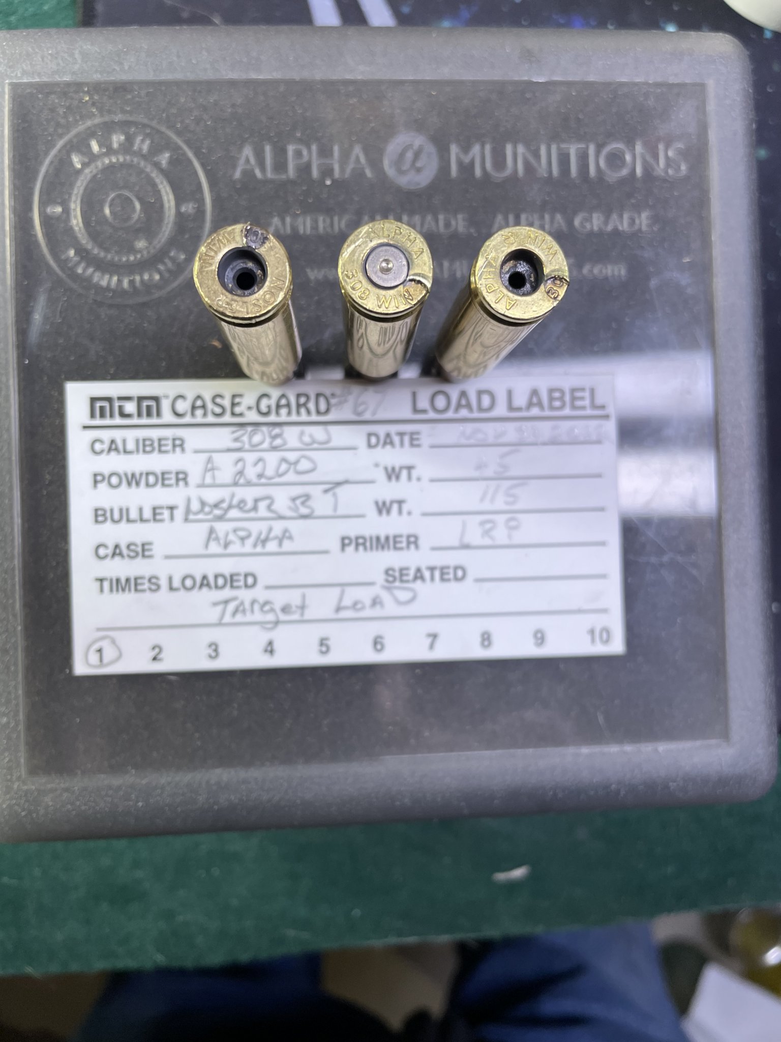

Okay all you reloading whizz bangs I gotta problem with a .308 load!
Here’s my data I used, right from Lee’s Modern Reloading 2nd edition page 532 115 Grain jacketed bullet;
115 gr Nosler bullet BT
45 grains of Accu-2200
CCI LRP
COL= 2.700
Brass-Winchester Alpha NEW!
Shooting gun-.308 semi automatic Smith/Wesson model M&P-10
Loaded with lee Classic turret press , .308 dies, crimped
At range-blew out the primers, fired only 3, jammed rifle due to blasted out primer!! Cleared everything, bought a box of 7.62x51 147 grain Winchester ammo, loaded-up a Mag, gun shot fine, but not to sure about the shooter!!! What the hell went sideways!! Looking for a answer!

Your brass is showing signs of over pressure. I see Hogdon's sight shows 47.7 grains as max load in a bolt gun 61K psi pressure. I didnt see a load for service rifle there using a 115 grain bullet so I can't comment on your 45 grain load. It does look to me that you have a very heavy crimp on your loads which would contribute to driving pressures up. 43 grains is showing 55K psi pressure which would probably be max for your AR10. If it was me, I'd start at 41 grains and work my way up to 43 while easing up on the crimp a bit.
Yes, I was looking at the crimp too! And yes, 41 grains with a light crimp looks good.

The brass definitely looks like you're way over pressure. The first thing that come to my mind is, did you measure case volumes for that brass? I ask because I've heard that the Alpha brass tends to have walls that are somewhat thick, which reduces the case volume. And with the amount of powder charge you're using, that could really boost the pressure up. In addition, the crimping could add to it depending on how much crimp you're using. With a fast burning powder like Accu 2200 at 45 grs, it just looks to me like too much powder charge.
2200 is one of Accurate's faster powders for .308 Win. It's fine for what you're doing but it can get away from you if you try to push it.
Accurate also tests their .308 loads with Winchester brass, which is about as "roomy" as you can get with case capacity. I'm betting your Alpha brass has less capacity. It has a reputation as being good tough brass... The trade off is that you give up a bit of case capacity.
Toss a fast powder in a tight case, crimp the daylights out of it, and throw it in a gas gun... You can run in to trouble doing that. I know from experience.
Back off to the minimum and start again. Lighten up a hair on the crimp. And look carefully for pressure signs as you move up in charge weights.
Just out of curiosity, which primers did you use... CCI 200?
Your correct, I thought about that too, Looked, and Nosler doesn’t make a 115 grain BT, but they DO make a 150 grain BT, and when I pulled the bullets on a few, weighed them, BINGO!!, 150 grain!!!
Starting load is 37.1 grains of Accur 2200, Max is 41.2 grains for a 150 grain jacketed bullet. I had 45 grains of 2200 in the case with too much crimp. Pulling all, redoing..
Thanks 🙏🏻

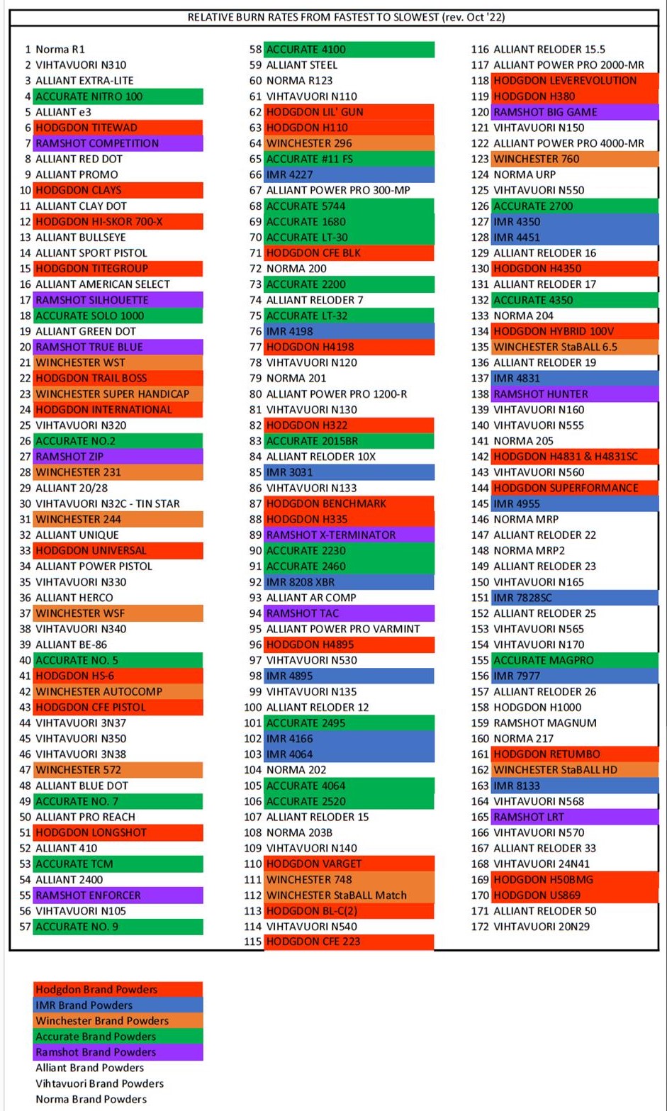

Thanks 🙏🏻

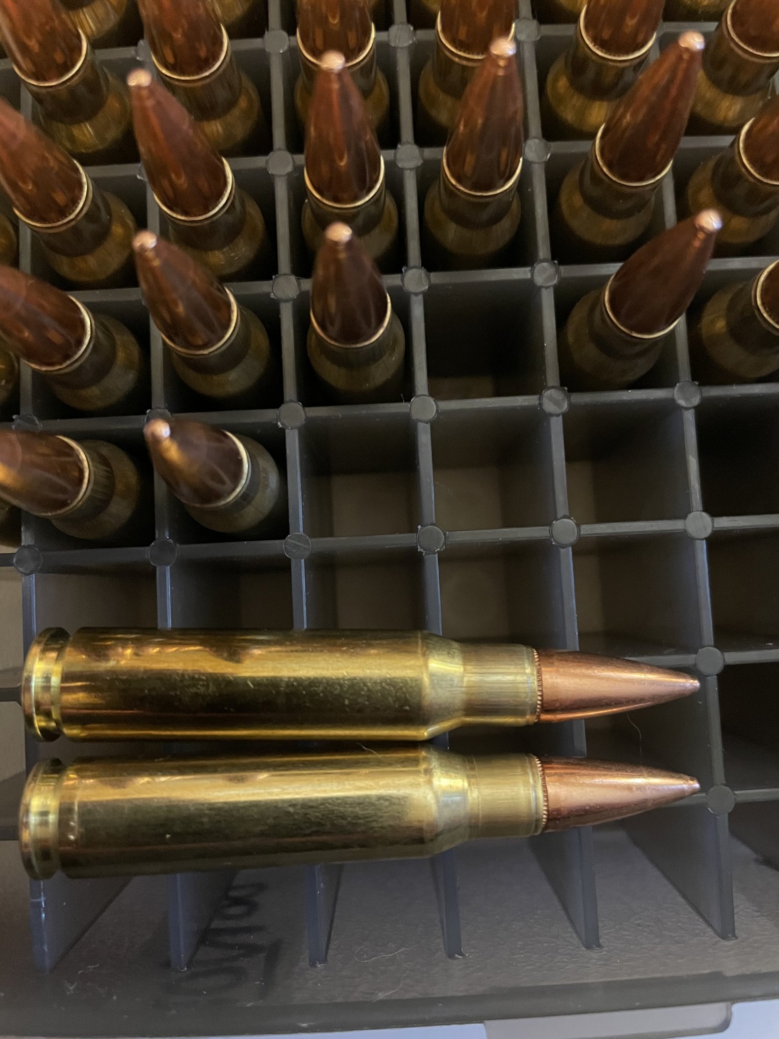

I just loaded 200gr eld x’ s into a savage 110. See the previous page. My cartridge that is 2.24” base to ogive is 2.897” in total cartridge length. I am trying to figure out, as are others, what your 2.76 represents. I would love to help you, but just need to know what the 2.76 is. And yes, these bullets are very long. It is pushed down way past the neck/shoulder junction. For me, and my rifle, it does not hurt a thing.
What comparator insert are you using? Looks like it might be like my Sinclair one.
With a 2.24" CBTO, how far from your lands is that?
That COAL of 2.897 looks like a seating depth of .610, pretty far down alright, and 41.0 grs of IMR-4064 would be ~101.5% of useable case capacity . . . meaning there's a little compressing of the powder (unless you're using Winchester brass).
Using a Hornady comparator set. Here is a couple pics of what the depth is. Let me know if you have any other questions. The lands are at 2.255 with this bullet. And the powder is 748. Almost forgot, it’s a Federal Gold Medal Match piece of brass.

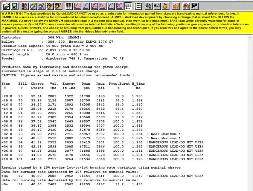

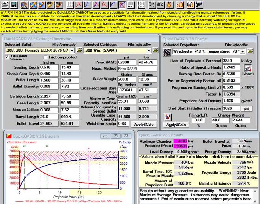

Thanks. I think R.STOCKFISCH might find that info helpful. And here's some more info for him and you that might be found helpful:
