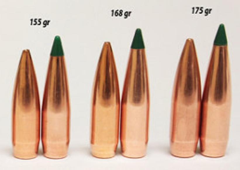

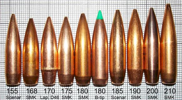

I never jam bullets into the rifling. That causes a big pressure spike of about 10,000 psi...plus if you unload it the bullet can stick on the barrel, making a big powder mess in the chamber and down the barrel.
Bullets have a variation on the ogive or radius of the point...some are better than others, and can change from lot to lot.
I am usually backed off .006" as close as I ever get but sometimes much more.
A long jump doesn't matter if the bullet don't care...shot some tiny groups with long jumps.
One can slowly add a fraction of a grain of powder for alot of extra COAL. Until ya hit the lands then the big pressure spike.
So if your looking for accuracy I wouldn't recommend adding powder above the max load, at longer than normal COAL for that cartridge but stay with book max requirements, until one has lots of experience and many thousands of rds down range.

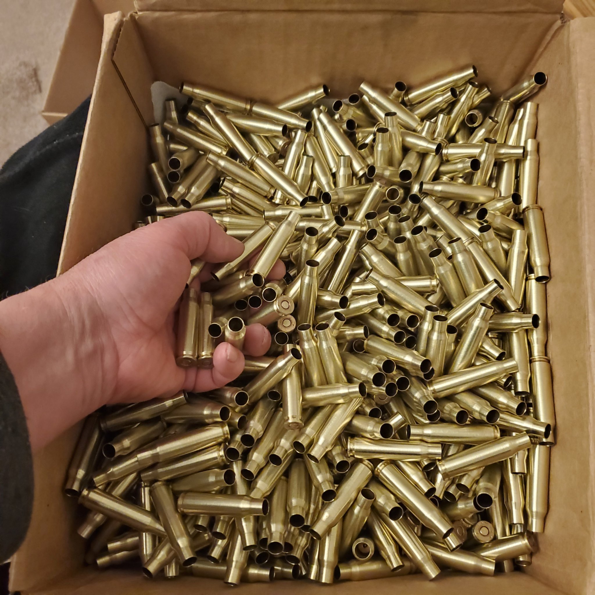

I recently purchased some reconditioned brass brand name-Topbrass. Anyone have any experience with this brand? I looks nice and the bag says it has been sized, cleaned etc. I noticed as I was resizing the neck small clippings of brass were coming off. I know they have not been annealed. Any input regarding quality or what I need to watch for is appreciated.
is "Topbrass" part of the head stamp ? or just what is on the bag ?
I use a lot of Lake City brass, along with just about every brand in range pick up braas, plus Lapua and hybrid cases in 308.
This 1000 pc order was pulled and contained the primer. Buffed off the sealant and loaded it in the Dillon progressive press, with old $20 per pound W 748 and 15 cent Speer 130 Varmint bullets.

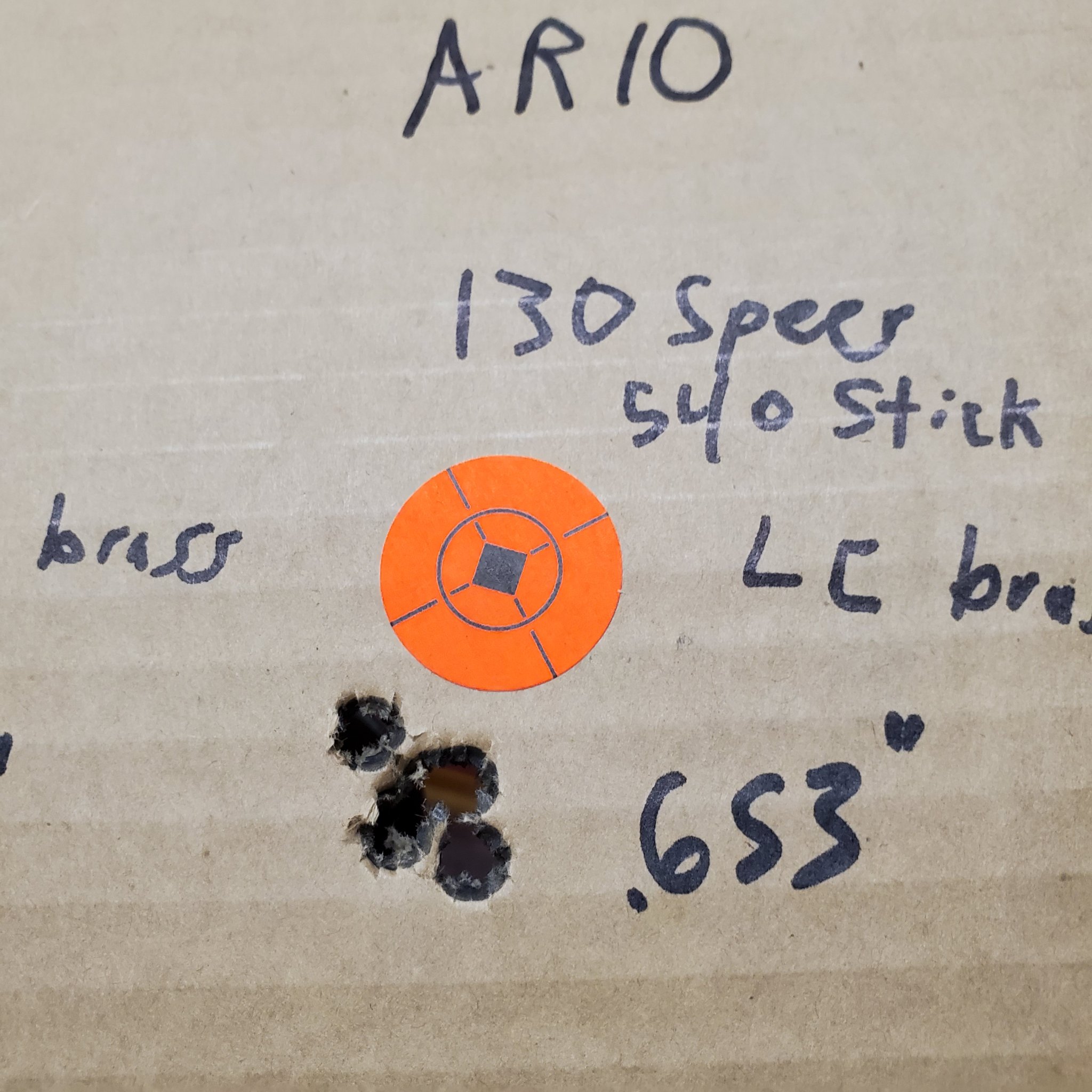

First 5 shots from an AR 10 with an 18" Proof barrel was .3" the 2nd was .4" ....
So I did a little test with a 308 target rifle Lapua brass vs LC ...the Lapua was better by only .1" to .125" with no weight sorting and whatever the military used for primers.
A .1" difference won't make any difference in any informal shooting one is likely to do.
So I use thousands of LC brass in my 308s especially autos. It uses tbe same bushing as Lapua brass in the bushing FL die. It will take the same powder charge but the velocity will be higher because of slightly less volume and one should drop the powder charge about 1/2 to 1 grain, as the case heads seem softer in LC, the primer pocket will expand sooner.

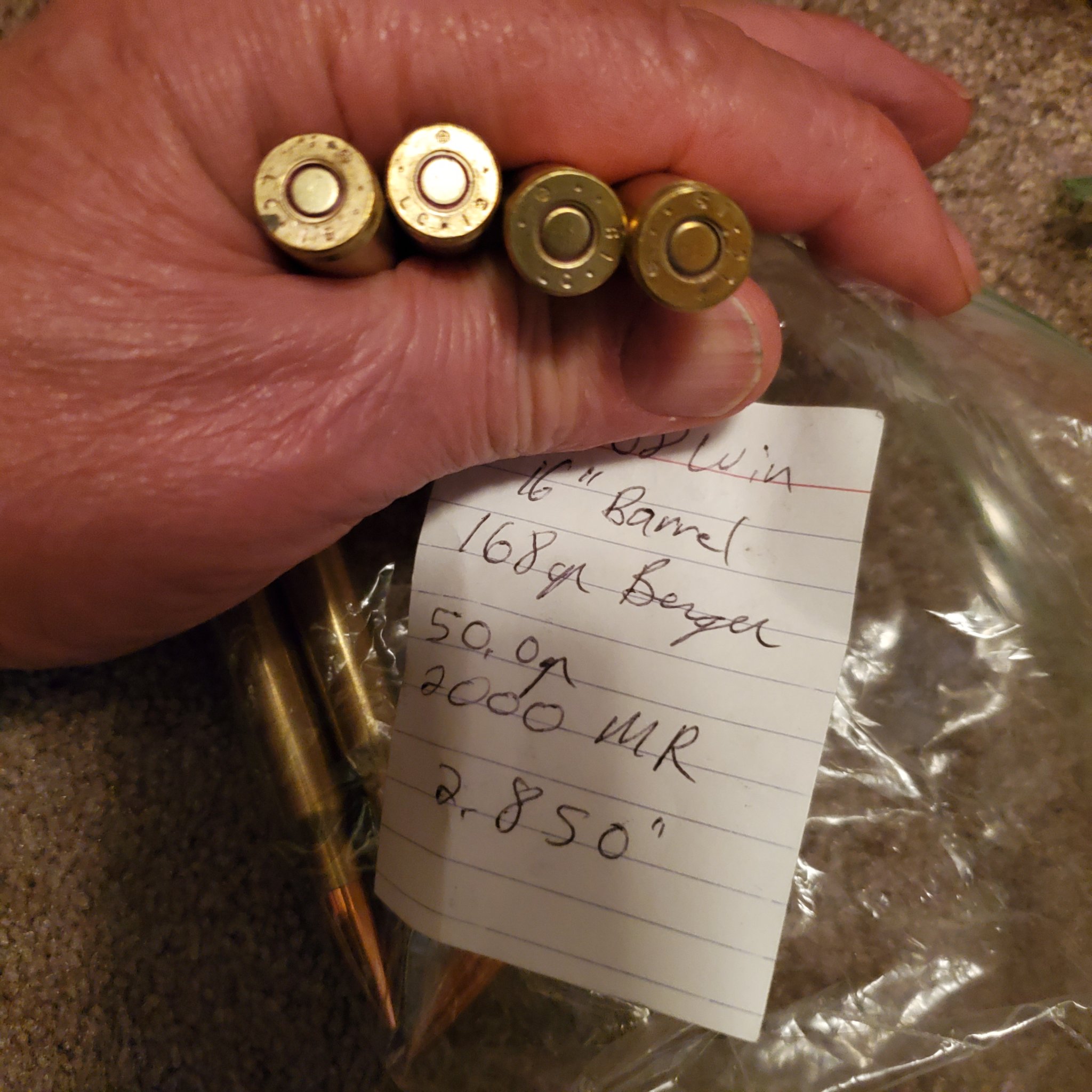

For cheap plinking, get some some surplus powder cheap Speer bullets and a good AR 10 will still shoot 5 shots into .4 to .7 inches.
16" AR 10, 1/2" 5 shot groups all shot with LC brass, nice S/D LC brass.
And shit surplus 540 stick, whatever that is, cheap primed LC brass, still shoots nice groups.
So LC brass is pretty good stuff, it's very cheap, and no worries if ya lose a few.

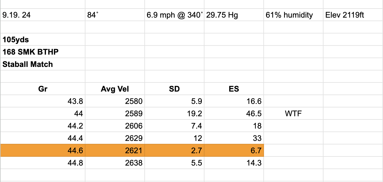

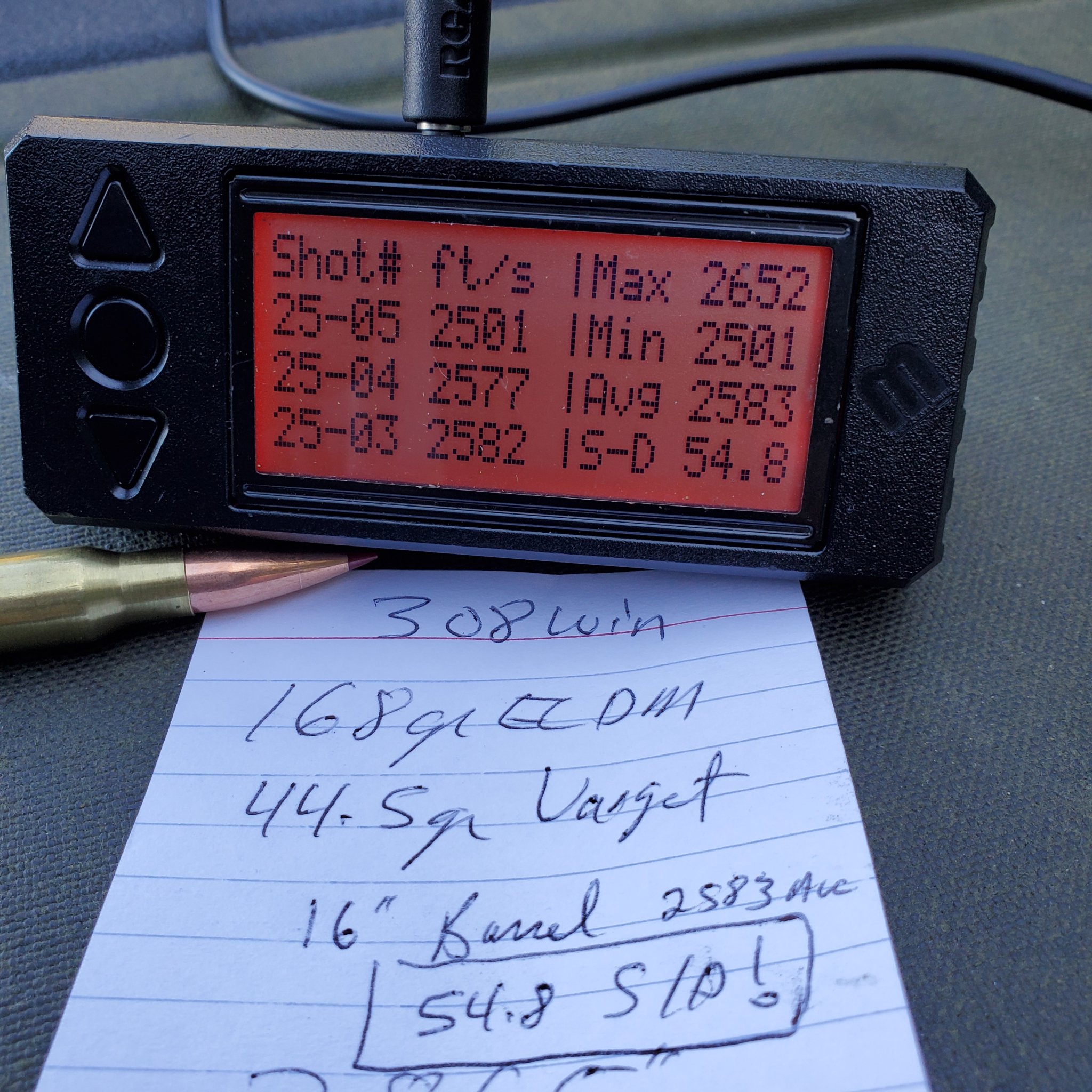

Weird anomaly today during a new load development with Staball Match. Best guess is I let the barrel cool down a little longer in between vs the others. Check out the velocity drop. Any ideas?
Has some wild S/D with weighed charges Varget... it was supposed to be a standard to judge the other powders for accuracy and velocity.
For some unknown reason it was the worst load ever...will revisit it one day.

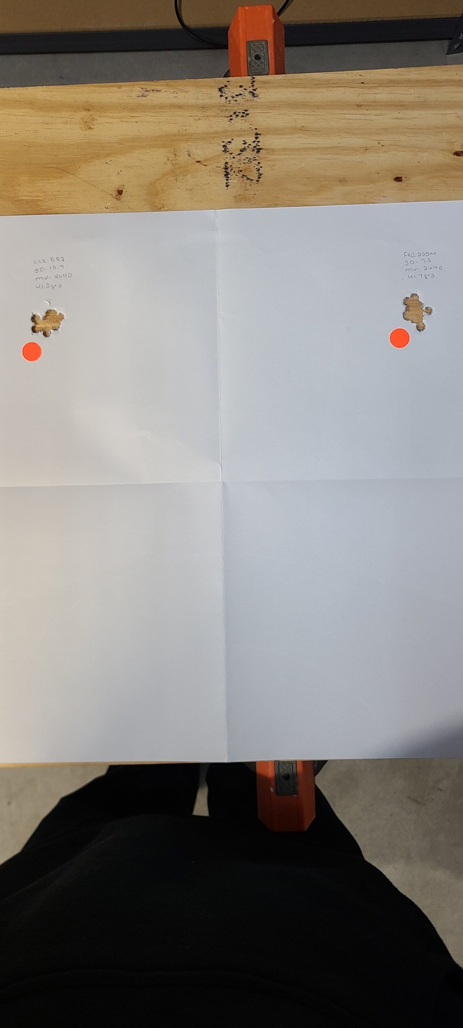

Speaking of Berger 168 Classic Hunters, these are 2, 10 shot groups shot on separate days with an M1A.
Both are exactly .90 MOA
Left Group
41.2 grs H4895
Virgin Lapua Large Primer Brass
CCI BR4
OAL 2.800"
Right Group
41.7 grs H4895
Virgin Lapua Palma Brass
Fed 205M
OAL 2.800"
Haven't even tried playing with seating depth yet.

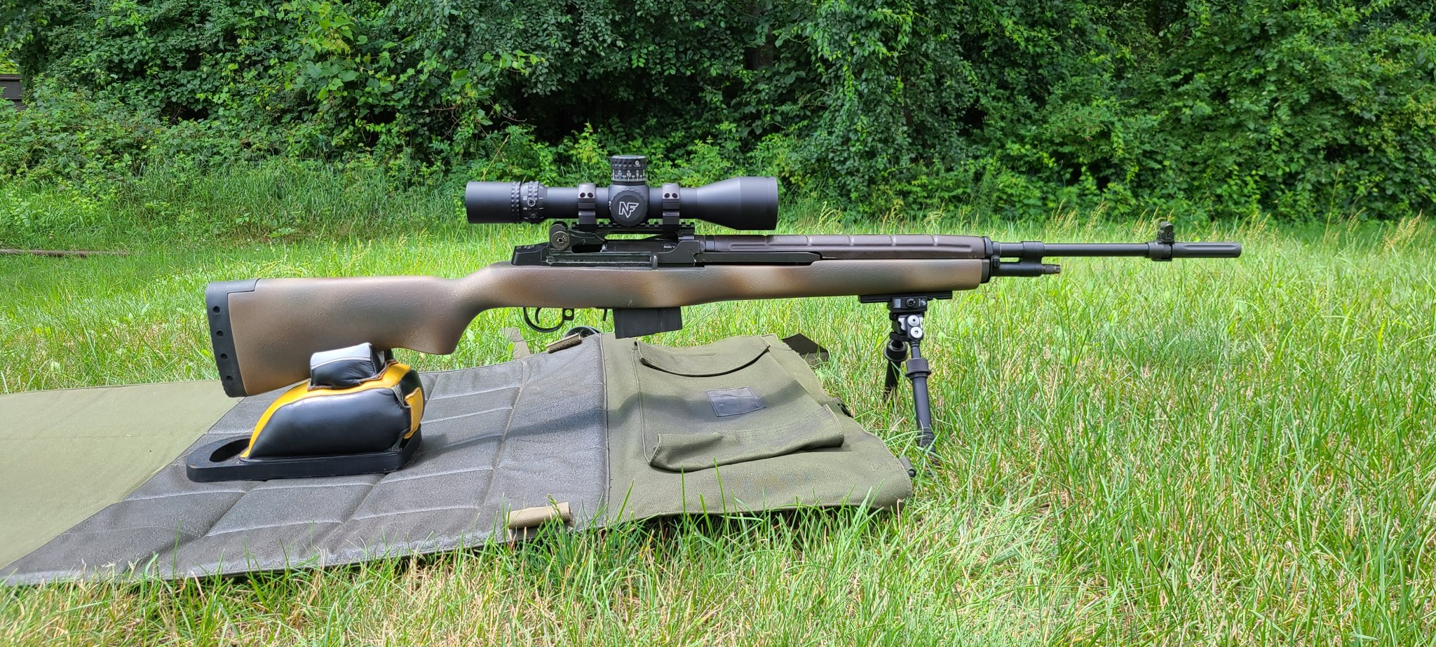

What kind of M1A?
You haven't experienced life if you've never owned some version of an M1A :ROFLMAO:
My first rifle love was behind an M1A. I greatly treasure mine! Particuarly after a trigger service done by Fulton Armory, with a new hooded rear sight. Just feed em' 168 Smk's behind 41.5gr of Imr-4895. Shoots better than I can with iron sights.

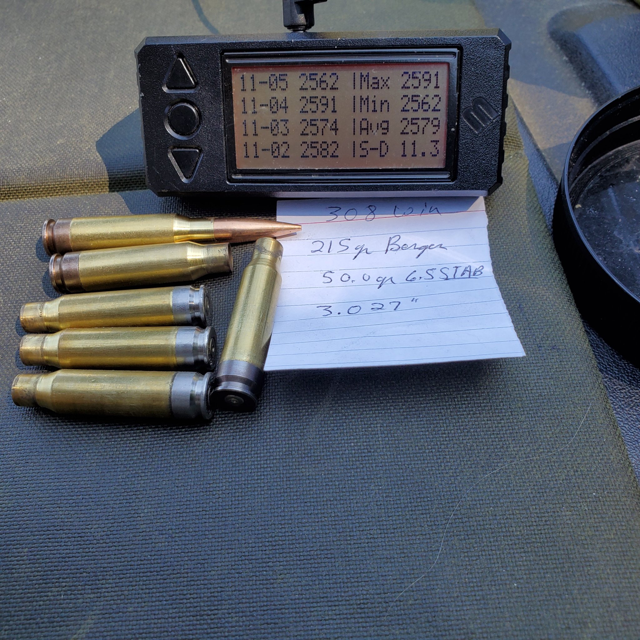

I will let you know if 2500 fps with a 215 Berger is safely doable in a 24" barrel seated around 2.95 with Lapua brass, as I am doing something very similar to this in a few months. Just waiting on the 9 twist barrel to show up.
Reactions: wvfarrier
Yes, with hybrid cases Bartlein 22" 9 twist, but longer single load COAL. 215 gr Bergers will go 2579 fps. But Berger 208 grs at 2634 was more consistent and more accurate in my rifle.
230 gr SMK at 2500 fps in the 22" is accurate.
Been running 200 gr SMK at 2740 in Lapua brass for several yrs in the 9 twist, 22", and 2670 fps n the 18"
And same load 2856 fps in the 30" 8 twist heavy palma long action, 230 gr Atip 2620 fps, 225 gr ELDM 2675 fps. Lapua LR primed cases.
Hybrid cases and 30" barrel will get more speed, and reach 4000 ft/ lbs of muzzle energy in a 308 case.

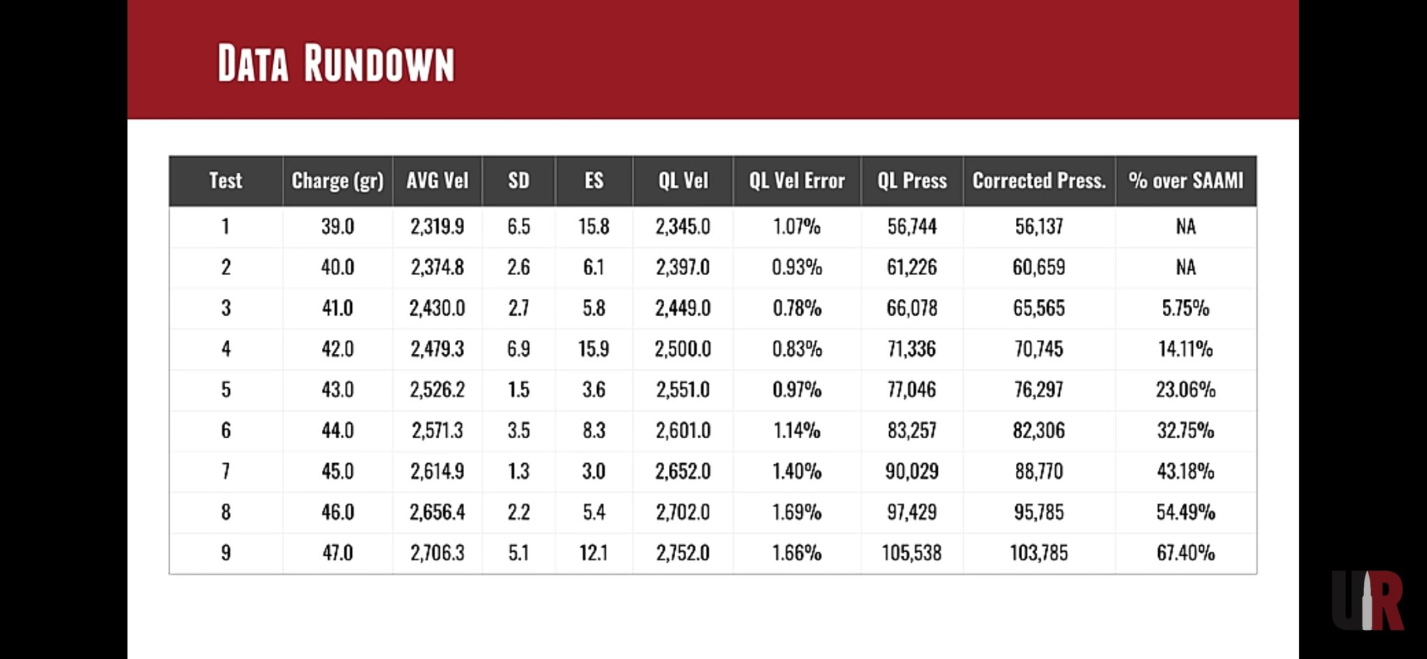

Safe? Seems to be in my rifles...only have QL to judge approximate pressures.
But not as insane as the ultimate reloader video...I'm not going there.
And Varget is not the powder to get you there, at anything close to safely as shown.

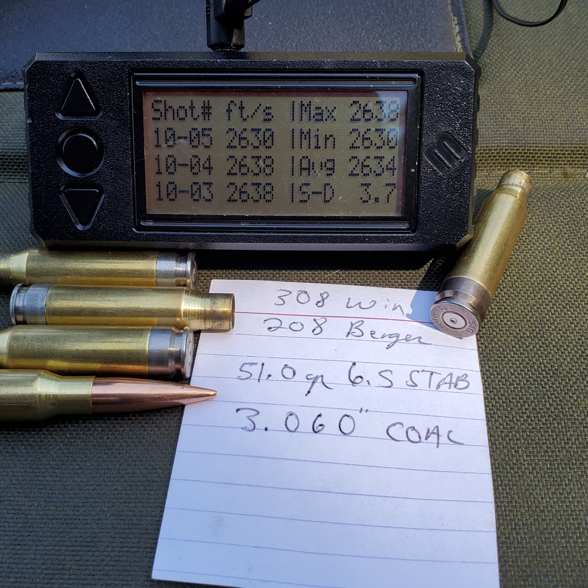

What powders are you using?
For 200 gr and under Alliant 2000MR, for 208 and up 6.5 Stabal.
Here's the load data, but these are loaded in hybrid Stainles steel case heads designed to run at 80,000 psi.
Maybe 2.5 to 3 grs less would be your maximum in Lapua Brass. Hybrid cases have more case capacity.
For your information SR Palma brass is 40 fps slower with the same charge as LR primered Lapua brass...plus here it had higher S/D and less accuracy, so I use LR primed Lapua brass with hesvy powder charges.
I don't run the Hybrids to the full 80,000 psi high but leave some for a safety margin, according to QL.
With these cases the 155s are shot at 3100 168 at 2940 from the 22" barrel of a Rem 700, 9 twist 5 R Bartlein barrel 308.
