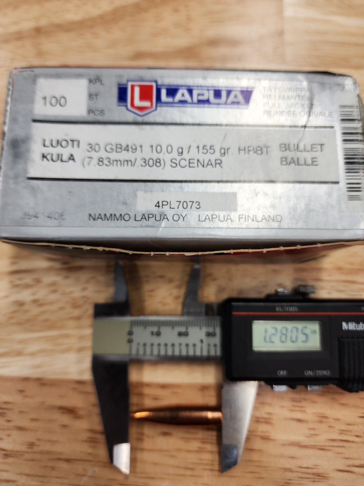

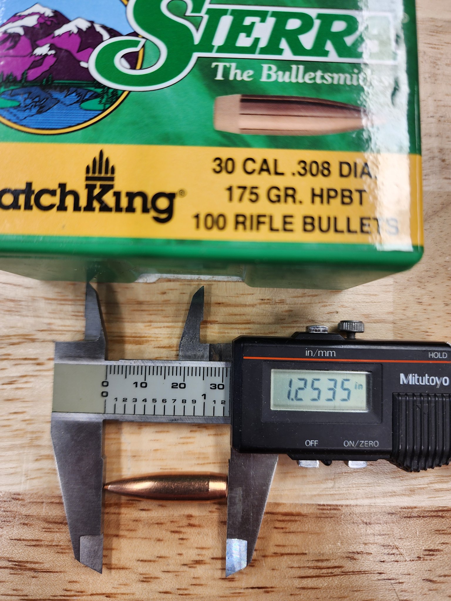

Guys, do any of you by chance have a picture of a 155 scenar next to a 175 SMK? I bought a 308 with an 11.27 twist. When I asked the previous owner why he didn't go with a 10 twist instead, he said he had it done specifically for the 155s.
I try to chamber factory ammo with 175s and it becomes somewhat difficult to close the bolt. I then realized I might be kissing the lands or barely jamming.
I'm trying to see if bullet base to Ogive on a 155 is much shorter than on a 175. Or, it might be longer but the ogive is at a much lower point on the bullet. I will re-check again tmrw with a sharpie painted factory 175 and see if the lands are showing up. I just had my brain going right now and figured I'd ask. Maybe the rifle is short throated and I may have to ream it out.

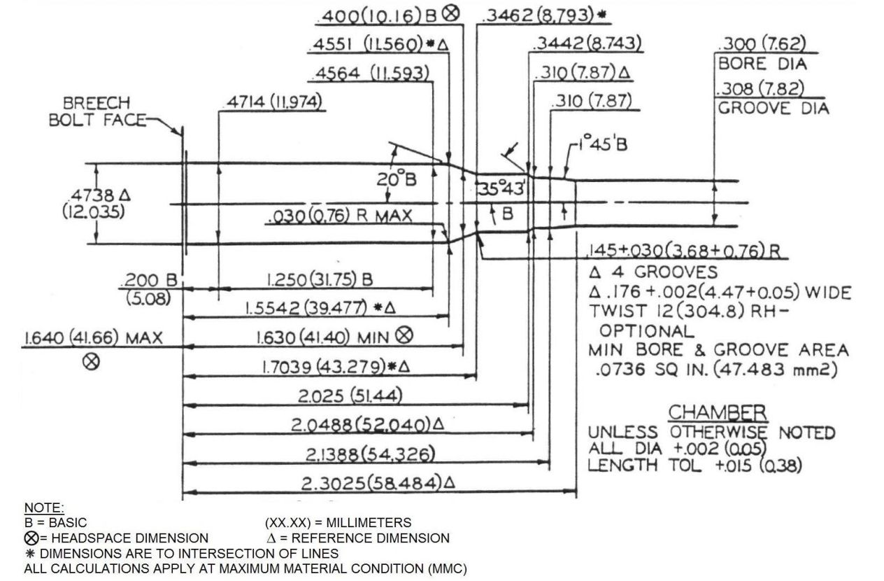

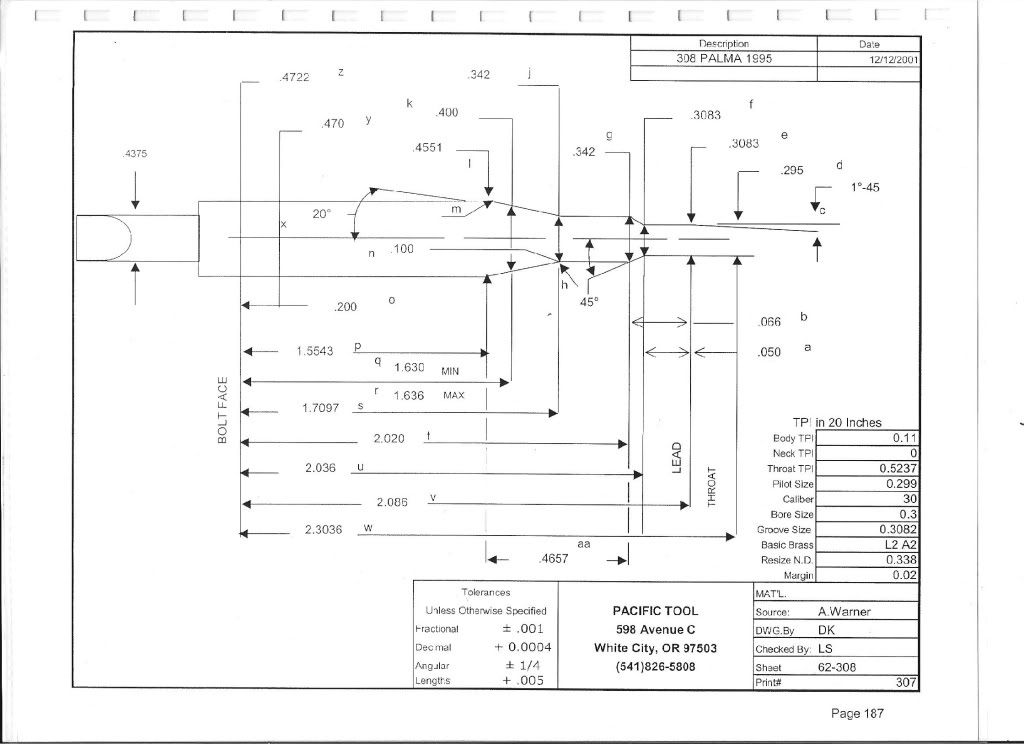

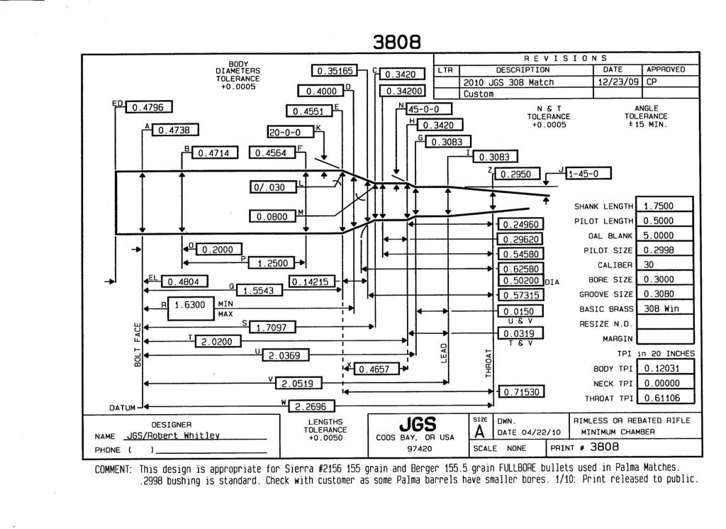

In Palma and target rifle circles, they normally cut the chambers with short freebores for Berger, Sierra. From as little as 0 freebore to a massive 0.050". Or they cut them long for Lapua Scenar with a 0.100" to 0.120" freebore.
What makes the 155 Scenar different is that is has pretty much the same external dimensions as the 175gr Scenar; just contains 20gr less lead.
I suspect that your chamber has the short freebore. If the chamber was cut for the 155gr Scenar it would have had a long freebore.

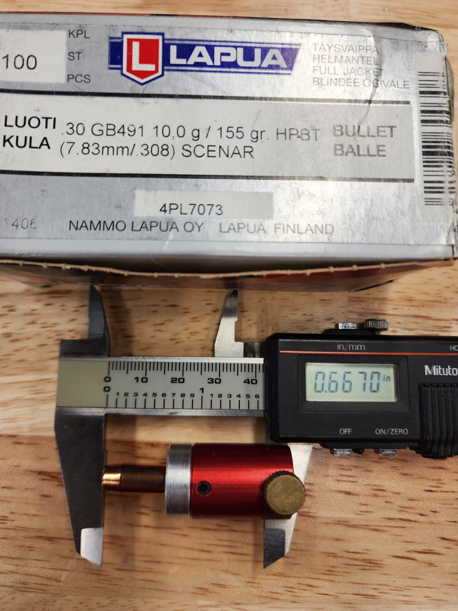

Yes the 155. Scenar is surprisingly long. I compared one to a 178gr ELD-M and there's nothing in it. Probably explains why they shoot very well in my Tikka factory chamber (11tw).

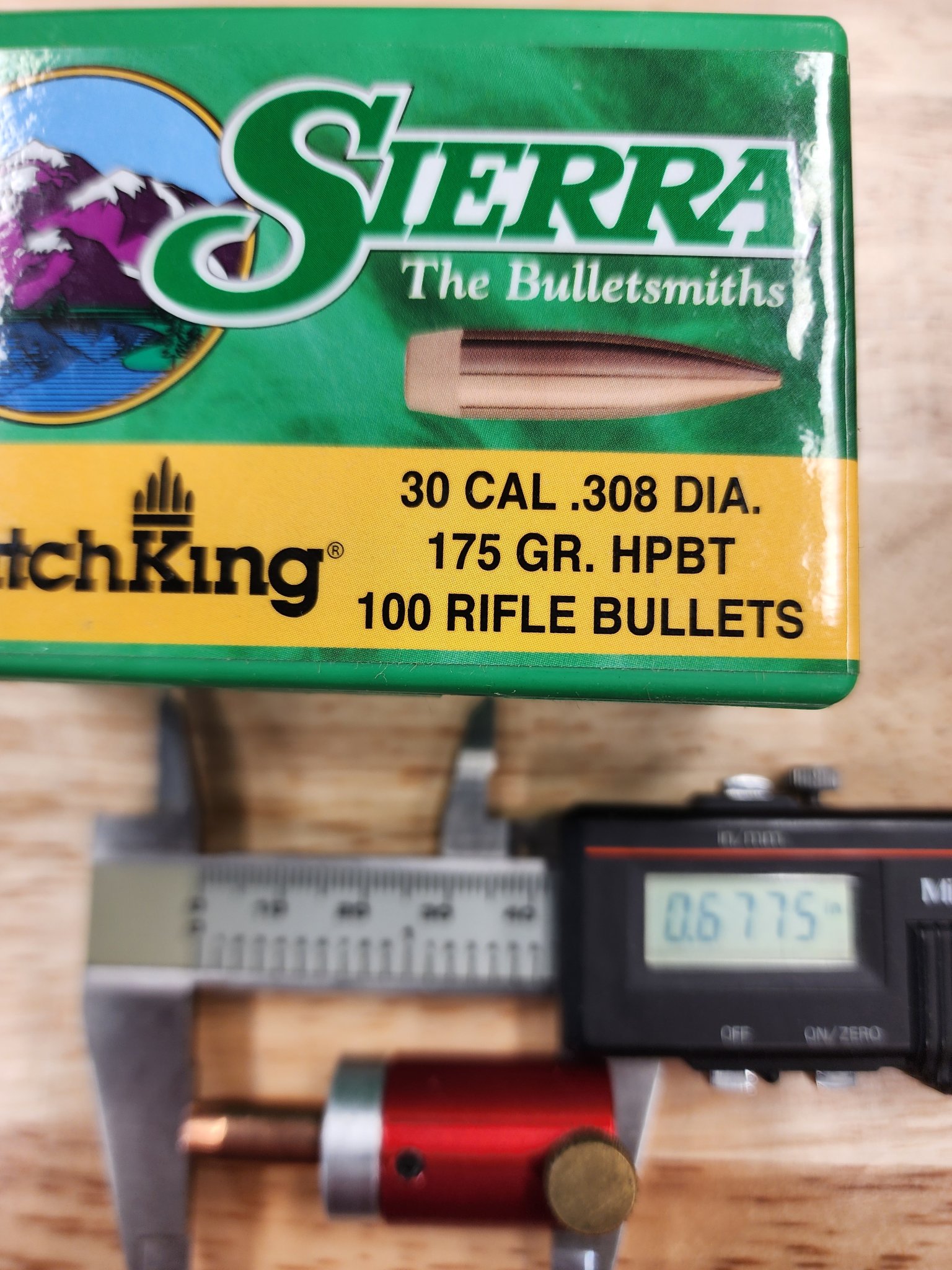

So it looks like while the 155 is still longer overall, its bullet base to Ogive is still shorter by roughly 10.5 thousands. Thank you for posting this.
I'm starting to think this barell was chambered/throated to possibly run 155s at mag length. This would explain why most 175s are kissing the lands.

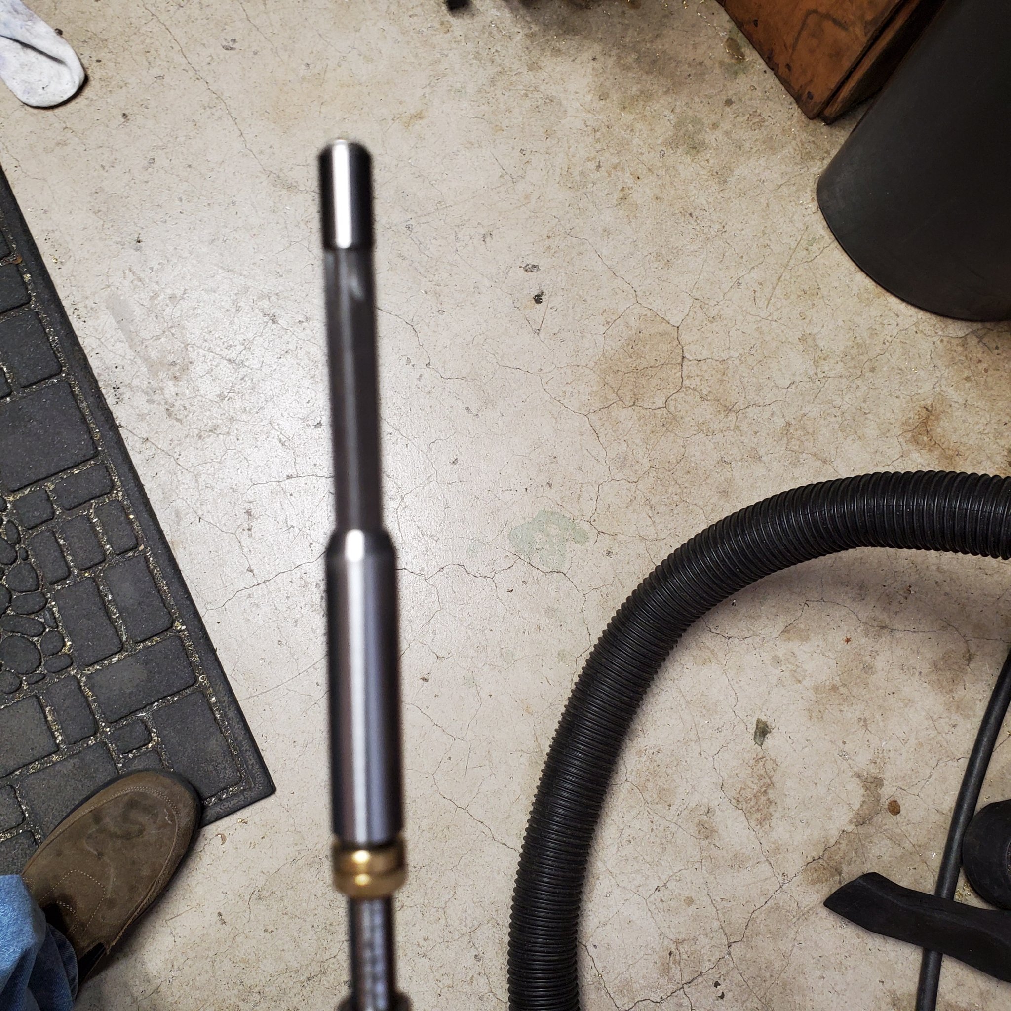

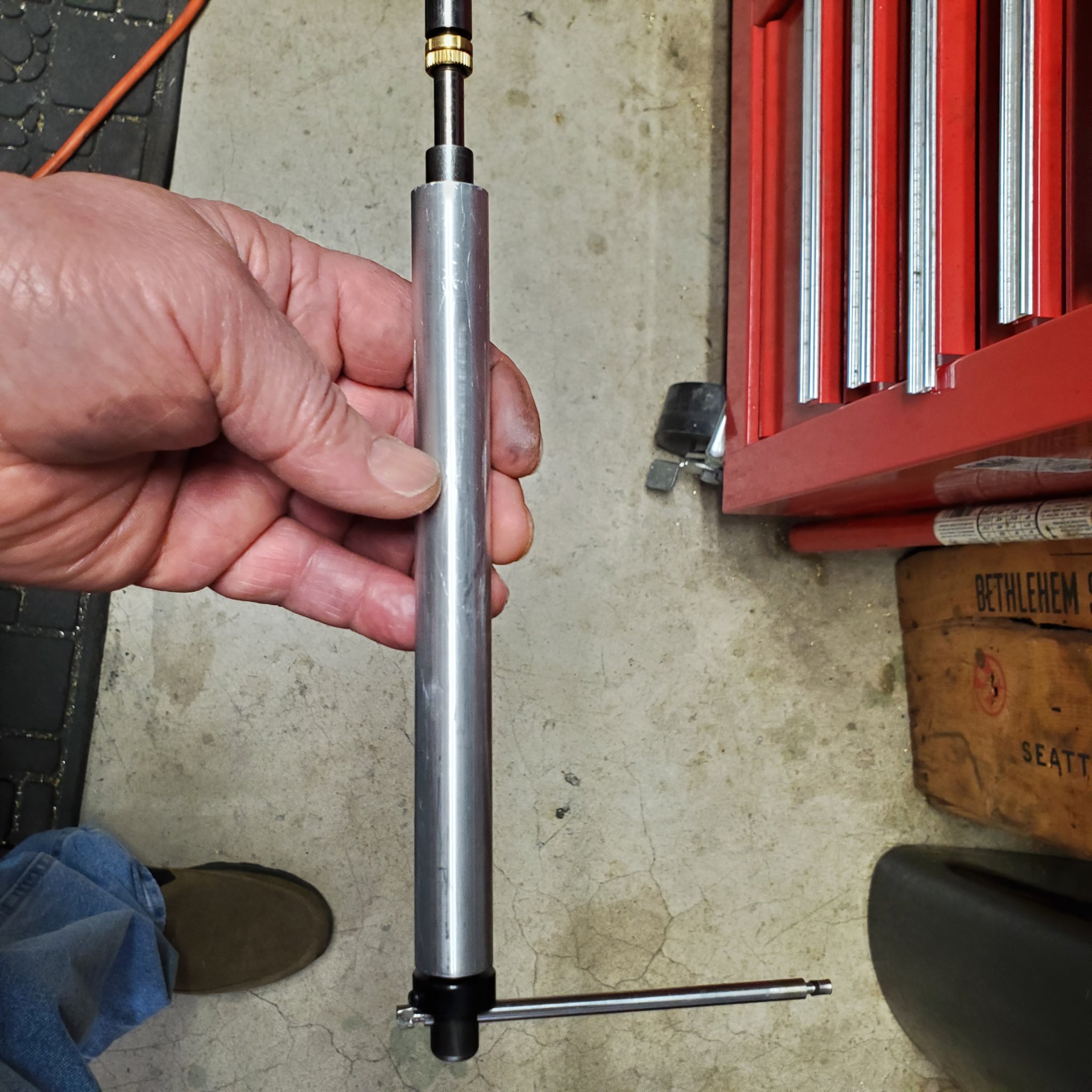

How do you suppose I measure OAL to land with the 175? I'm barely going to start reloading soon so it'll help me to know.
I've seen the method where gut out the bolt. They then insert a case with a bullet in it with very minimal neck tension to allow it to be pushed inside the case as it start going into the lands. The bolt should free fall down with no resistance. Is this what you mean?
Just buy a 308 throating reamer and handle.
The aluminum fits the diameter of the bolt and sized to the long turning handle, so everything is centered.
Use dark heavy cutting oil, with all the cancer causing agents...cause it works
Cut your free bore any where you want it.
Done....it's easy to do.

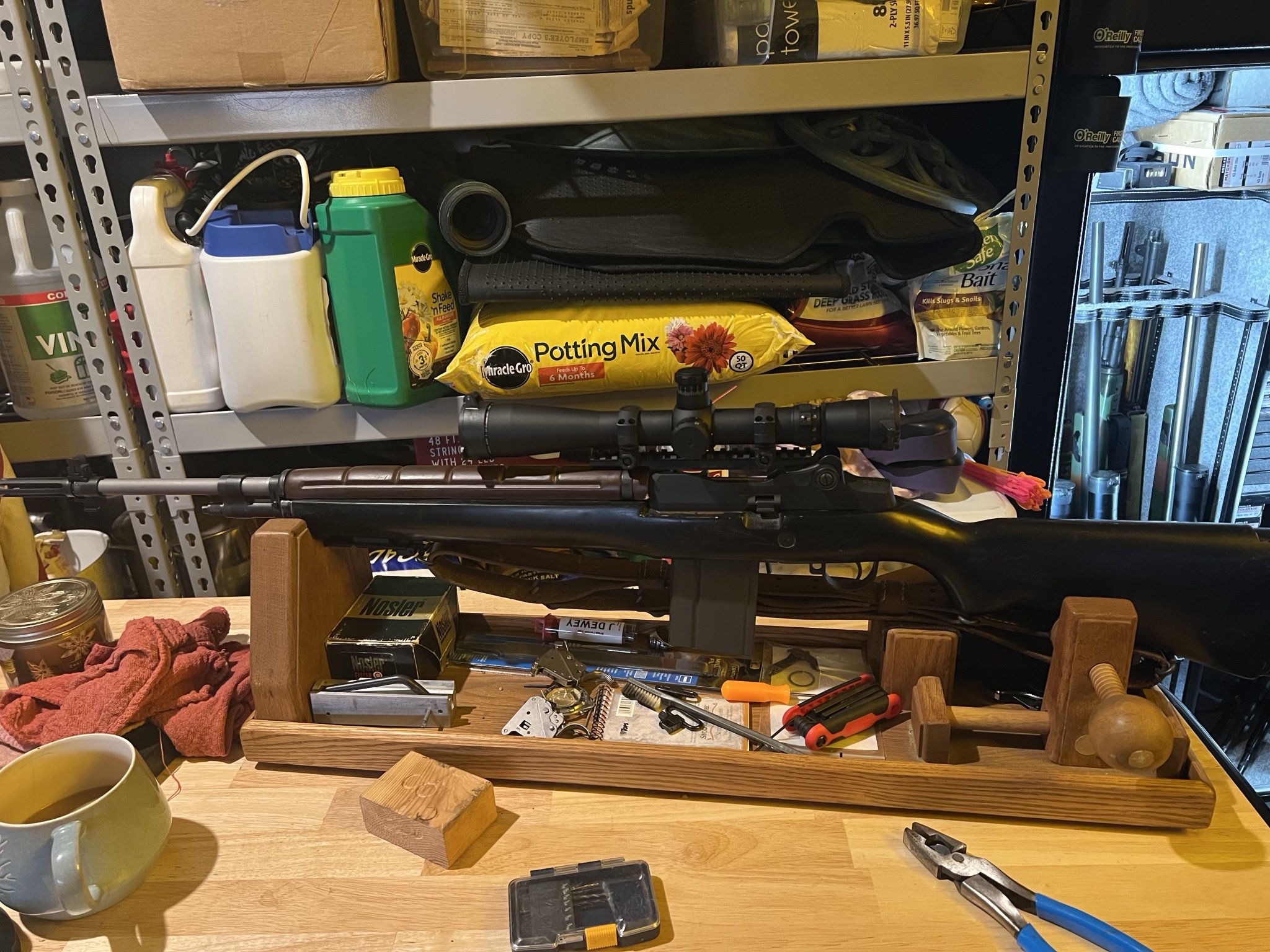

I am bedding the scope base at the moment. Later tonight I'll remove the base to drill the screw holes out. I'll use sharpie to paint a bullet and then chamber it. I had already done this before but cannot seem to remember where I placed it. I'll update with what I see on the sharpie'd bullet.

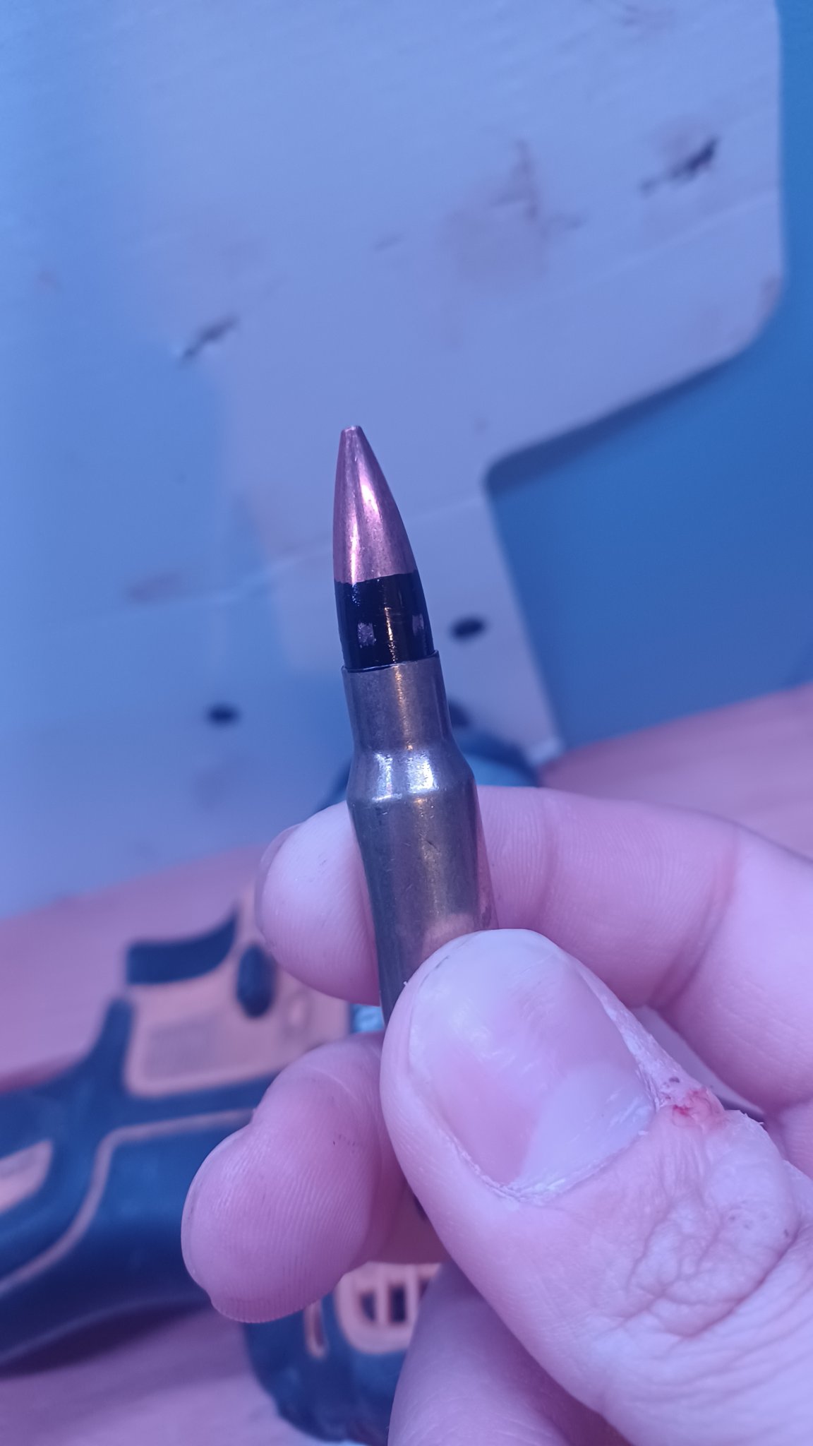

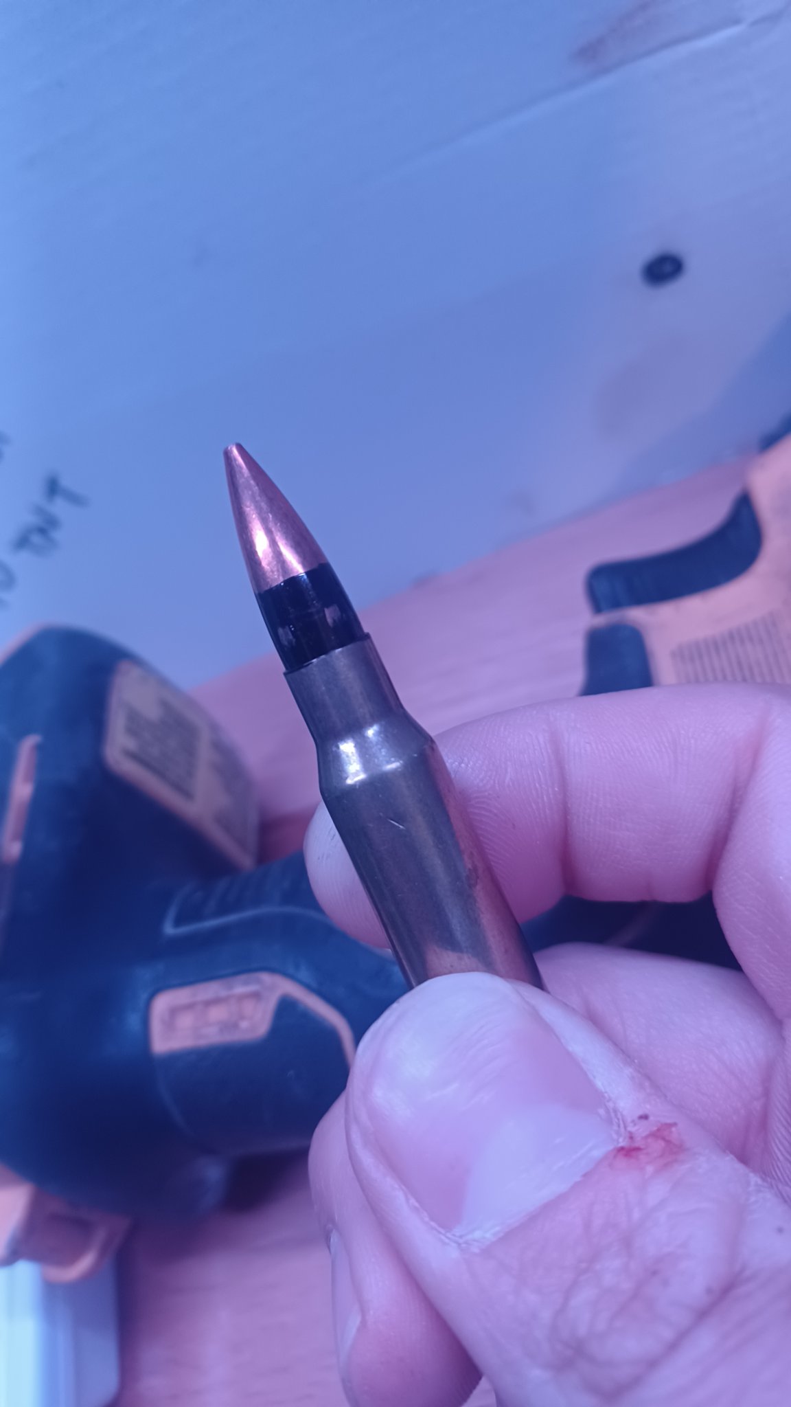

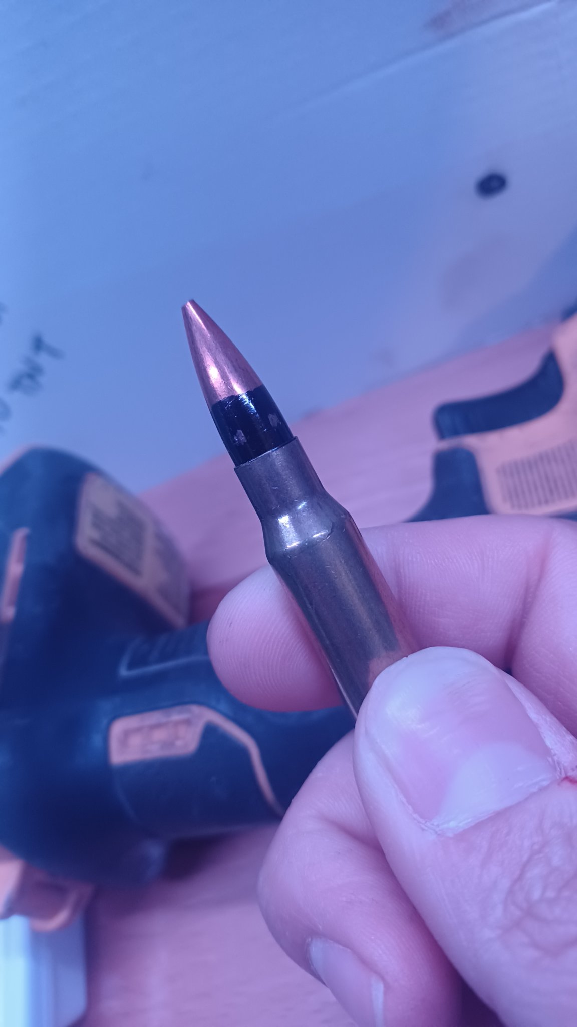

Just got done doing the sharpie method. If this isn't a clear indication of kissing lands, then idk what is.
There's 5 total marks of paint scratched off. Pretty sure this rifle has 5 lands lol. Although there is a very very nice and blended brake that won't let me see the muzzle end to verify that. I have no idea how to remove it without scratching it. There are no wrench flats.
Reactions: Balor
Judging by how close to the case mouth those marks are, the freebore is mighty small.

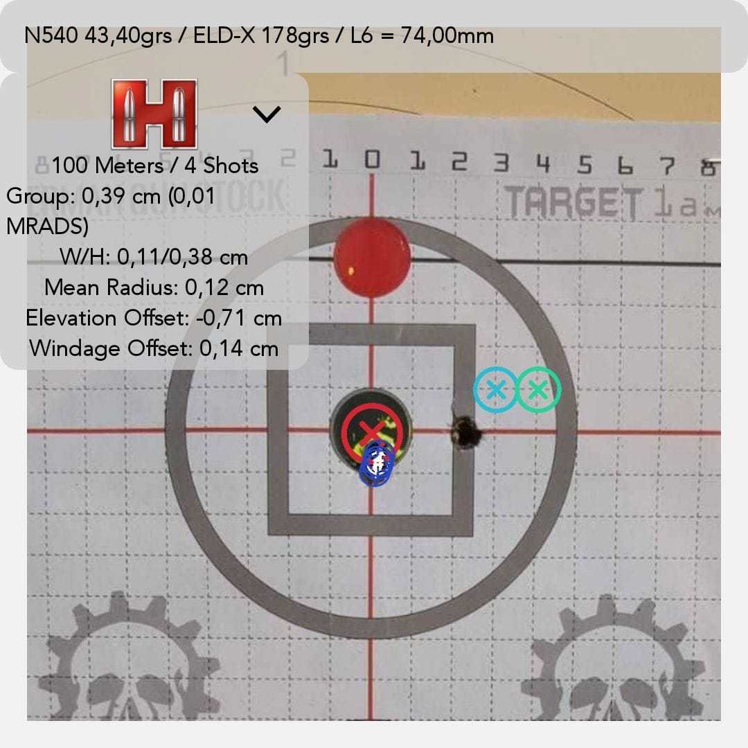

Lapua Brass 51.00mm
Hornady ELD-X 178grains
Vitavhouri N540 43.40grains
L6 = 74.00mm
RWS LR Primer
Tikka CTR 308 20"
MDT Field Stock
Burris Six XE3-18x56 FFP SCR2

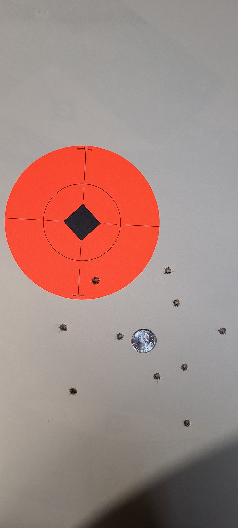

Shot 5 rounds from hunting stand at a target about 100m
First shot 2 clicks right, Cole Bore, next 4 shots dead center

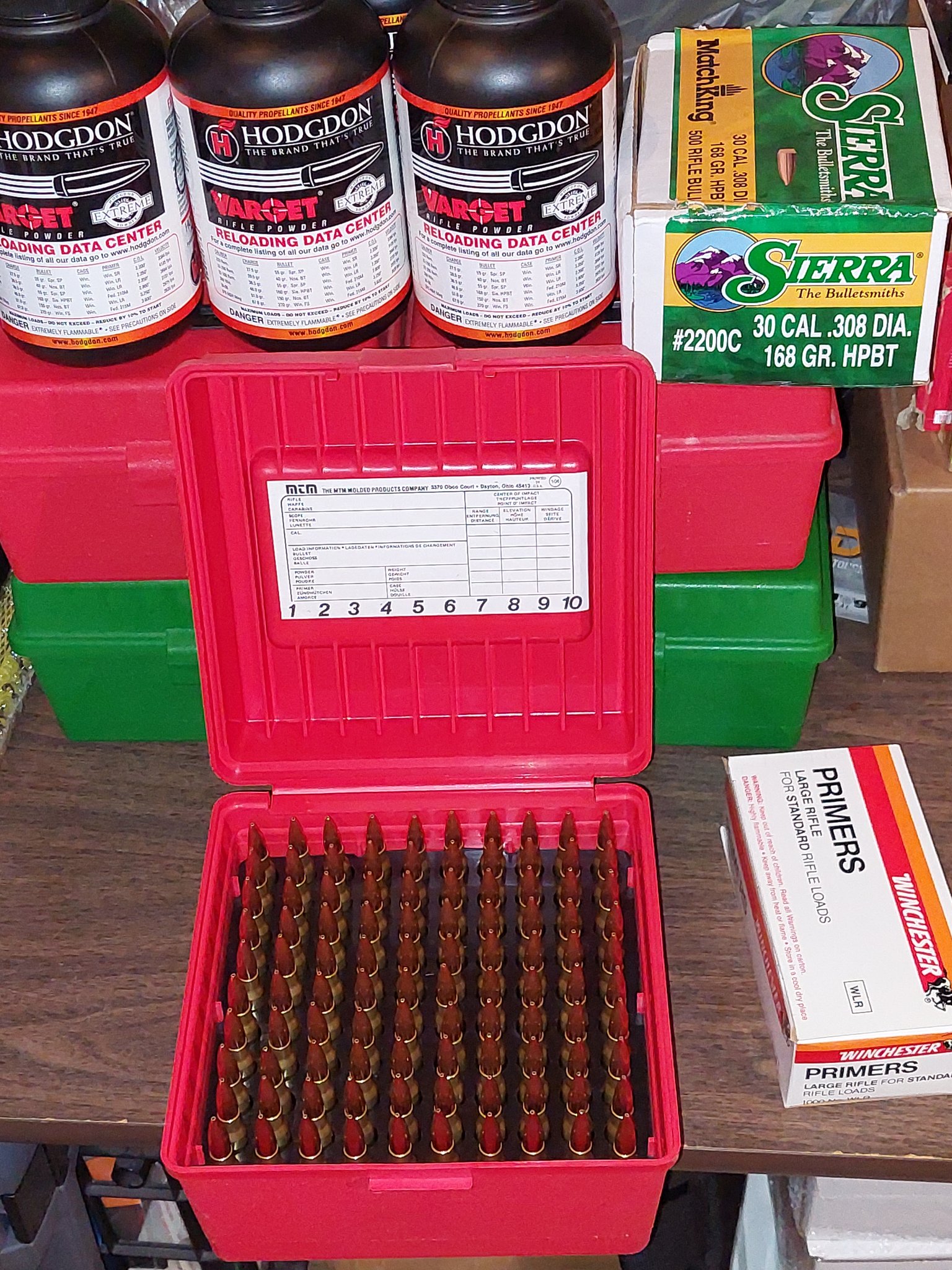

Whipped up 500 rounds today. 168 SMK, 41 grains of Varget, old Winchester WLR primers. Old once fired Winchester cases from the 90's. COAL 2.80. I've been using this loading for well over 20 years, just lacking the Varget since the start of covid. Today was charging and bullet seating on my 45 year old Rock Chucker.
Good luck with those primers. ;)

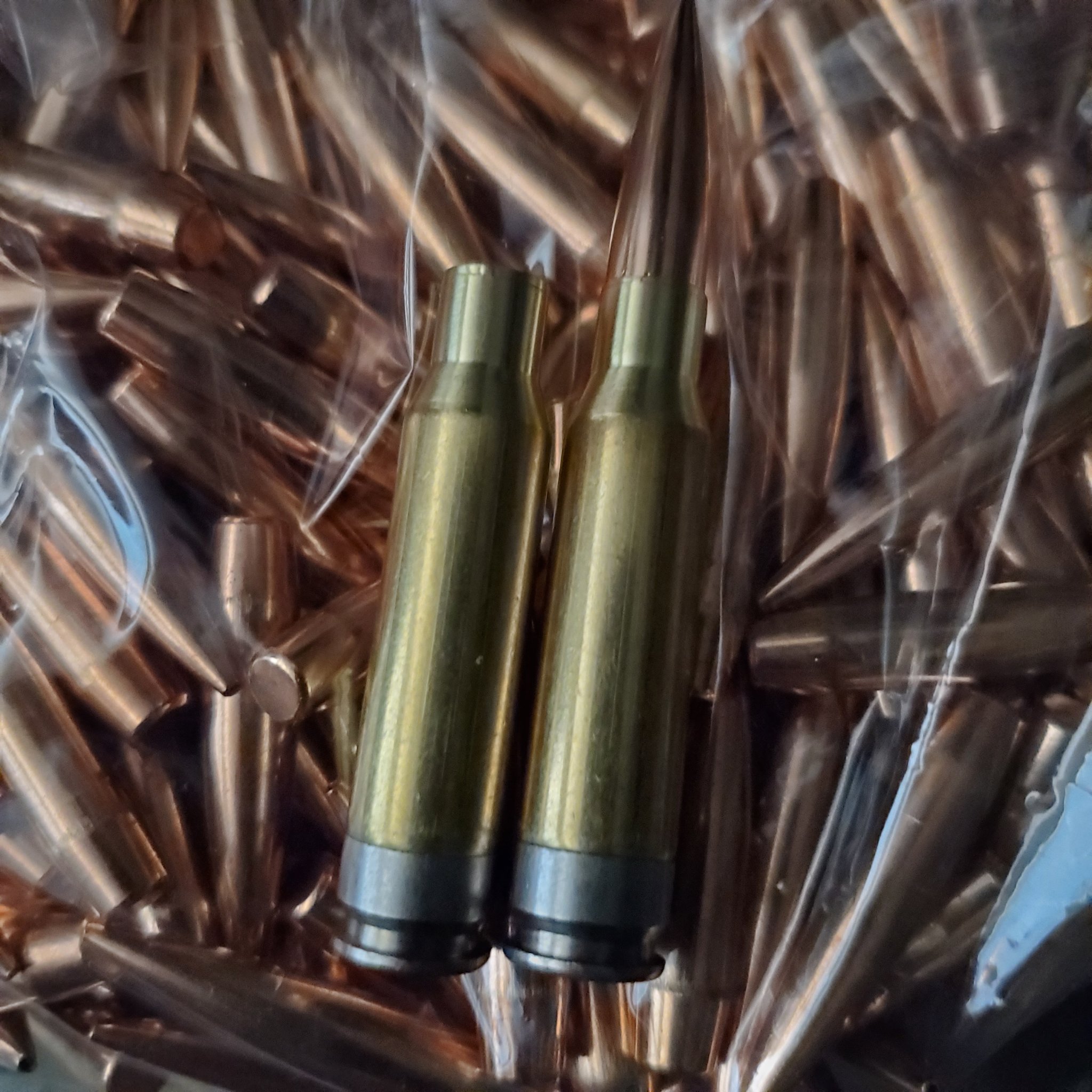

For today's 308 Win loaded a bunch of these hybrid 208s and some 215 Bergers in hybrid cases ...51 and 50 gr of powder.
For a 9 twist 308 22" and a 30" 8 twist 308.

Where might one procure these hybrid cases?
I bought 1500 cases early on...yrs ago then a few from time to time..a big investment.
They were spotty, as to availability...
But the good news is American Reloading had just received a bunch and put them on sale for like 52 cents ea with the primer, from pulled military cases.
I purchased 200 to replace the ones used in the 8.6 Blackout ...

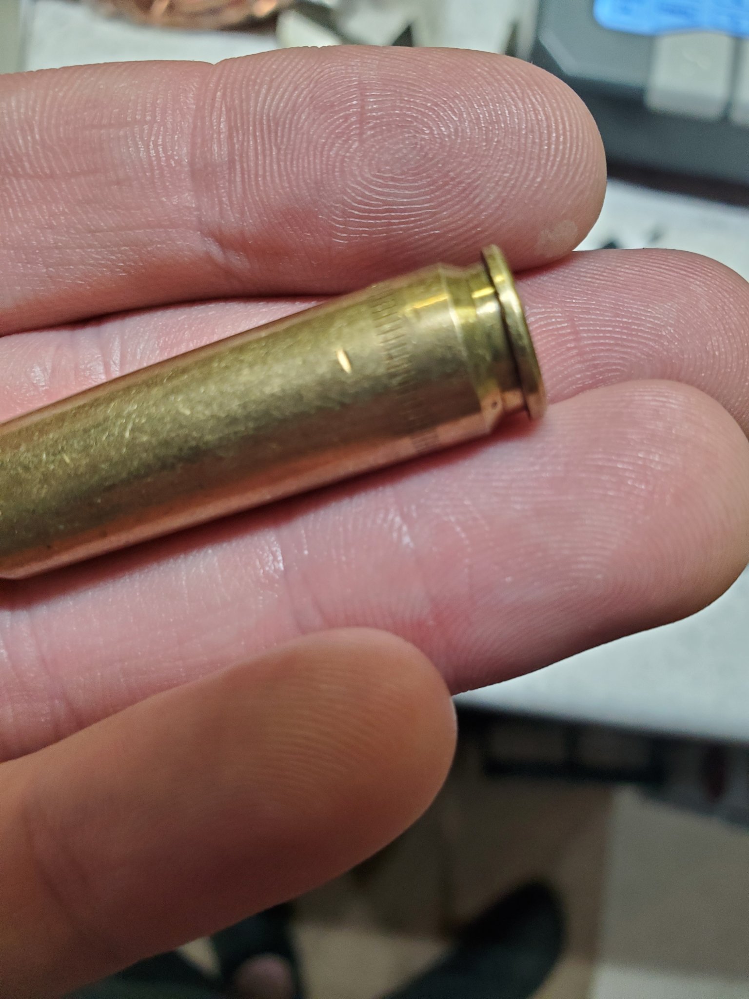

The bad news, they had stuck ball powder in the cases,... from compressed loads?
The easy way to get it out is with a air compressor, and a skinny harbor freight air nozzle, and blast the hell out of it with compressed air...watch the eyes.
I decap, with a Lee decapping die...and re use the primers., later.
Mandrel up to 30 cal and size in a full length Wilson bushing die, with .334" dia bushing.

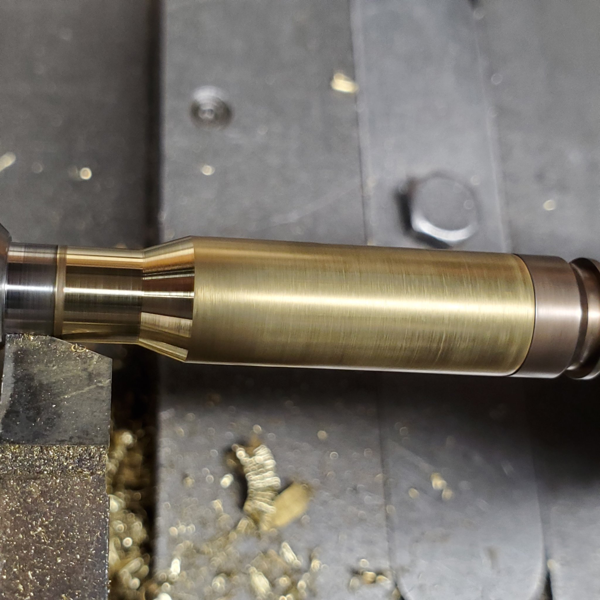

For those with a lathe,
I neck turn into the shoulder with a ground form tool with a radius sharper than print in the neck shoulder junction on the lathe to eliminate the donut, completely.
But it's a step you may not do to enjoy the benefits of the hybrid case, but I'm always concerned with pressure spikes from inconsistencies in that area.
The pic is how I precision neck turn, not the average way...but it gets precise results.
I run minimum chambers in 308 boltguns with the same reamer...but it's not necessary to be that precise with most chambers, have a lager plus side to work with.
These cases have beat out Lapua LR and Palma SR for accuracy with 230 SMK at 2550 fps. In the Bartlein 9 twist 22" barrel, with a Rem Varmint contour, so one can pack it around... also run the same load in the LA 308 Win 8 twist 30".
