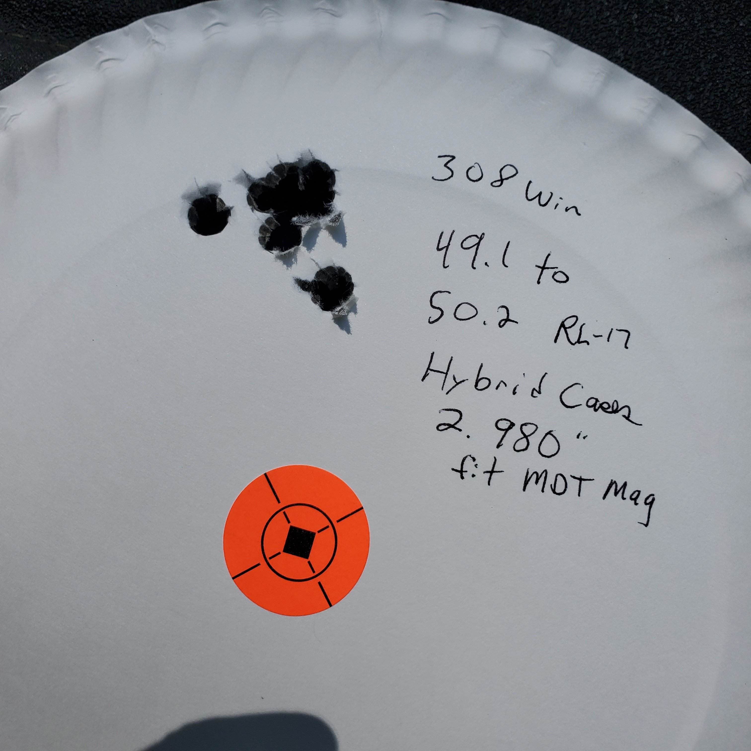

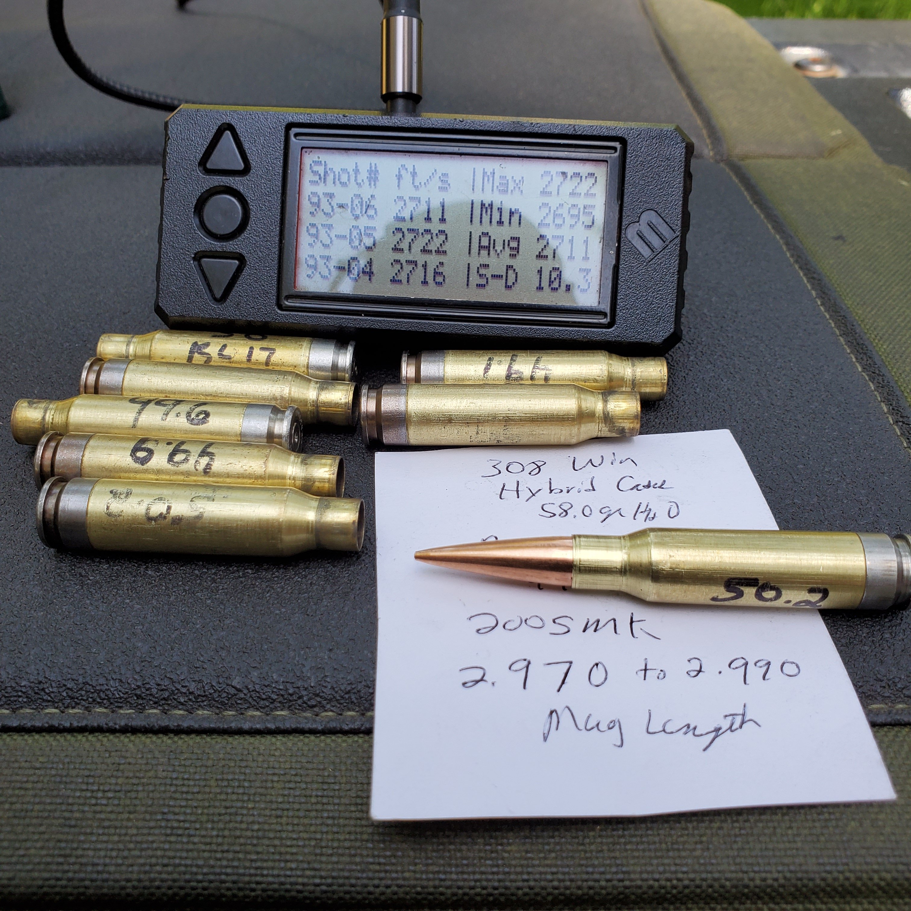

.308 Winchester
I used H4350 the most temperature stable powder in the 308 not looking for temperature stability but accuracy in the long barrel long action with an 8 twist.
308 long action 8 twist
200 gr SMK, Lapua cases LR, Win primer 48.0 gr H4350, 3.175" COAL.
Velocity 2681 fps ave
Group 10 shots .699"
Also used H4350 with the 230 gr SMK, & 225 ELDM.
Another powder is 6.5 Staball with 208 to 230 gr Atip, for a fairly temp stable ball powder. It works with heavy bullets and hybrid cases pretty well.
Ya need a 9 twist to properly stablize some of the heavier bullets.
If you can run 208 gr bullets 6.5 Staball may help ya out in Arizona with hybrid cases.

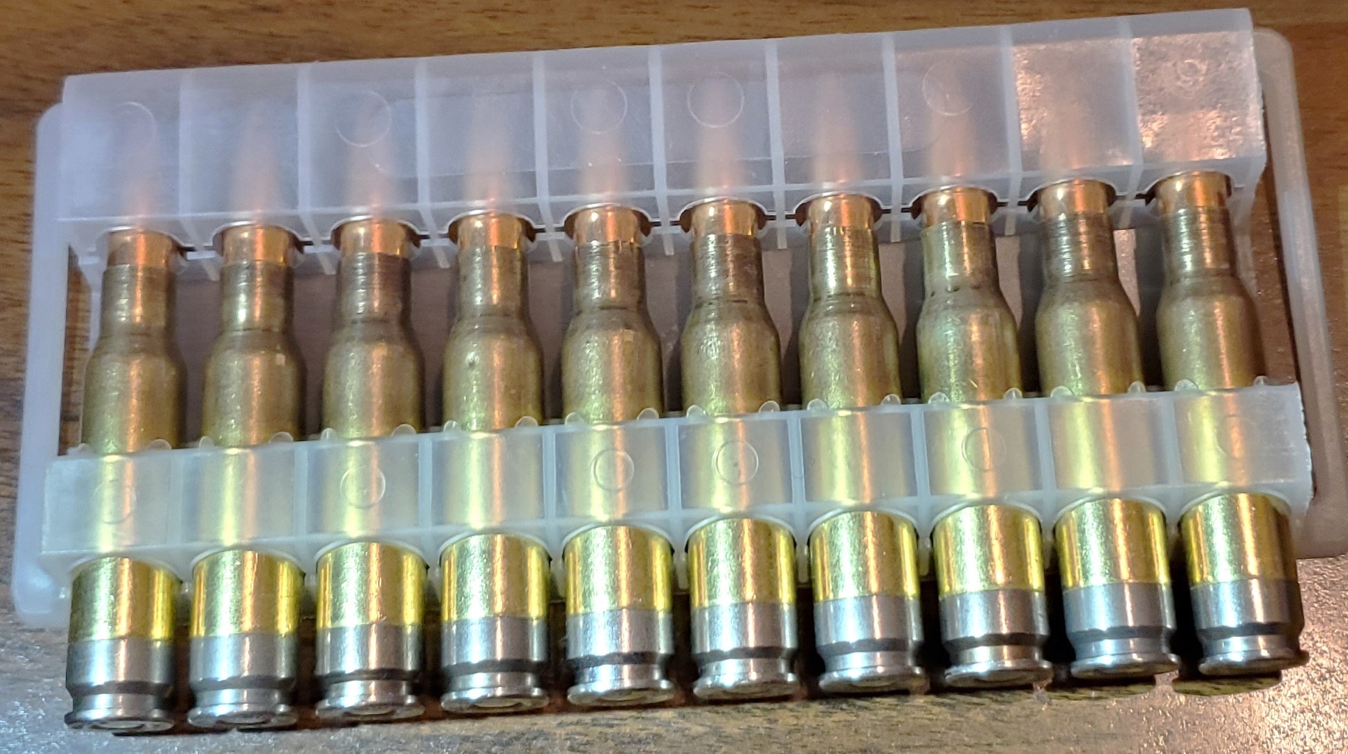

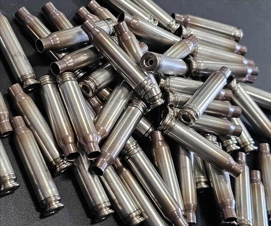

So I looked into hybrid cases on line. I instantly saw Bartlein won’t sell or warranty a barrel for this use. That is a huge red flag for me. Bartlien tends to be on cutting edge of barrel technology
Varget in 308 is not a short barrel powder. It’s best in 22-30” bolt guns
H4895 works better in short barrels
I have used a bunch of H4450 in 308 and just can’t get enough powder in case to get velocities to make it competitive
I wonder why no one in F TR is using a hybrid cases in competition?

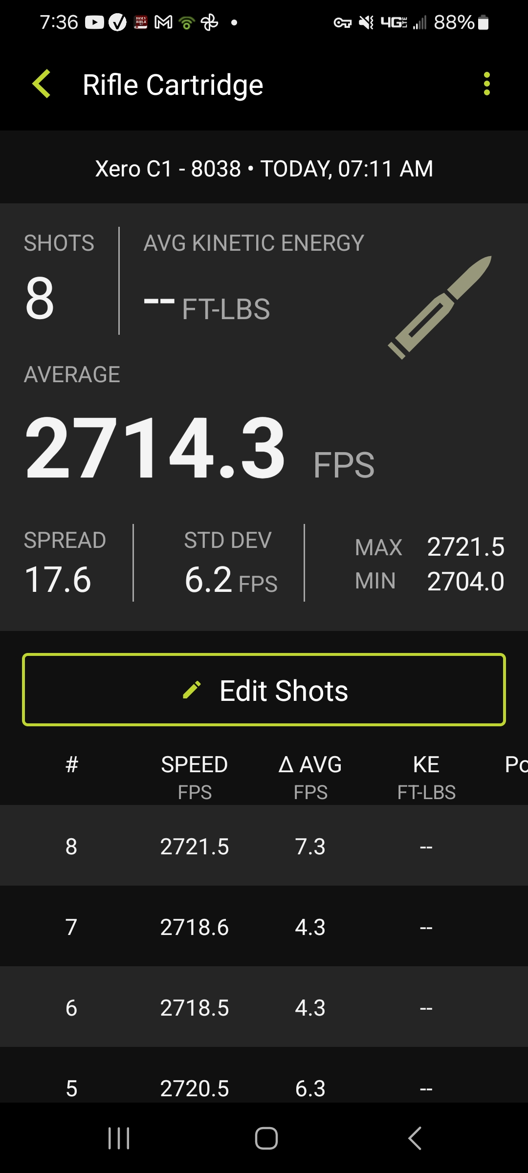

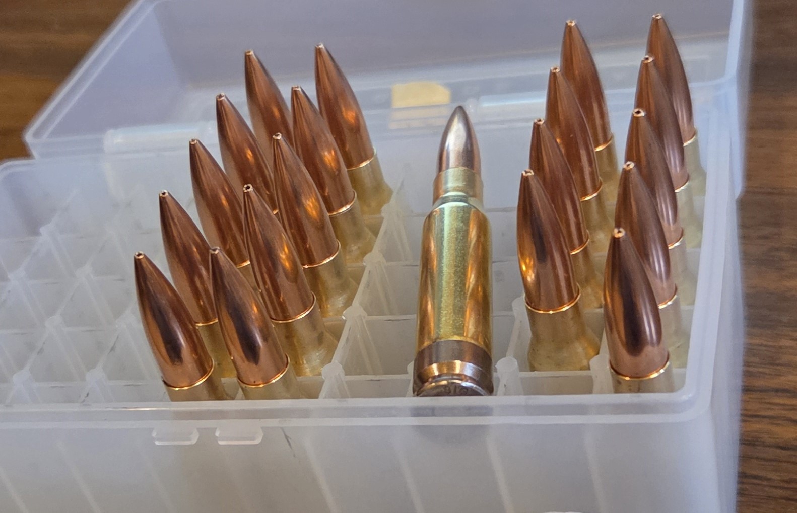

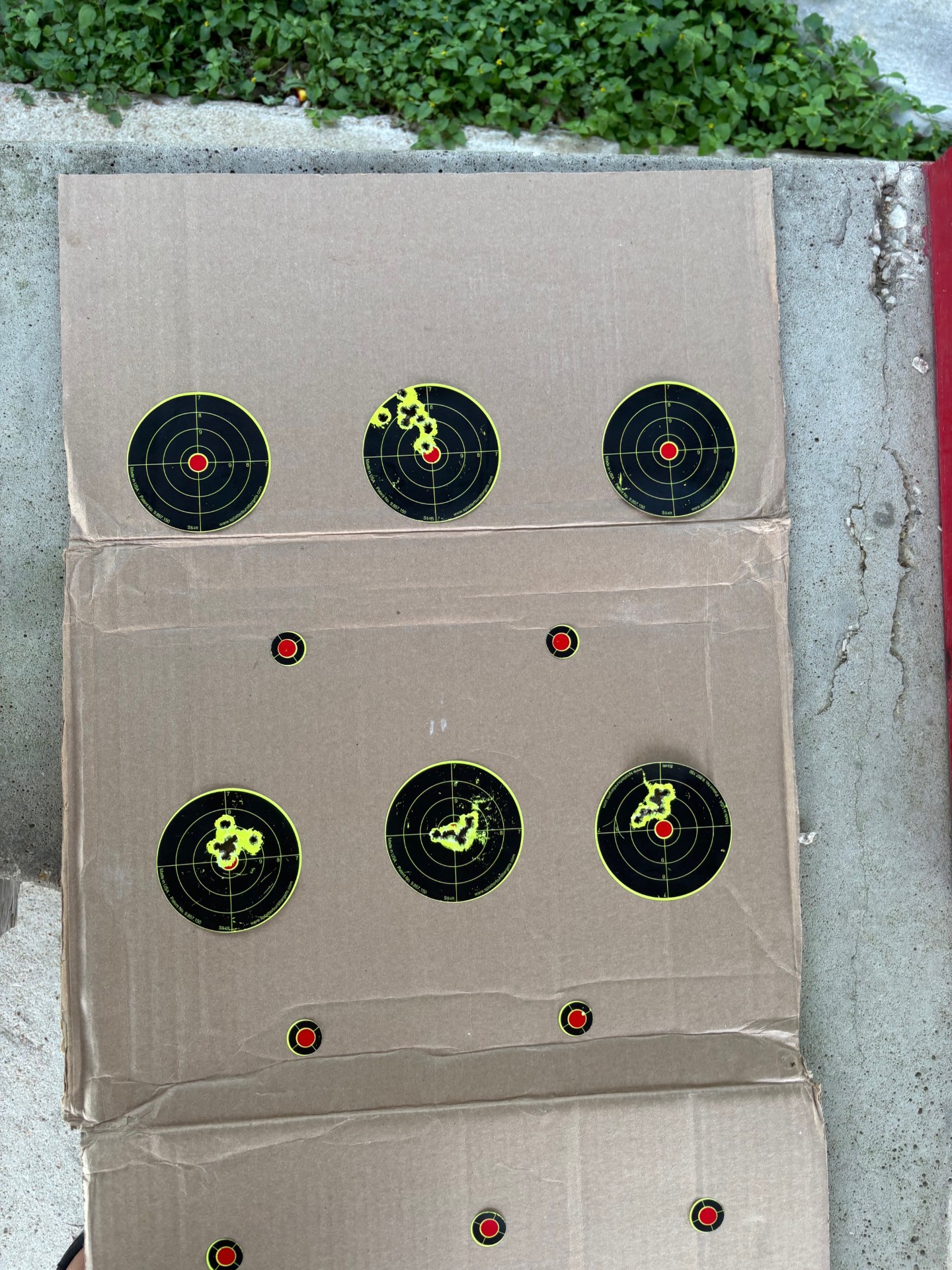

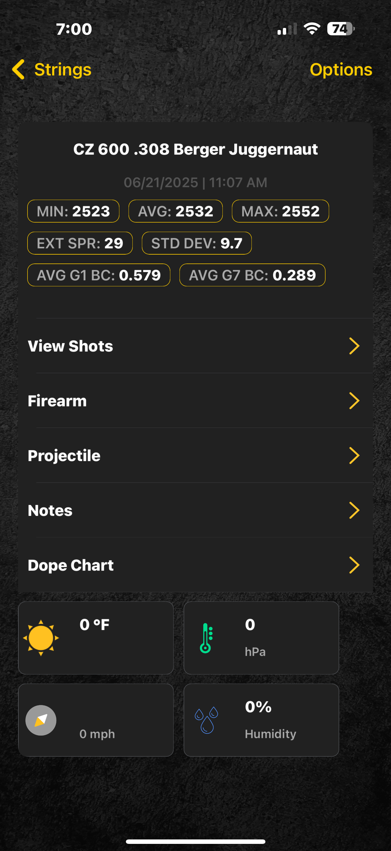

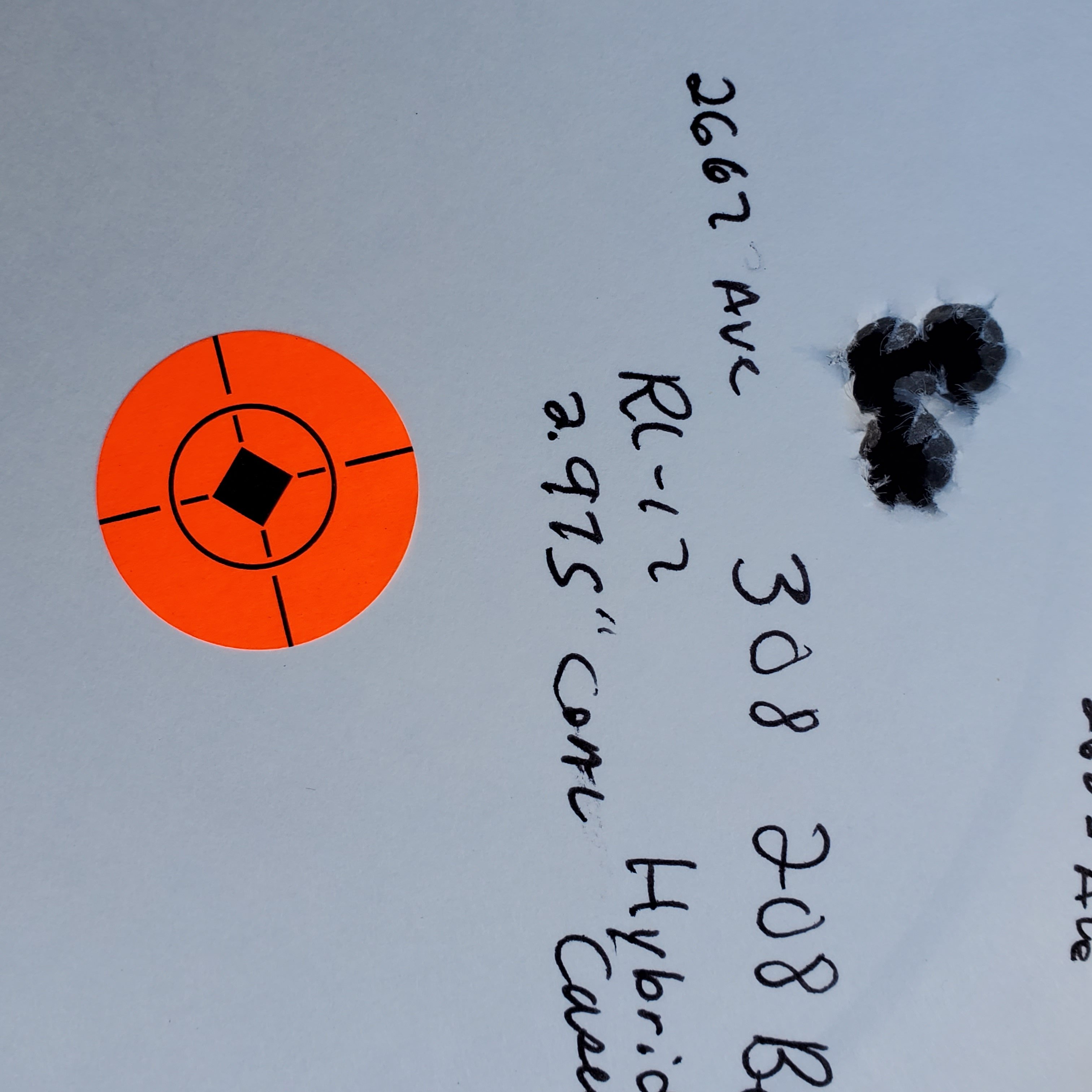

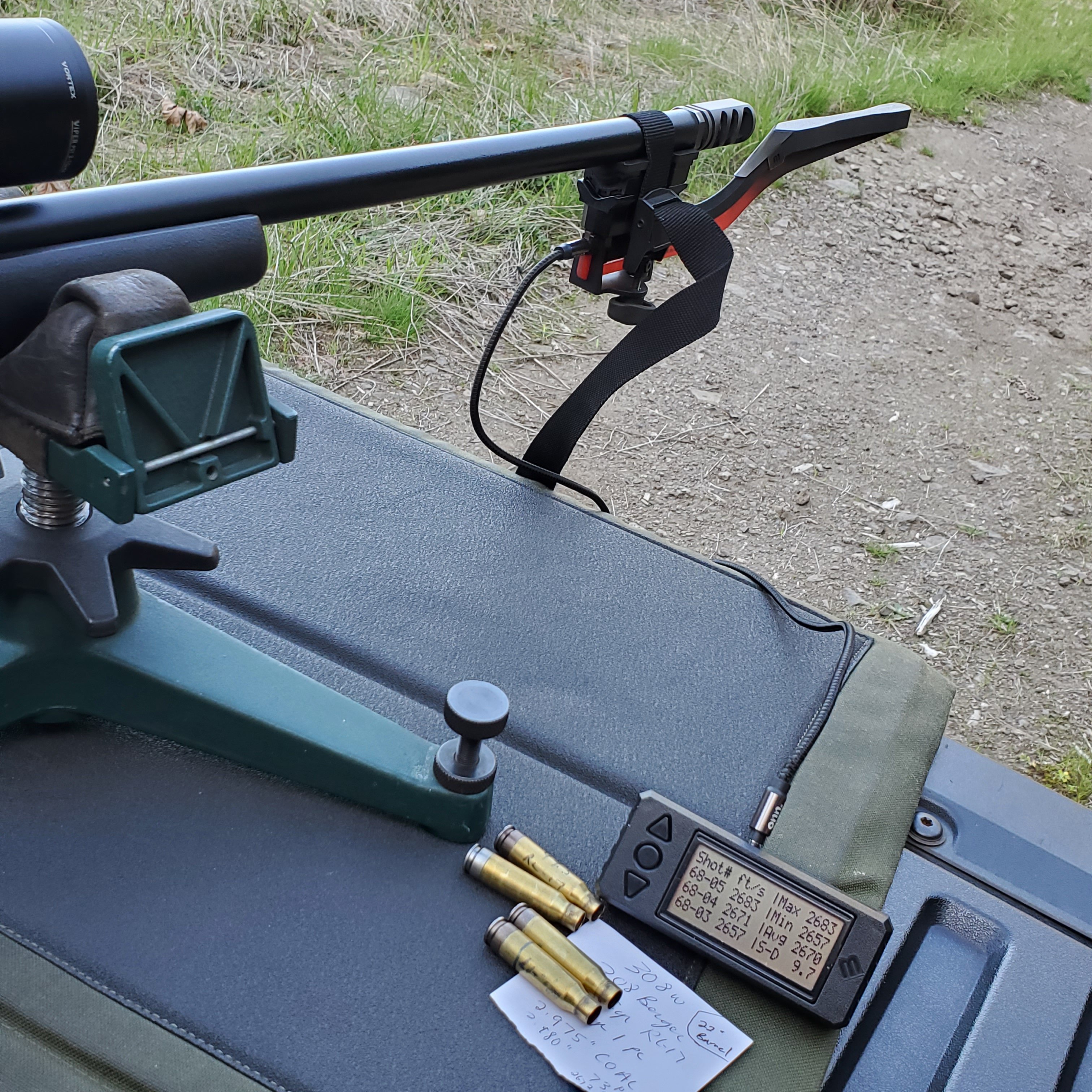

Ran some hybrid cases in 308 yesterday with 208 gr Berger in a Rem action 22" 9 twist varmint contour barrel. Loaded to detachable mag length.
Velocity was 2670 fps with good accuracy.

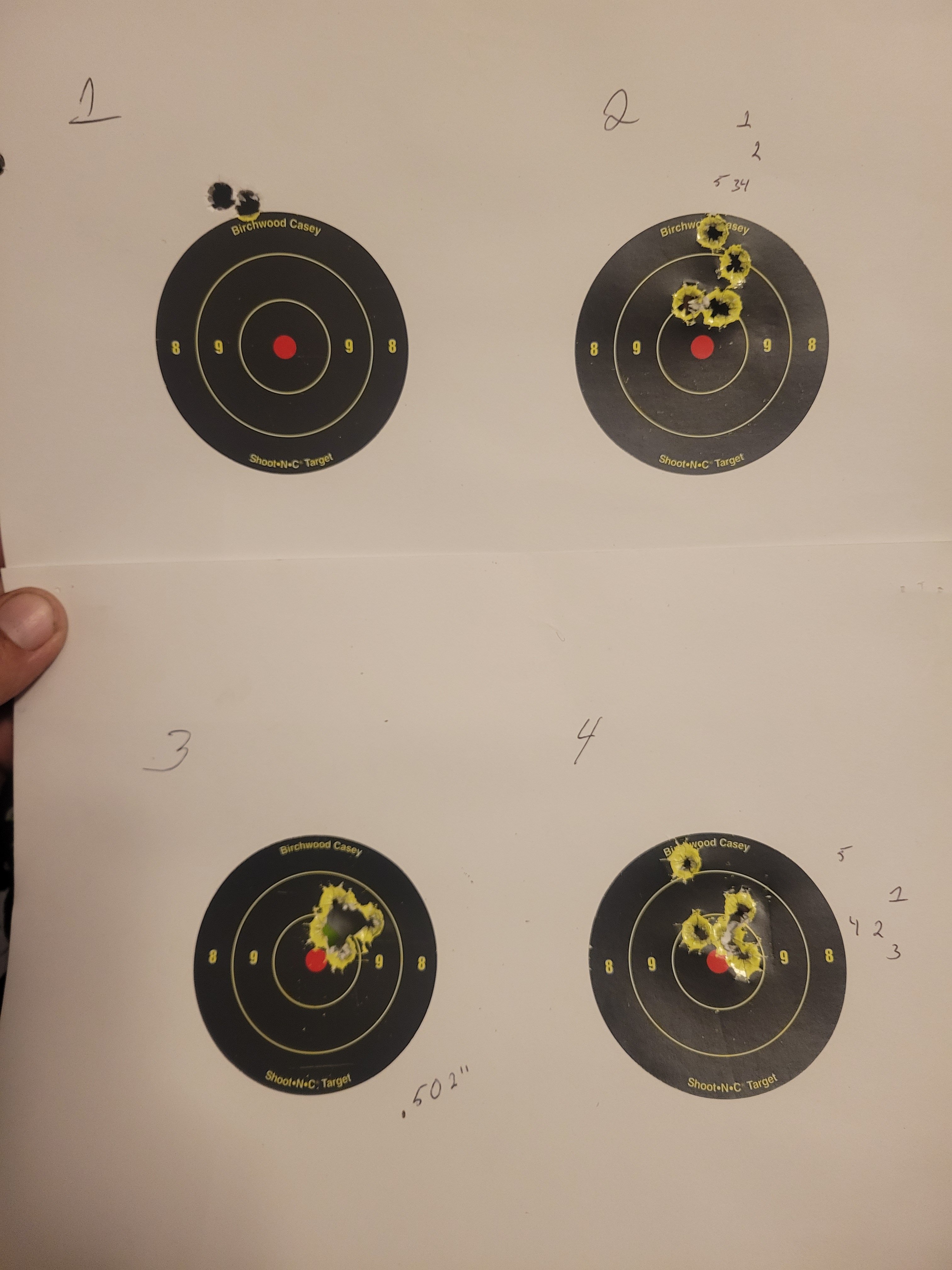

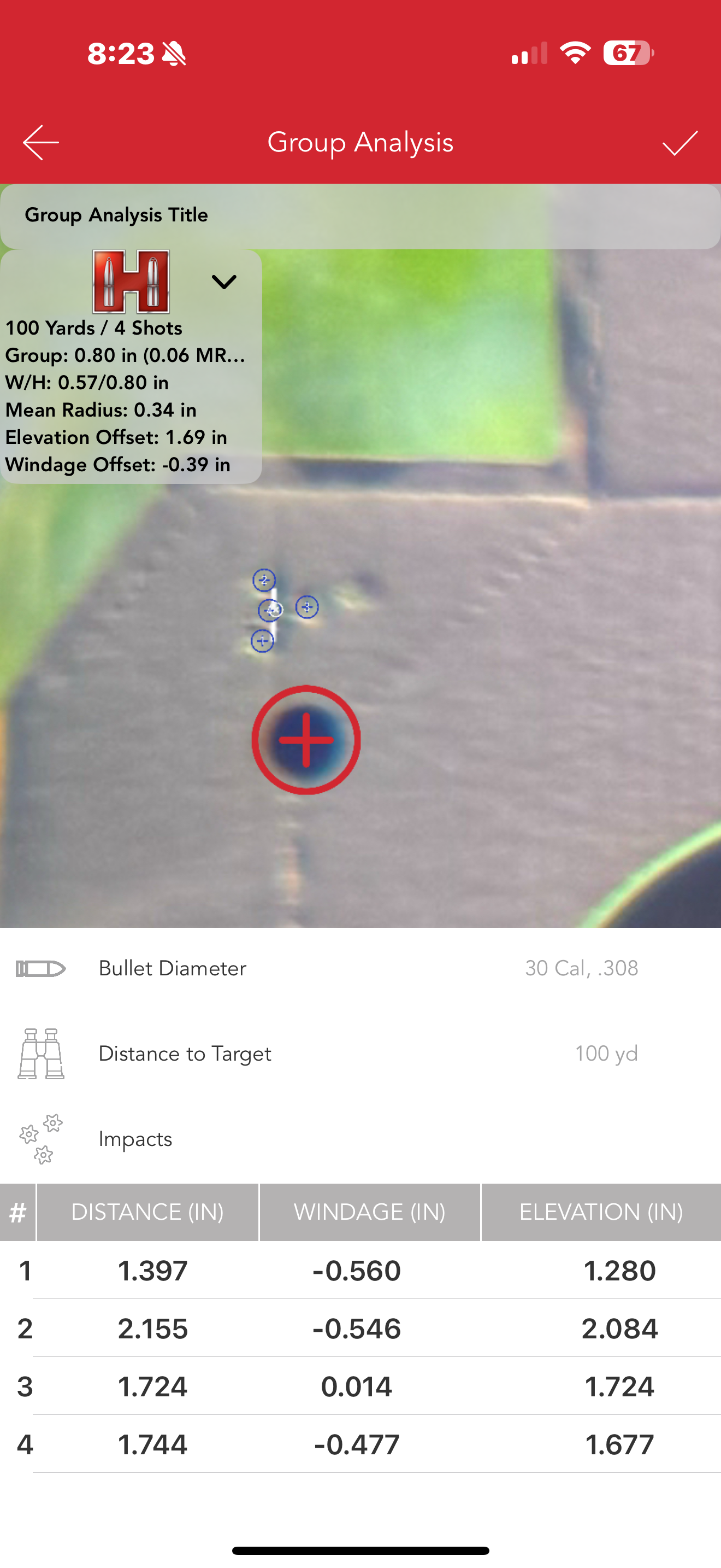

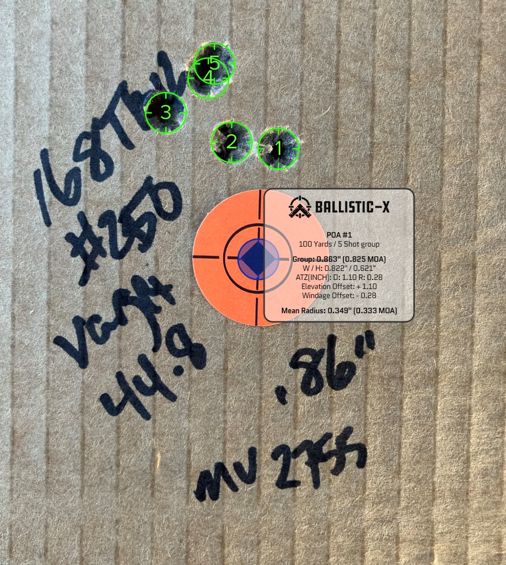

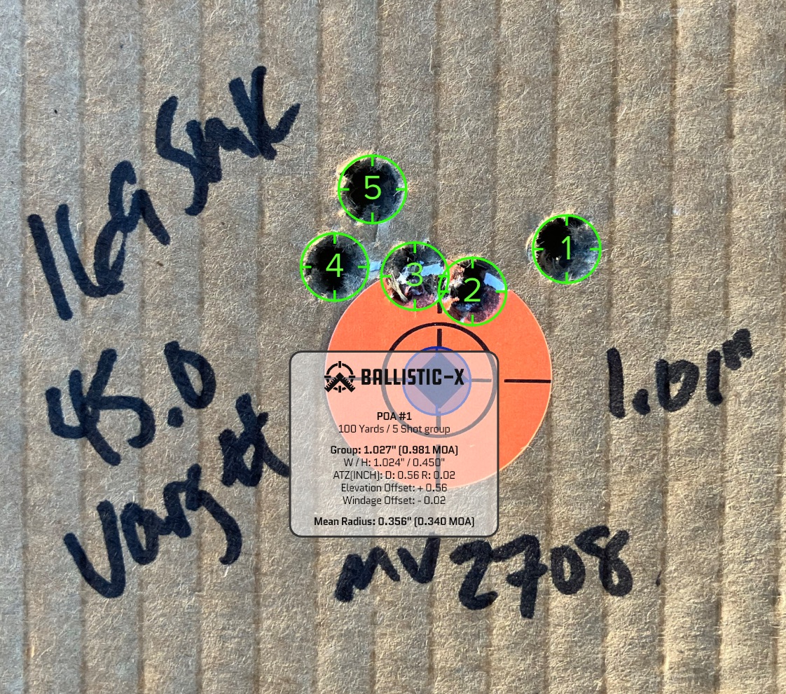

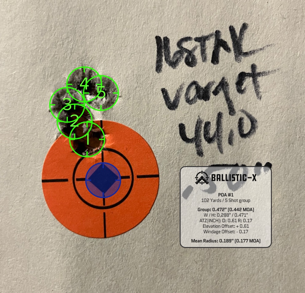

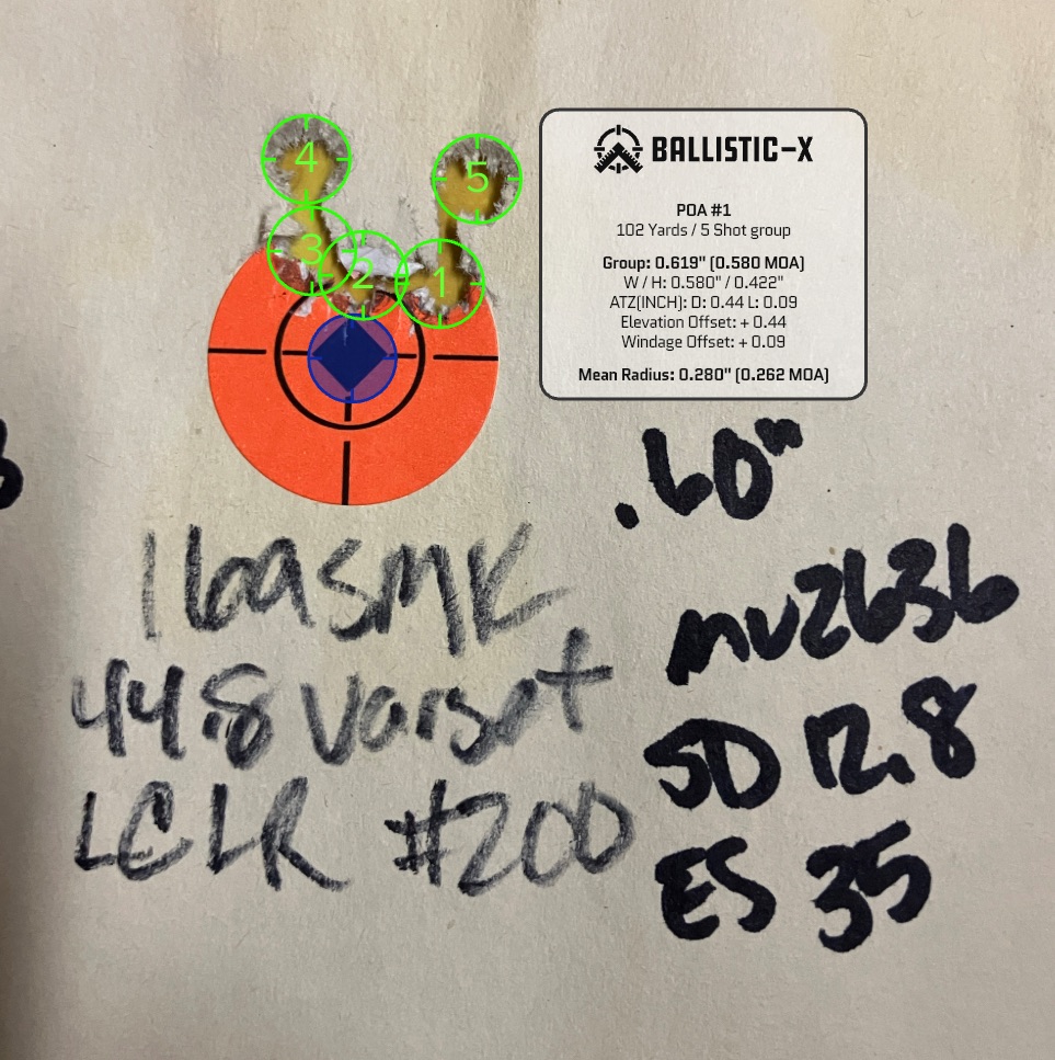

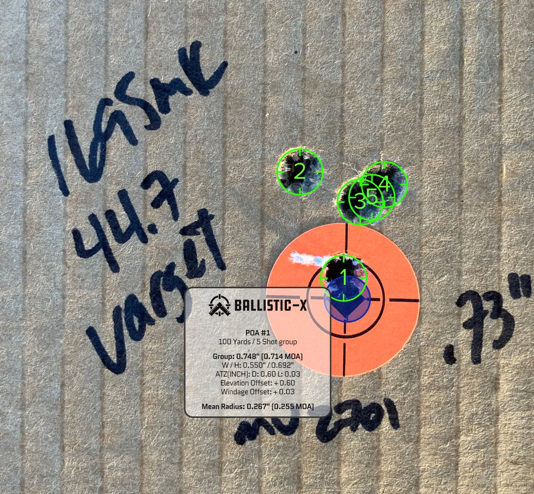

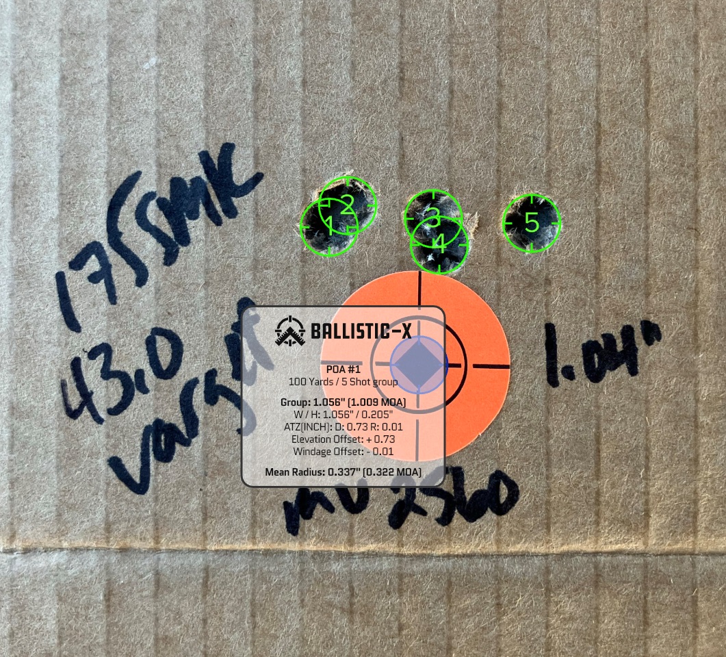

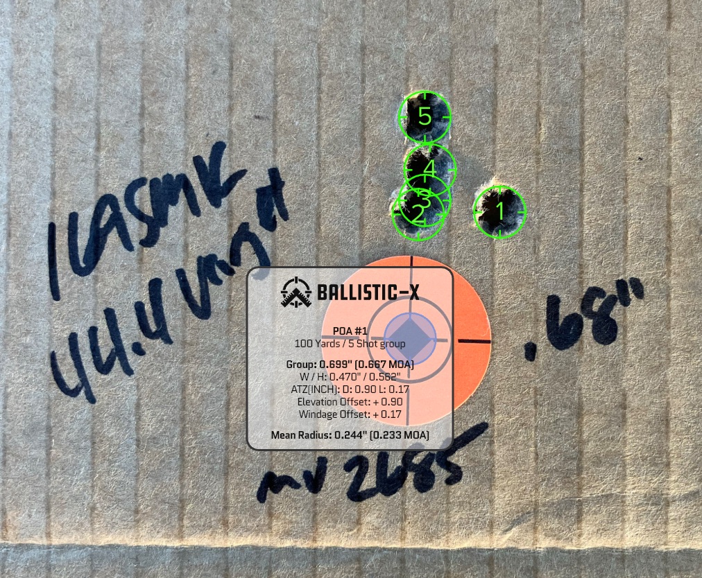

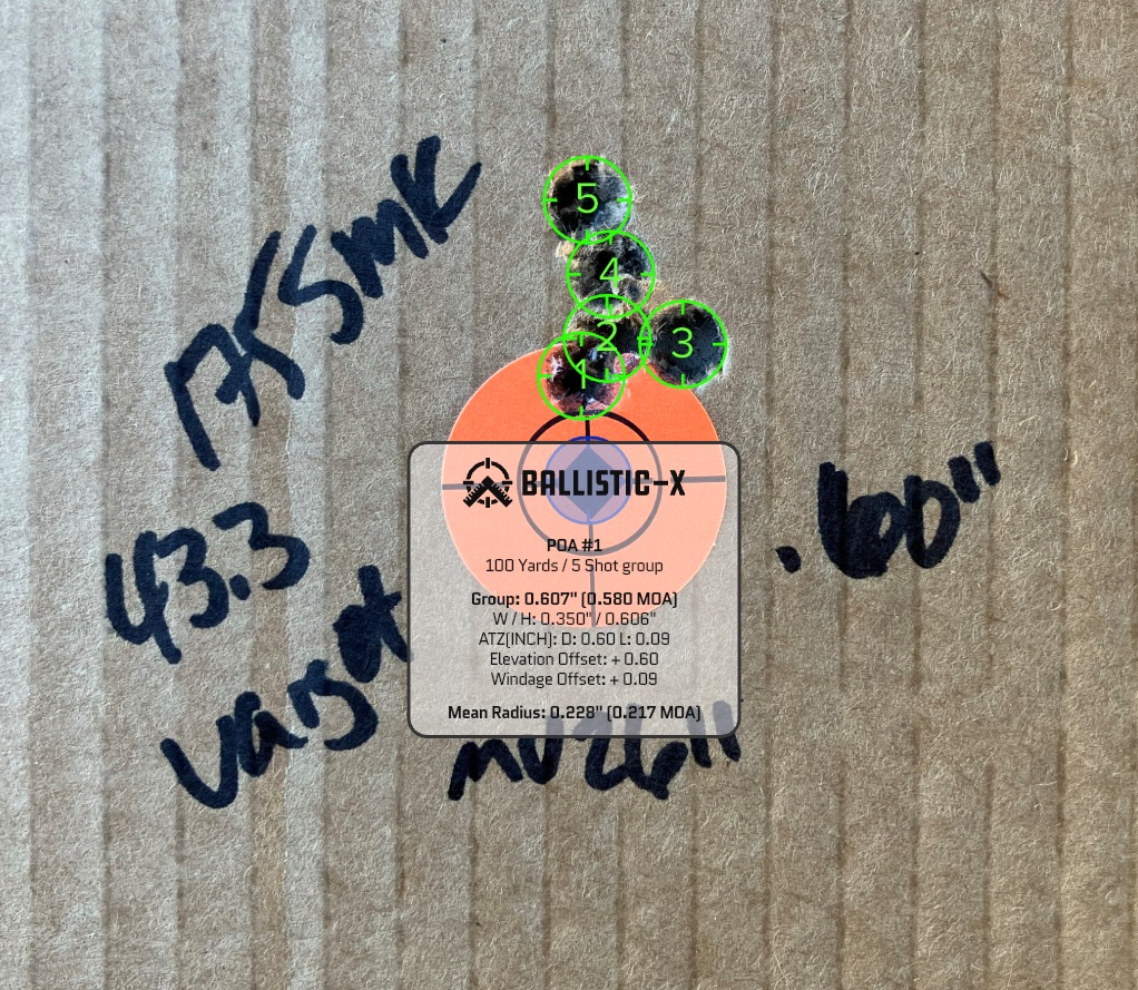

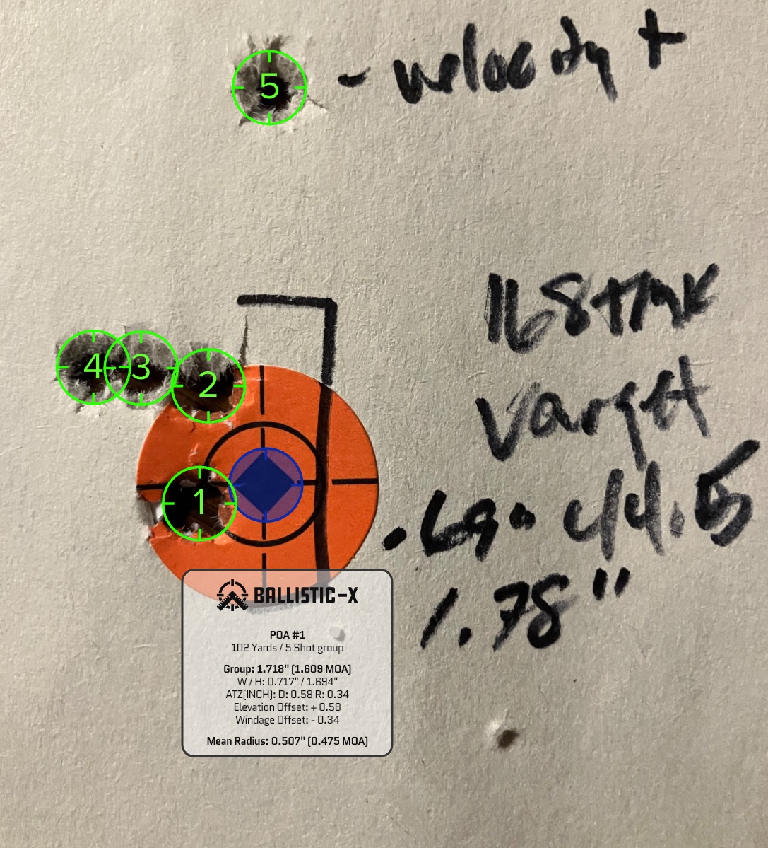

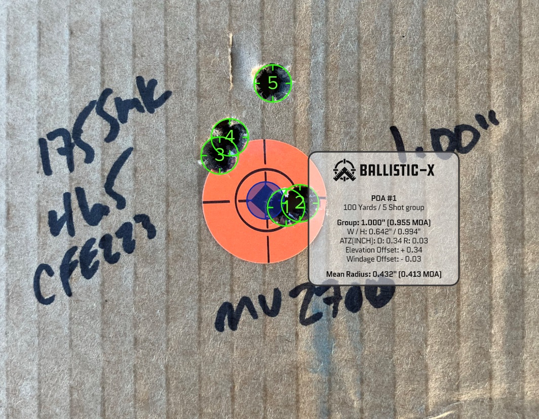

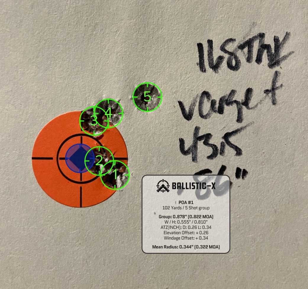

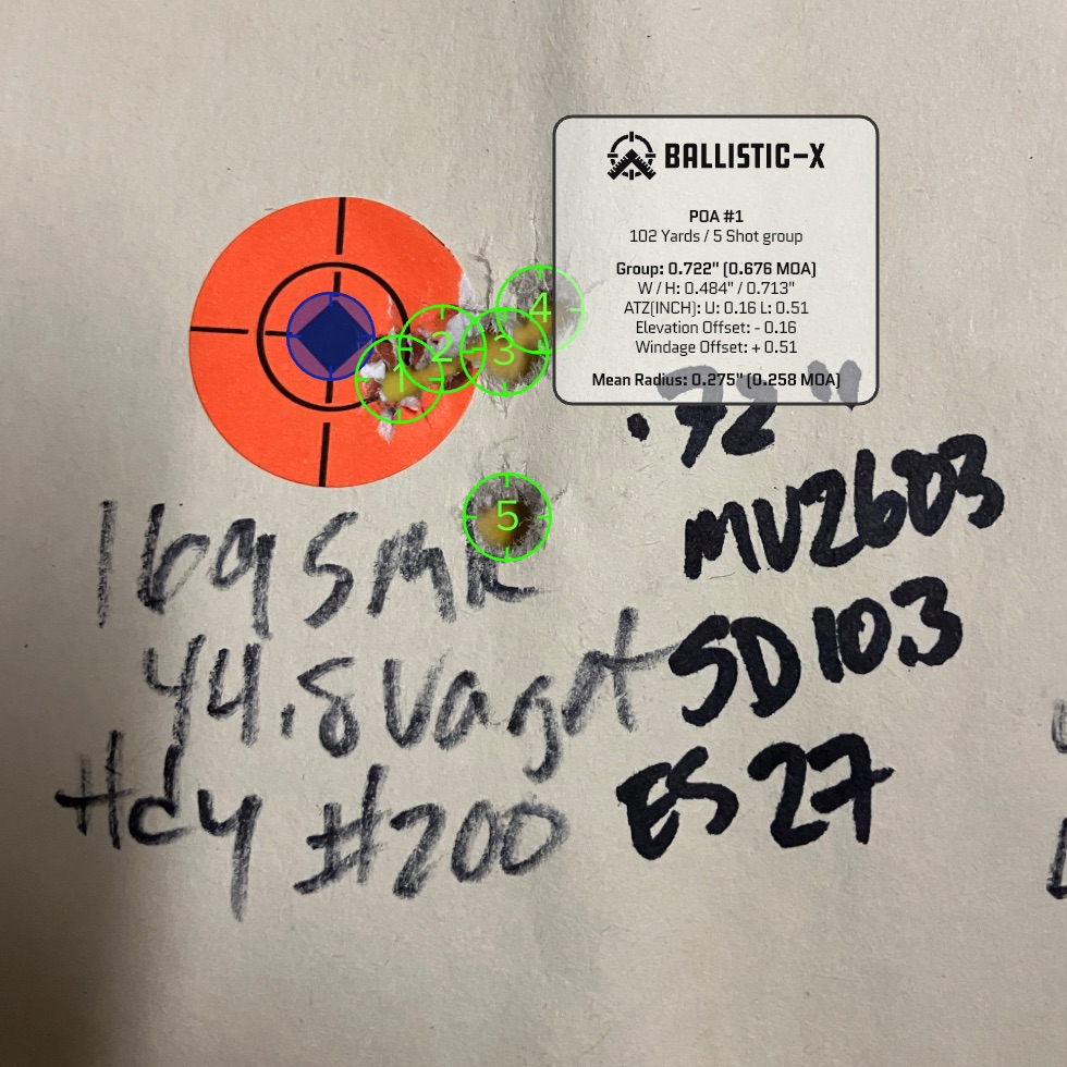

First rifle I’ve done load development for. B14 HMR, wearing a 5-25 Strike Eagle and Omega 300. I also did not know I had the ability to put groups out as small as some of these have been. Started with 168 ELDM and they suck in this gun. Bought 169 SMK, 175 SMK, and 168 TMK. Primary powder choices Varget and CFE223.
Think my final load is going to land around 44.8 gr Varget on the 169.

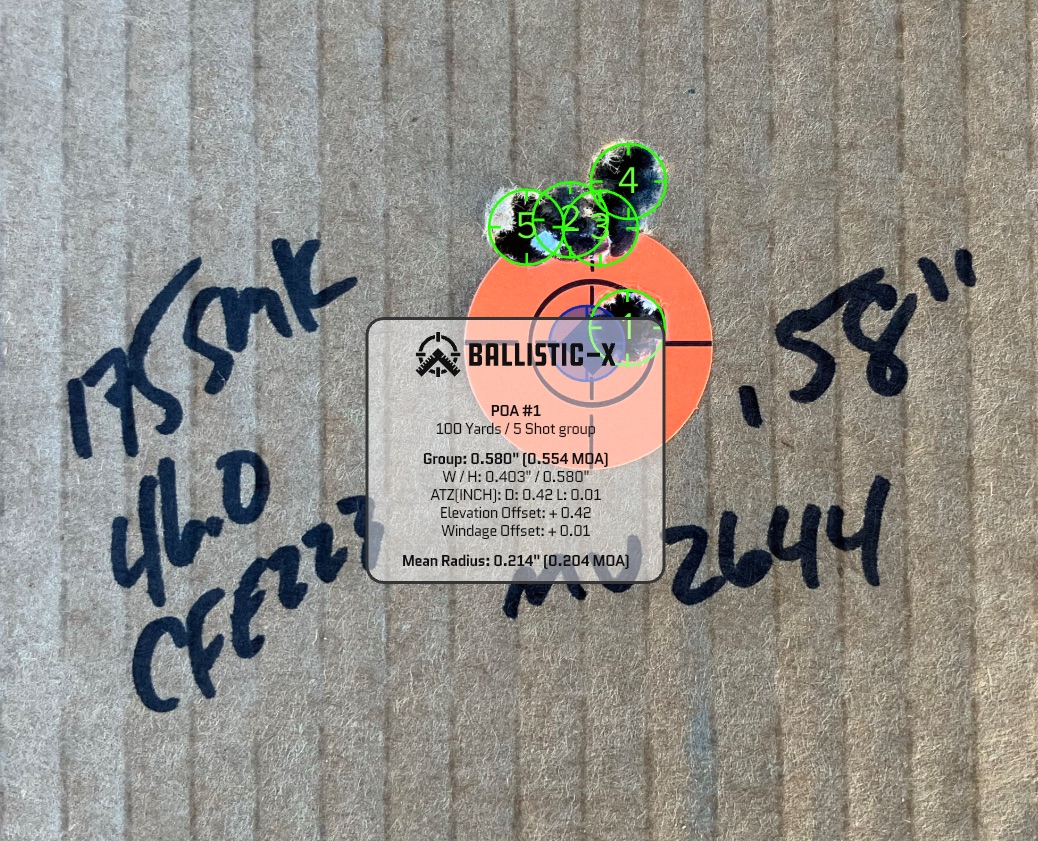

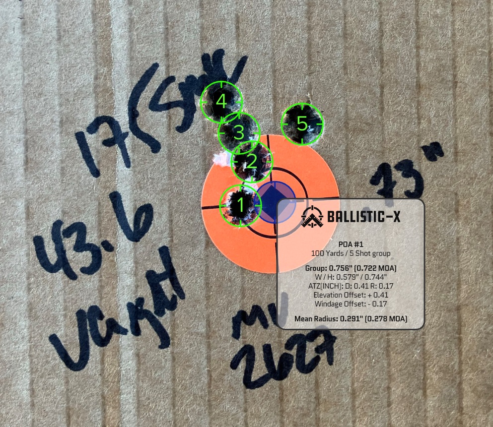

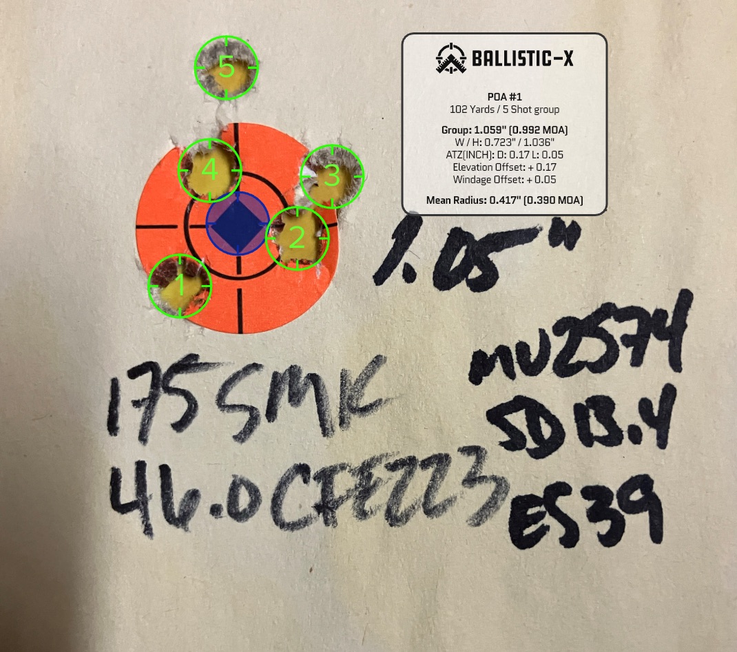

Think I’ll load up the last of the box of 175’s on 46.0 gr CFE223.
image_cropper_F85FF8E3-6A43-4A03-8C03-7E58797C7AA2-22494-0000034DEFBF2A46.jpegimage_cropper_21AC4940-C705-4A2B-95FA-B5551D2B83FD-22494-0000034E4C955223.jpegimage_cropper_B86460E7-B6E4-41DA-9F7D-41E1D36F3383-22494-0000034EBC29FBA6.jpegimage_cropper_BD352F46-1518-4AC6-8E90-ACCD78135E2A-22494-0000034F27A4EDC1.jpegimage_cropper_DA311437-57EA-4B75-942D-4B191B5F261C-22494-0000034F8A8EC2FD.jpeg

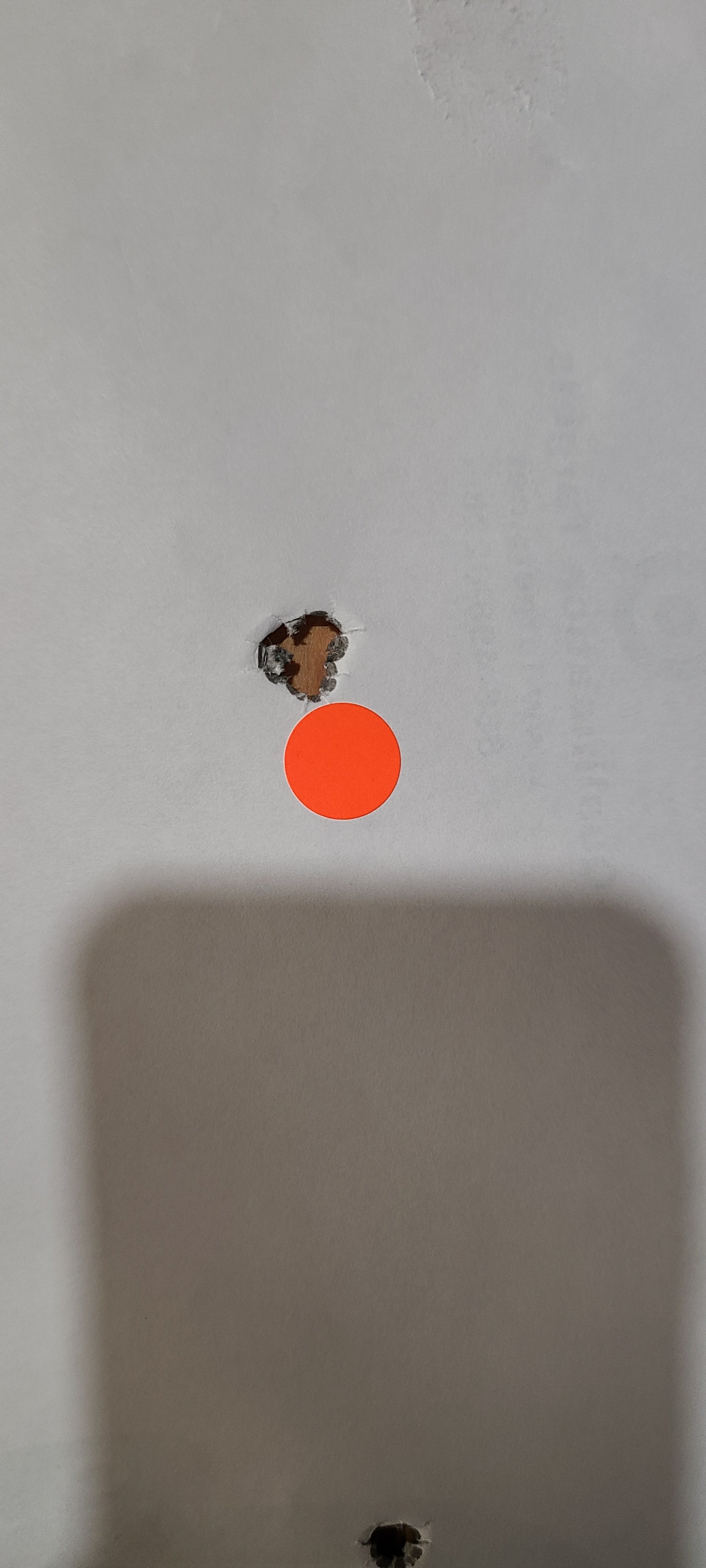

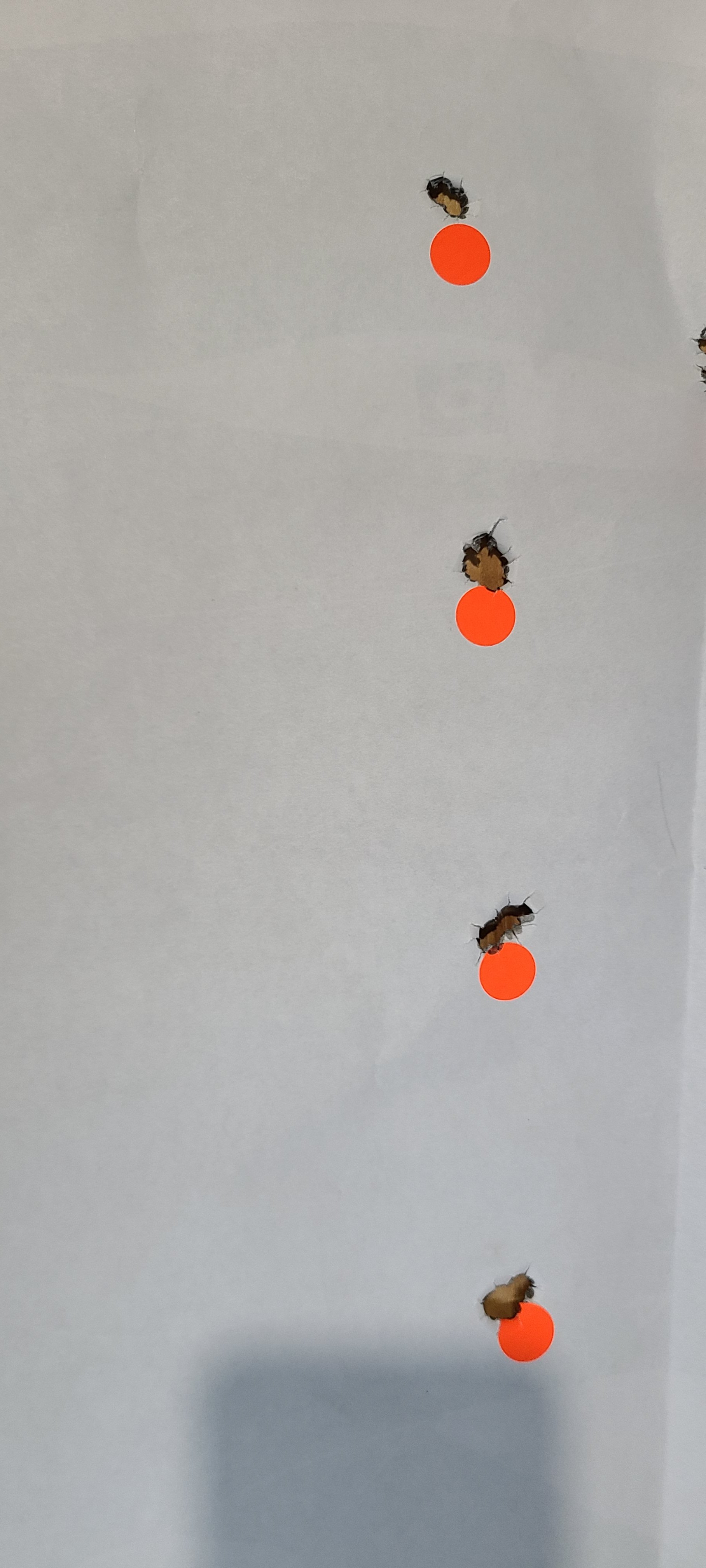

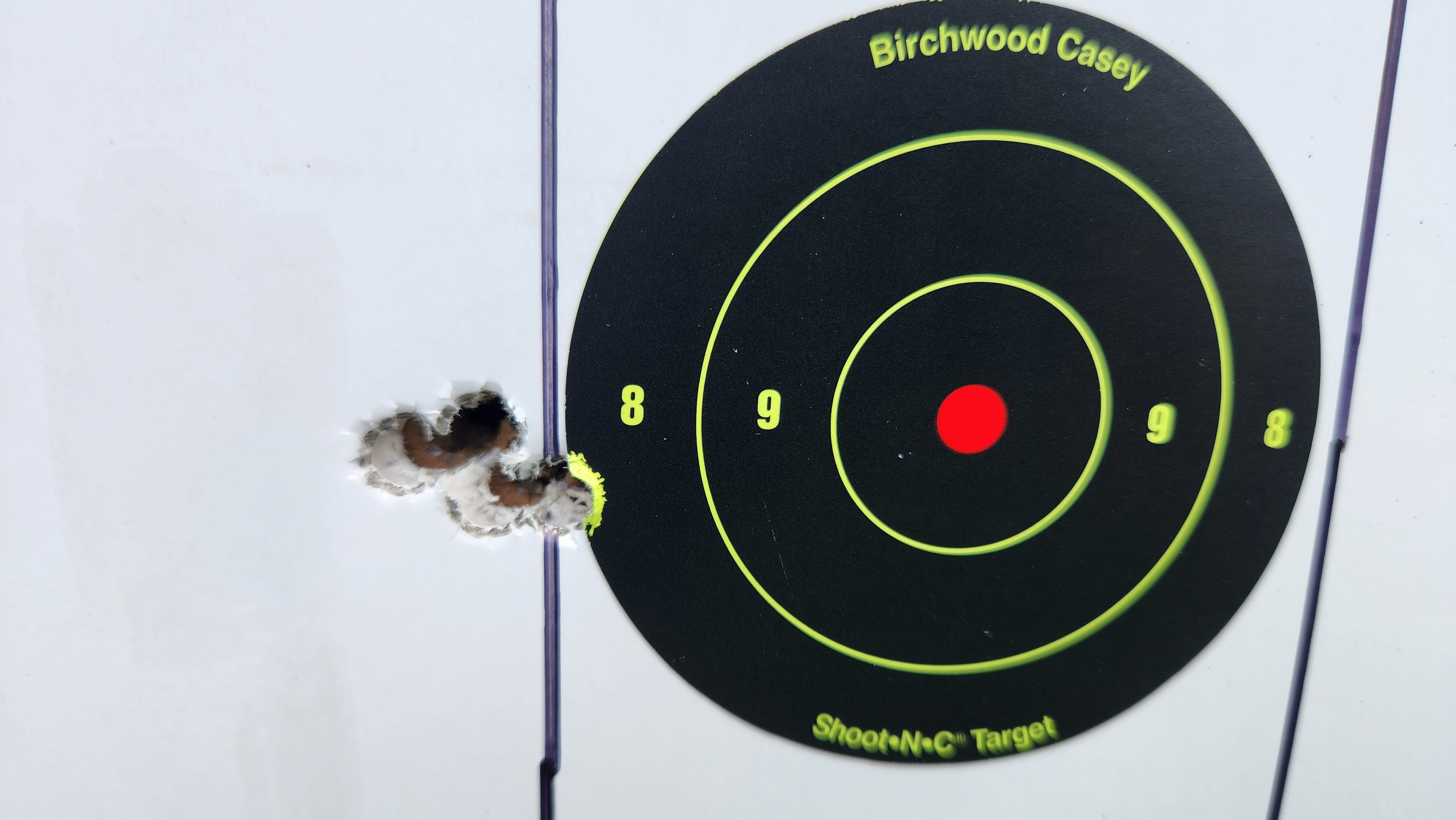

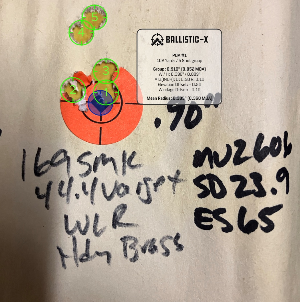

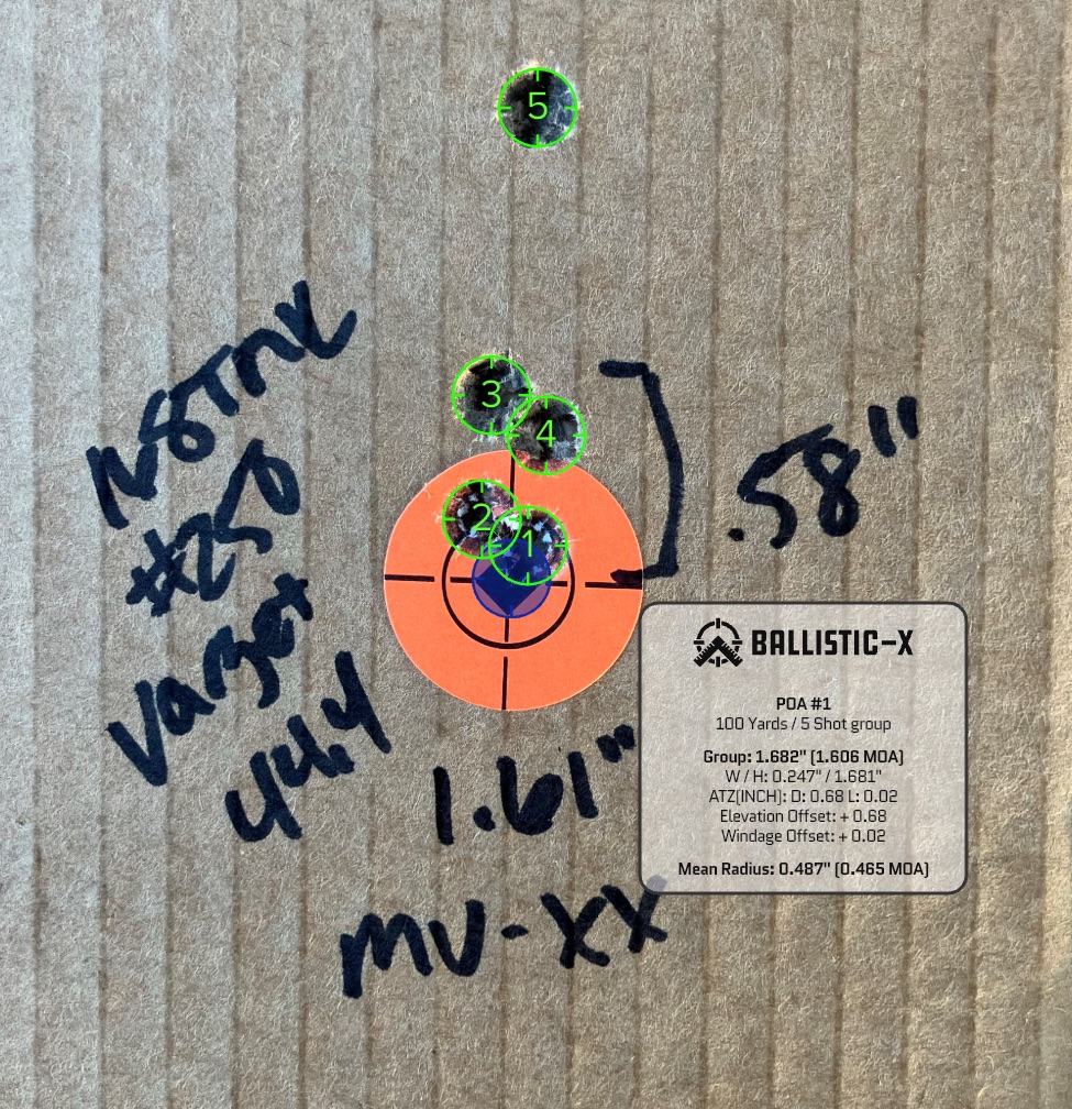

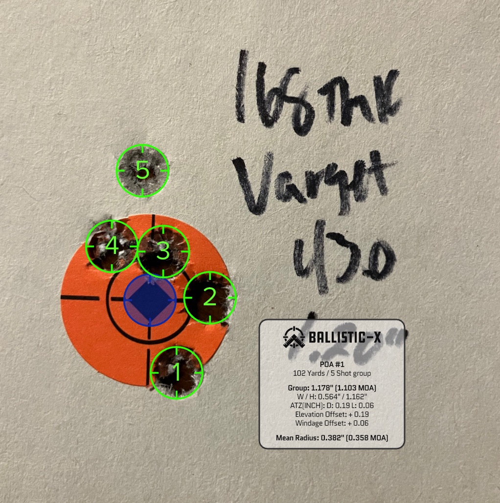

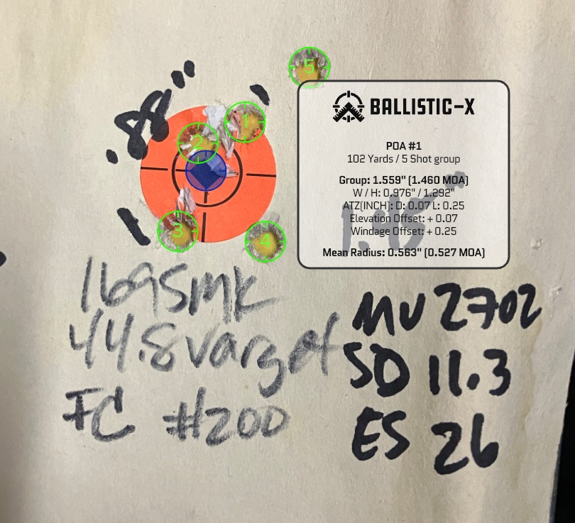

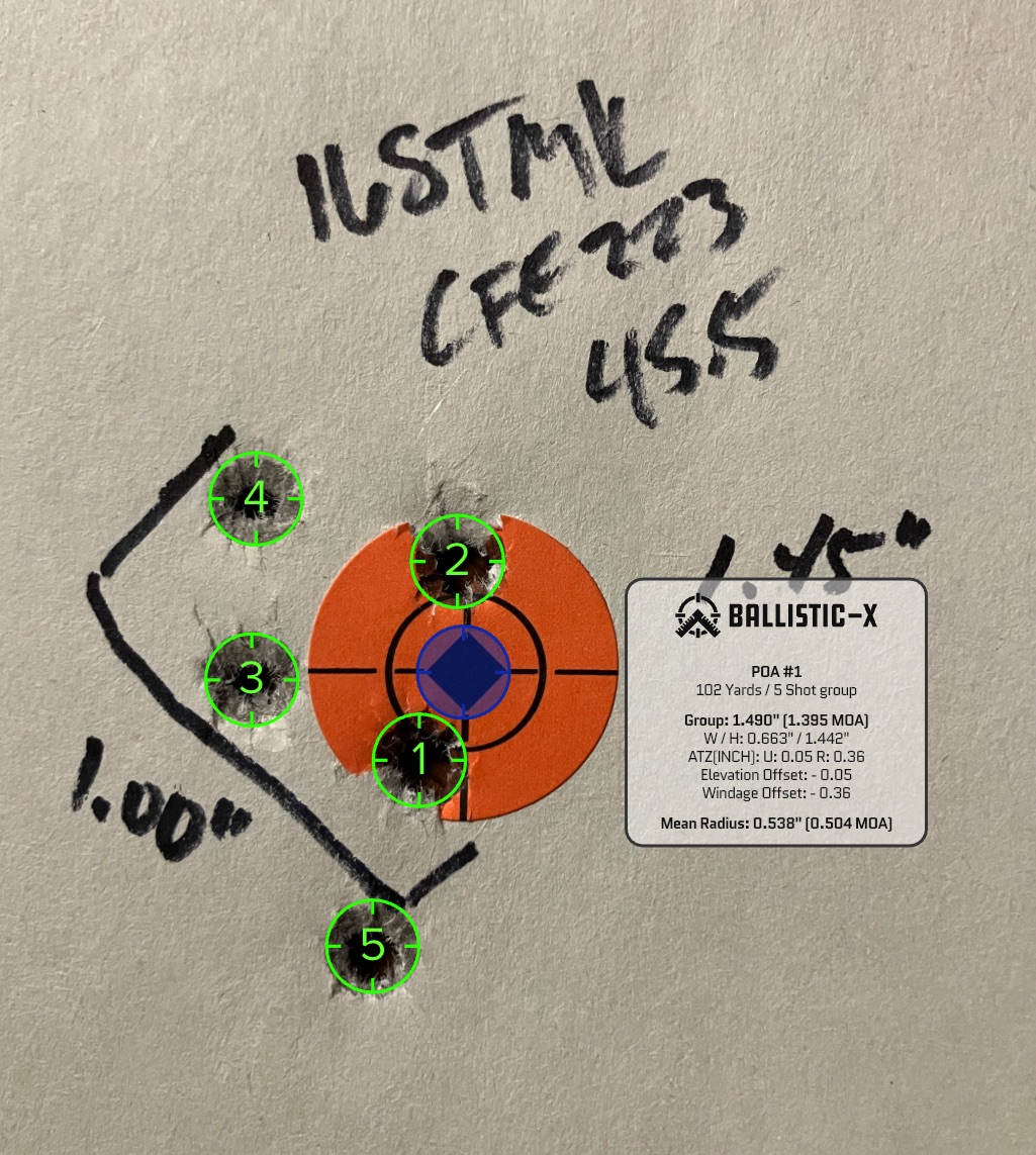

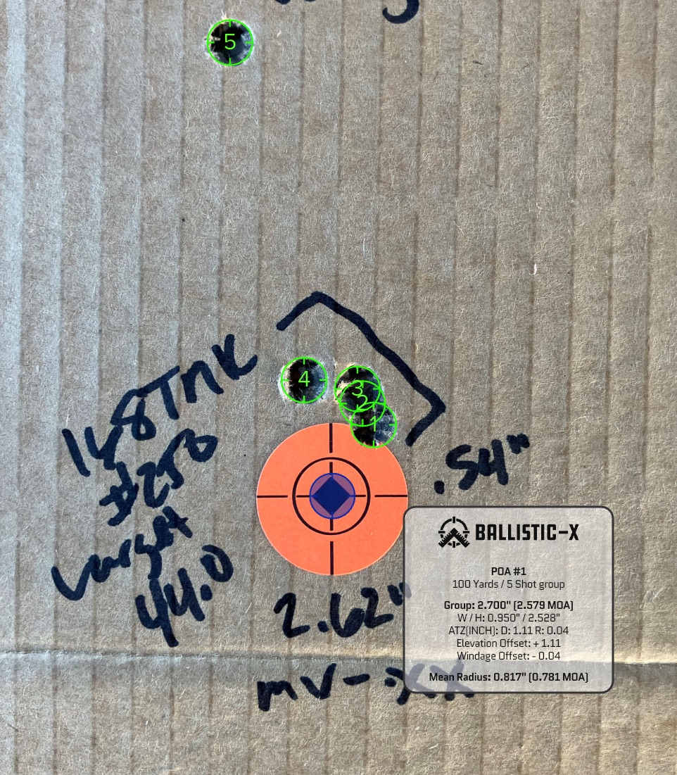

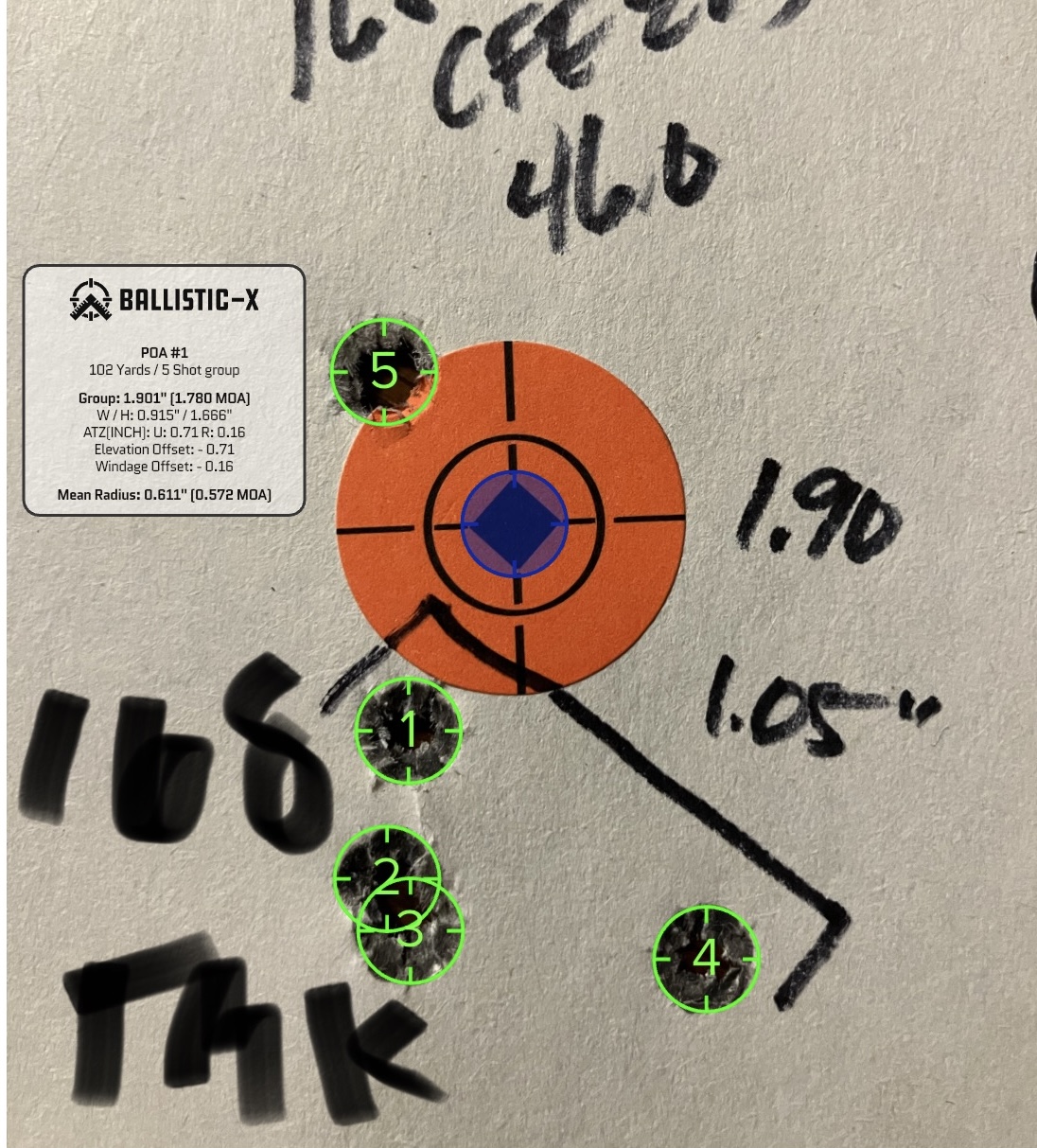

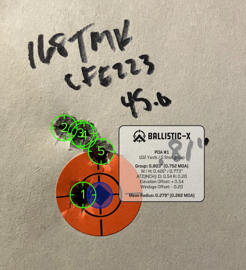

But can anyone explain this with the 168 TMK? It’s not the first strings I’ve had where some groups are great, and others are great with a single flier like these. Rifle loves the Fed T308T tipped load.
image_cropper_024AAA43-7B66-4C5D-9DAE-8EA7F97B5951-23603-00000379CE924EA7.jpegimage_cropper_A49A413D-EF78-49A5-B87B-989E08A961C7-23603-0000037A37ABFE19.jpeg
View attachment 8678798View attachment 8678799View attachment 8678800
View attachment 8678805View attachment 8678806View attachment 8678807View attachment 8678808View attachment 8678809
View attachment 8678811View attachment 8678812
As someone who's use all these components and looking at where the center of the Mean Radius is,
I'd suggest rest your 169 SMK's with 44.7 to 45.0 grs of Varget. The loads for those two targets look like they have the most potential. Also, the velocity you're getting for those two loads is right at where my particular gun (with 26" barrel) performs very well. . . though with a different powder (AR-Comp).
I believe my final load will land somewhere in that charge range for the 169, though when I have to switch brass is might go down a bit because the Hornady brass I’ve been loading has a significantly higher capacity than anything else I’ve got.

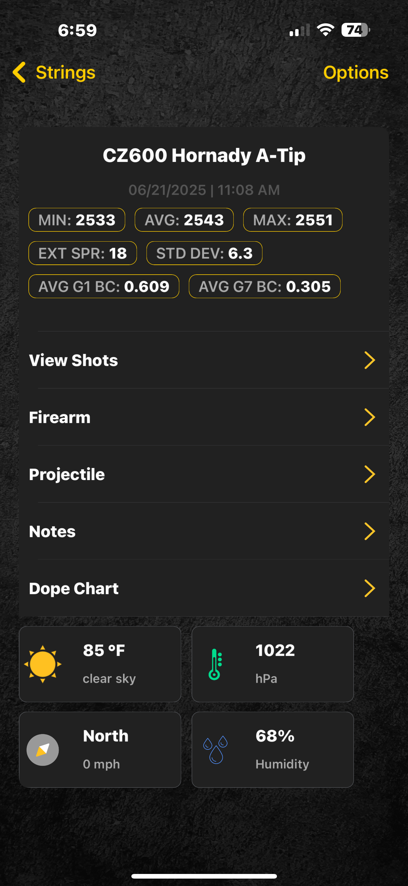

I’m suspicious that the Caldwell chrono I have now reads a bit high over the ProChrono I used to have.

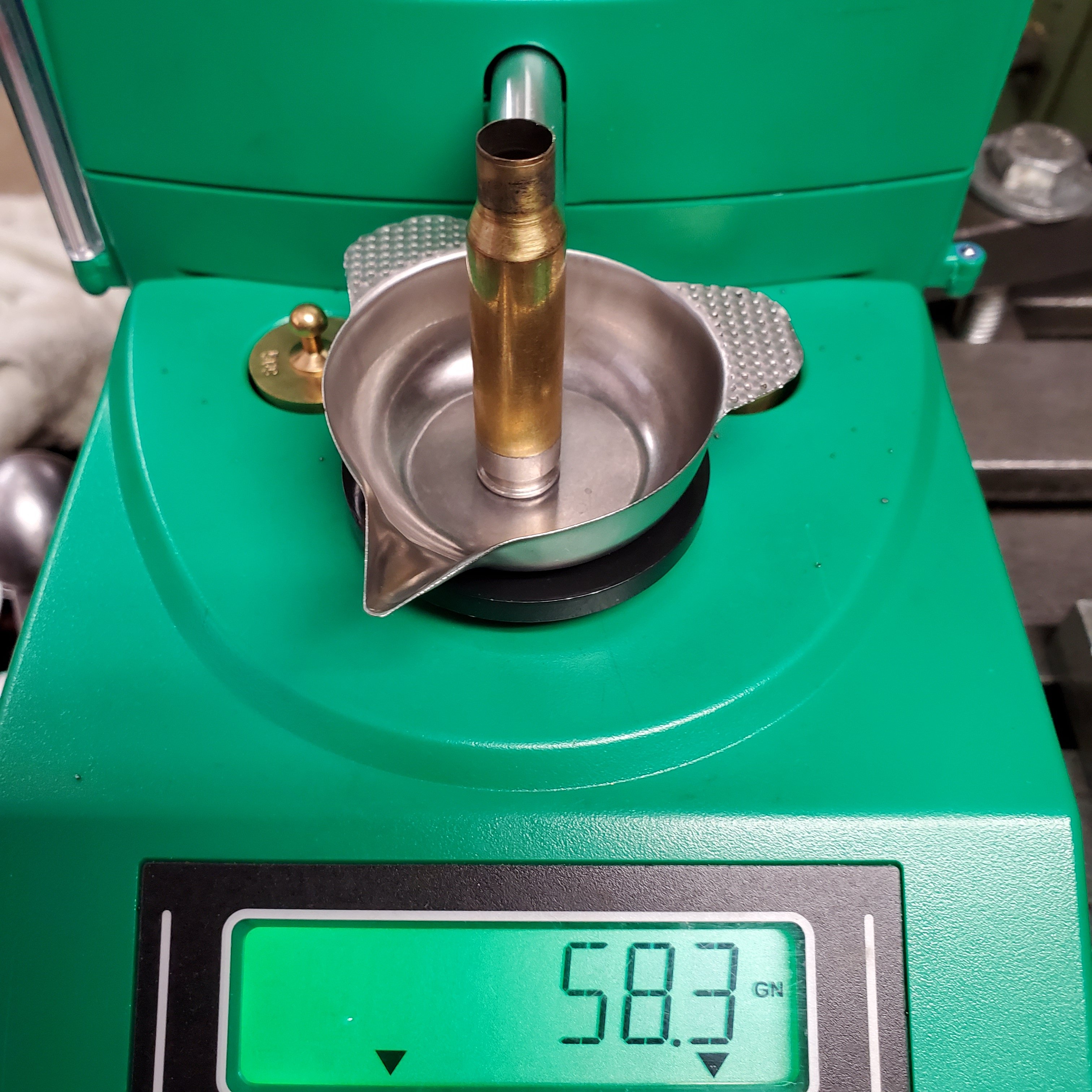

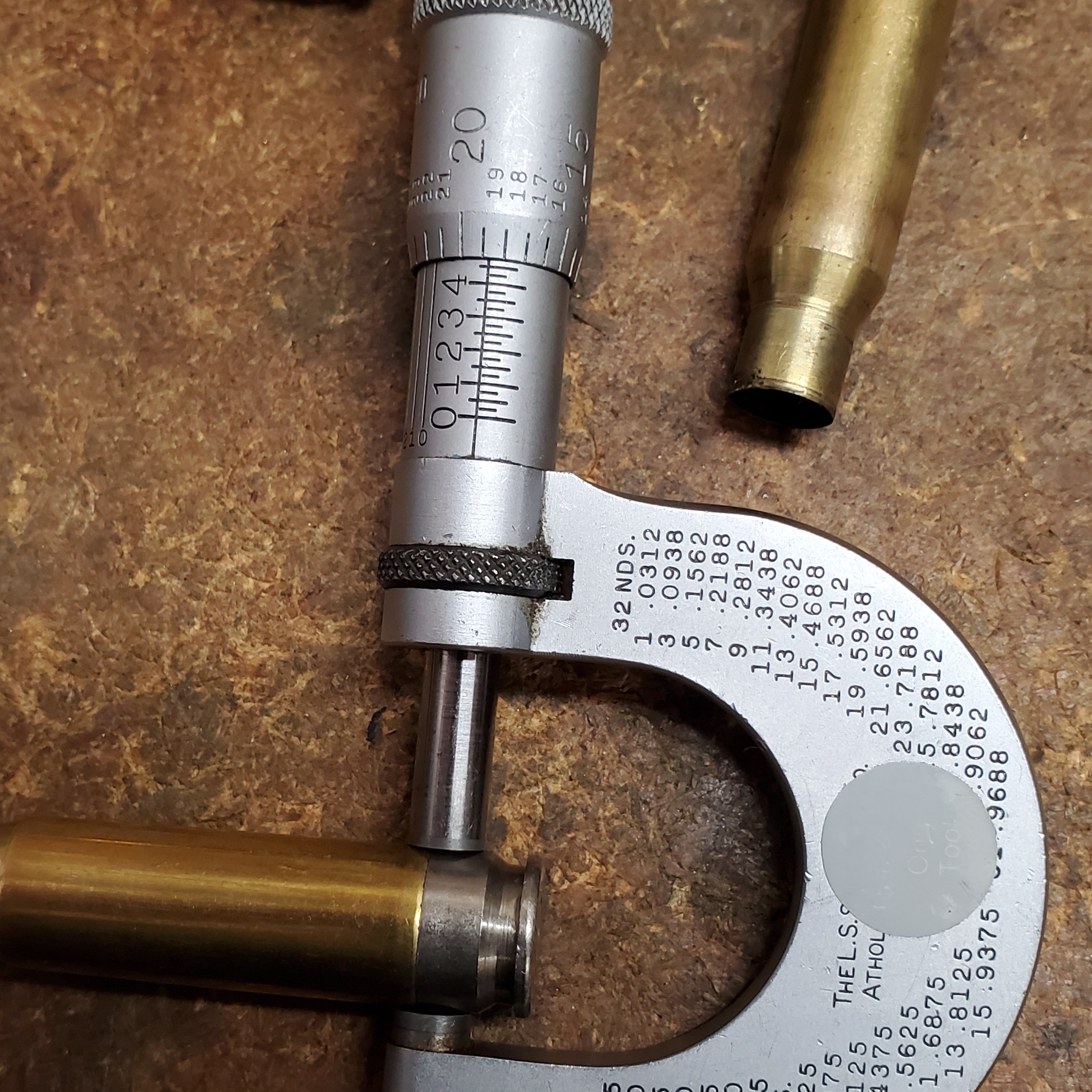

Which brass of yours has less capacity? LC brass? How much less?
My data I've recorded for my Varget powder, though a little dated now, shows velocity a little higher than what you're getting with 44.7 grs. as measured by a MagnetoSpeed (that's with 169 SMK's at a COAL of 2.903). So your Caldwell may not be off as much as you think???
LC, Federal, and Armscor were all similar at high 54 - low 55 gr water capacity. Hornady was almost 58 gr. I started in Armscor with Hornady bullets, got pissed at the results, and switched to Sierra bullets in Hornady brass. I did load a group of 169’s on 44.4 of Varget in 5x fired Armscor brass. MV was 2711 versus 2685 in Hornady, and a .94 MOA group.
I had a ProChrono before, and I believe a lot of pistol and 5.56 loads ran hotter with the Caldwell than my old one. Remember this is a 20” barrel.
Hmmm??? Interesting that your Hornady brass is at almost 58 grs H2O. Most of mine (though I almost never use my Hornady brass) is at 55 grs.

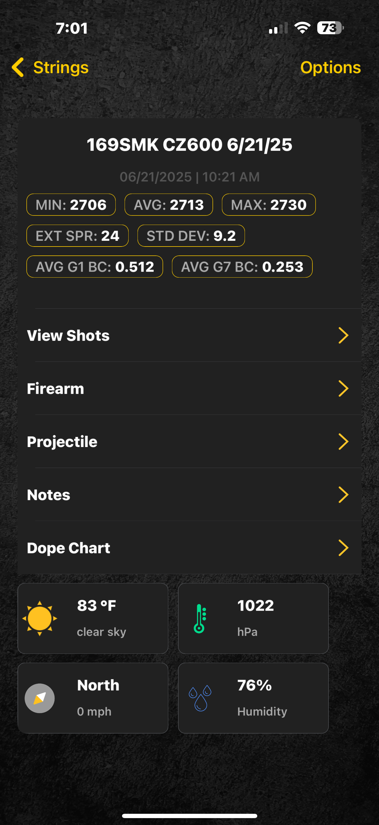

That’s what I’m saying. My 47.0 gr of CFE223 read 2819. Sierra’s data is 2800 with a 24”.
All the Hornady brass I have is from 2007 or maybe 2013. It is super light at ~155 gr. All my other brass is in that ~55 gr water capacity and weighs 177-185 gr without paperwork in front of me. I just weighed the Black Hills I have, and it’s just over 57 gr capacity and weighed 162-163 gr.

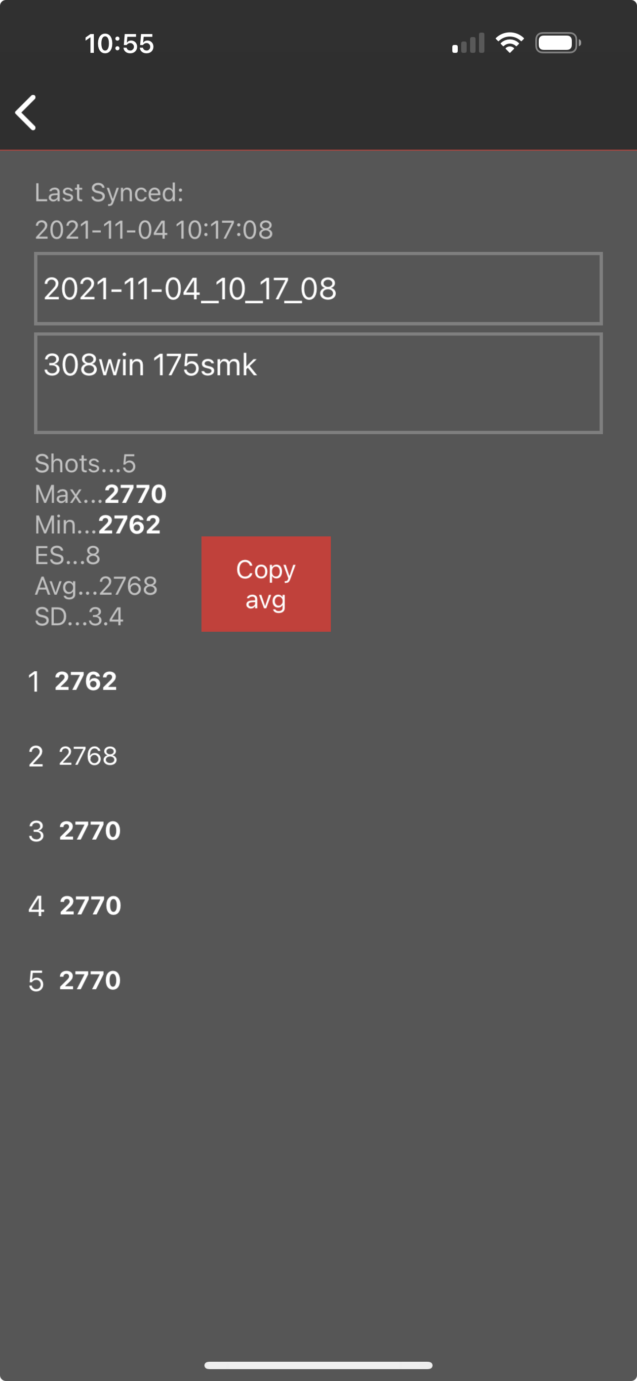

175 hornady Aeromatch, lapua brass, Win LR, 45gr of varget, seated at 2.800"
It maintained a solid .5 moa out to 600.

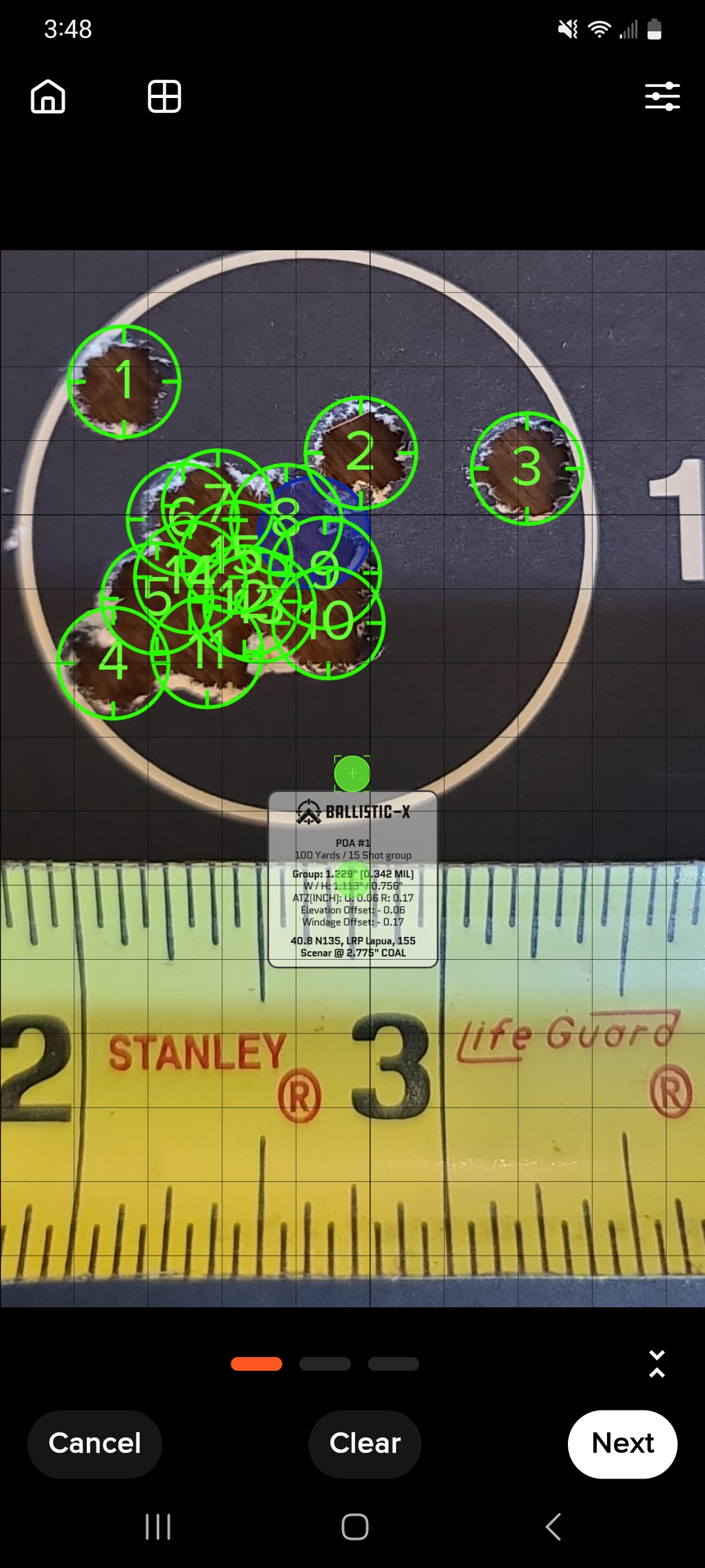

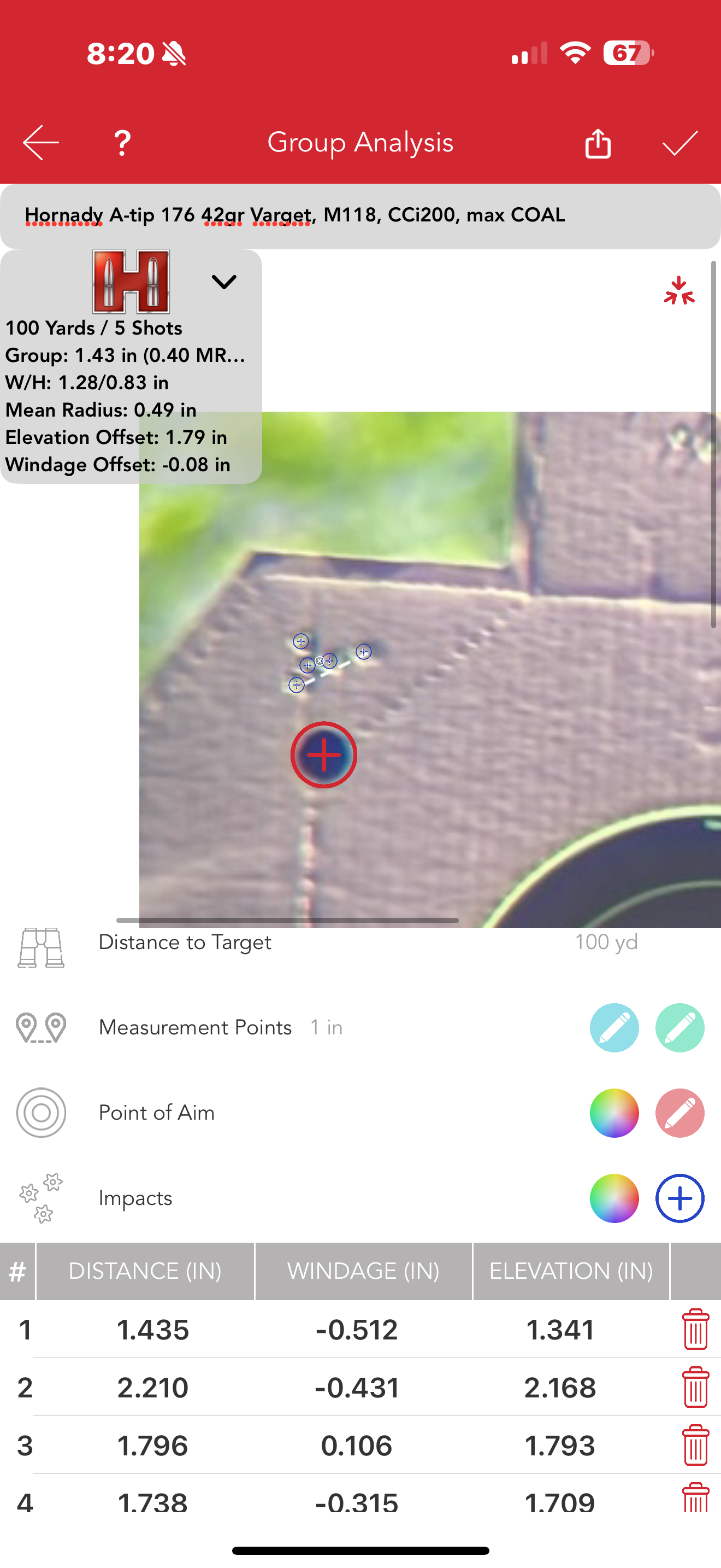

Doing some load development on the 178ELD-M on my AIAT in preparation of 1000 yard qualification.
IMR 4064, Seating to 2.805". Doing a 10-round group at 100 yard.
From bottom left to right- 43.5gr, 42.5gr, 43gr
Top is 44.5gr

BTW: that's a lot of velocity for a 20" barrel using Varget behind a 169 gr bullet. :eek: I only came close to that using Pro 2000MR out of 20" barrel with 168 SMK's.
With a 20" barrel best groups should be around 2500-2550 fps with the 168 and 169 and probably about 2475 to 2520 fps with the 175 with target. I agree on the 2000MR comment and it was a crappy powder to shoot. Way too slow for the 20" barrel. I was in the 2650 range with it if I remember correctly.
If you are talking about the 44.4 gr Varget 168 shot then that looks to be shooter induced.
I just got a different chrono, plan for this week is to see about comparing velocities. Even my lower end 42.0 gr charge of Varget with 175’s was about 2490 according to the Caldwell.
As far as the 168 TMK, it produced mediocre but consistent groups with CFE223, which is as the 169 as well, but Varget had good geoups, sans significant fliers. Either way, I’m not worried about it. Both the 169 and 175 have given beyond adequate results, and at a better price, so I see no need to further chase it.

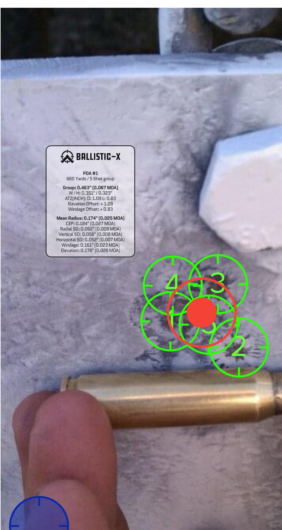

  • Ballistic-X-Export-2025-04-24 22:37:42.910663.jpeg

Went out last week and fire formed 10 hybrid .308 cases with case volume of 56.3 grs H2O and loaded them with 41.7 grs IMR-4064 behind 190 SMK's using the same primers that I removed from them and seated the primers to the same depth as they were originally. Though this was only to fire form them to I could measure their case volume after firing, the chrono data was remarkably good. SD for the 10 shots was 4.7 and the ES was 15 with MV at 2,560 fps from 26" barrel. Group size was surprisingly good too at .552 MOA.
Sorted through my 4 remaining boxes to see how many of the different head stamps there are and found 4 different headstamps (stamps were like "24", "23" "Sig" and "277 Fury"), each having different case weights. The cases I loaded above were the 24's and the heaviest of them all and was with majority of them all. The 23's were very close to the same, just a little lighter. Those with the "277" Furry stamp were all much lighter and I expect a substantial increase in case volume and since there was about 75 of them, I processed them into a .308 case and loaded some up to fire to form next using the same powder (10 with 190 SMK's and 10 with 168 SMK's). Will see how they compare. :giggle:
Got me one of the Athlon chronos. Shot some stuff that’s more or less final loads. Found it interesting what velocity was doing, especially the FC brass. Been loading everything to 2.81”, more or less, 2.150” base to ogive on my comparator with 169’s.
image_cropper_F5E5E04F-F7A8-4CE4-ADD7-177A29092D5E-65951-00000A02300ABC93.jpegimage_cropper_1FDE4A51-4C51-4A2B-B27B-4CF1E6A14B49-65951-00000A02971C00E6.jpegimage_cropper_61FA2452-4C1E-4B82-B659-D3973FA2D385-65951-00000A02FE1C502E.jpegimage_cropper_2DEC01D0-B704-4077-A112-2F5E5A541377-65951-00000A0364C0BE2A.jpegimage_cropper_757D44EE-9241-432E-8A18-9B928E21850E-65951-00000A042554B8A7.jpeg
Reactions: ubet
I have one I'm pretty pleased with. Earlier this year I had Moon @ Crescent Customs make me up a new Bartlein M24 contour barrel for the Archimedes/Xylo I have. I managed this yesterday before the rains returned.
15 rounds at 100 yards. I have enough info now I can move it out some. Most I can shoot is 600 at my range.

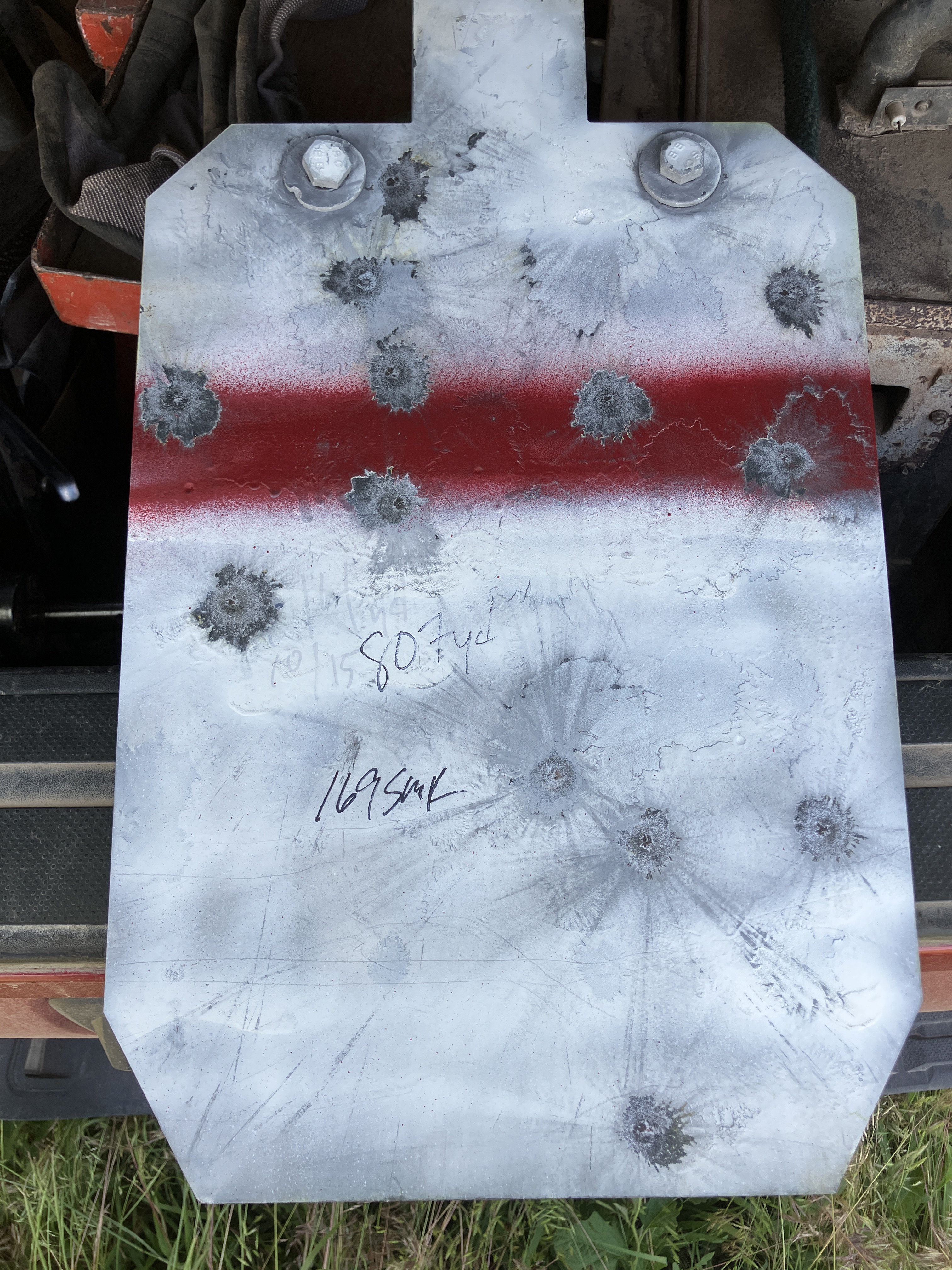

Had great conditions yesterday, 807 yards. I just don’t enjoy shooting over the hood of my pickup, but the grass is tall. I count 13 impacts of 18 rounds.
169 SMK, 44.8 gr Varget, CCI 200
FC brass, MV 2710, SD 6.9 4/5 hits
Hornady brass - MV 2610, SD 18.5, 2/5 hits
LC LR 04, MV 2645, SD 5.2, 7/8 hits.

Shooting some 308 hybrid cases, testing a different powder RL 17 with the 200 gr SMK.
So 200 gr SMK, MDT mag length cartridges at 2722 fps...
Dangerous....do not use in regular brass cases!
For fireformed hybrid cases... only...58.3 gr H20 capacity, neck turned, annealed, ..work up, slowly...hybrid cases only.
The rifle liked this bullet powder combination....top loads cluster together.

Ladderes two different projectiles today for my SP10. These are shot at 125 yards (from my porch 😅)
#1 was the Barnes 150 grain tsx-fn, these are flat nose meant for 30-30. I had a bunch so tried to make some reduced recoil loads for my wife. Only one shot well at 1.08" but they did not feed reliably (had 2 that ftf'd) and seemed to like a lot of jump.
#2 was the 155 grain Sierra TMK, now these were a different story. All the loads shot well but the last shot best. It was 44.9 grains of Varget, all using factory primed Federal brass. I stopped here due to ejector swipes on the brass.

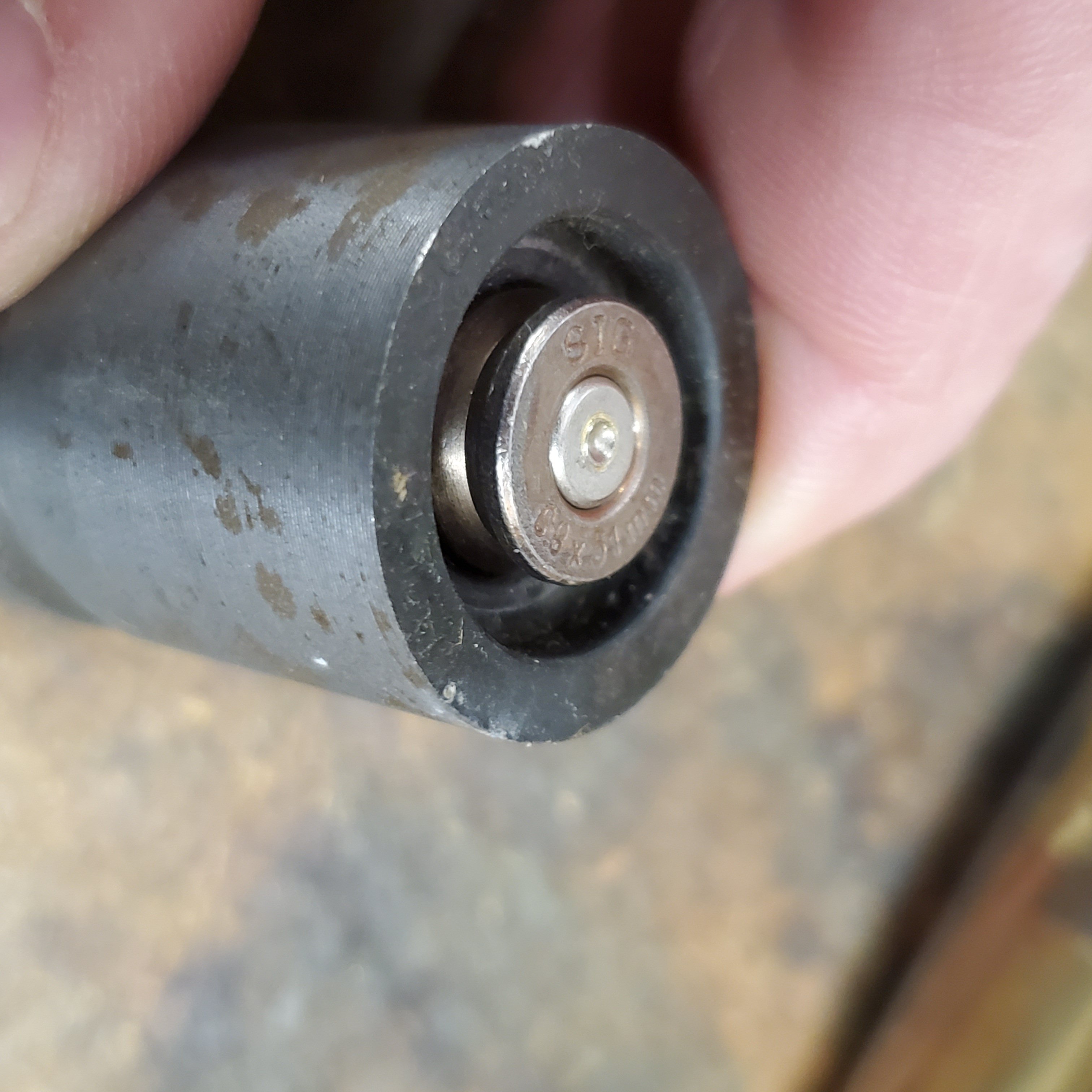

All cases extracted normally with no bolt lift issue; no pressure signs. Actual case volumes of fired cases weren't known until after these were fired. The 57.7 gr of H2O is exactly what I've had with Winchester brass and at 2 grs more than my Lapua brass. The hybrid cases with head stamp of "24" were 1.4 grs less in case volume, which was expected when weighed and being heavier.
Upon taking some case measurements, I wasn't expecting as much expansion of the area at the .200 area of these hybrid cases as I found. I thought the steel would retain most of it's starting dimensions. As it turns out, that area of the case grew from .467" to .470. The fired cases still easily chambered and extracted. My Lapua cases expand from .469" to .4705" (they've been fired 11 times so far and are till in very good condition; virgin Lapua cases start at .468").

So it appears that the early cases made by Sig have more capacity and may measure slightly different, then the new date marked cases...I heard LC was tooling up to make them some time ago.
Mine hold 58.3 gr H2O.

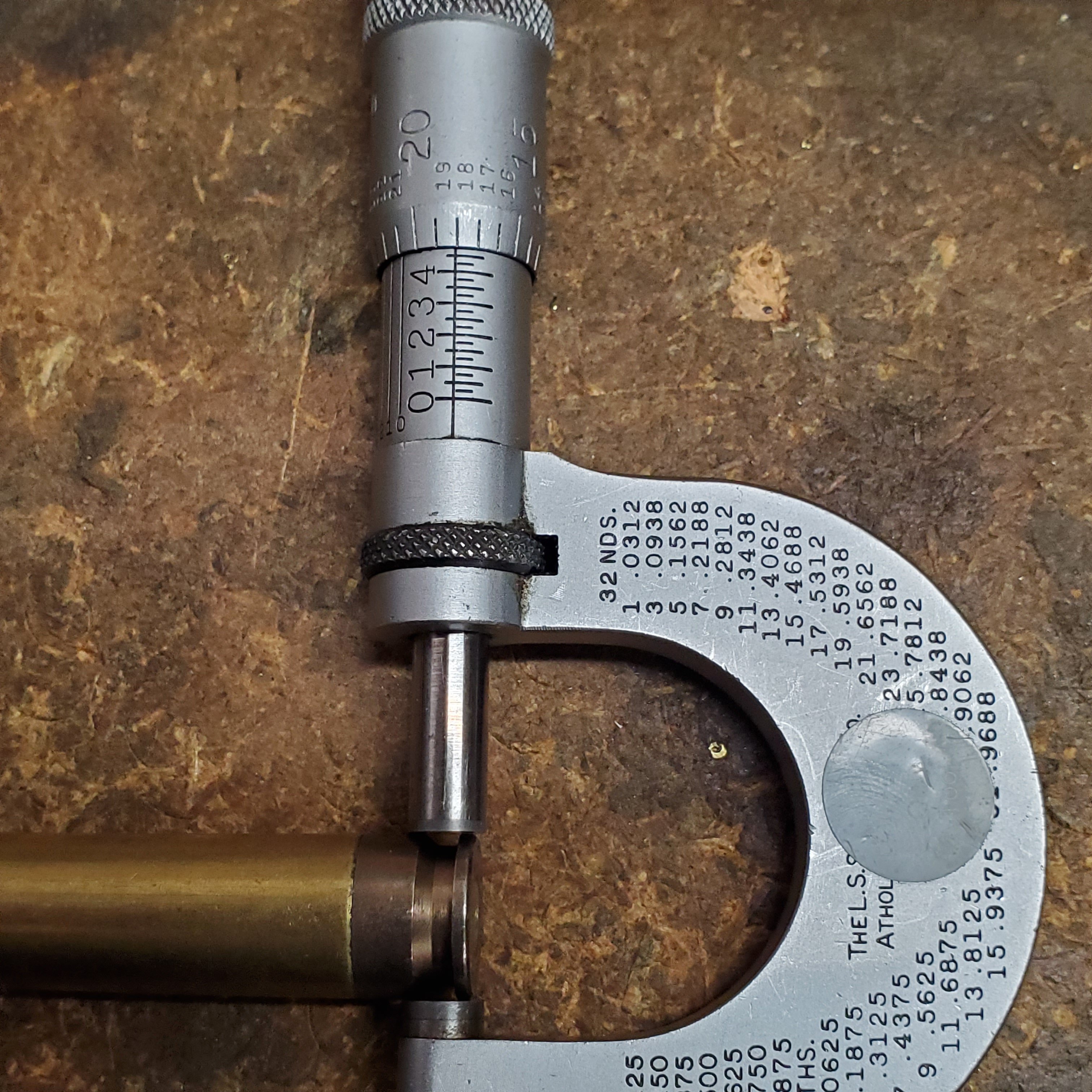

51 grs of powder behind a 208 Berger, got a head expansion of .469" / .4688" and tapers back to .467" over the solid head, where it's unsupported by the chamber.
The Stainless steel head tapers up to be thin like the brass at the joint, making the Stainles expand a bit more there because it's so thin.
Actual 308 factory chamber, and a high pressure, 75,000 psi hybrid case fired, still fits, all the way in.
The unsupported part if the case head where your FL die never resizes, measures .467" to .468" that is the critical area between brass and stainless.
Brass expands in this area quite quickly after 65,000 psi, and stainless doe not, dropping or blowing a primer in the brass case.
So when running the high pressures with these different case capacities, one should leave some room in the upper psi limit.
Chambers and barrel tolerence differences will also add to or detract from the final max psi in the case upon firing.

I can post my numbers I guess when I get out to my buddies to shoot them out of my and his rifle... mines a 24" I think his is a 18, mines a 1:10 twist and I duno his off the top of my head.
42gr Varget, CCi 200's & M118 LC Brass.

This was a 5 shot string
M118 Brass
CCi 200 Primer
42.0gr Varget
2.8" C.O.A.L.
I forget the base to ogive measurement but can get it if it were wanted.
Duno how the heck you plan to gain 450+ fps with those hybrid cases but stay safe... 42gr of varget is basically 100% case capacity... duno what it actually is but if it's not it's darn close to compressing. I could see some powders maybe getting 100fps more but not that much... like just running out of case volume unless you just move to a double or triple base powder?
Not to too my own horn but I'm very pleased with the SD...
Oh rifle was a CZ600 Range. (24" barrel)
