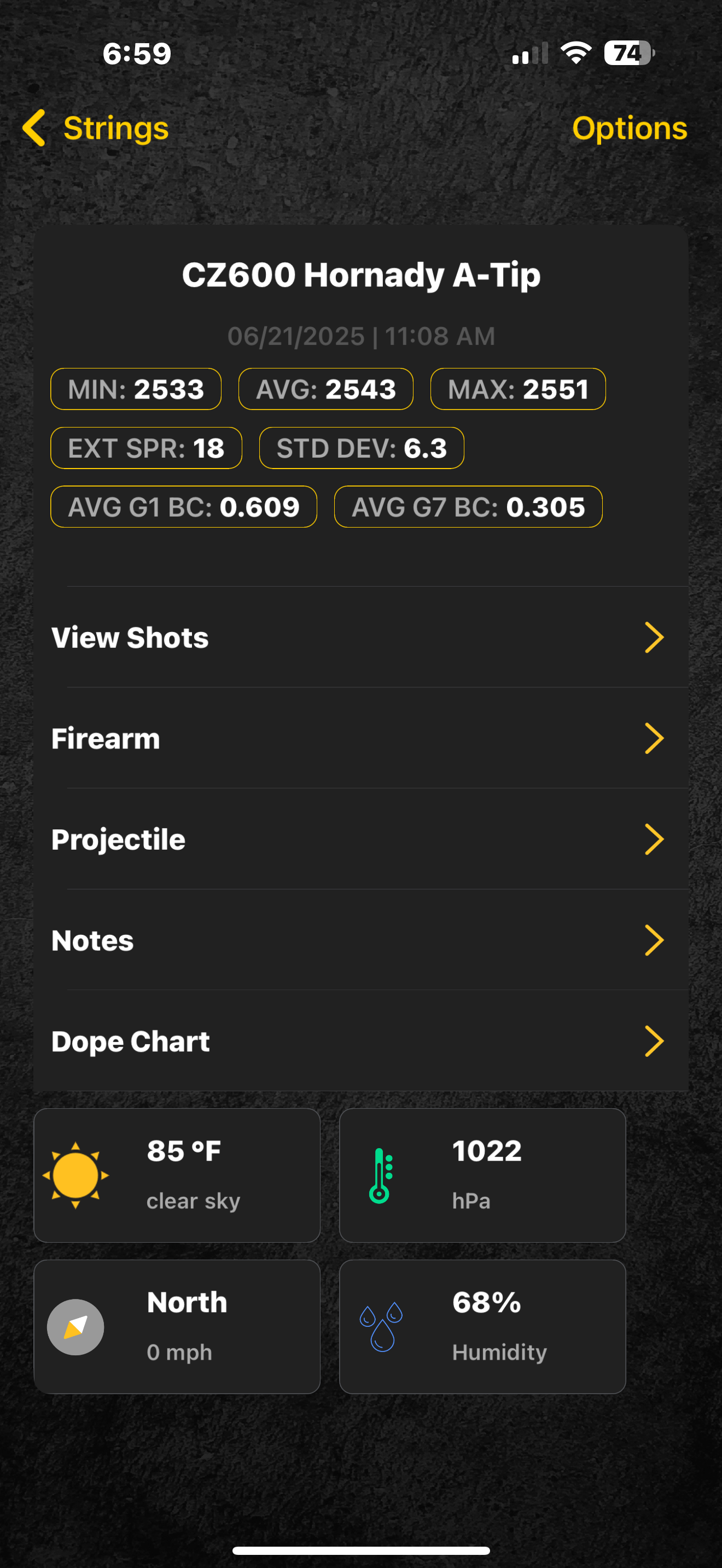

.308 Winchester
This was a 5 shot string
M118 Brass
CCi 200 Primer
42.0gr Varget
2.8" C.O.A.L.
I forget the base to ogive measurement but can get it if it were wanted.

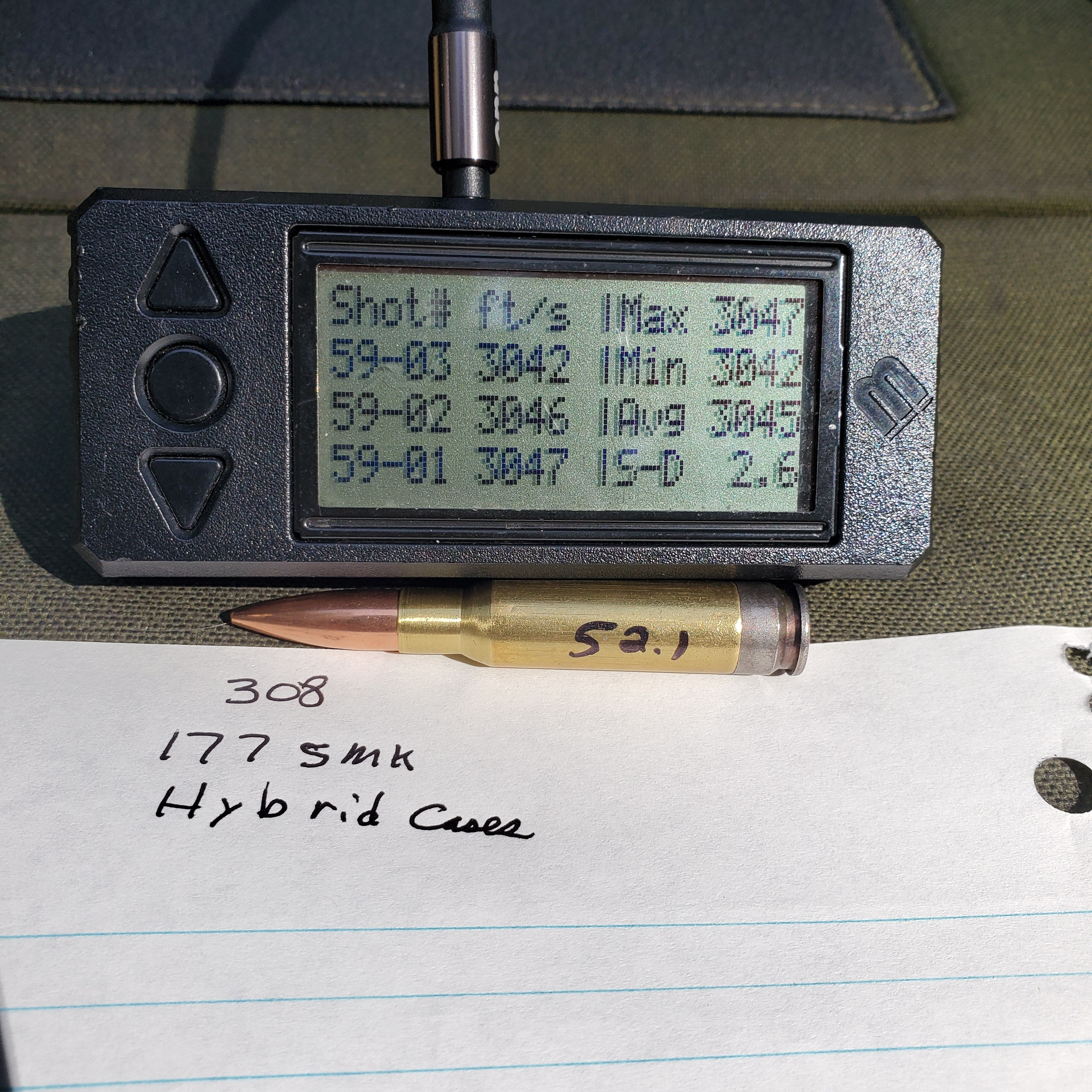

Duno how the heck you plan to gain 450+ fps with those hybrid cases but stay safe... 42gr of varget is basically 100% case capacity... duno what it actually is but if it's not it's darn close to compressing. I could see some powders maybe getting 100fps more but not that much... like just running out of case volume unless you just move to a double or triple base powder?
Not to too my own horn but I'm very pleased with the SD...
Oh rifle was a CZ600 Range. (24" barrel)
Already running 177 SMK at 3045 fps in 22" 308 with hybrid cases. And 3126 fps in the long barrel.
So the 174 ELD- VT should have 3000 fps velocity with several powders.
They bullets have arrived, so it's time go get around to loading them.
what powder(s) are you using and what barrel lengths if you don’t mind me asking? Also how are they grouping?
I have 8 308s autos, and bolts...
I only run hybrid cases with high pressure loads in bolt guns for obvious reasons.
I have 308s in lengths of 16, 2,18, 20 (dead), 22, 24, 26 (dead), 27, & 30 inches.
Twists 12, 11.25, 10, 9, & 8.
The 3045 fps with 177s was in the light weight 22" 9 twist.
The 3126 fps was 177 gr SMK in 30" 8 twist heavy Palma, long action, alum chassis, for shooting 200 SMK 2900 fps to 250 Atips a bit over 2500 fps with hybrid cases or Lapua cases with a bit less velocity.
Powder was RL 17 in this particular test with 177 SMK.
Accuracy is good, usually a bit lower than max pressure loads around 50 fps from top loads.

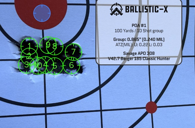

Not the fastest but damn did they group…and from a Savage lol
Savage APO 24”
Garmin Zero
6/21/25
90F 56% 30.15in
Berger 185 Classic Hunter
Bullet BTO 0.7050
Varget 42.7
FGMM Br x 1
210M
COL 2.0190
BTO 2.0450
2556, 2664, 2661, 2658, 2681, 2685, 2658, 2670, 2659, 2662 SD 10 ES 30

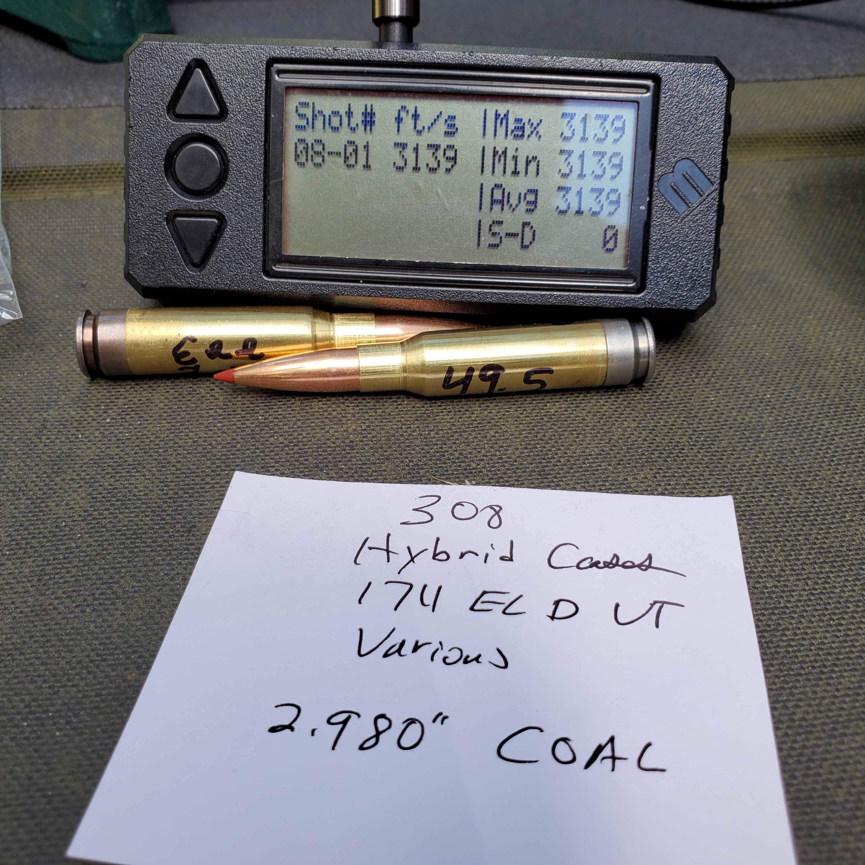

I loaded up the new 174 gr ELD-VD in hybrid cases.
The velocity was 3139 fps, with 3806 ft/ lbs of muzzle energy.
1000yd ballistics: 1720 fps, 1143 ft/lbs 22.5 moa drop, 64.6 inches of drift in 10 mph cross wind.
Mag length for MDT 308 mags.
Fired in the 30" heavy palma 8 twist 308 Win today.

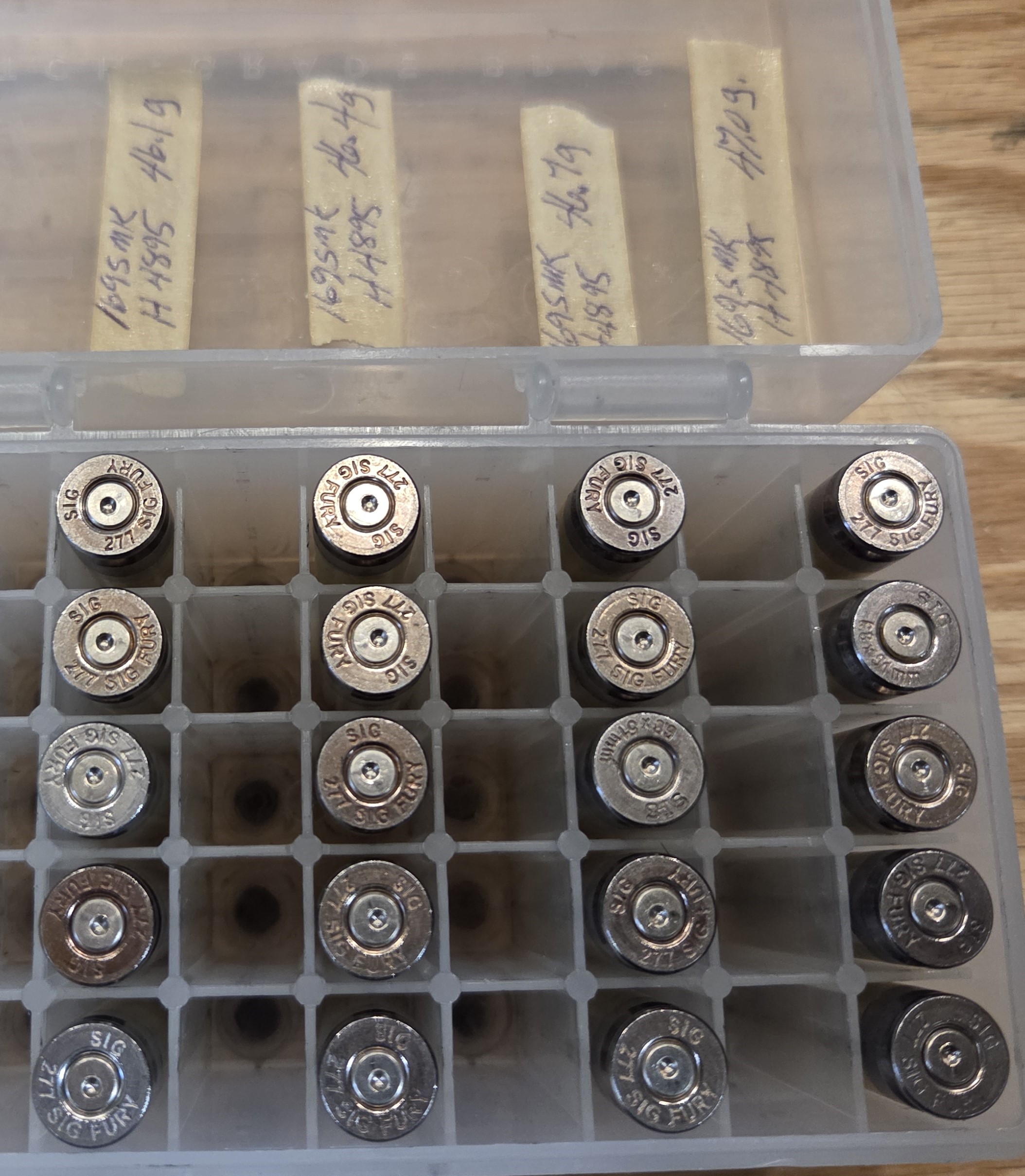

Having necked up my 277 Sig Fury Hybrid cases to .308 with case volume of 57.7 gr H2O, this morning I tested some H4895 behind some 169 SMK's. Using data for the lot of powder that I had, the velocities came in really close to what QL predicted for me (about 8 fps higher, I think because it was a pretty warm morning at 94°F. . .(summer time in AZ ;) ). For 47.0 grs., case fill at 97.5% with COAL at 2.977", the 5 round average was 2,929 fps (SD: 6.7, ES: 20). . . ~200 fps faster than I normally shoot them in my Lapua brass (26" Krieger barrel). QL estimates the pressure to have been ~73,600 PSI. No problem with extraction, though it seemed it might have felt a hair heavier than previous load Interestingly to me, this load produced the best print with a .432 MOA even though this is the first firing after sizing to a .308.
Reactions: 45-90
I keep the hybrid cases limited to around 74,000 psi in QL predictions, for a safety margin.
This will still give much improved velocities especially with certain powders.
Probably gain about 1 grain or so in water capacity after firing.
I also experienced the most accurate groups at one hundred yds in small sample tests with hybrid, Lapua, Lapua Palma, and LC brass.
The Lapua Palma was the worst with larger groups, lower velocities, and larger SDs.
Probably because there is more powder to ignite and SR primers have a problem with certain powders, larger charges, and temperature drops.
Also when sizing barely bump the shoulder back... these hybrid cases are thin.
It may be prudent to discard after firing 5 times as I have started to experience case head separations, maybe 1 in a hundred, but it ruins your day at the range.
The cases seemed to have gone through changes slighty as reported by some with less case capacity, and a different manufacturer emerging to produce the hybrid case. All of mine are older...and hopefully any changes will be positive.
The slight protrusion of the primer cup back into the firing pin hole looks normal.
If it grows a longer teat you are having excessive pressure, especially with stiff bolt lift...stop...you surpassed your 80,000 psi limit. There are no other pressure signs like those seen in brass case heads.
Certainly, case volume is going to be more after firing than a sized case. And in .308 the difference, I find, is about 1.5 grs H2O. . . depending on the thickness of the case walls.
In my gun, the Lapua Palma brass performs just as well and more often better than Lapua LRP cases. But then, my experience is pretty much all in a warm to hot environment. I get really consistent results with the Palma brass.
Given the case volume/capacity you've reported, I'd expect the case to be pretty thin. Those cases that I fired today with 57.7 grs of case volume do measure somewhat thin. Like the neck thicknesses are .0135 to .014" thick (similar to Winchester brass). The cases with the "24" stamp on the head have a case volume (after firing) of 56.3 grs H2O and the necks measure .001" thicker.
Yes, that's is indeed normal for my gun.
Good report...and keeping your testing on the sane side.
(y) (y)
Reactions: 45-90
I use 308 Plama brass in target loads up to 200.20× bullets in the summer with good sucess.
But with 50 grs of ball powder with 230 gr SMK at 50 to 60 degrees the Palma cases and SR were a poor choice in my testing.
Continue to report on what works for you, and what does not.
We will likely have some different experiences depending on all that can influence shooting.
But the information is what's important to share so others have an idea of where to begun with hybrid cases, and if it's for them,... or they may have just limited use, as I kind of suspect for many.
But they are there, so they need to be investigated, to see.
Reactions: straightshooter1

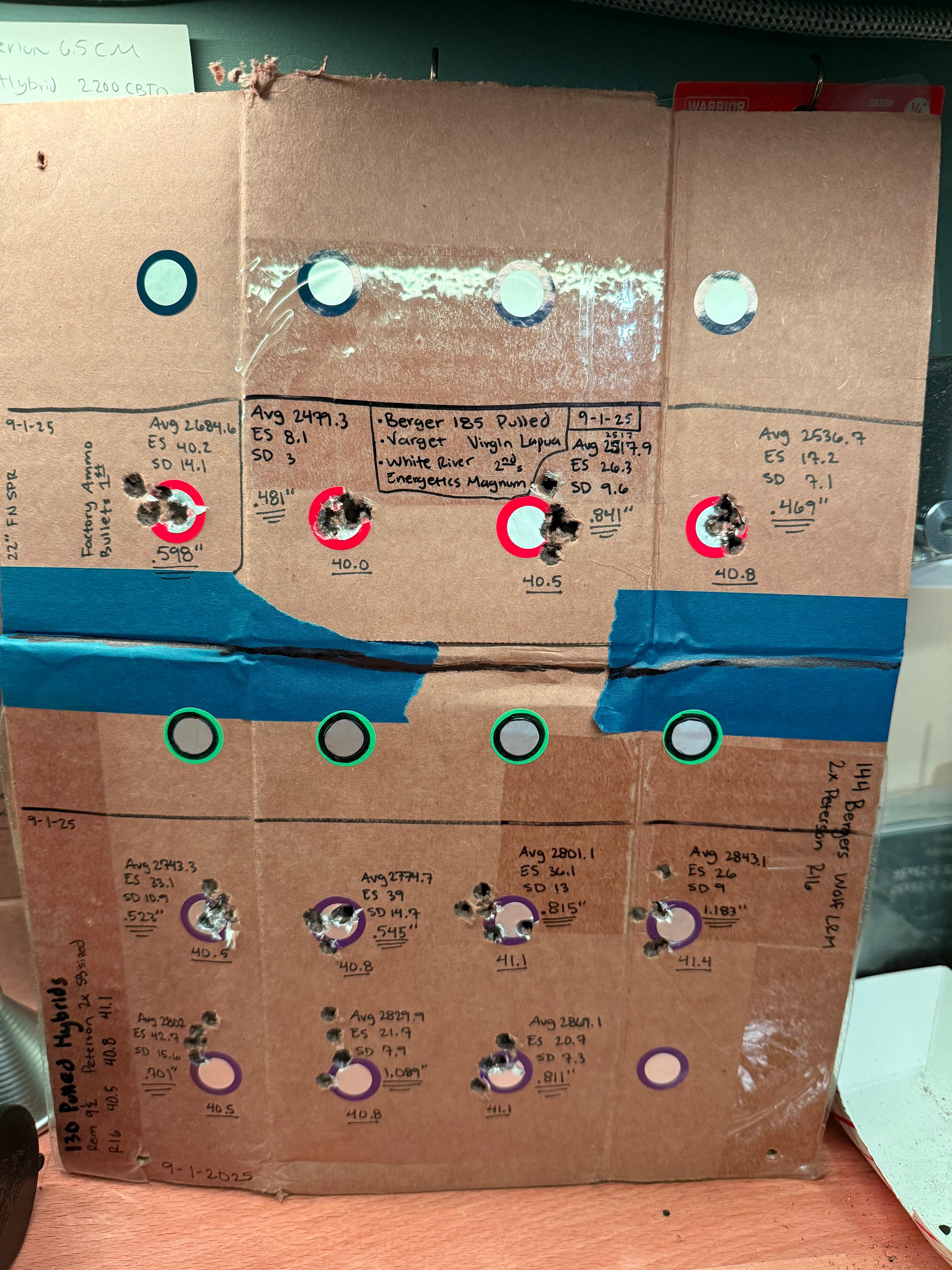

Loaded 308 for the very first time. Didn't really do a full on load development. Honestly, I just threw some random charges and ran with it just to see. I was really trying to find a load for my 6.5 which has been problematic for me. But the few 308 loads I did try, looked really good.
Having these 3 loads shot and on paper already, what would you do next? If I want to get more serious with the 308 instead, and do a full-on load development, where would my next step be?
I was also thinking of just loading the remaining of the brass with the first charge weight just to fireform the brass, then try to find a load. Thoughts?
My 308 loads are at the top. First group on the left is cheap factory ammo I tried first just to ensure I'd be on paper.
Loads are as follows:
185 Pulled Bergers
Varget
White River Energetics LRM 2nds
Virgin lapua
40.0 gr
40.5 gr
40.8 gr
I read a lot online of people loading 44 grain and such with varget. I can't even imagine that being a safe load no?

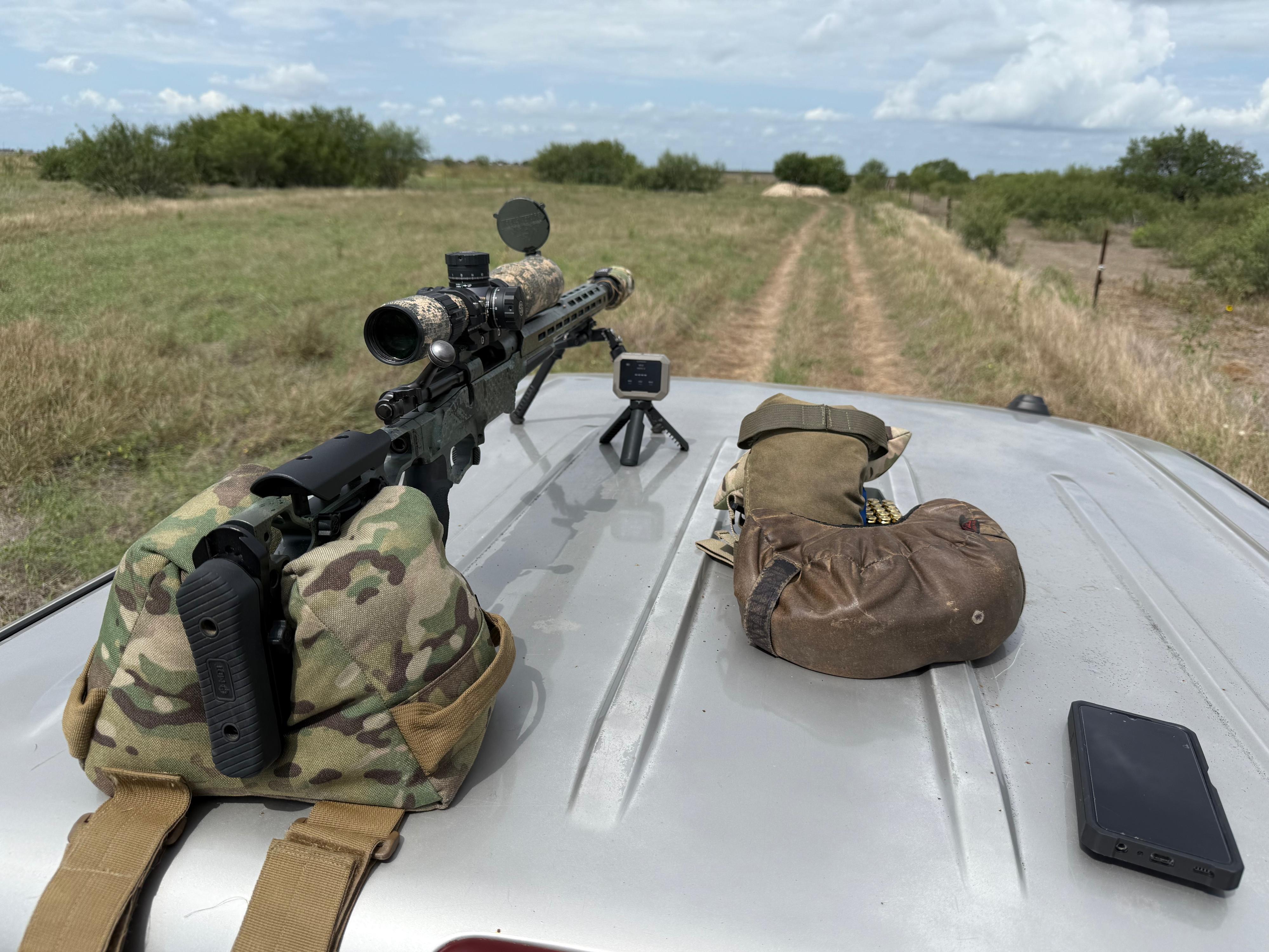

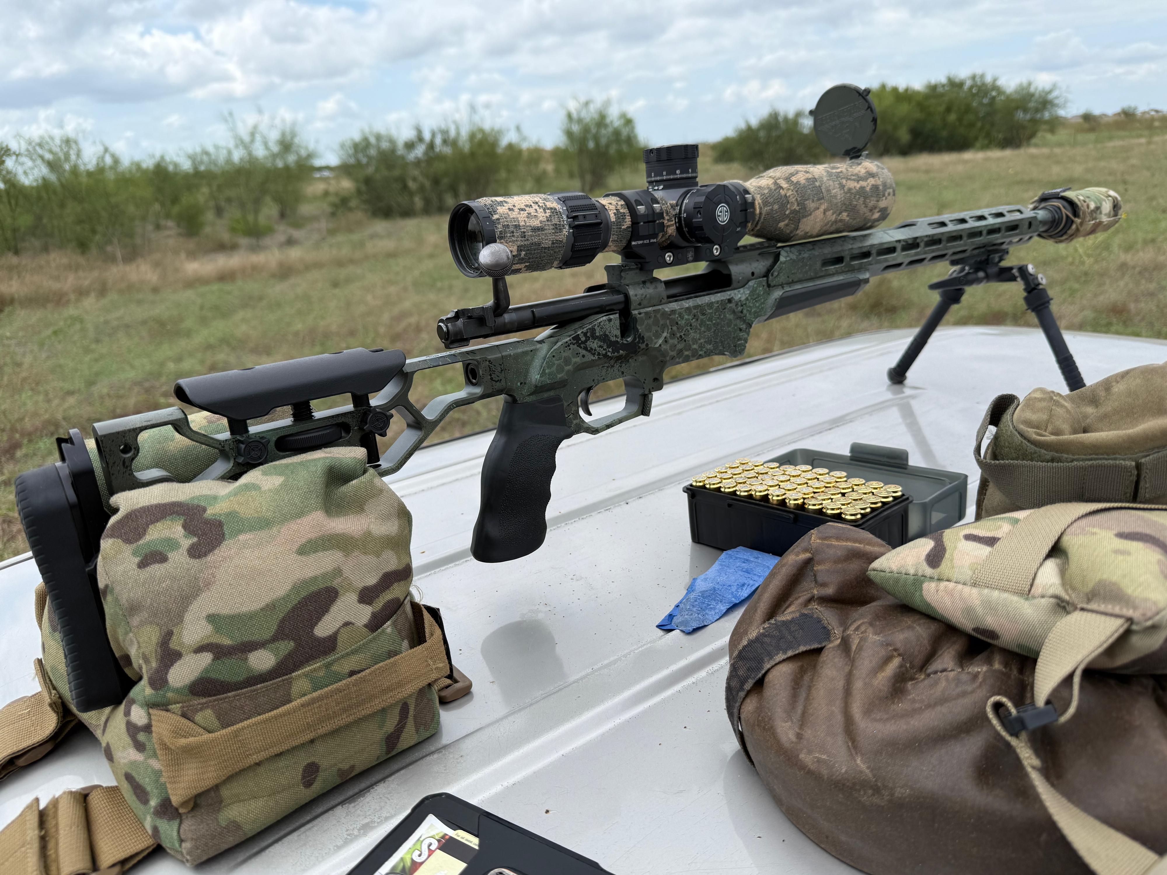

Rifle specs:
FN SPR
Factory trigger with McCarbo spring
Shilen select match 22.5" barrel
PTG 308 reamer
MDT ESS
Sig Tango6 4-24
TBAC Dominus
