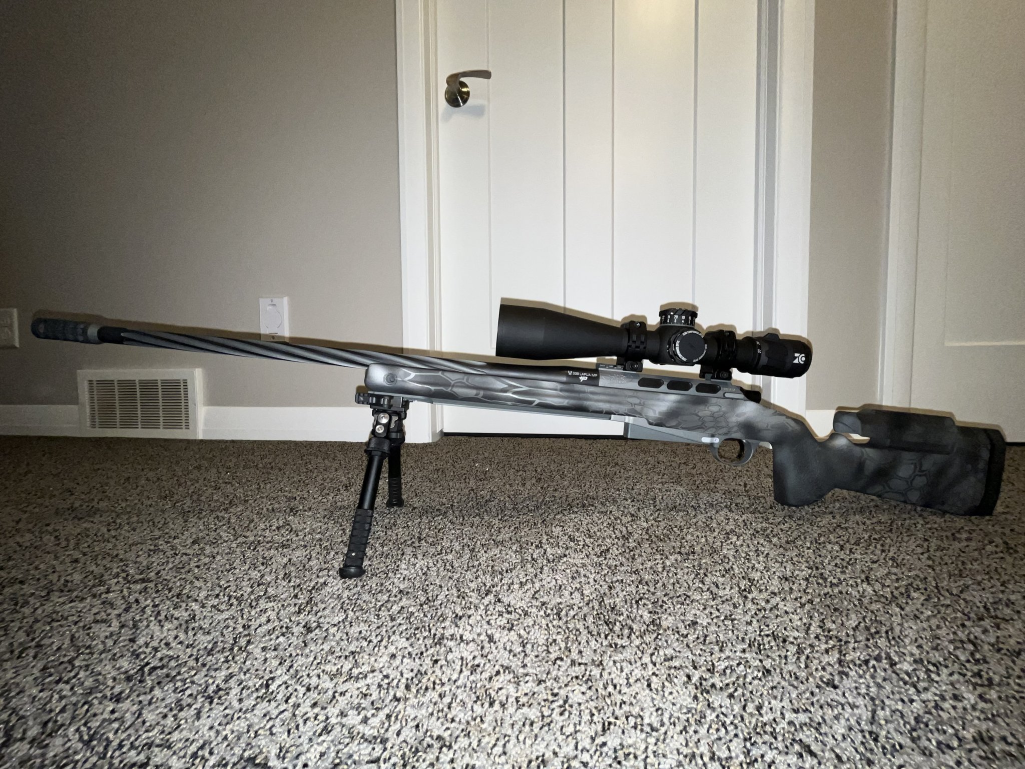

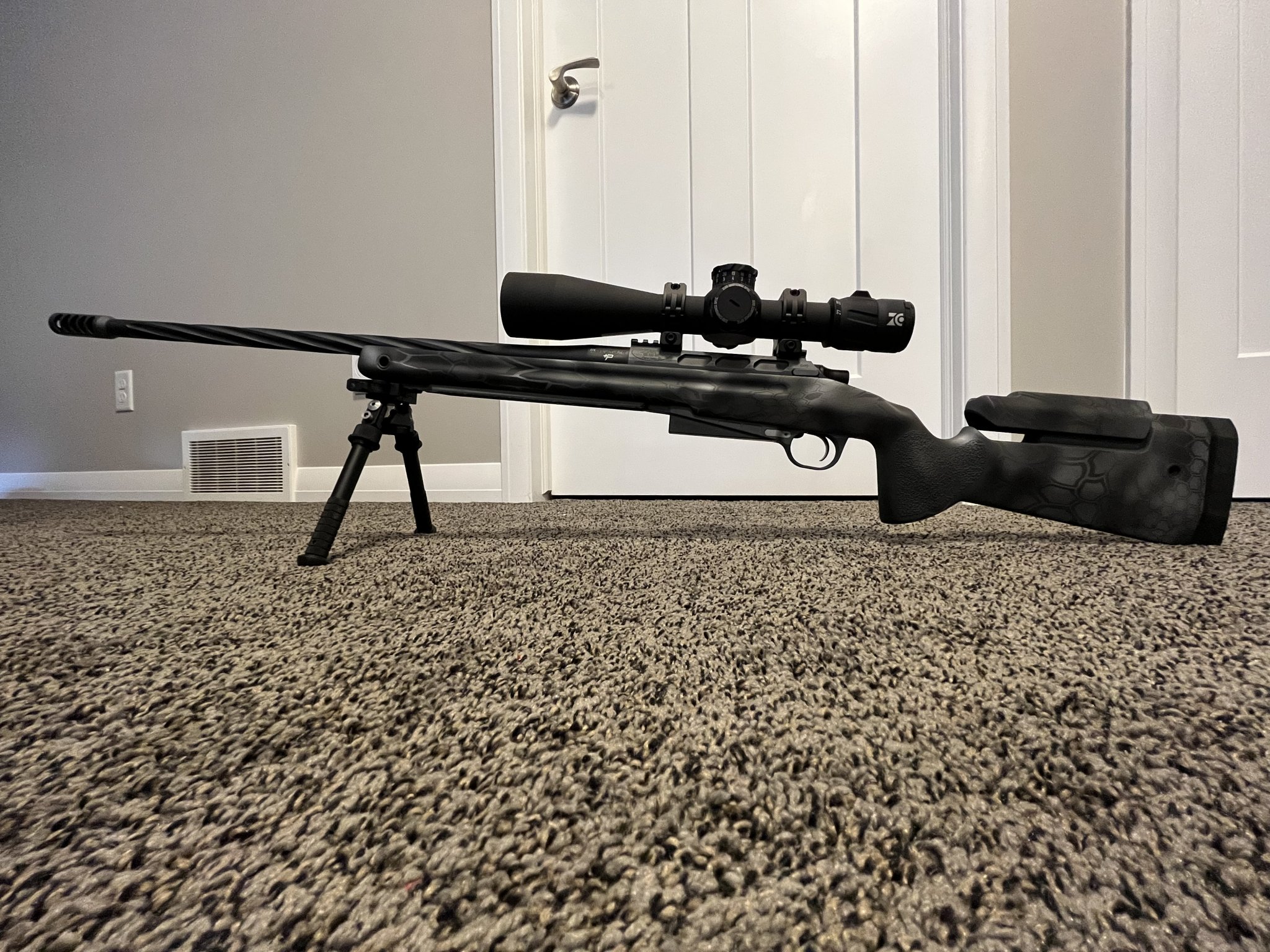

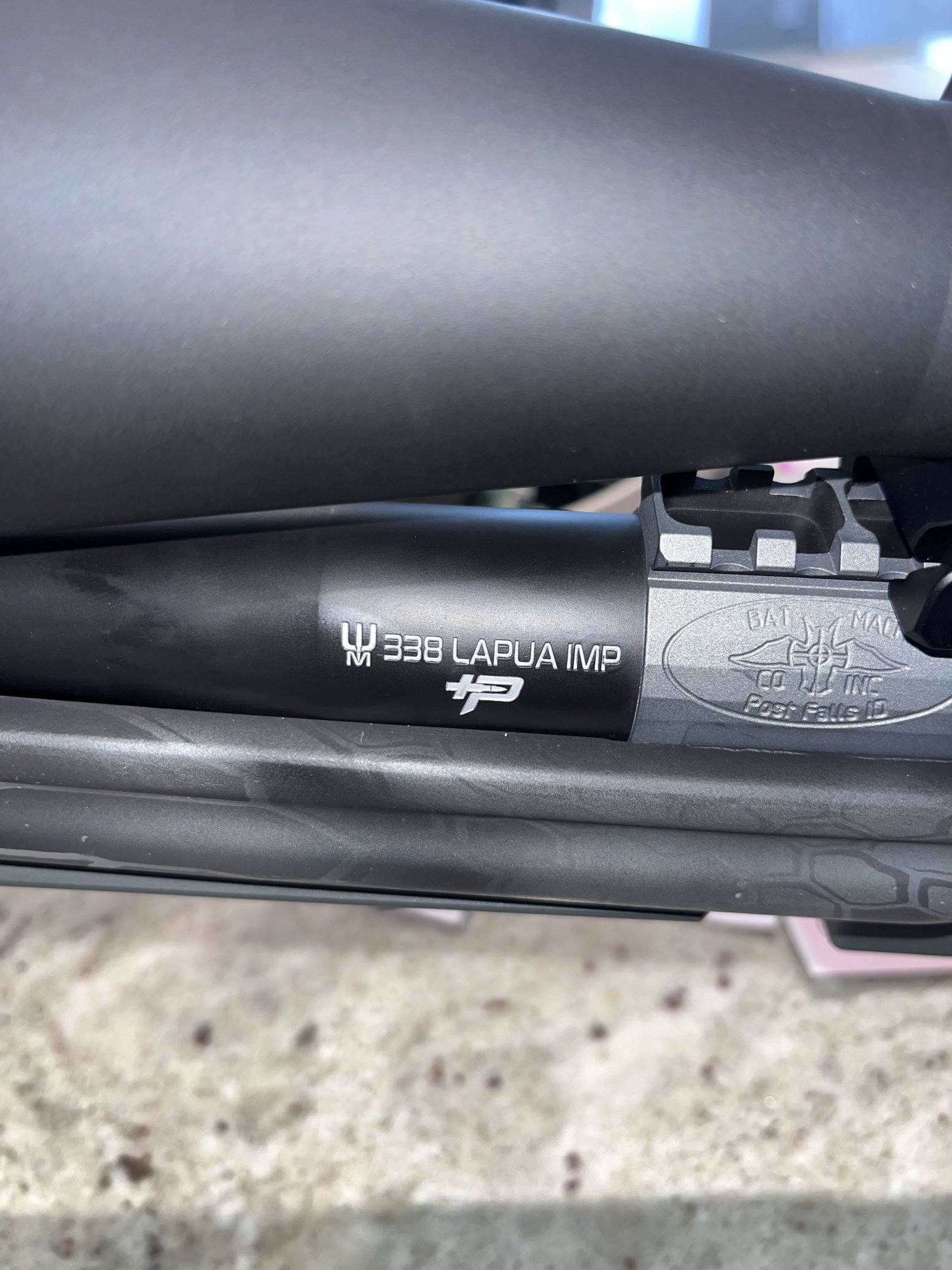

Just got my build in from unknown munitions.
Manners LRH
Bat Vesper

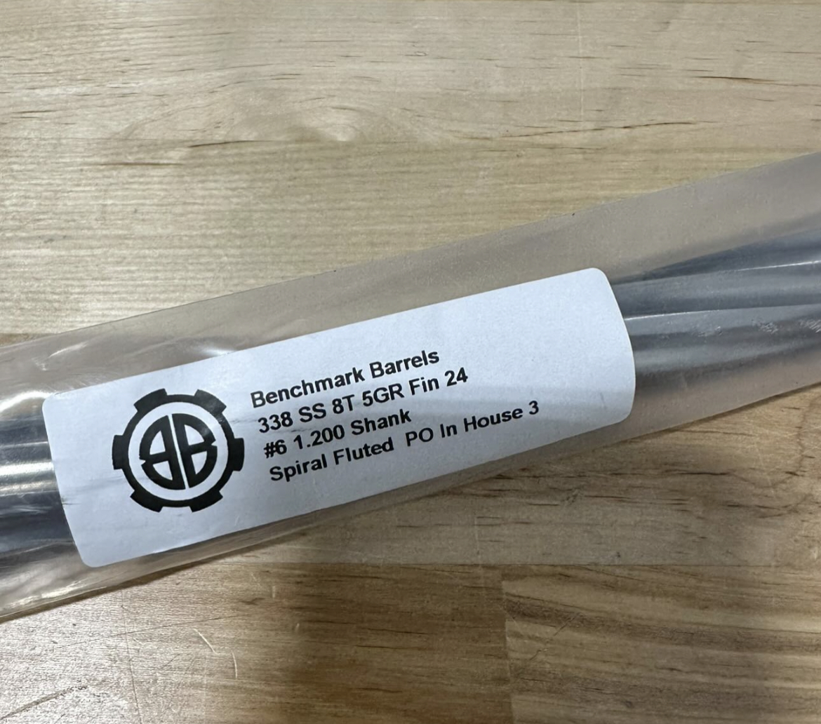

24” Benchmark SS 8T
Triggertech Special
Ti Pro 5 Port
UM Long DBM
ZCO 527 Scope

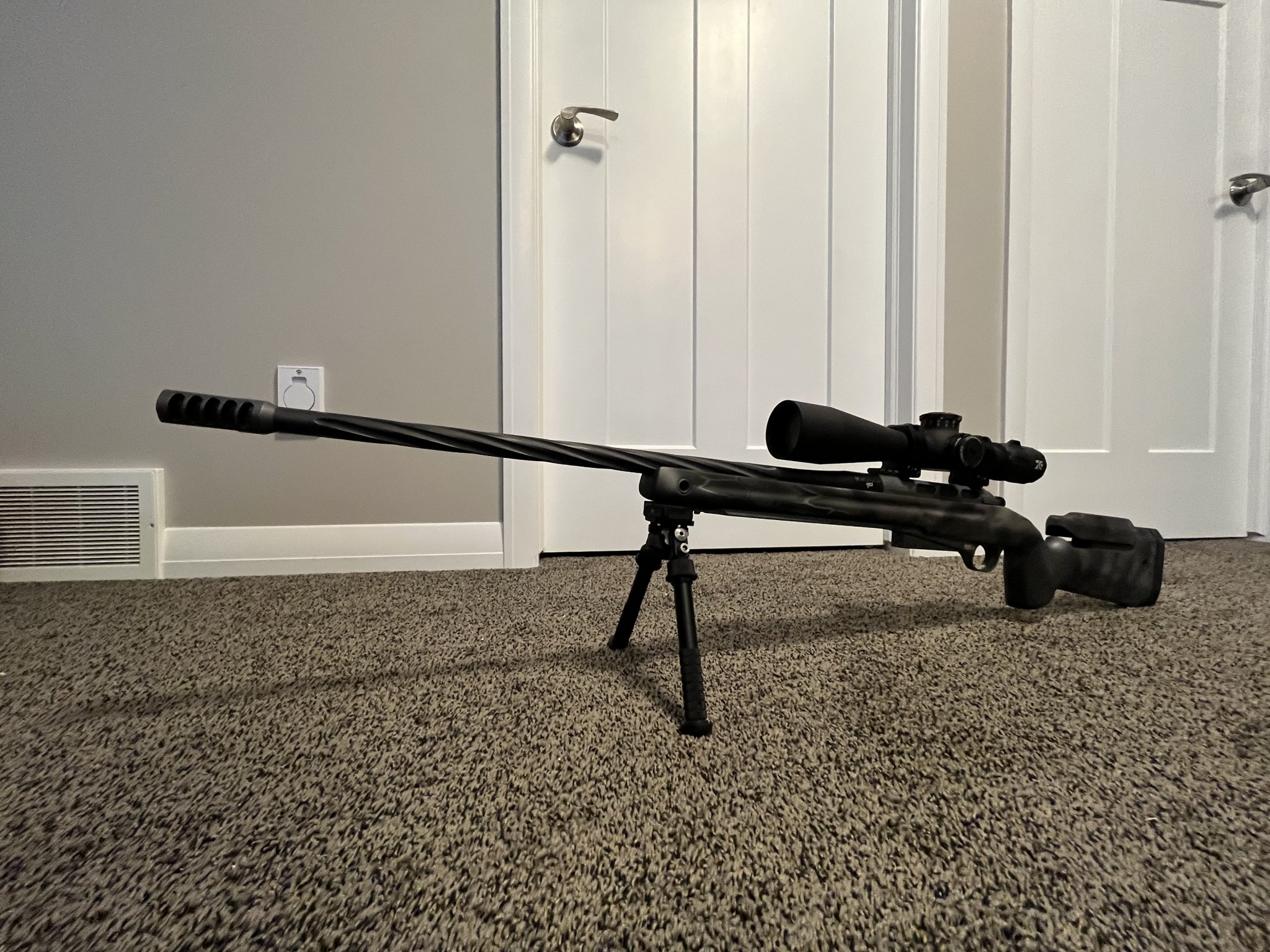

Haven’t got a chance to shoot it yet! But looking forward to seeing how the 300gr OTM performs.
It’s 9.9lbs scoped without bipod.
Damn nice looking rifle.
What profile is your barrel ?
Looks like the scope and barrel might weigh close to 9 ponds.🤔
Never mind just looked again, the pic were you shined light at it threw me off due to the shadowing.
At first glance it looked like alot heavier profile.
I was surprised by the weight too. Didn’t intend for it to be lite foresay. Will see how the recoil is when I get it out.
But yes, it’s a heavy scope and also went with the ARC rings, which aren’t the lightest either!
Reactions: XLR308
I had to look up that action, damn BAT really has a heavy wieght in the banter wieght division.
26oz is impressive for an action that size unless Altus sight is a typo.
