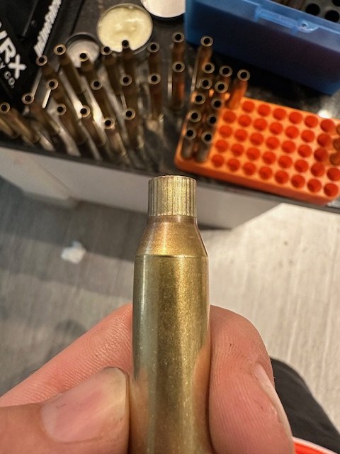

Hello everyone, I was just sizing some brass and started noticing these marks along the neck of my brass. I am using die wax for the body and dipping neck in graphite before sizing. This is all annealed brass also. Just wondering what's up? I cleaned the bushing that I'm using inside the die but now I'm not certain if these are damaged or not. They're maybe on their 10th firing so maybe it's an older case problem and is ready for the trash can, but I've never seen this before and would greatly appreciate some advice here.
Is that safe to load?
I have had good luck with Nosler brass.
So have I. I think they may even be made by Lapua. But unless cost or availability are an issue, I stick with Lapua.
