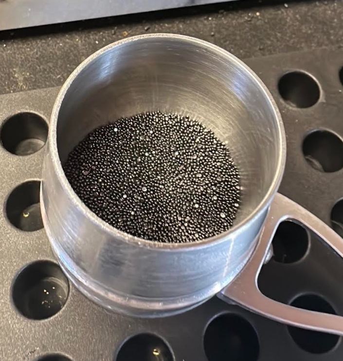

So I'm helping get a friend up to speed with reloading and we set out to make a clone of the BH 300SMK load that shoots exceptionally well in one of his rifles. First off, I chrono'd five rounds and was floored he was getting an avg 2881fps out of a 27" barrel with this factory load (that's well over 100fps more than I would expect, and while there were no obvious pressure signs, I did get the impression it was getting close).
I measured a 3.59" COAL and pulled a few rounds to look at the powder: 99.9gr of some kind of ball powder. That really narrows the options.
What say you? Doesn't this look like US 869?
I'm under no illusions that this could be some proprietary powder, especially given those insane velocities, but I'm just curious what others think?

US 869 seems way too slow for .338LM, however I just did a comparison with Ramshot LRT and they look remarkably similar. And Western says the max load for that combo is 101gr, so we may have a winner.
That’s 869.
Mega speed in 50BMG too. For a while the Hornady factory ammo was loaded w it, but now they use RL50 last time I checked
It seems to match Ramshot LRT. I did a pressure ladder up to the load charge weight and the velocity was pretty close. 869 should be too slow.

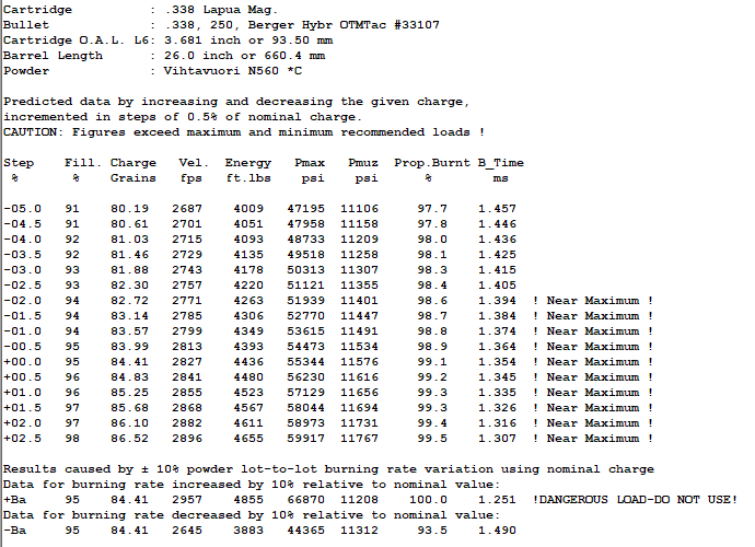

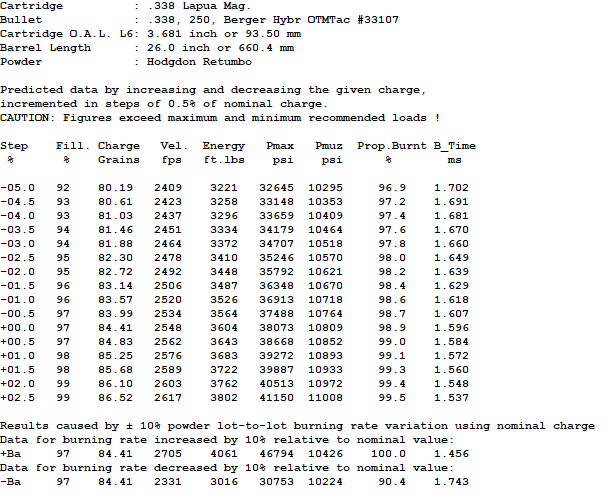

Has anybody used StaballHD in the lapua yet ?
It's right after retumbo on the burn rate. Too slow for 250's ?
N560 seems to be around, h1k is nowhere to be found, retumbo seems to be disappearing fast.
Probably too slow...
Even Retumbo is slow with 250s. Here you can see even at 99% case fill you're still just barely cracking 41k PSI and velocity is anemic for 250s.
N560 is a much better fit
