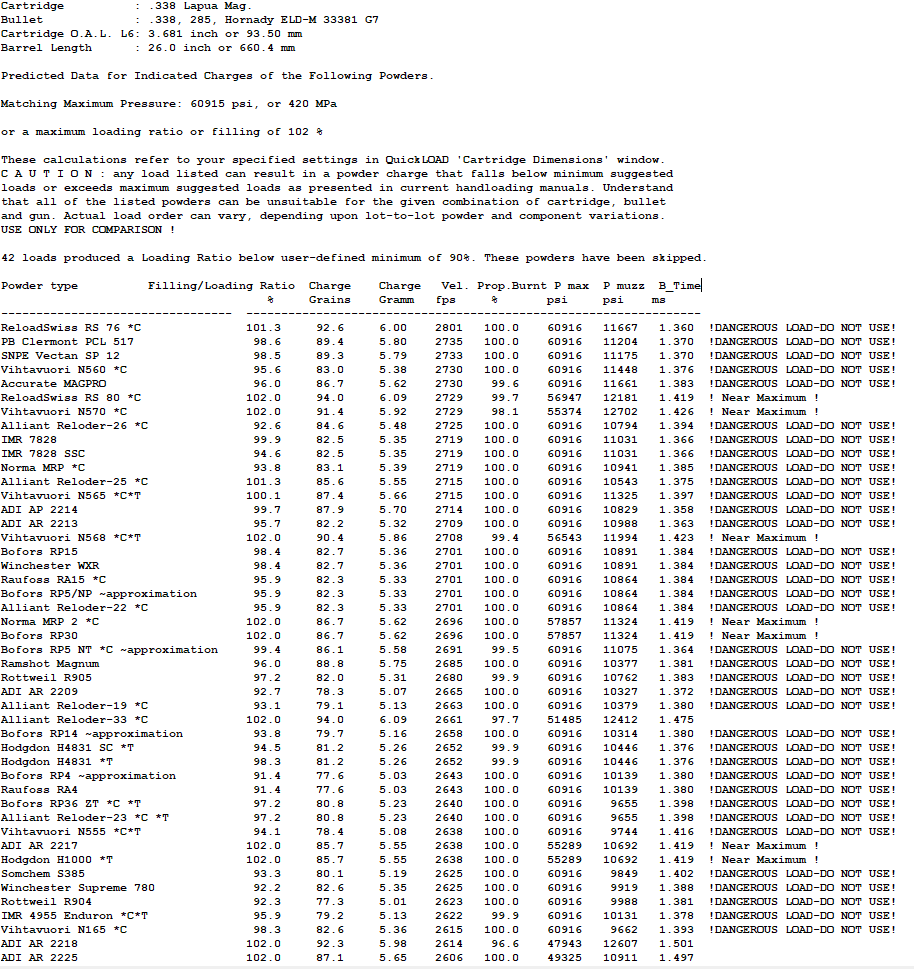

You can see some standouts for maximizing performance with 285s.
Note: N570 gives good performance, but look at that 91% fill (not ideal). N568 looks to be a better fit and RL33 will get you there well within pressure limits, but the latter is unobtanium.
Edit: whoops, I totally misread that line about N570. Which is silly as this was one of my go to powders for .338LM

ADI AR 2225 is Retumbo (the native designation in Australia) and it's way down at the bottom.
N570 gets you high velocity with good case fill. Even if you dial back to 99% it still performs well and you stay within pressure. The VV load data actually says max is 93.7
Case Fill - interesting how the curve on FPS react as the case fills up and starts to get up to 100%. I've added a tad more powder and didn't see that increase in FPS; because of compression. Love the sport, it's always intrigues me.

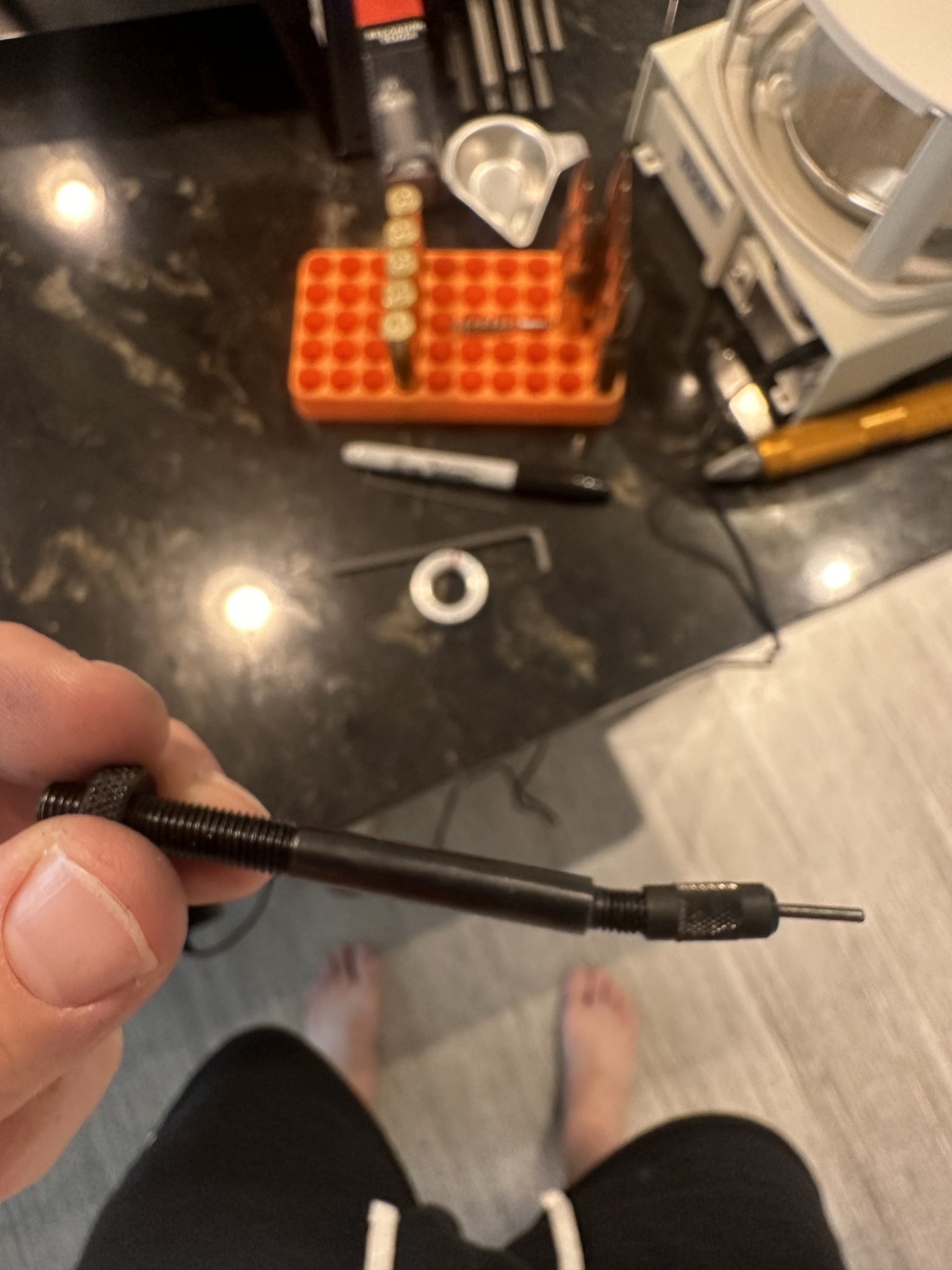

I got a custom made small base FLS die from a friend but don't know who made it. Its a great die with excellent concentricity. I was using the Redding Type S 3 die set but this allows me to cut out one step. I am using Lapua over run brass with the i think is a BB85 head stamp. It's great stuff for $90 a hundred.
Of course it's the equipments fault!! Hide members are flawless and perfect!! :ROFLMAO:
That really sucks, good thing you had a "backup" Any chance there was some foreign material in the case?
Btw, I've ruined a couple over the years in about the same fashion.
Sounds like everyone’s done it to me. Glad my right of passages is behind me now.

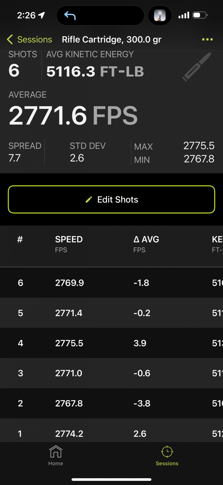

Ps: what do you guys think of this es and sd from this 6 shot string?
300 gr Berger, lapua brass, Cci 250, and 91 gr of Retumbo seated at 3.055 inch base to ogive.
You mean Doug Altman,
The British statistician who recently died? I doubt he would say that so you must e referring to something else
PS I was joking it’s a great SD and a respectable velocity
PSS I wasn’t TOTALLY joking, it will get worse (regression to mean) :D
Reactions: CEO10KaDAY and lash

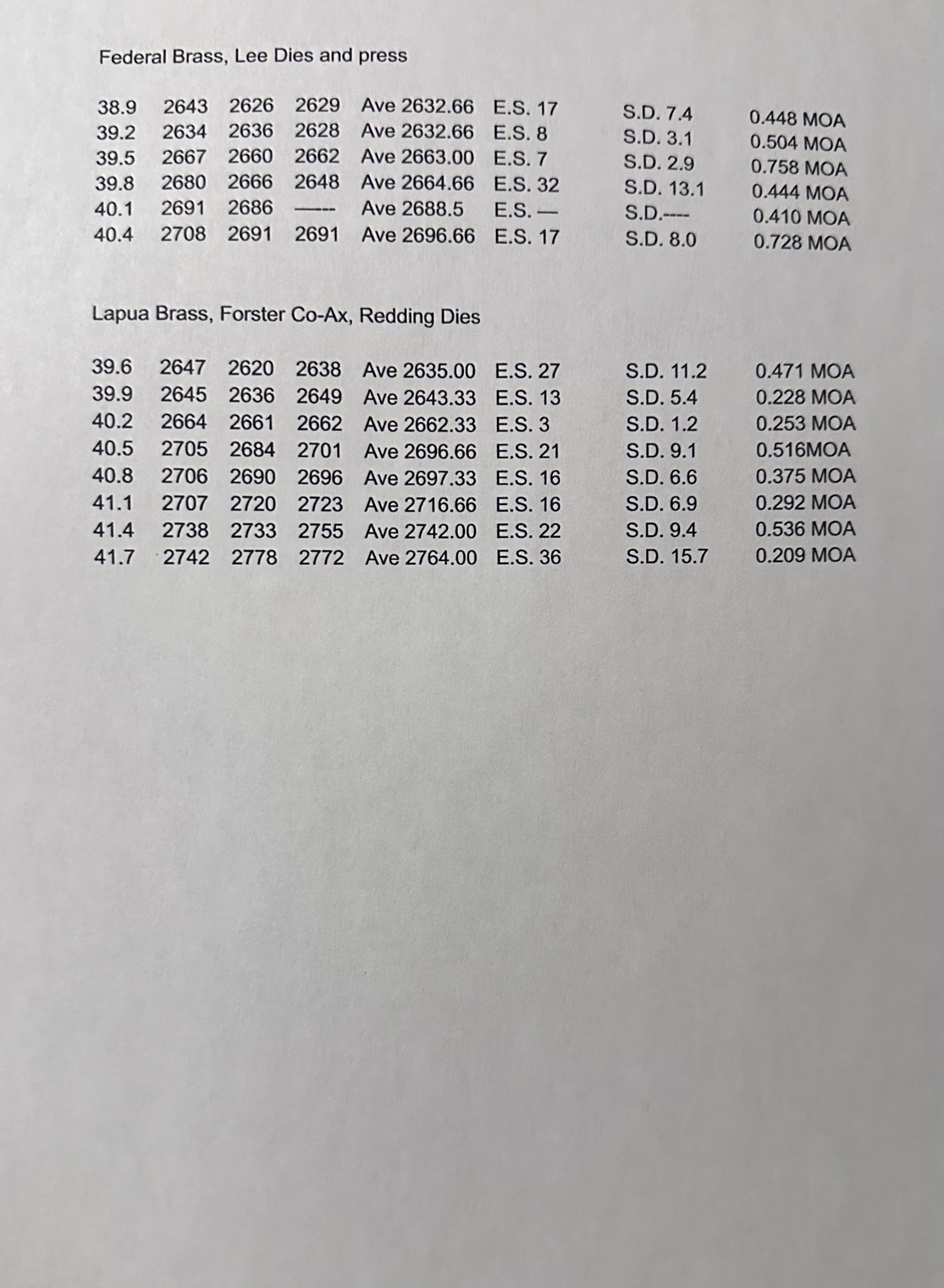

Some people love Lee dies. Some don’t. I started with Lee decades ago, but Redding Bushing dies and Micrometer Seating dies I came to prefer.
Like you I started with Lee dies and a Lee press and moved on however I think that the press and dies are capable of making some accurate ammo.
I got into a discussion with someone on another forum who stated how much money his grandson spent to start loading 6.5CM.
He included the price of components and Lapua brass plus all the loading gear specific to the cartridge.
I replied that if you excluded consumables you could do it for under $100 per caliber using Lee dies and you could still load ammo that is quite accurate.
This is a comparison using on one side Lee dies, a challenger breech lock press and 18 pieces of once fired Federal brass from some Sierra Competition Ammo compared to my Redding Competition Type S bushing dies, a Forster Co-Ax press using Lapua brass.
Powder was H4350 Primers CCI BR-4 and bullets Nosler 140 RDF.
I was already going to the range to do an OCW test on that combo so I slapped together the 18 round ladder test + 2 sighters in the Federal brass. I reduced the charge in the Federal by 1 grain due to the internal volume difference.
Someone argued that it isn’t a fair comparison since the brass and load were different.
This weekend I will repeat the test using Lapua brass for both and the same powder charges.

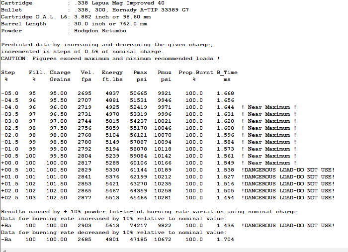

Getting ready to do a charge ladder on my AI 40*
Any advice on Retumbo and 300 A Tips would be greatly appreciated!
