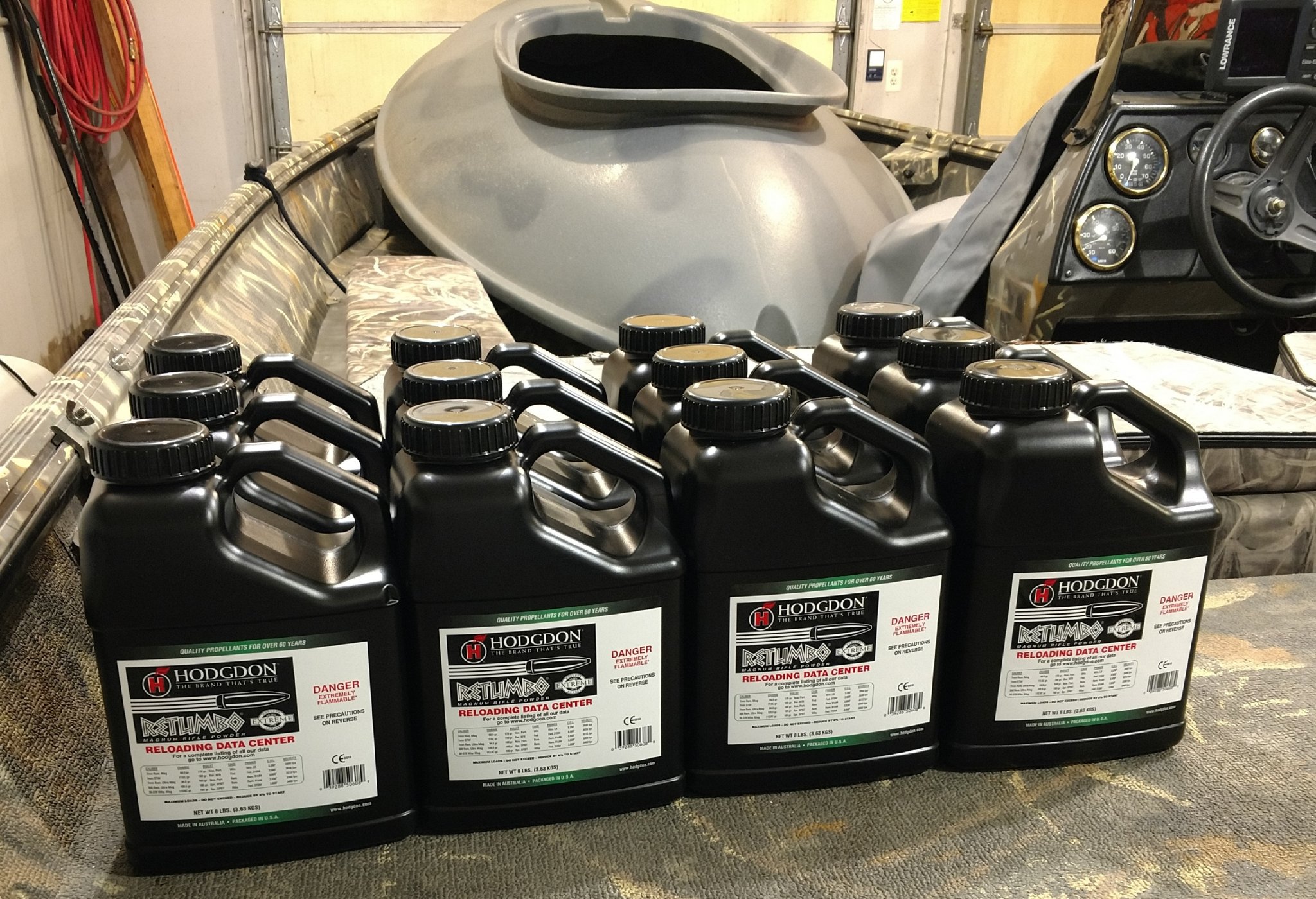

I had a he'll of a time finding vv570, but I did find 10, 1# retumbo all match, it's been really good with the 350 lazers so far. I just started loading for the 375ct also.
130grns of retumbo
Fed 215m
350grn ce lazer
Bertram brass
3050fps out of a DTA HTI.
