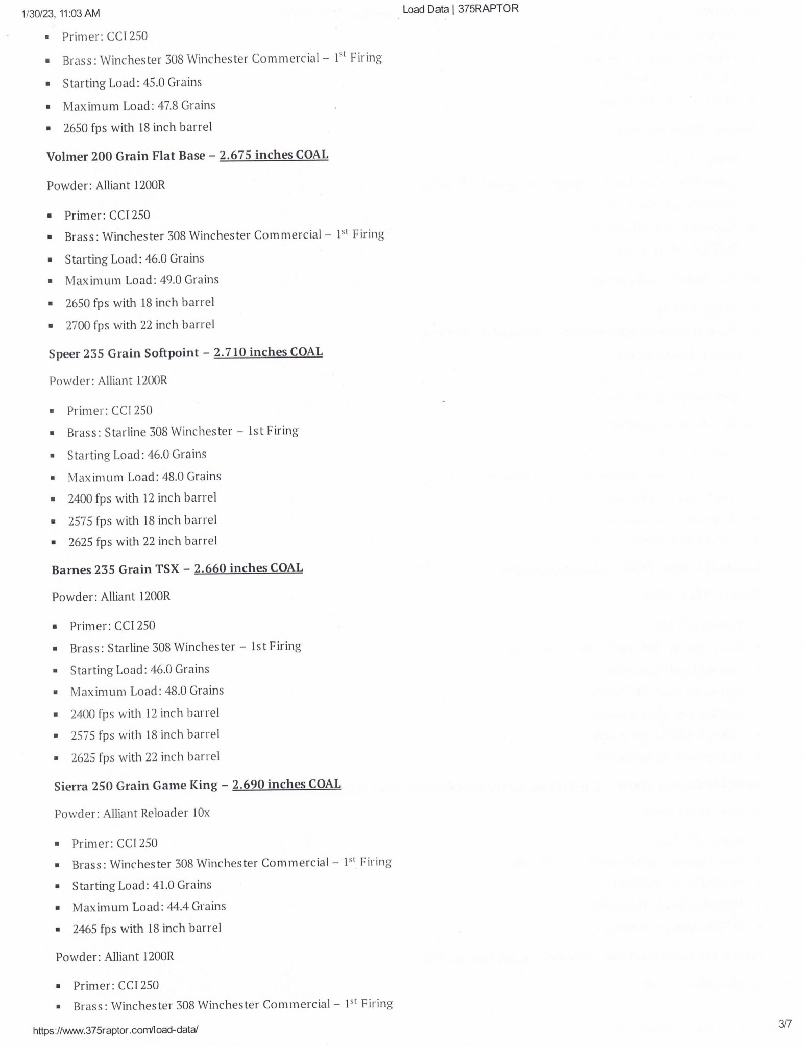

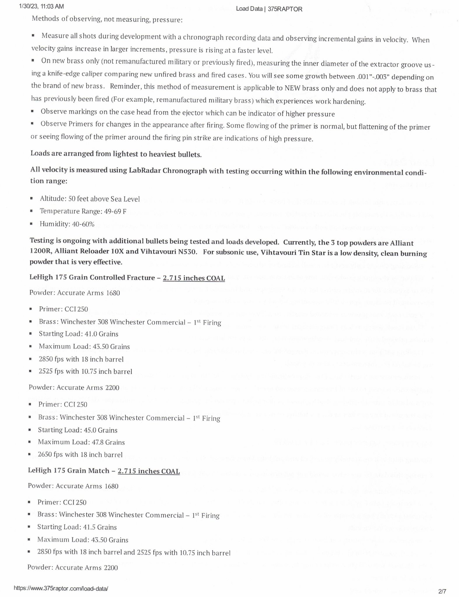

Regarding bullet seating depth, I believe the old data showed 2.710" for the 235gr speer.
Regarding powder for that bullet, I used the data for the 250gr SGK to find where to start. It lists both 10x and AA2200.
BTW, don't expect to get the velocities listed on the old raptor site data. My velocities are 50-75fps slower.

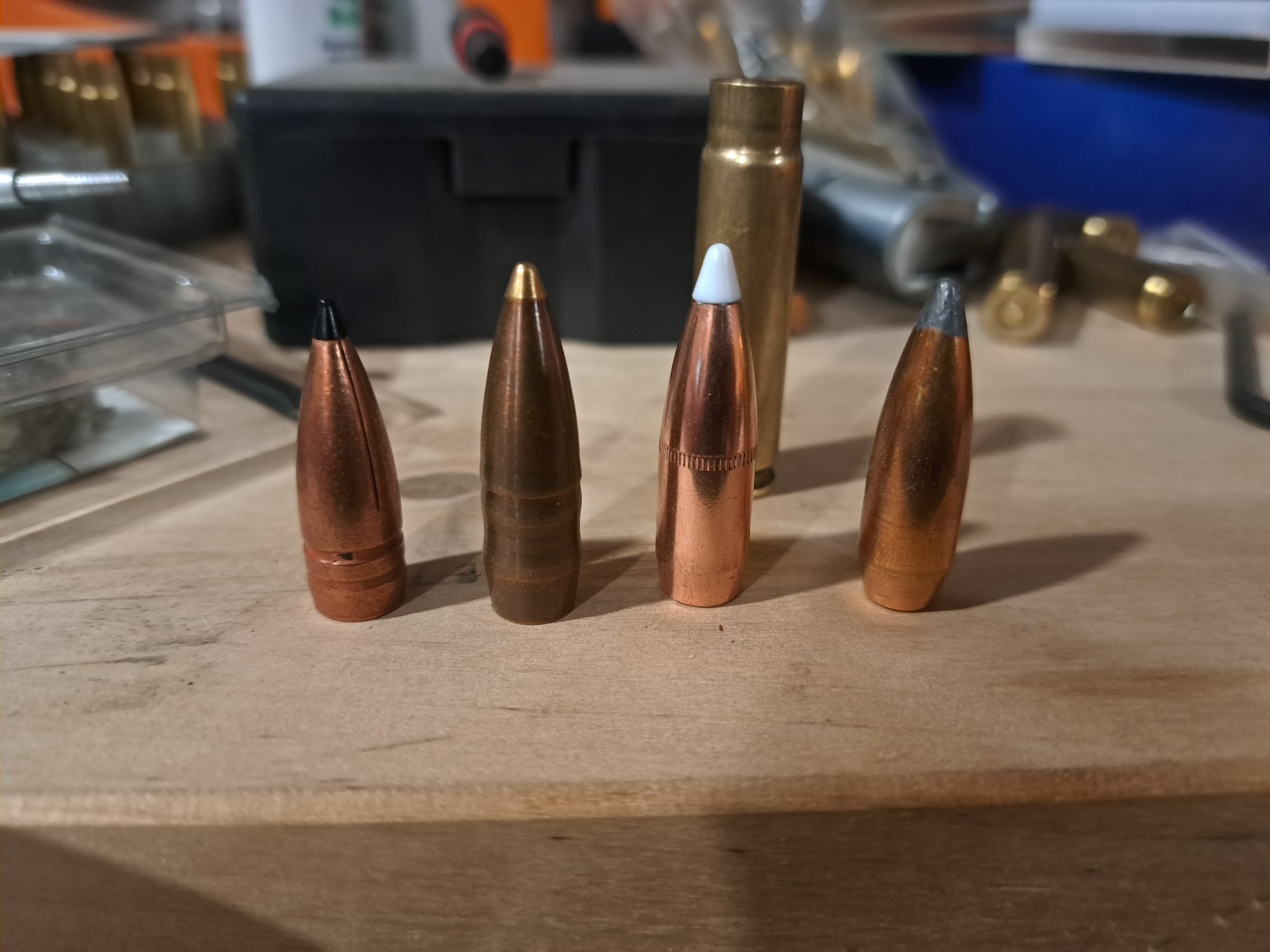

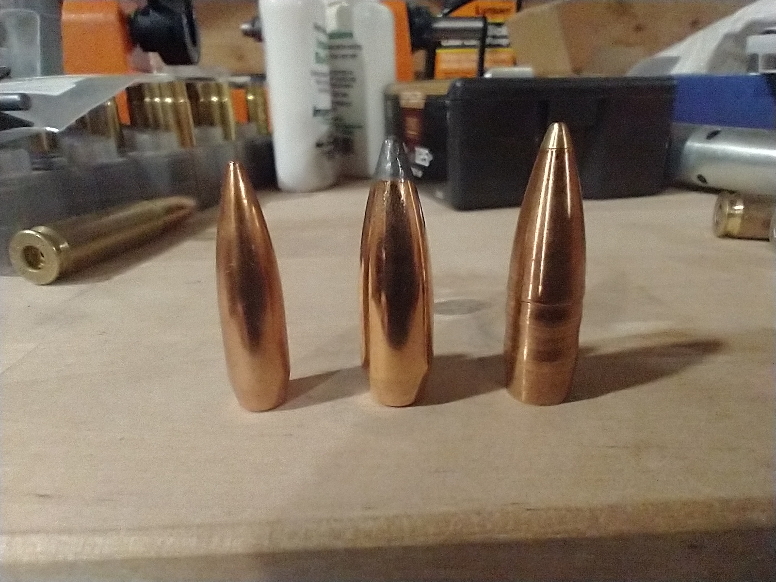

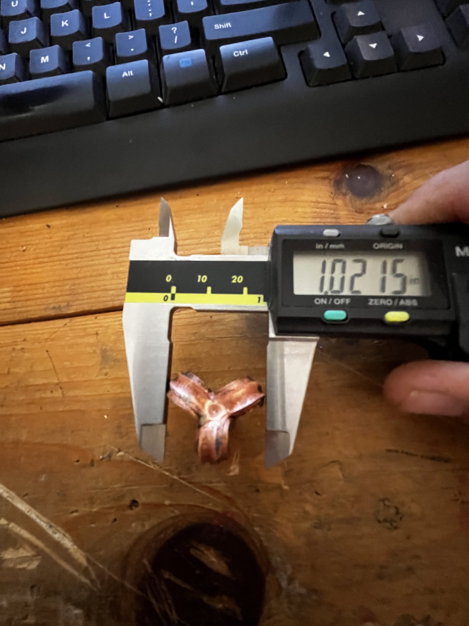

The 400 gr Maker didn't stabilize in the 12 twist past 40 yds...
So I machined .064" off the point and repointed only lost around 8 to 10 grs and the Berger bullet stability calculator says its now stable...we'll see.
Not to concerned about it because I don't plan on hunting with the 375 Raptor in sub mode, just messing around with this caliber is fun. Plus I have 510 whisper.

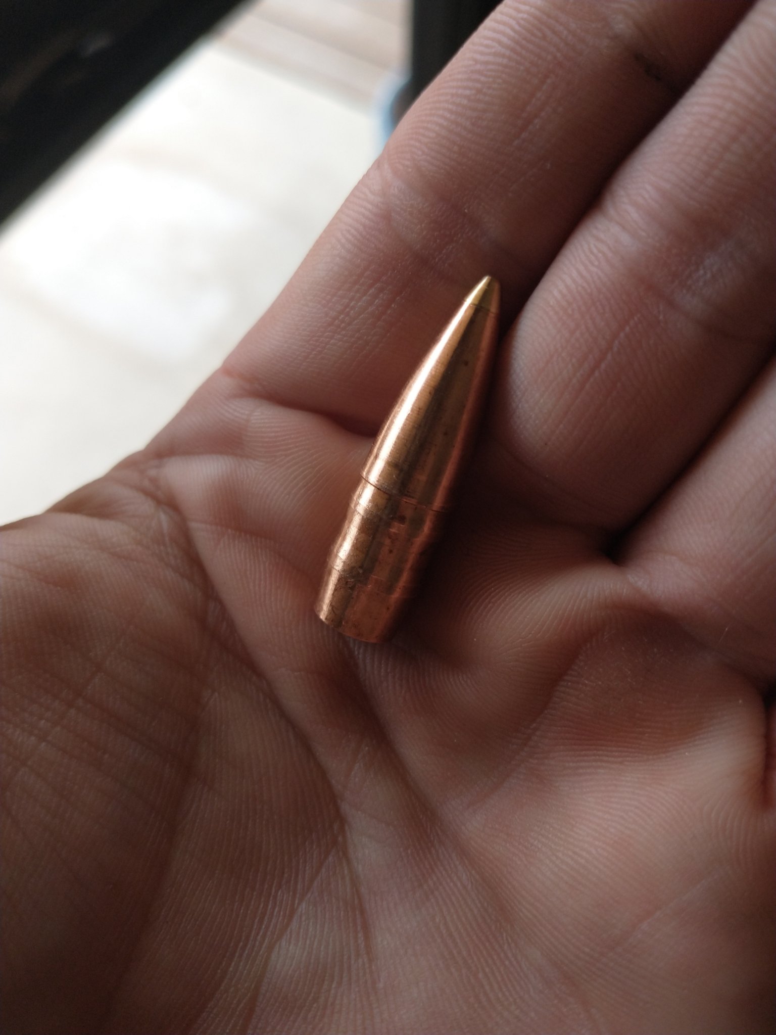

So I started on other bullets, hollow pointing 270 gr Speer, hollow pointing 235 gr and thinning the jacket for more explosive expansion on small game.
Making 165 gr out of copper.

You may know more than I on this, but I am not sure how accurate those stability calculators are for subsonic.
I thought I read about that issue somewhere. The round nose shape may also change things.
I do hope the 400gr makers stabilize well with my 10 twist.
I did get some 137gr hammer bullets to try on lighter game.
The round nose would require a slower twist being closer to the bore and shorter lenght by design for the same weight compared to long pointy match bullets.
Bullet length is a big factor in stability, the other is altitude, and temperature is a smaller factor ...12 and 10 twists, they'd be all stable at 4200 ft or above in elevation. I have that here, just gotta drive a bit farther.
So we'll see how the bullet stability calculator works with subs and around 12 to 1500 ft in elevation.
Don't have the answers so I'm doing the experimenting.
Whats nice about the Maker 400 gr is its long nose is hollow, so ya don't lose much weight to shorten it. But shortening the bullet is the best way to stablize it...or hunt at high elevations.
I believe a 10 twist will stablize the 400 maker, at least for close ranges where one is likely to use it.
Bullet tumbling increases wounding and alot of these bullets tumble after impact and a bit of penetration, as they lose gyroscopic stability, for many reasons like loss of a petal, impact with bone, off balance because of weight loss inconsistencies.

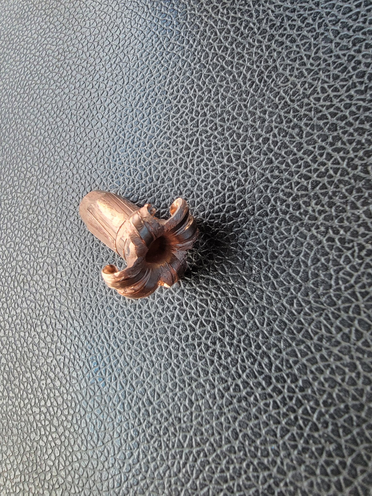

Got out today and did some Maximum load testing...
Except for 2 400 gr Maker modified to 388 ...shortened to 1.742" from 1.805" and weighing in at 398.
So take 10 grains off the bullet shorten it 1/16" cause it's all hollow and repoint...now it's stable in my 12 twist.
Just as predicted by the Berger stability calculator...works for round nose subs ...in this case.
Here is the basic "Maximum loads" tested ...use at your own risk ...work up if you decide to use them. Note any difference in COAL as pressures can really rise with a small shortening of the COAL.
The 300 SMK at 2125 fps ave had noticeably more recoil.
The Speer 235 gr showed good accuracy at maximum pressure. The 300 gr Sierra was less accurate around 1.3"
The H335 showed good SDs in velocity for a run of the mill AR 10.
AA 1680 appears to be good for the 388 gr Maker 18.5 gr 1090 fps.

Deep Hollow point the 235 gr Speer & thin the front portion of the jacket on the lathe.
Or even saw cut segments in the front of the bullet...
Or machine some out of copper solid.
Already did most of that except mess with the 300 grs
Just cut a bunch of LC & Lapua to length, only takes a few minutes in the mill. Cut 5hem about .010" over and they size down in length to print. A very easy case to make.

Finished shooting a bunch of sub load attempts.
Wrote down velocity, powder, velocity S/Ds, COALs for the load, group sizes at 50 yds are pictured for the various powder charges.
Bullets 235 gr Speer, 270 gr Speer, 300 gr RN, 300 gr Sierra.
AA1680 is the only one that will operate the bolt...it produced some fair groups but high S/Ds except for the 300 gr Sierra where it worked great.
TrailBoss was only accurate with the 235 gr Speer. Herco put 3 in the same hole and one down low, with 270 gr & S/D of 17.9.
RedDot had the lowest S/D of 6.0 and good accuracy with the 235 gr at 1088 fps
So as I expected the 375 Raptor is not as good of a sub round as the tiny cased 338 Spectre or the 388 ARC imp 6.5 twist for normally used bullets for caliber.
They are more accurate with sub loads but struggle with supers because they don't have much case capacity needed to drive supers faster.
The 400 gr plus should be better for sub loads in the 375 Raptor to take up powder space to get lower S/Ds. Although some here would be fine light bunny loads...notice the mostly short COALs with the light 375 cal bullets.
All things considered a fun day shooting, although hot and uncomfortable, tends to make it more tedious shooting all these loads.
