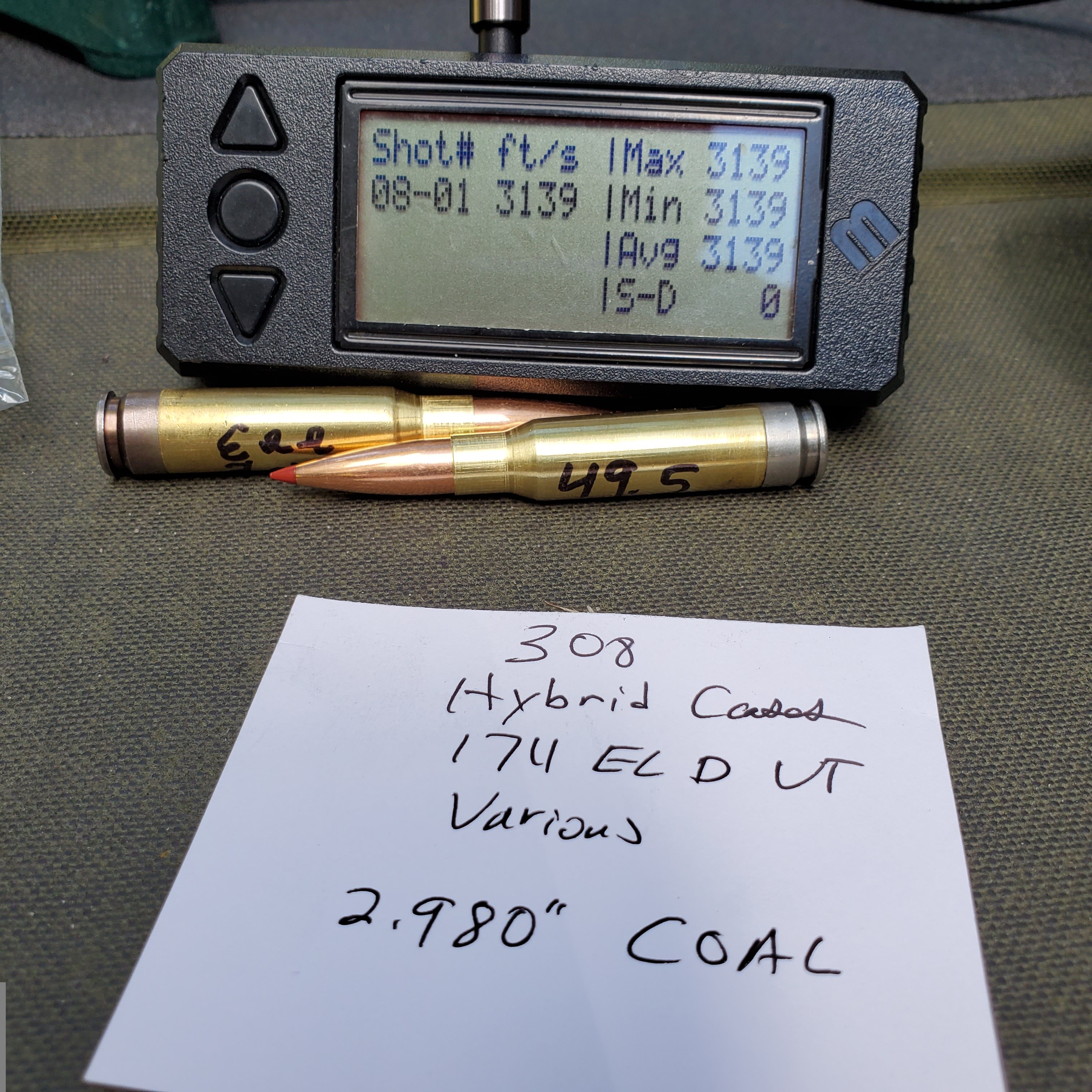

308 Win hybrid case 174 ELD-VT 3139 fps 3806 ft/lbs of muzzle energy.
1000yds 1720 fps 1143 ft/lbs.
22.4 MOA drop 64.6 " drift in 10 mph cross wind.
Mag length, for detachable MDT mags.
The rifle has a 30" 8 twist heavy palma, in aluminum chassis. Set up for heavy bullets 200 gr SMK to 250 Atips
Just shot the new 174 gr ELD-VT bullets today.

Those are some impressive loadings.
Do you have a measurement method for how high your pressure is using those cases?
It does make me wonder, seeing your results vs the factory steel head cased furry ammo, If one upsized that case even further, to 358 or maybe 375 for bullet selection, how heavy one could go with the higher pressure allowance in order to optimize for a shorter 20" barrel, like you have for that long 30" barrel. By the volume, one could expect a similar expansion rate. If your results "scaled" up with the heavier projectile, might be pretty impressive.

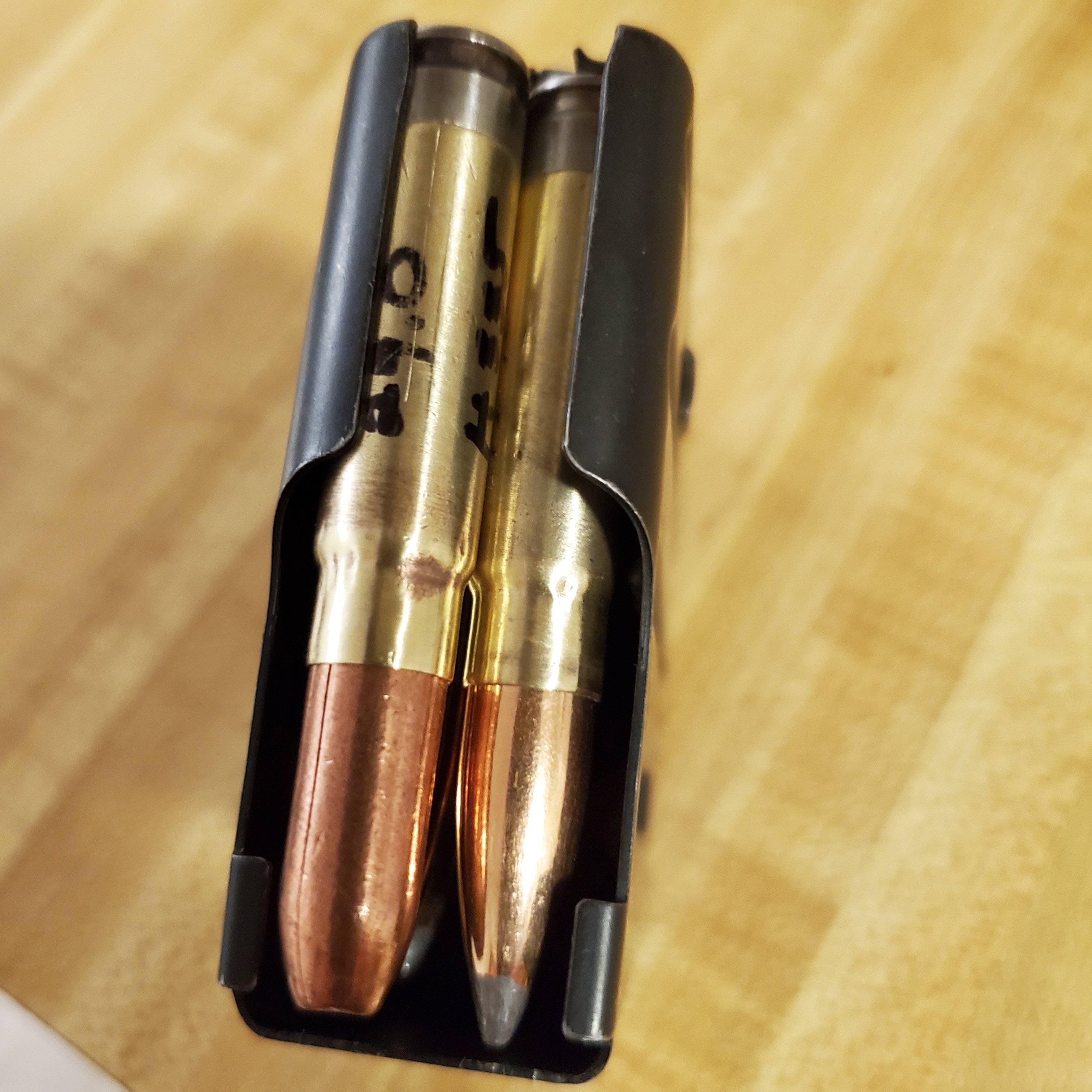

The hybrid cases have been necked up to 358 Win as I have a 358 Win... and 375 dia for fun.
But one can not run high pressure in an AR 10 much more than 62,000 to 65,000 psi.
I run the 338 RCM in an 18" AR10 at max book loads and its accurate.
The original 6.8×51 necked to 6.5 CM, .308, 358, .375.
Also use hybrid cases in 8.6 blackout to get 338 Federal high velocities... And 6mm Dasher.
Extra long 350 gr 338 Maker bore rider 6.5 twist 1886 fps in 6.5 twist, max load is 1050fps in 3 twist, which is ridiculously limited to mostly subs and copper...not the 6.5 twist, which actually makes the 8.6 a much more versatile cartridge.
The 8.6 AR 10 3 twist was scrapped as unusable for me and a bolt gun in 6.5 twist replaced it.
The 338 ARC improved 6.5 twist and tiny 338 Spectre are much more accurate with subs than the 8.6 AR10 3 twist.
Why carry a AR 10 3 twist that's less accurate and more limited than a lighter AR 15 to do the same subsonic job....your choice.

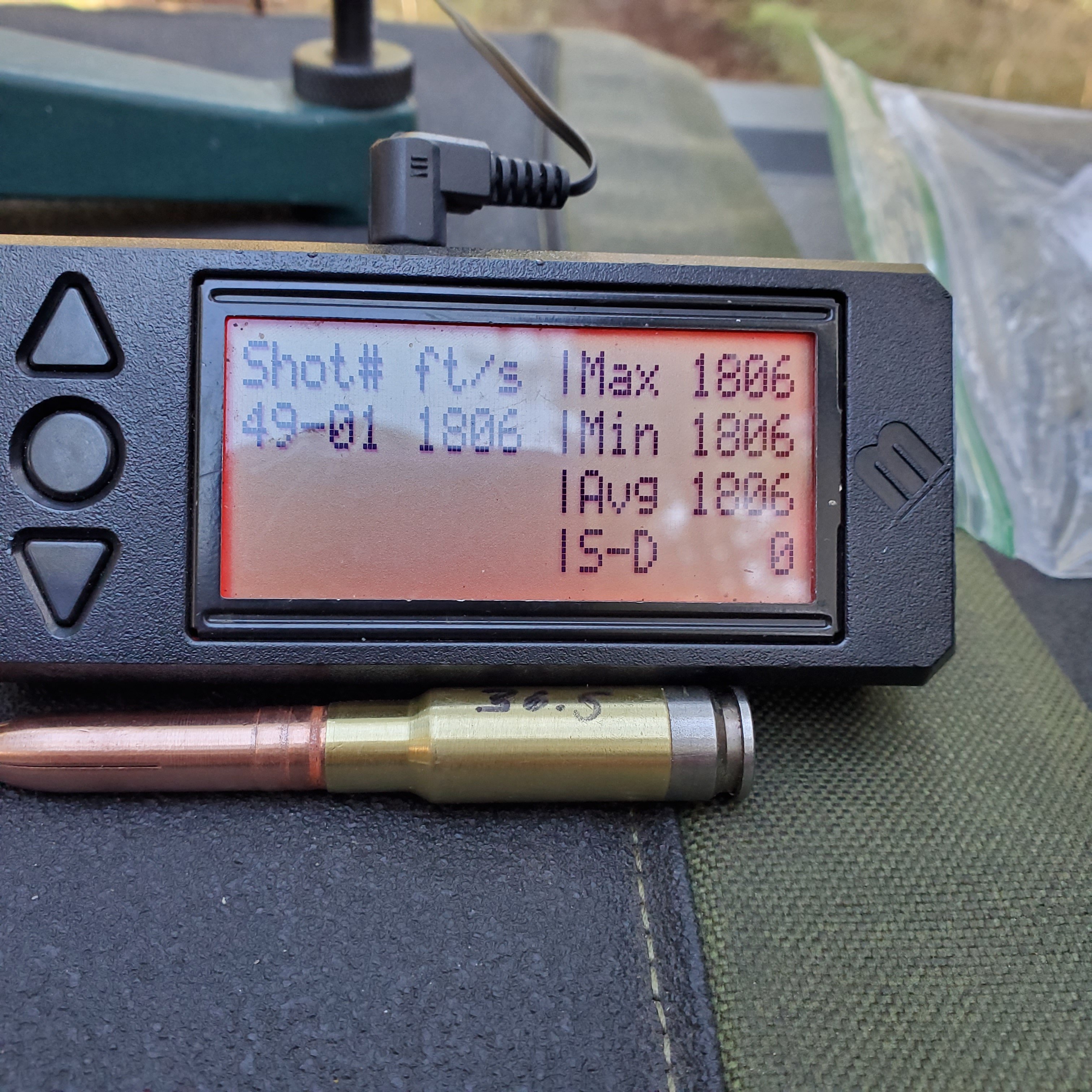

The 155s shown on the chronograph starting loads are 2815 fps some g1 bc's .45 to over .5
The good load Sierra Palma match at 2875 fps, from this light 16" 308...accuracy is very good.
The 168 ELDM 2756 fps 523 g1, or 208 eldm ay 2442 fps .690 bc. Most good to 1200 yds if necessary for long range shooting in a 16" 308.

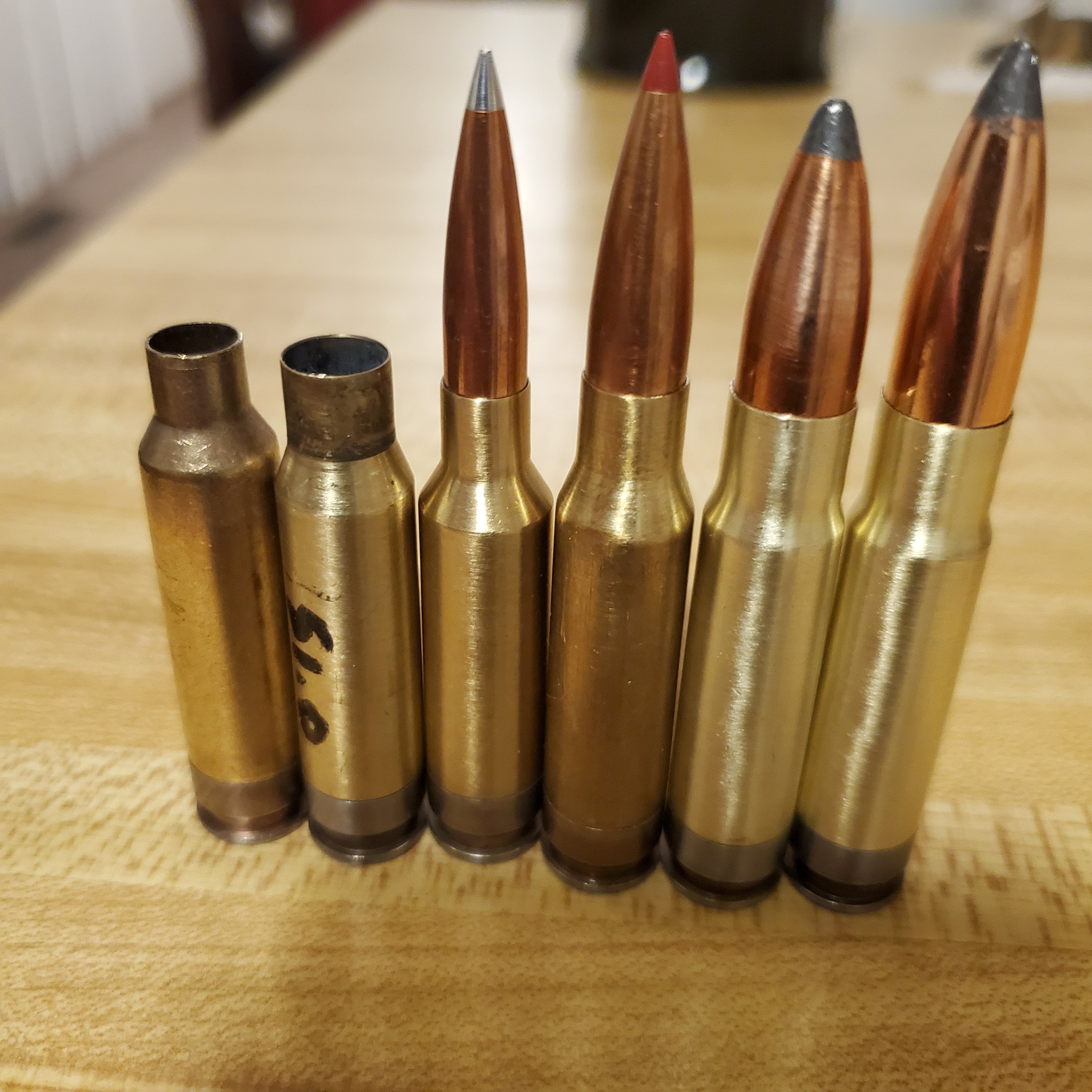

So, to challenge myself ... I'm building a 375 Raptor...the 20" long barrel is in the mail, but dies, and bullets haven't shipped yet.
Notice I'm using hybrid cases for the raptor against Lapua or LC for the 16" 308.
The 308 will have better long range the Raptor will put the short range energy on target,.... going for supersonic, I already have enough sub guns.
I already cut down and opened up the hybrid 6.8x51 cases to 375 dia. To get every advantage out of the 375 Raptor.

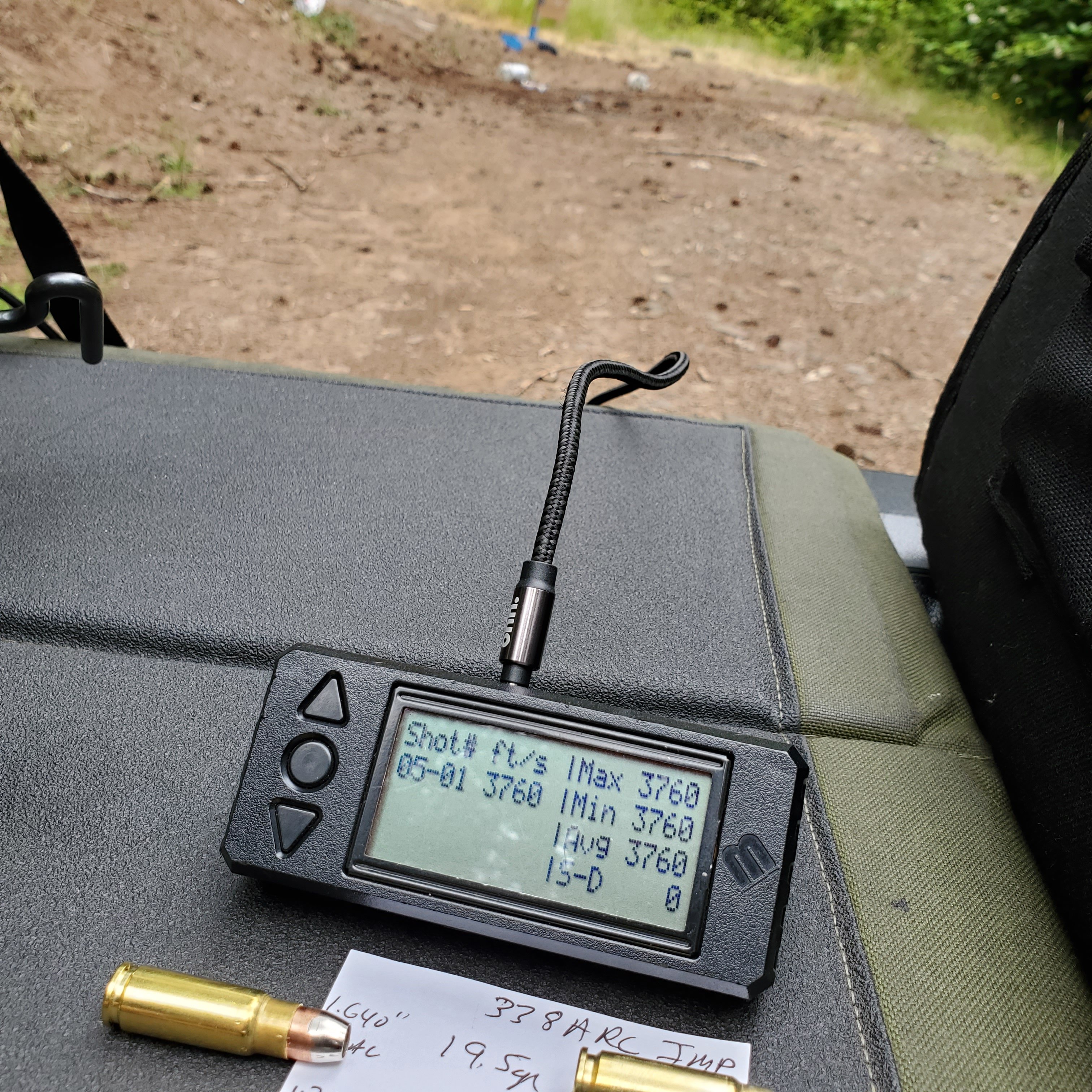

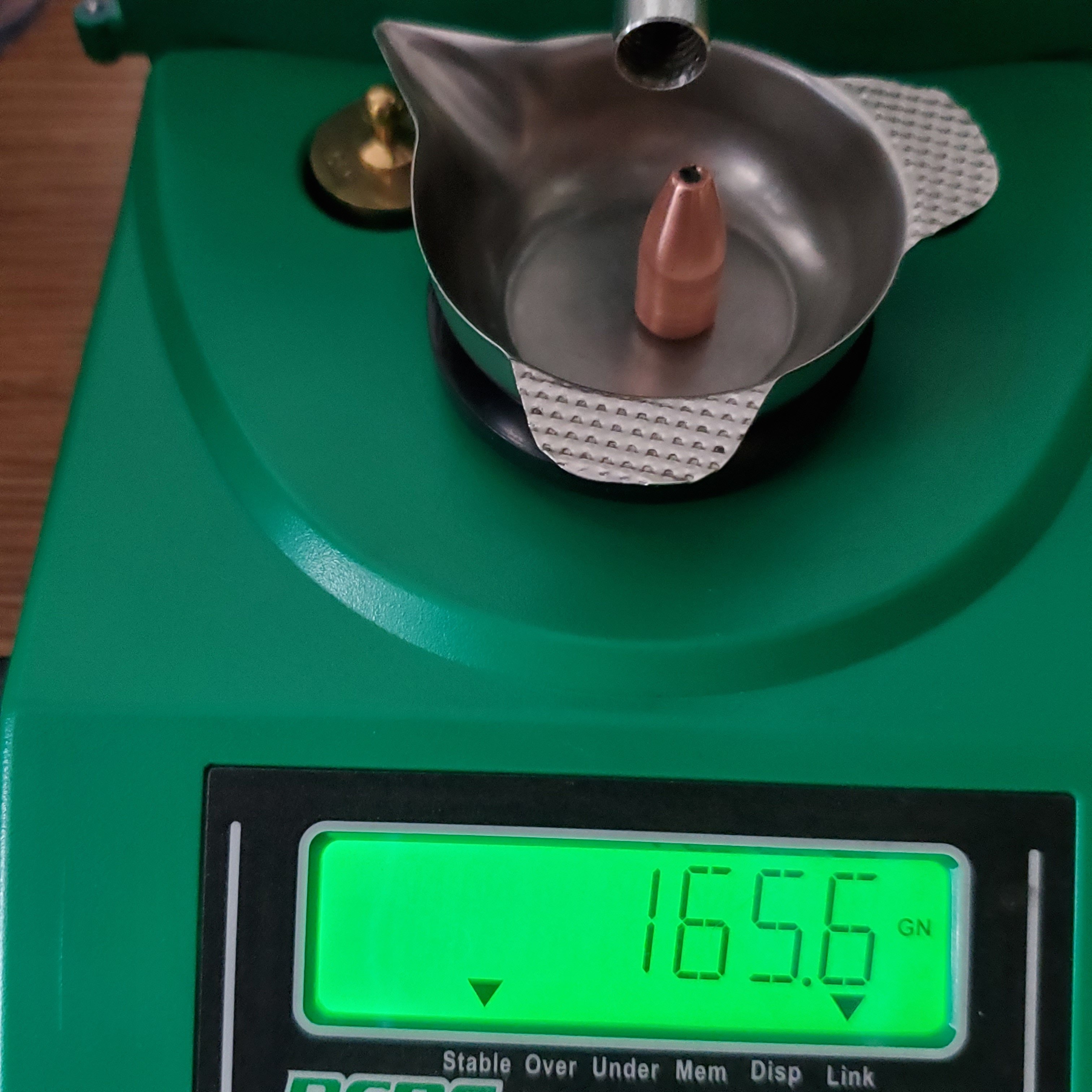

I made this 165 gr bullet to see how fast one can go with the 375 Raptor.
Lehigh Defense makes some 175 grain fracturing bullets that expand down to 1200 fps...but the BC is very low so maybe it's only a 250 to 300 yd bullet at most.
I have some 400 & 200 gr Maker bullets coming to play with along with the 270 gr and 235 gr from Speer & 300 gr bullets.
Maker does not have the 175 or 190 gr tipped in stock.
I'm not planning on hunting with it but should be fun for messing with.
I plan on experimenting with high velocity rounds mostly.

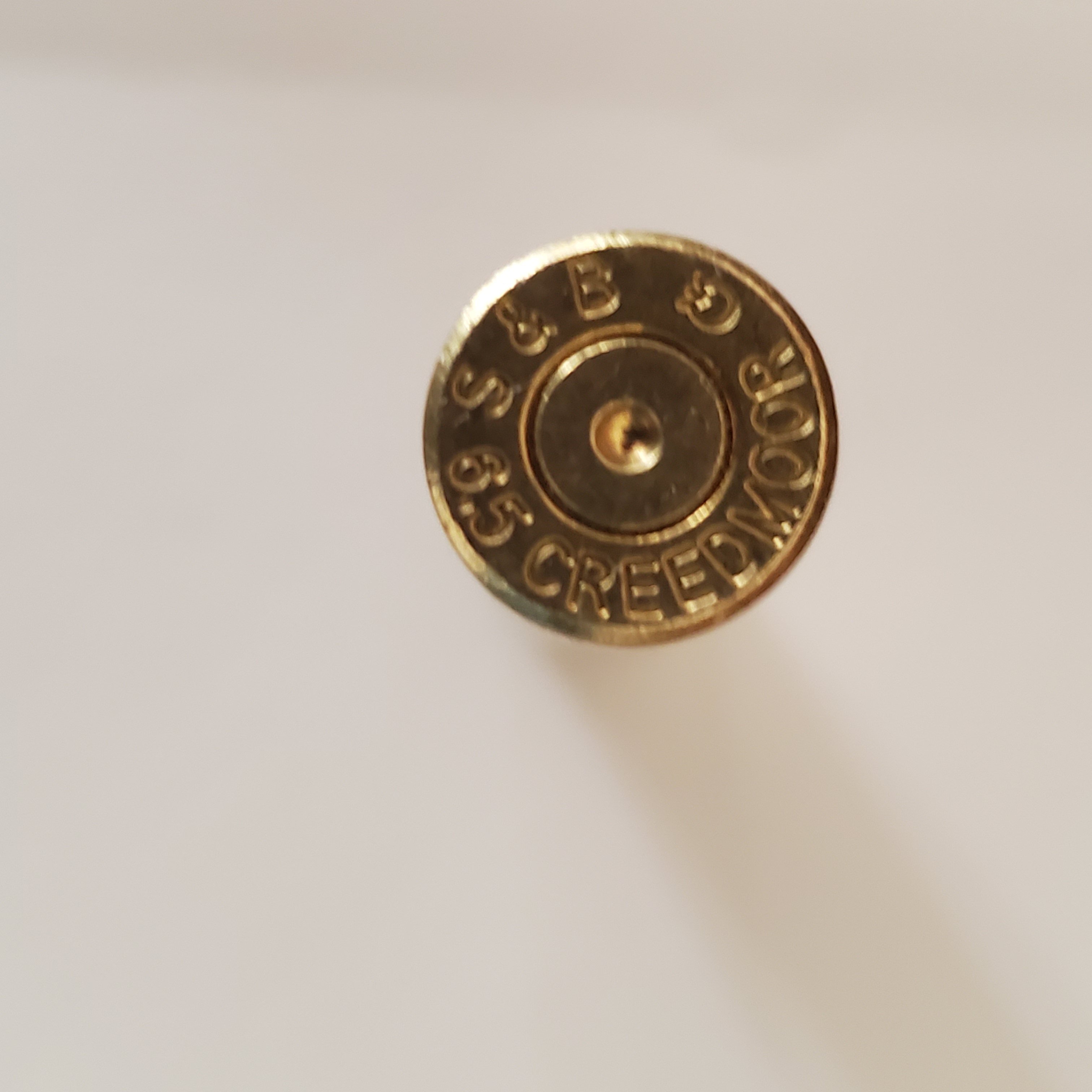

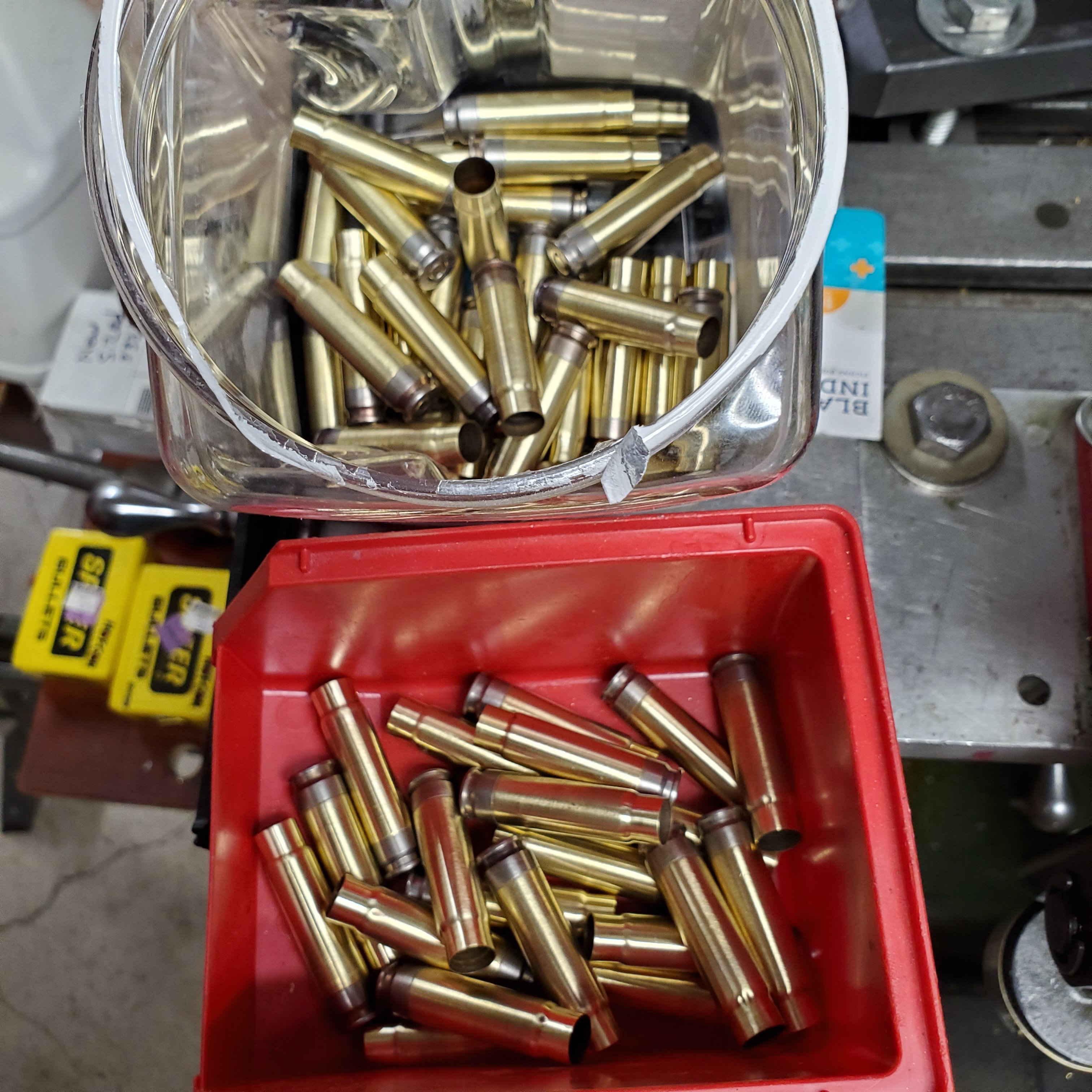

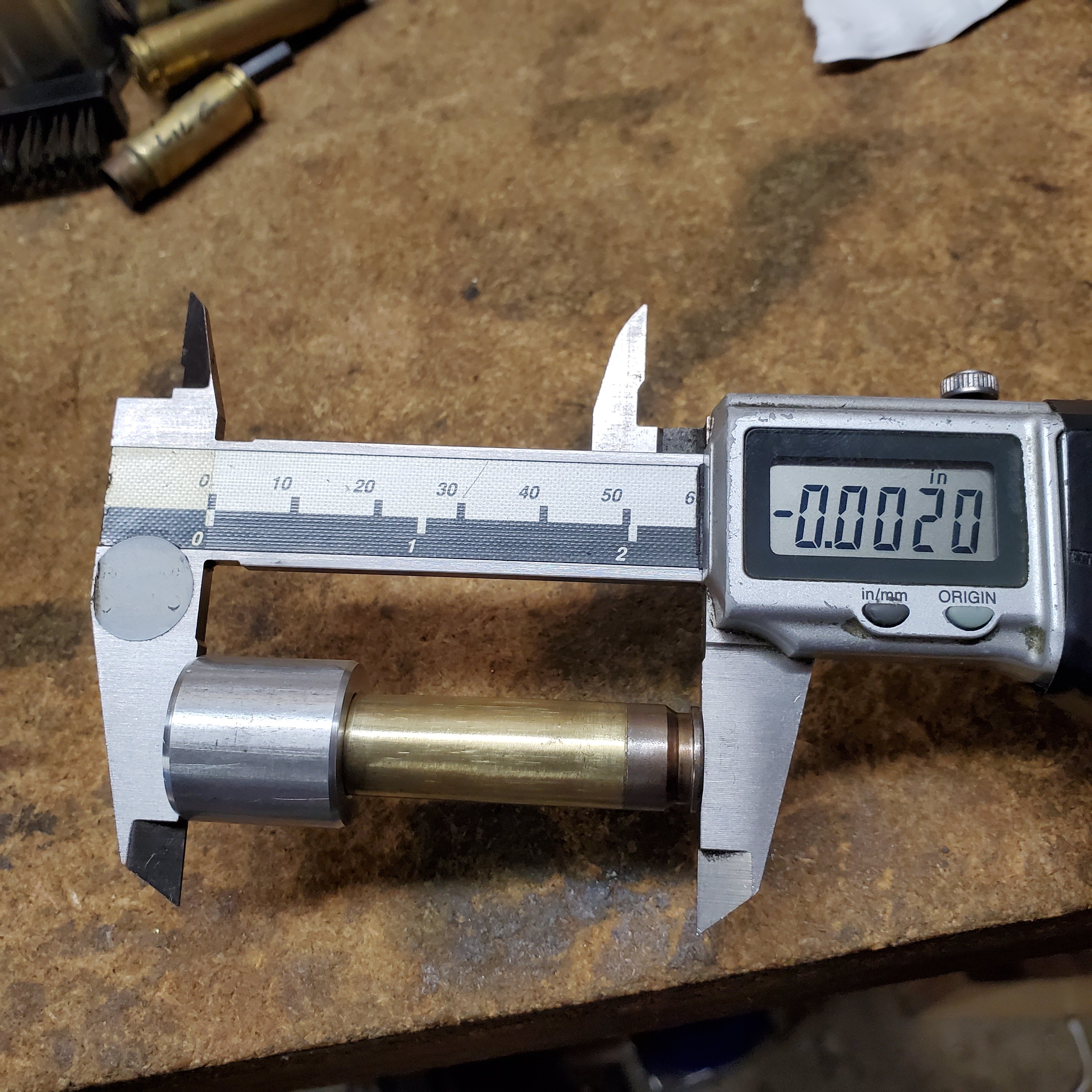

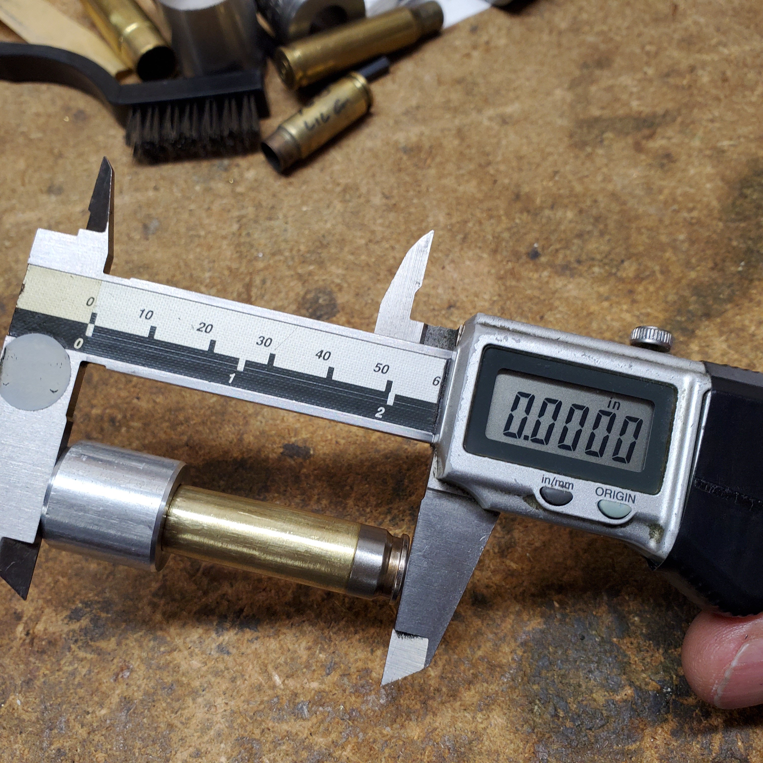

I checked out 6.5 CM to 375 Raptor...
It's totally doable, but more effort. This is to .405 cal so it can be necked back down to .375 caliber when the dies arrive in a few days.

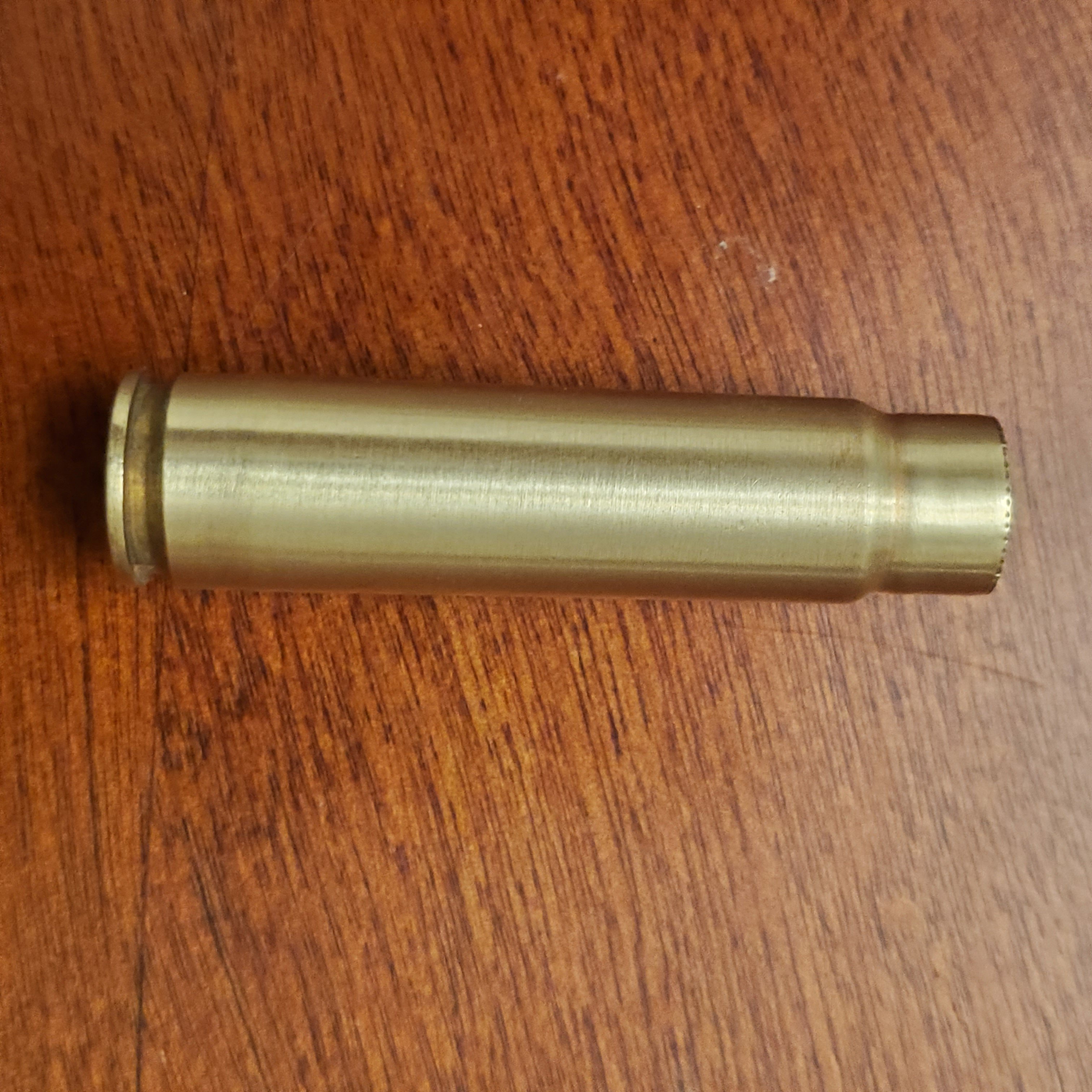

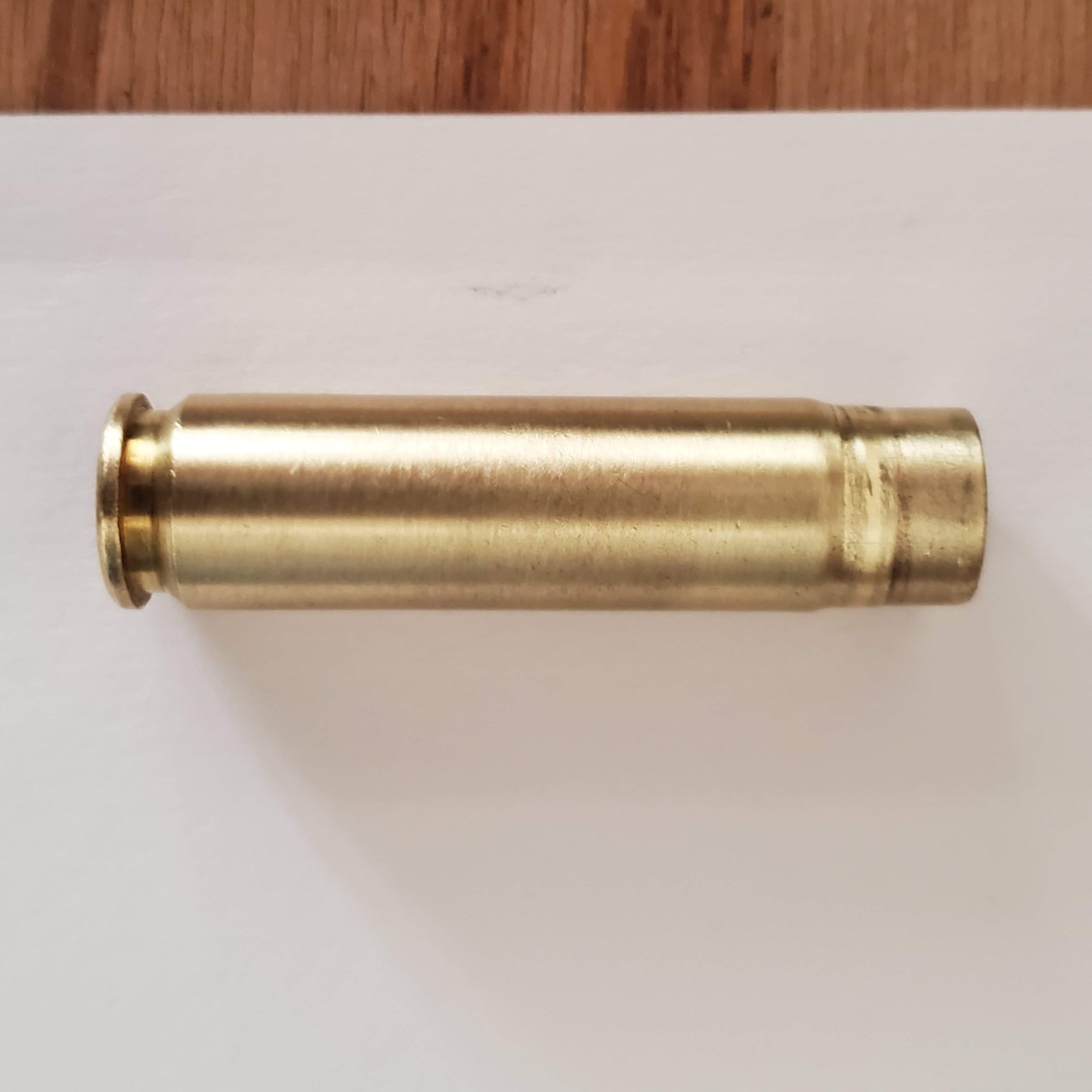

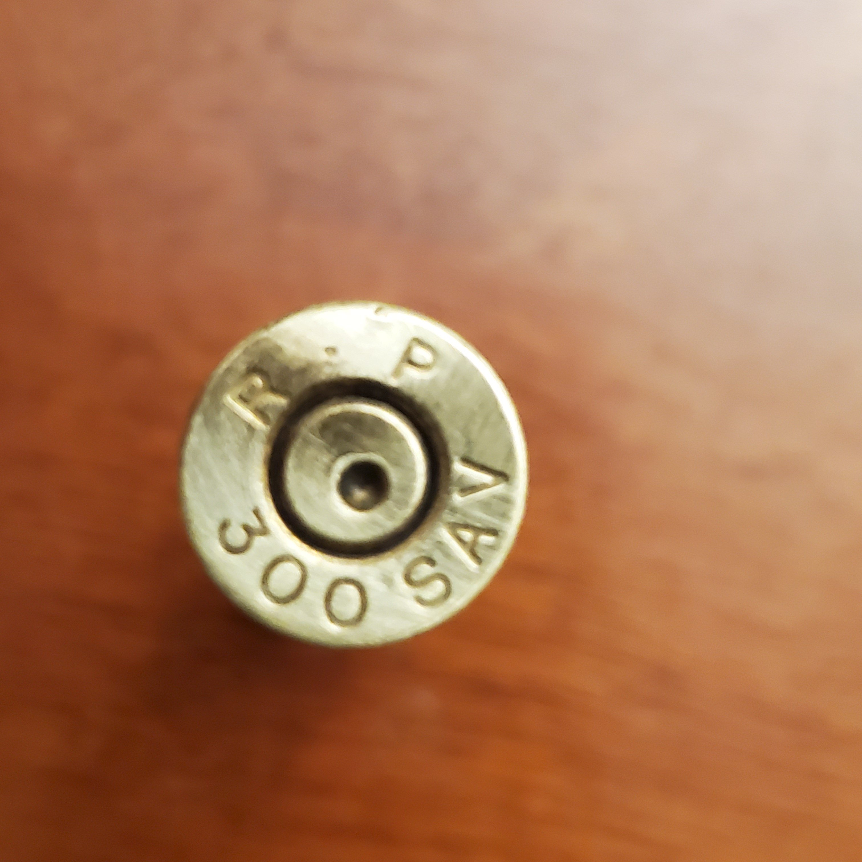

Found a few pieces of 300 savage brass.
No timing just neck up to 375 Raptor.
Very easy...the 375 Raptor is really a 375/300 Savage.
But good luck finding a quantity of 300 Savage brass...

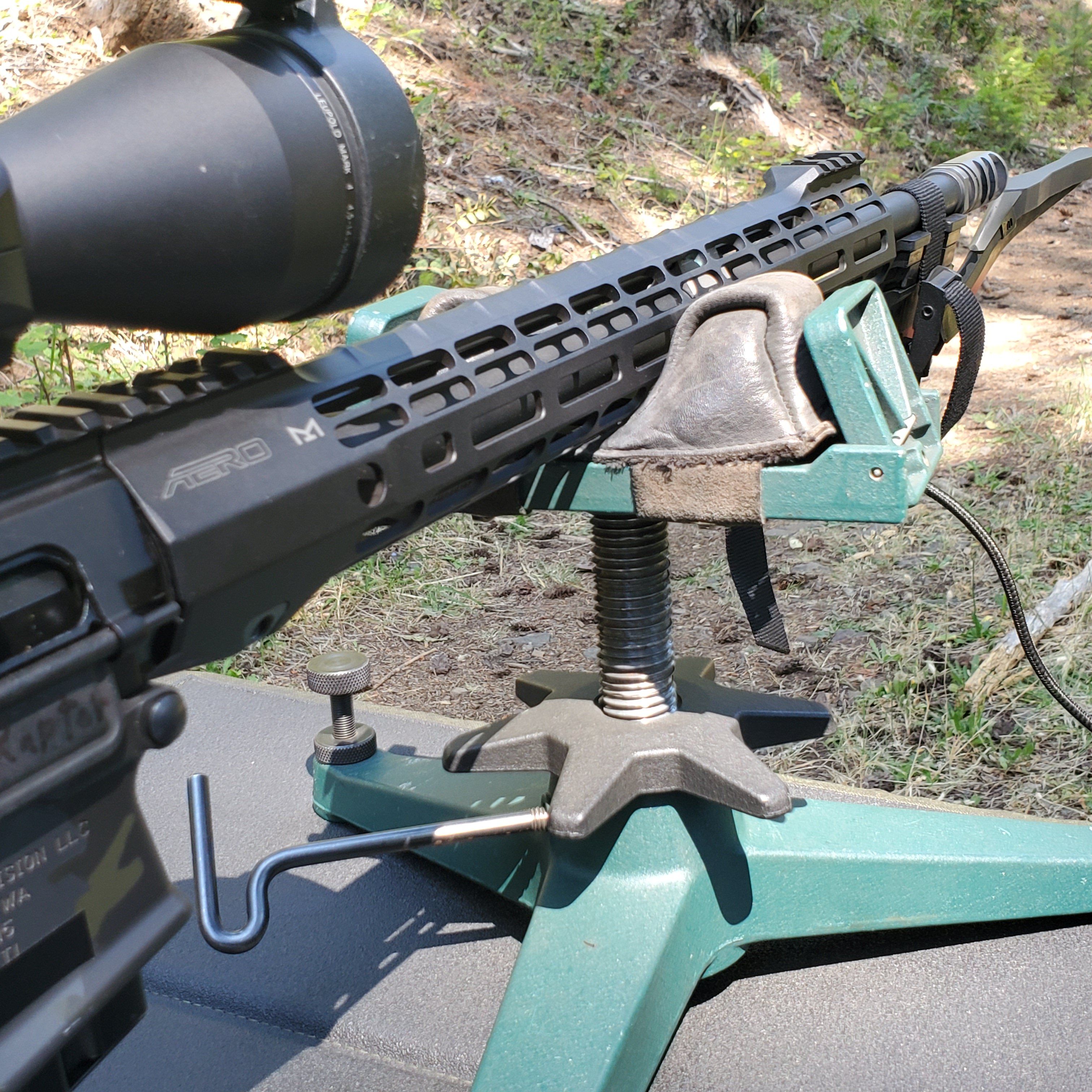

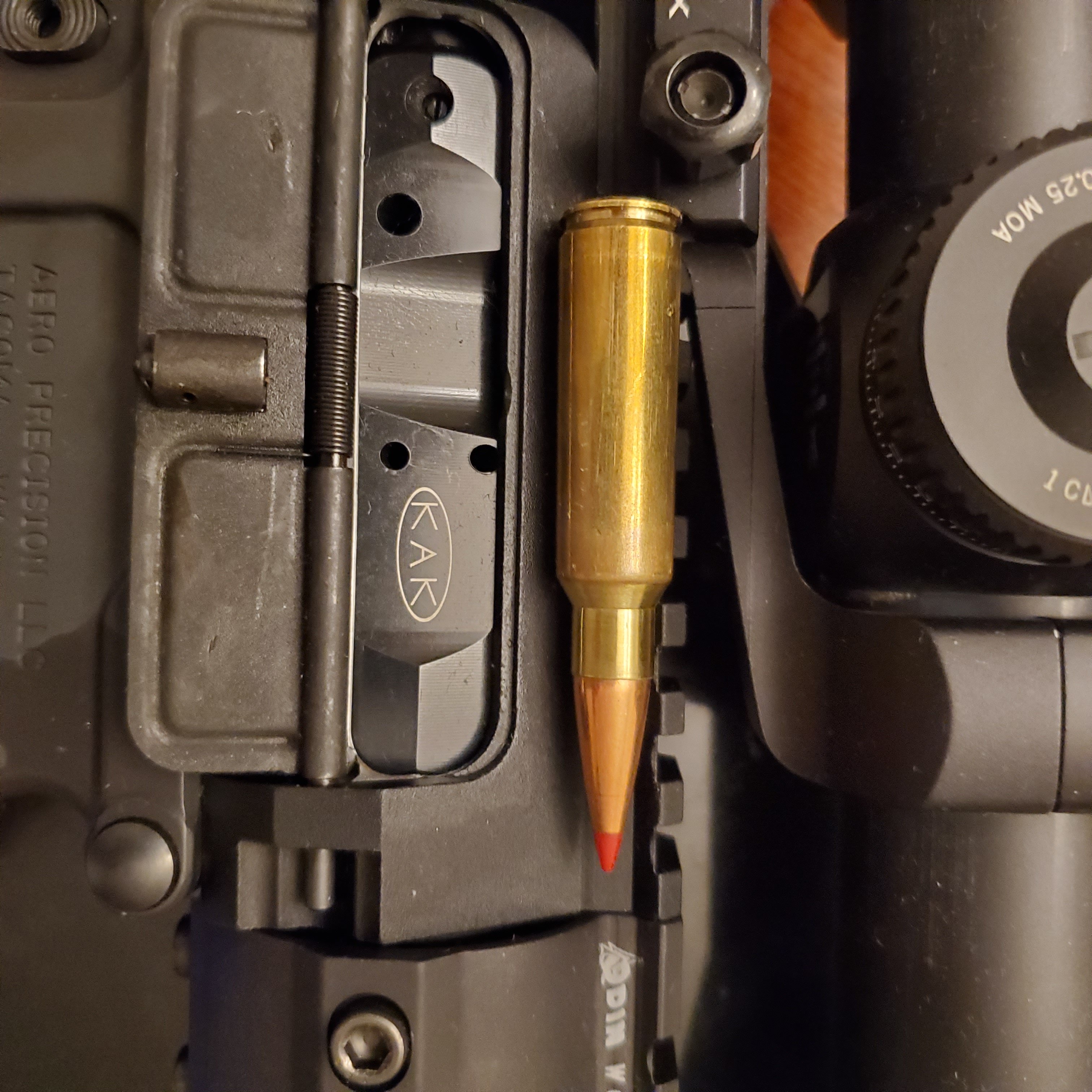

Well the 375 Raptor is complete...opened up the 308 muzzle brake to take. 375 bullet, to finish the project. It weighs in at 8 lbs without optic.

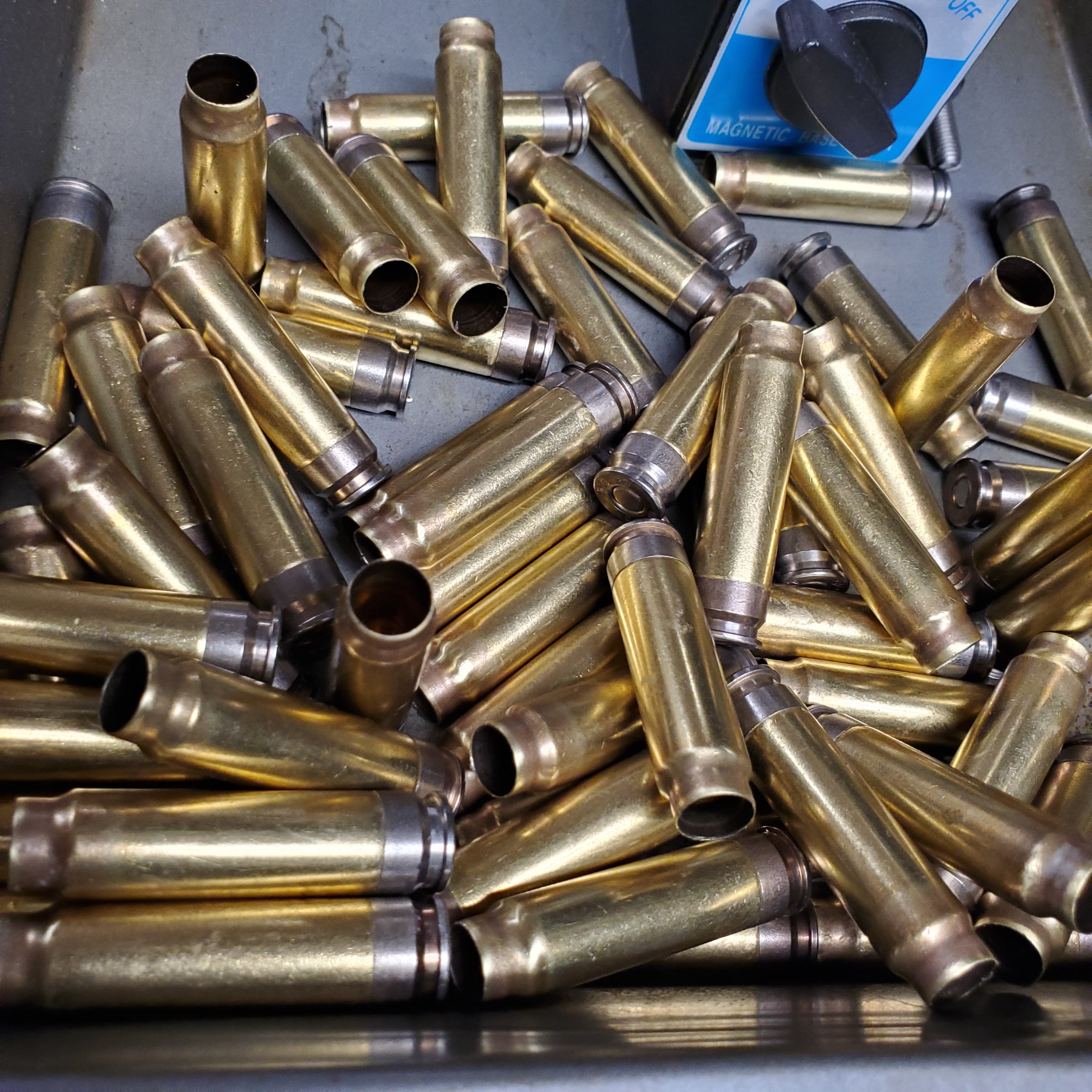

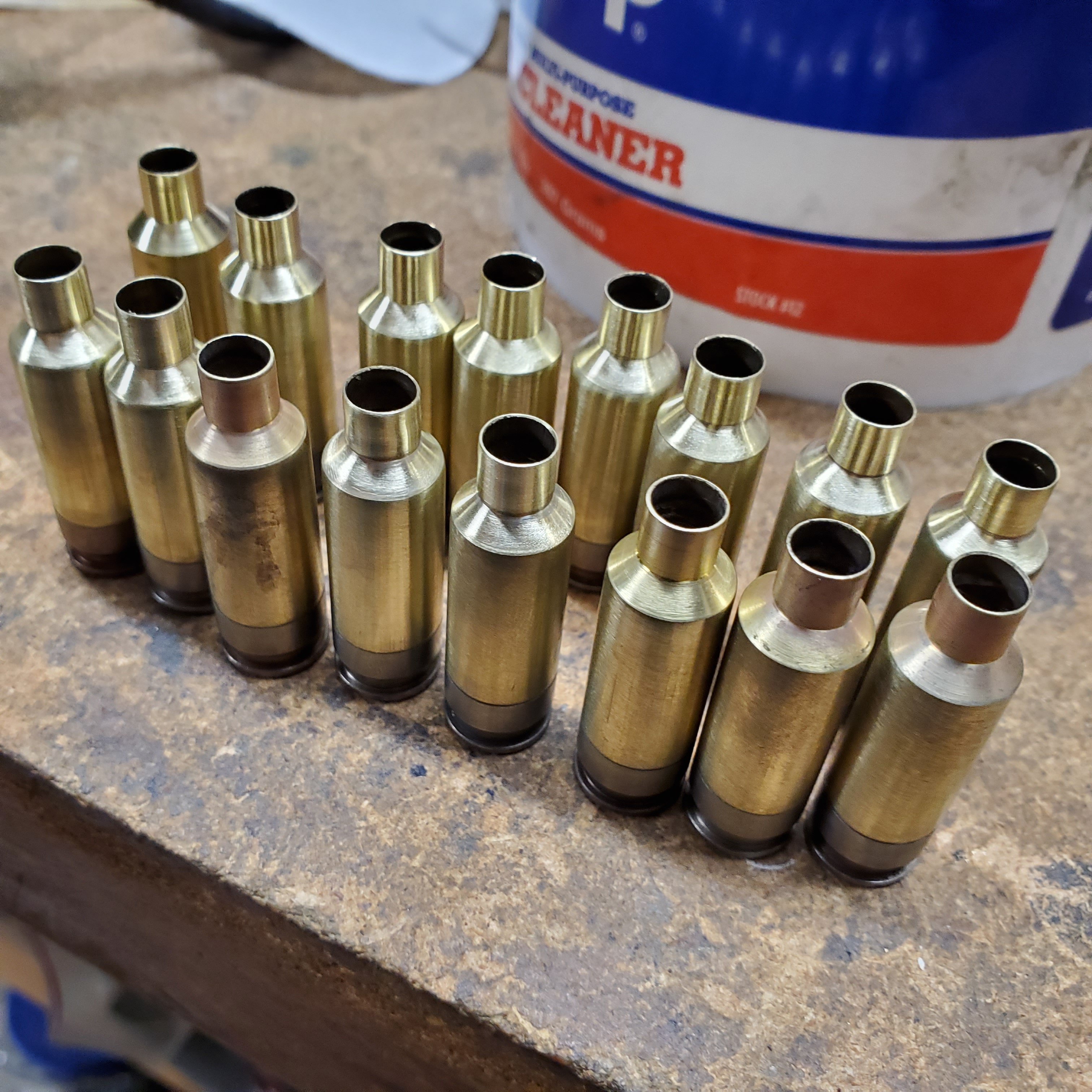

Finished up making some regular brass cases and some hybrid cases for the 375 Raptor,....so it won't be long before I get to try it.

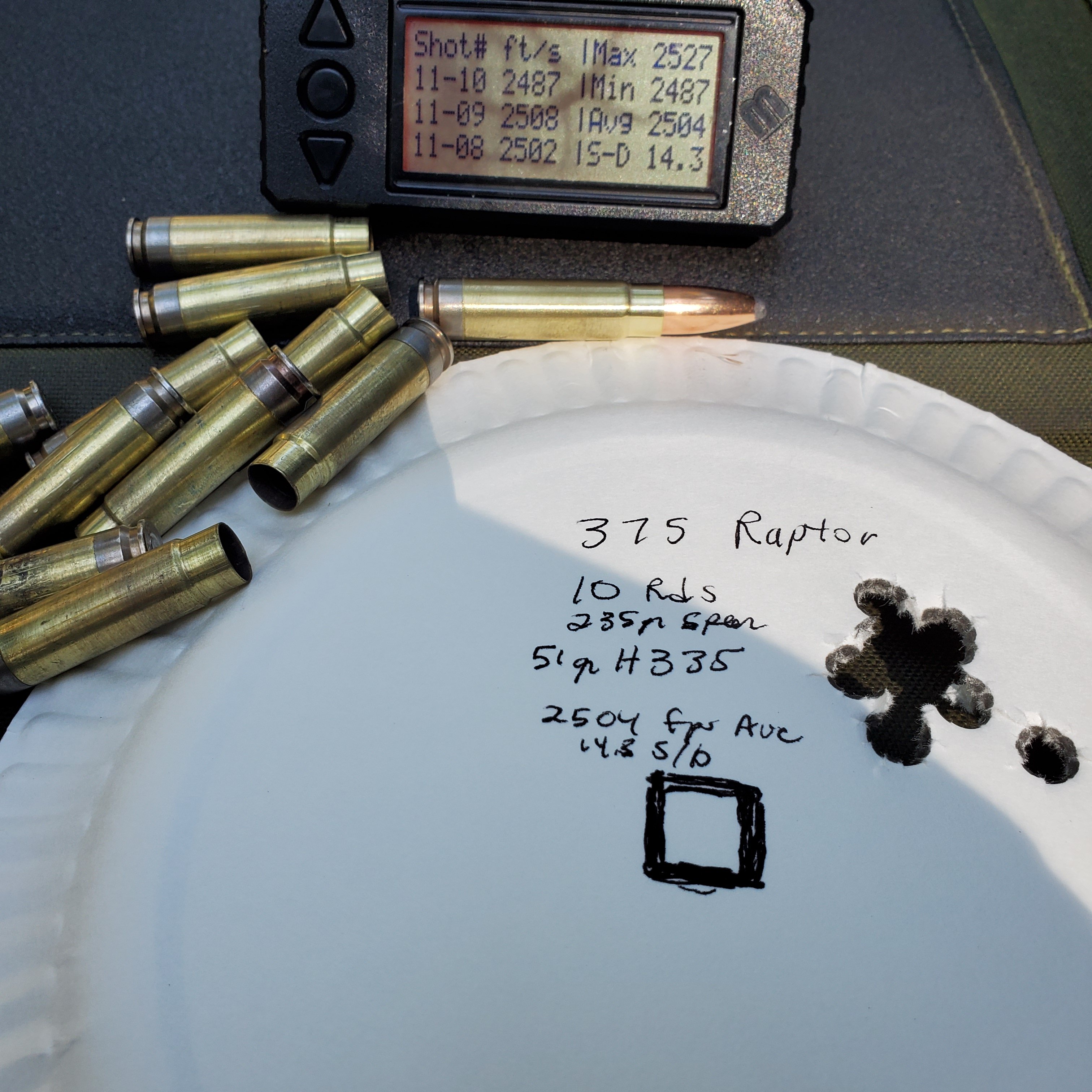

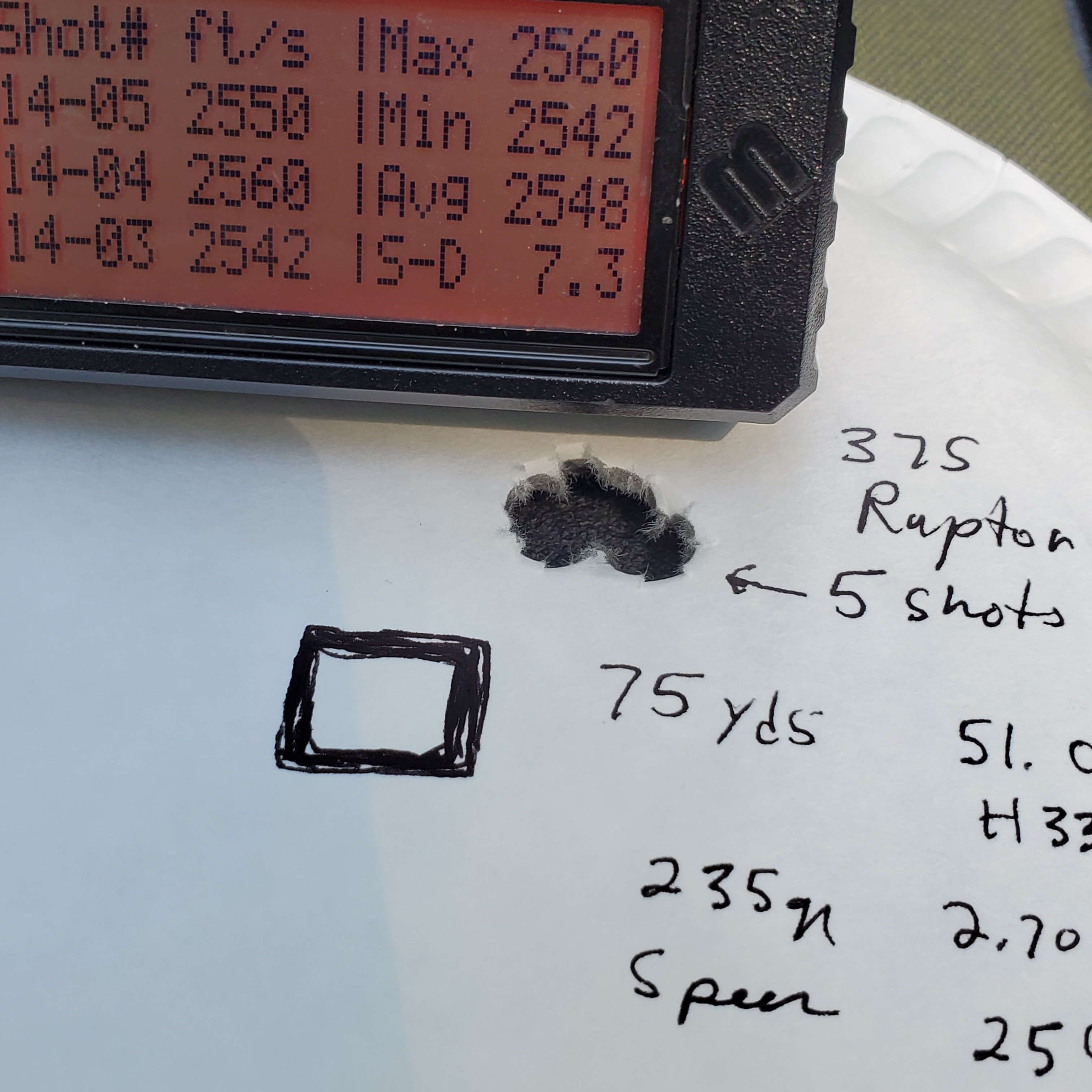

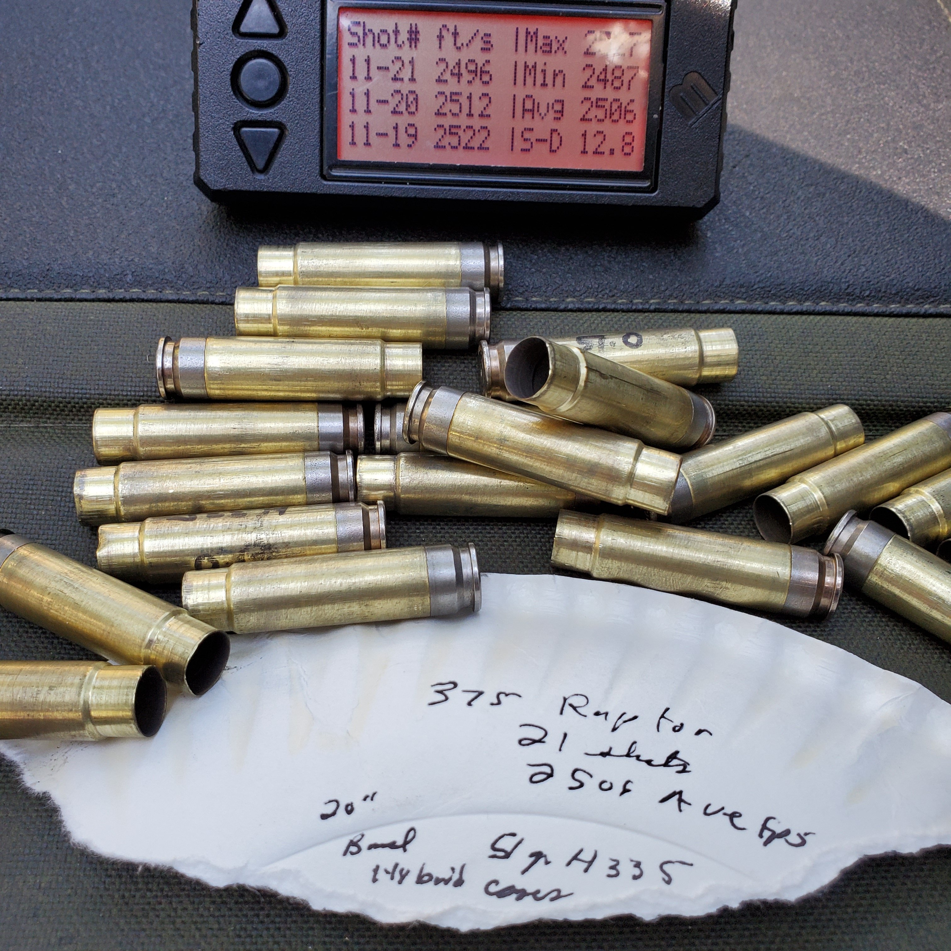

So I shot the newly built 375 Raptor AR 10... supers only. Not interested in hunting anything with subs, but I shoot them for plinking fun in many calibers.
You'll have to develop your own sub loads.
So the best super load today was the 235 gr Speer at 2506 fps average over 21 shots...its also accurate and cheap to shoot. I shot up a whole box.
270 gr Speer 2275 fps
300 gr Sierra 2047 fps
300 gr RN 2071 fps
400 gr Maker 1515 fps
235 gr Speer 2506 fps.
I have other bullets some Maker 200 & 225 with 2 variations...see if the 200 gr copper can make 2600 fps.
But today I needed some fireformd cases. I loaded brass cases and hybrid cases, with the same load and 1 fps difference in their velocity.
These 308 brass and now hybrid cases have a fairly large spread in case volume over the yrs, and between brands. So loads will have to be worked up to for your particular group of cases.
So the experiment continues.

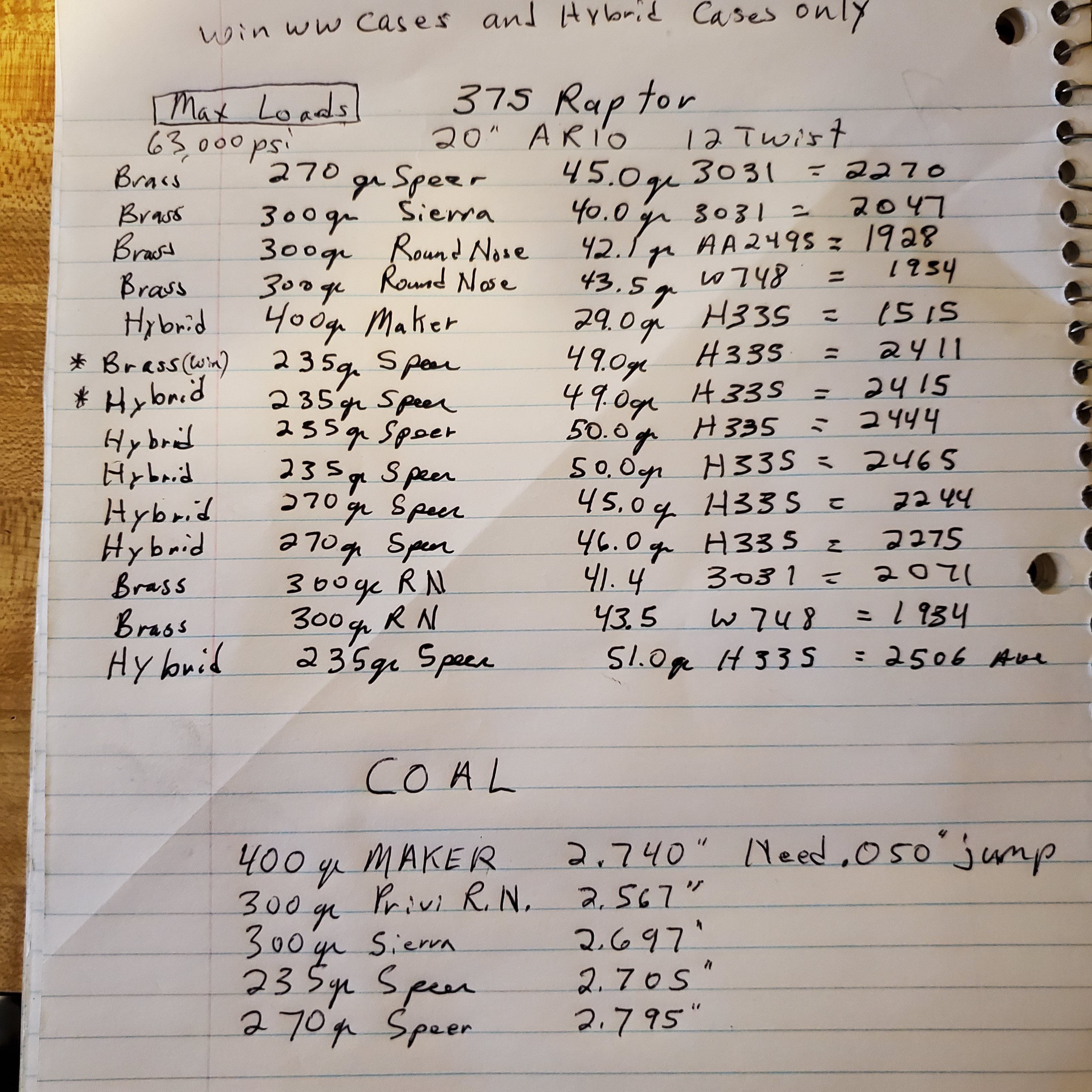

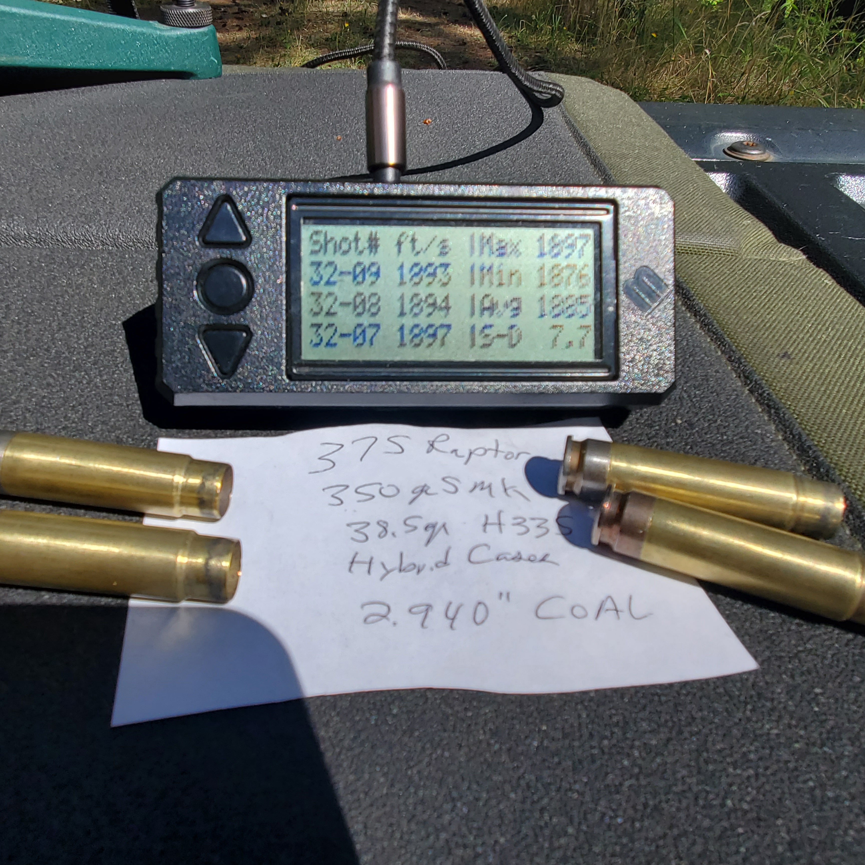

So Here's "my" Maximum Load data for the 375 Raptor with various bullets.
AR 10 20" barrel 12 twist set up for supers.
Running 63k psi approximately so its already over the pressure set down in QL and about the max pressure that can be run continuously in an AR 10 IMO.
Notice the only 2 cartridge cases used brass Winchester WW and formed hybrid have close to the same H2O capacity.
All others had less capacity, and case capacity is all over with 308 commercial and military.
My cases are now fired and Win has 56.2 gr & hybrid had 56.5 gr H2O capacity about 3 grs more than unfired.
No excessive pressure was encountered during firing of many rds.
Start lower and work up looking for pressure signs as chambers and barrels are different requiring different max powder charges.
Notice the WW brass case and the hybrid case have close to the same velocity with the same powder charge, as they have nearly the same H2O capacity.
Other brass cases will most likely have smaller capacity and require smaller charges to reach the same pressure and velocity....becareful case capacity and cartridge overall length is where you can get into trouble in a hurry handloading...any change can spike pressures drastically.

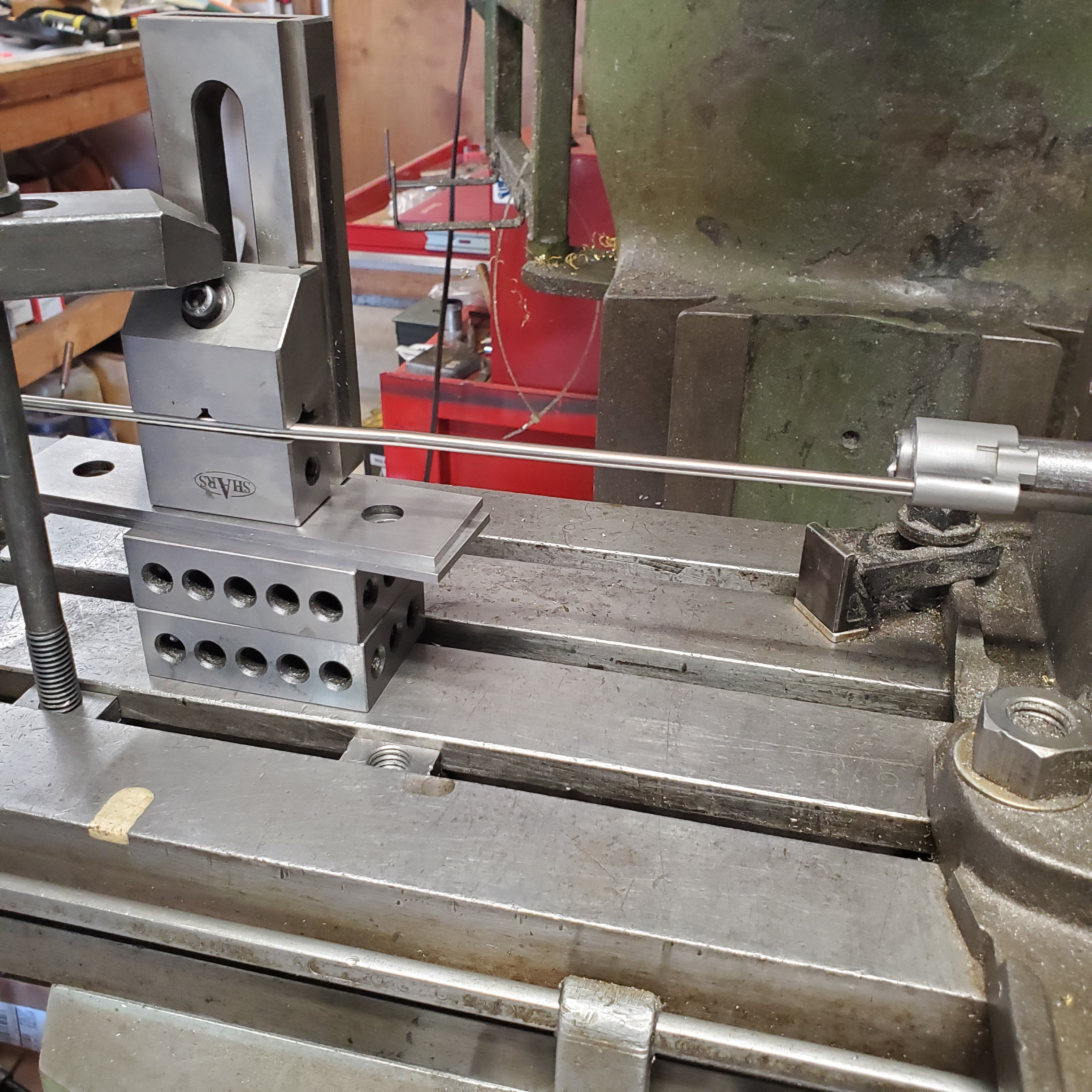

You can make your own simple headspace gauge for setting your 375 Raptor headspace from a fired case to .002" setback with your FL sizing die.

Also using some hybrid cases in my 375 Raptor, but staying in AR pressure limits...they have a bit more case capacity, for supers.
Reactions: wvfarrier

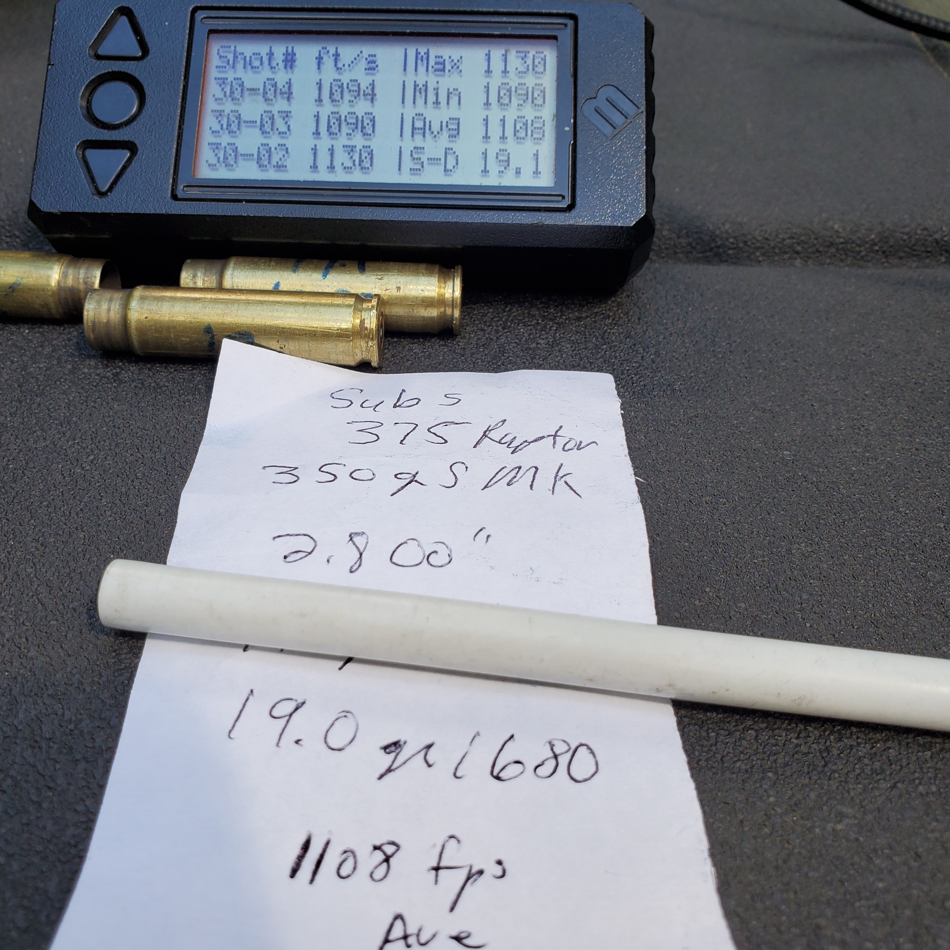

Fired some 375 Raptor loads today.
The 350 SMK was the bullet focused on.
Green Dot is a great sub load for the 350 gr takes up alot of powder space and is burnt
100%.
H335 is a good supersonic load.
Ran it with hybrid cases and LC, Win, Lapua, brass cases with lower capacity at a lower velocity.
Separated out the Lapua cases and got tiny 6 shot group at 75 yds. With 33.5 gr H335, and 350 SMK. Which can be used....a bit over1700 fps and accurate.
DO NOT use the HYBRID powder charge IT would be WAY OVER PRSSURE IN BRASS CASES
So it appears one should not shoot range brass of different makes if ya want tiny groups, at least in this test with the 350 gr SMK.
The hybrid case has more velocity because it has more capacity, and longer COAL as a max effort to see how fast the 350 gr SMK would go...about 1900 fps with this set up...Again do not use the 1900 fps data for brass cases.

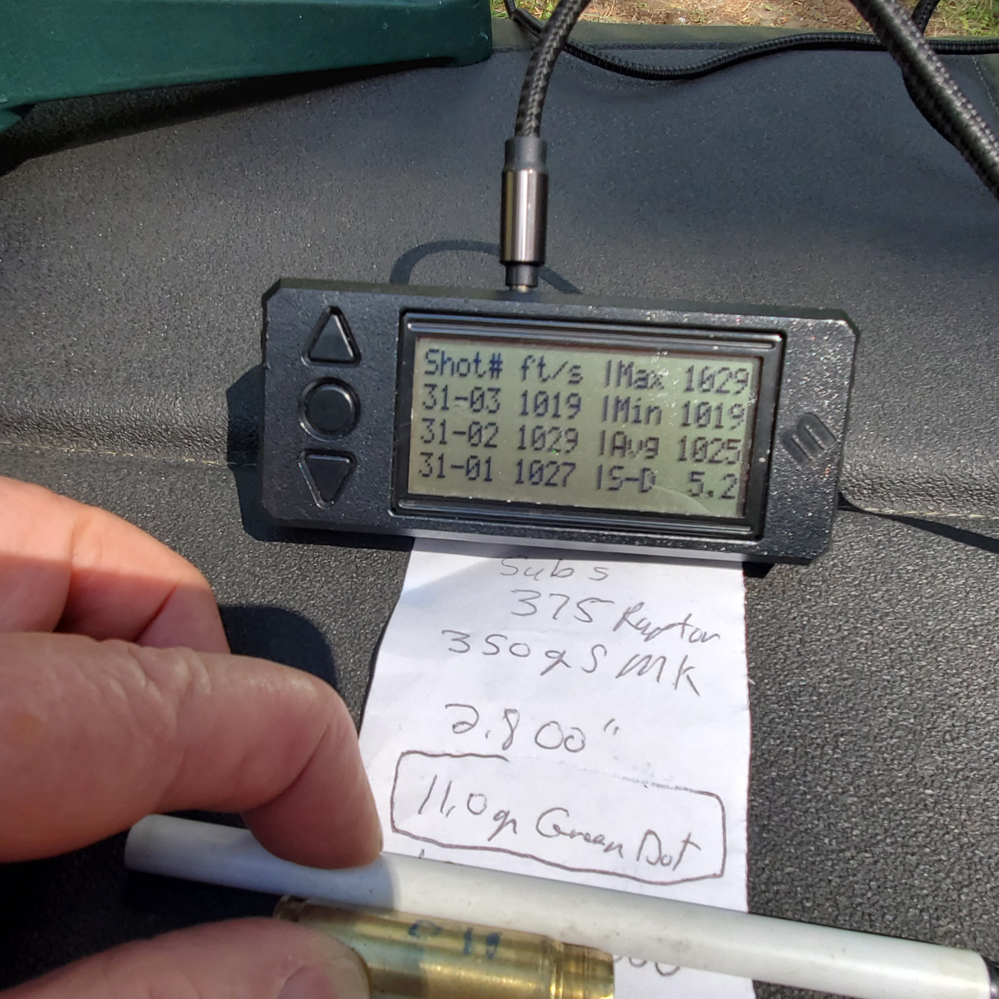

Subsonic loads with the 350 SMK
AA 1680 okay
Green Dot.... which was right on.
Good load density, low S/Ds and 100% burnt...but did not operate the bolt carrier, as is.
For informational purposes, use at your own risk. And DO NOT even think about the hybrid data for normal use with smaller capacity brass cases.
