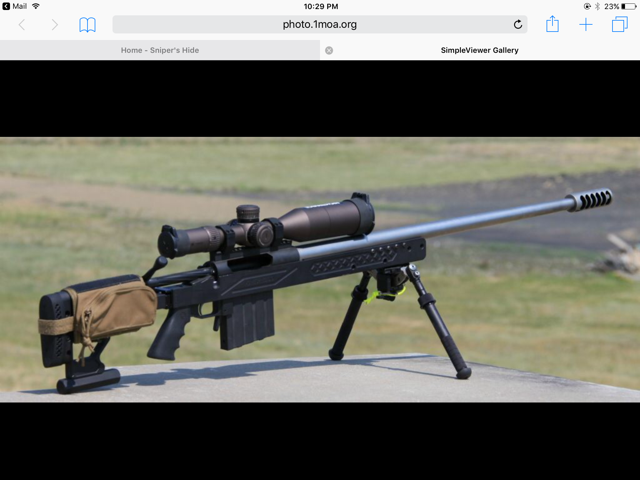

Hi fellas. I am thinking of building another 375 Snipetac. I have 2 questions for you guys.
1. Cheytac or snipetac? What are the advantages if any really?
2. Who would you have it build it? Looking for good work but not willing to pay primadonna prices just because of a name.
Any help would be appreciated.
