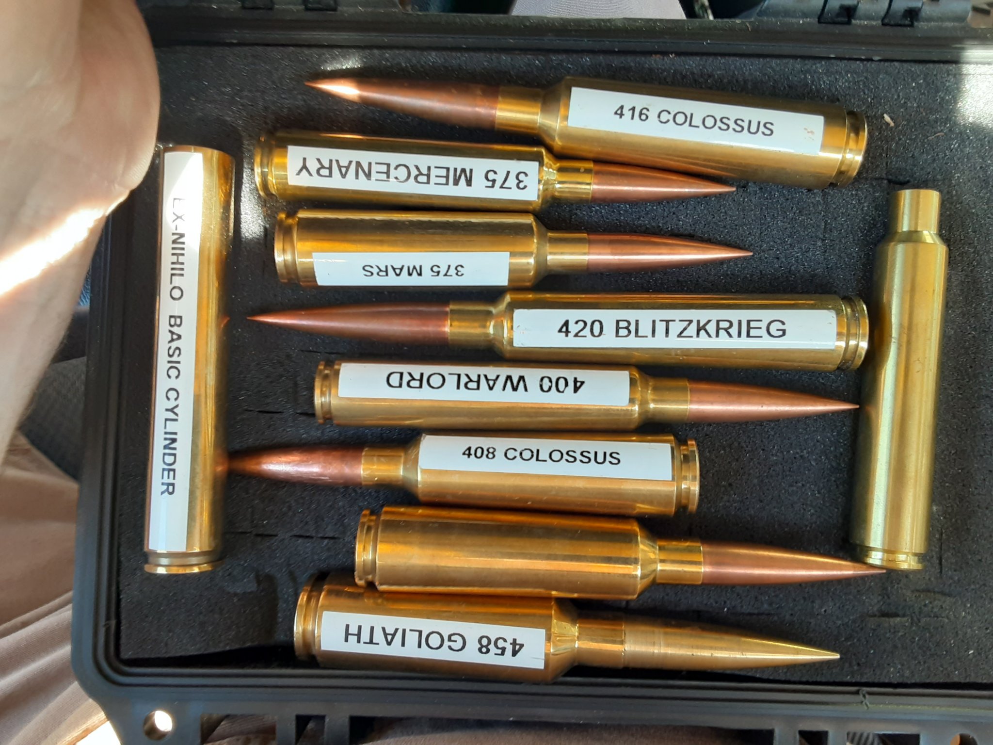

This is what from scratch means not using any existing parent web Dimension cartridge making something from scratch...
Do any of those need/have custom bolt face dimensions?
In the photo yes but its an example that can be done. Cartridges like the razor and headhunter and wolverine Are prime example non sammi based cases with no parent. But yet existing standard, magnum, lapua faces (swamplord designs ) precision rifled ordinance.

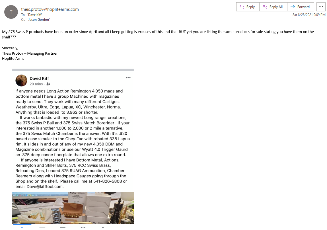

Hi,
All my comms and issues with PT&G, including Dave posting stuff for sale as "on shelf" on Facebook last night to RUAG liaison in Thun.
What is even funnier is that about 8 weeks ago RCC called me out of the blue...Talking about Dave told him I was interested in 375 Swiss P brass and I could not help it...I just busted out laughing because not 3 weeks earlier I had played phone tag with Jeff at RCC in regards to where my standard 300NM brass order was because it was constant this and that too...... all to end up canceling that order.
Sincerely,
Theis
Hi,
Sincerely,
Theis
