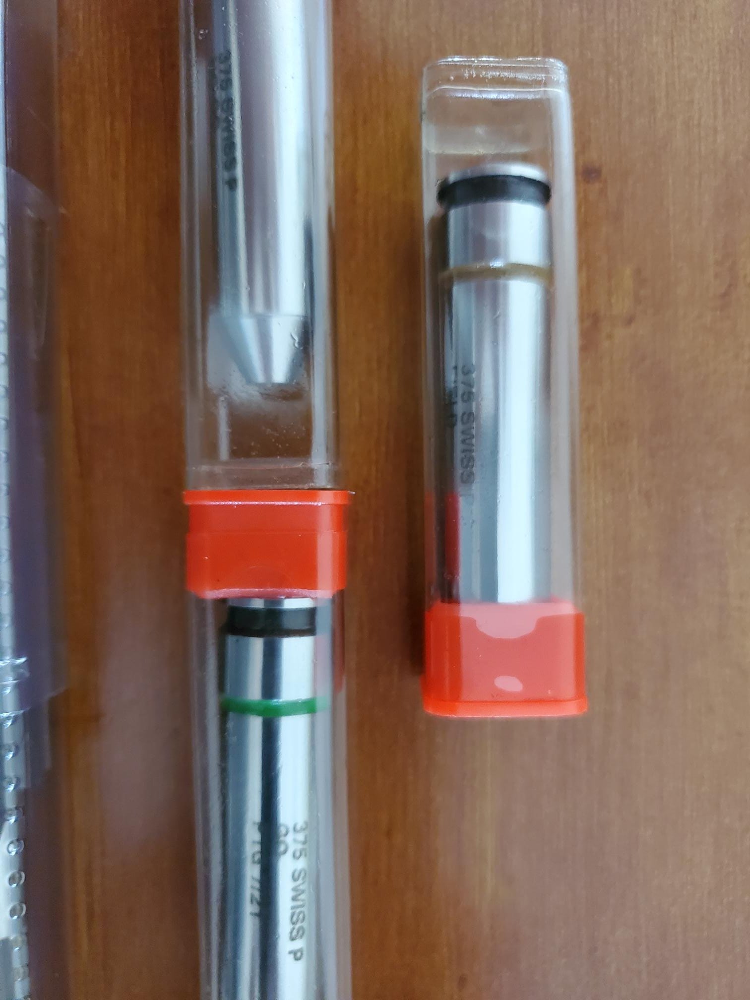

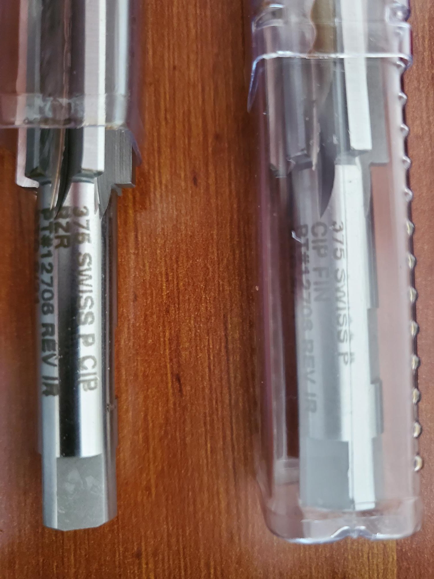

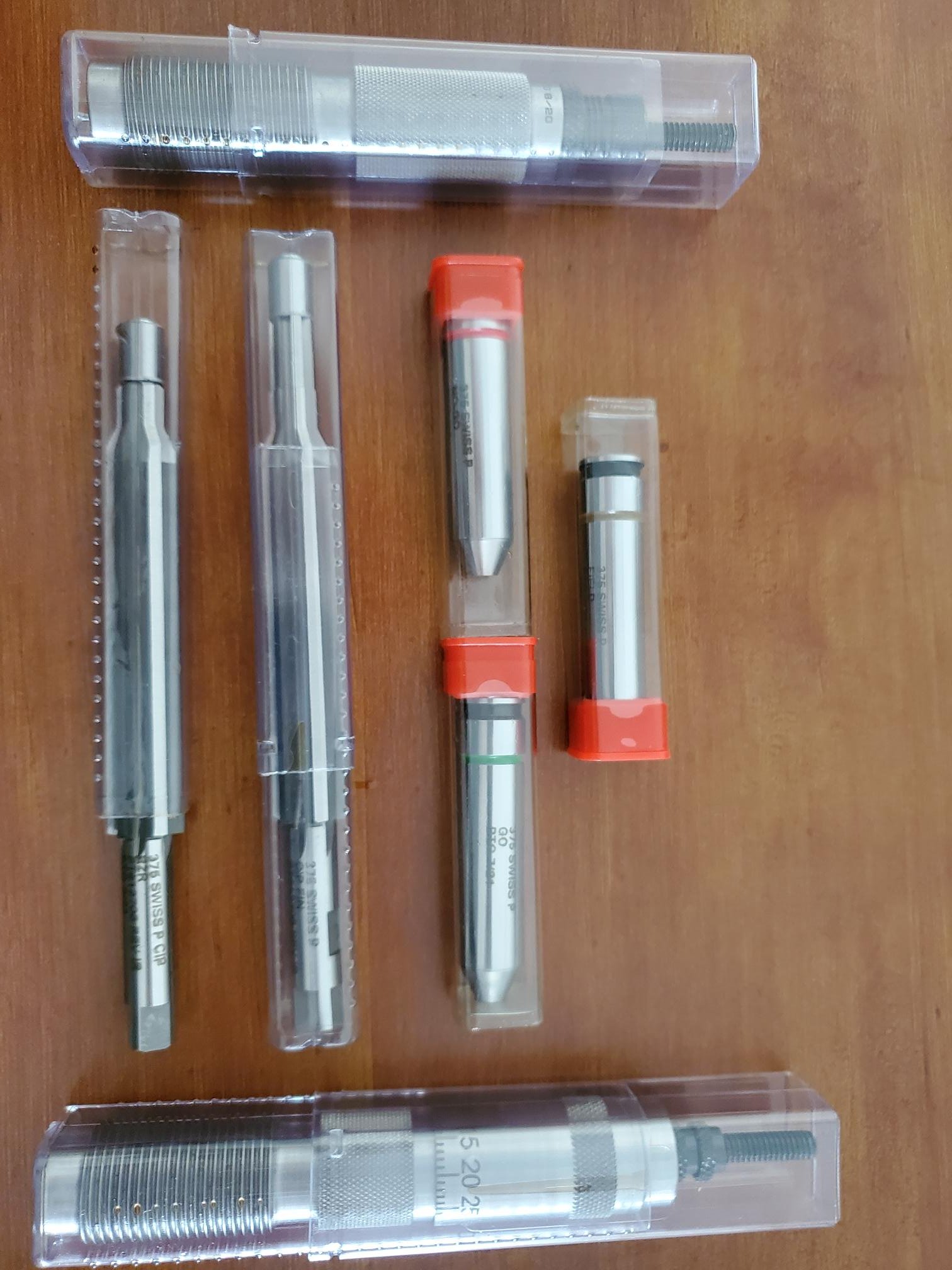

It seems PT&G had a ''discharge'' of orders as mine just arrived at Customs, order from November 2020 !!! All in vain as i had my own parts machined instead of PT&G vaporware. Someone has to start dolling out participation prizes for enthusiasts that went for PT&G -Rem barreled action deal
The reamer without the throat i assume is for resizing die? Will you be offering resizing dies to match you rifles chambers?
Now fingers crossed they are actually made to specs.

Looks like Hoplite will make own dies ,neckless reamer looks like its meant for FL sizing dies

Soon enough that will be the press of the "Easy" button....including reamers and gages.

Once we get rifles flowing to the public (That have stood by with us for what seems like eternity) we will handle everything from reamers to dies to matching chambers and more.

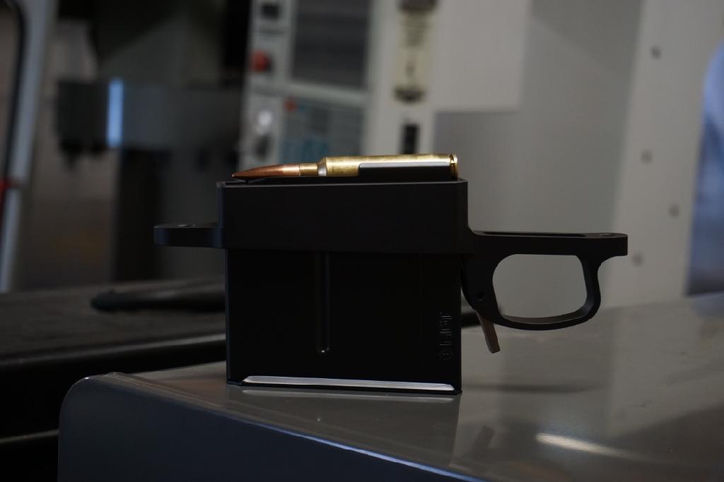

Is there bottom metal available yet for the MDT mags for 4.050"? Wondering if a 390 A Tip would be an option to magazine feed.
Hey I just noticed this thread and a company that I’ve heard about named Tierney Arms is building rifles and bottoms metals for the 4.050 MDT magazines

It’s easier to just measure. The problem is the about of room from the case mouth to the mag wall isn’t a lot. In order to get a high ish BC the ogive needs to be long. As a single feed it would be ok, but mag fed limits it when it comes to solids.

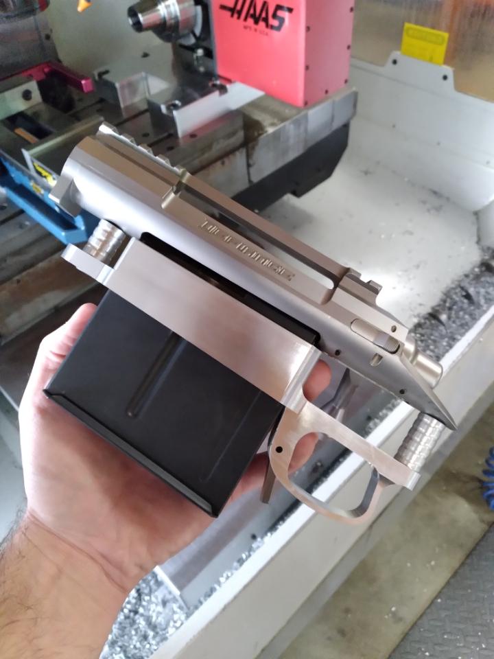

Mags are easy. working on some now. i can make them. we will soon have a extended 800 series action that should mag feed any thing made in a lapua face including mag feed of the xc cartridges.

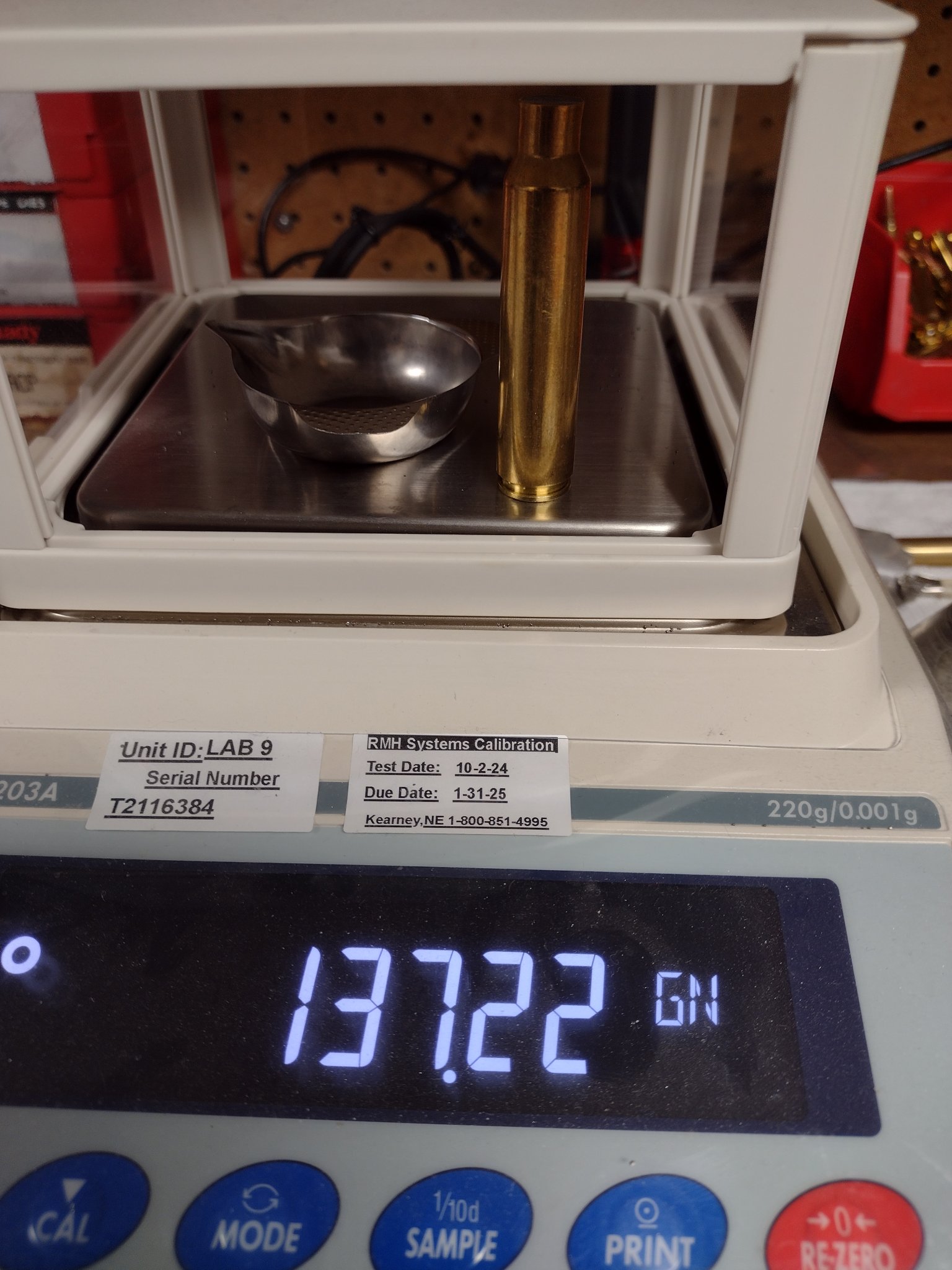

No the brass that I have is not RCC it is from Europe it is all being formed into my 6.5 Romulus. LOL the plus p is simply a 375 500 Jeffries hopefully this brass will be better and stronger than the junk Jefferies that is currently available. I am forming 50 pieces of it first if it does not hold up well the other 150 pieces that I have will be up for grabs
No the 500 jeffreys fits into a lapua face just fine with no mods its about .002 or 003 larger in the rim and is rebated . Built a 338 Kronos about 15 years ago off of the Jeffrey's case the 65 Romulus is a WSM length 6.5 designed off of the Jefferies web diameter 100 grains H2O to case mouth swamp Lord did a 375 off of the 500 Jeffries the Swiss + p is almost an exact copy of swamplords 375 mjolnir you should be able to find Post here on snipers hide from 12 years ago where swamplord did that build
