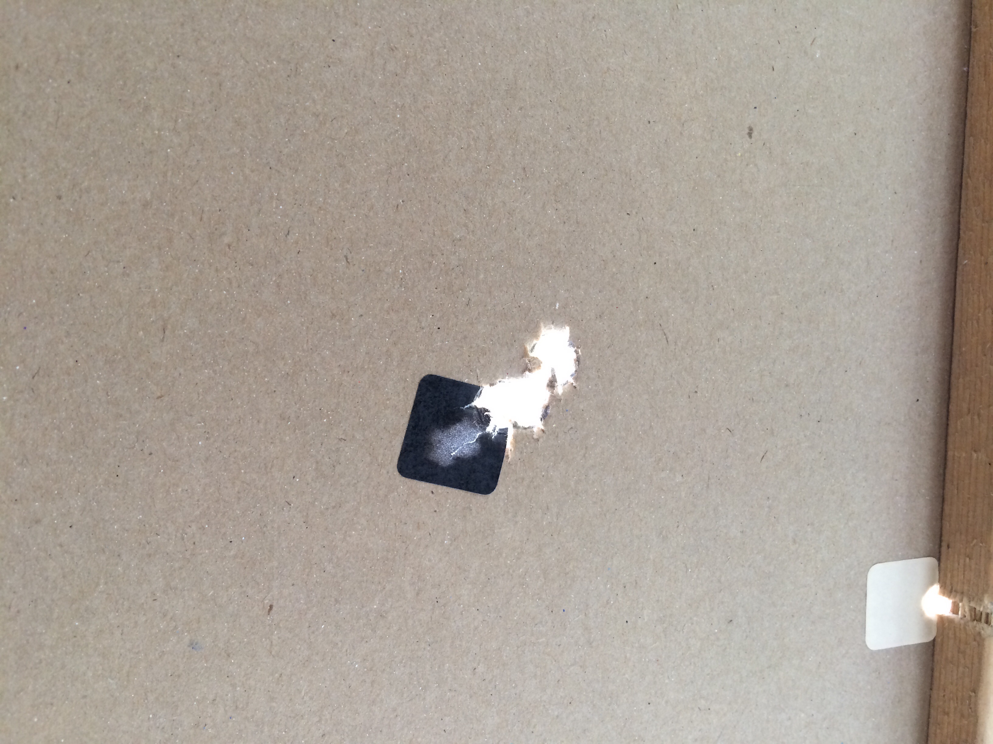

The 1000 meter testing was canceld because of hunting in the aerea around the range, so i drove down to the local range and just took some shoots at 100 m just to verify the loads, shoots like a dream, 3 shots 377 gr CE bullets on paper.
I seated the bullets a little deeper than previous, last time i fired these bullets they gave to much pressure, i had a jump to the sealtite band of 0.014" and these was 0.037", wich was perfect, no pressure signs at all.
