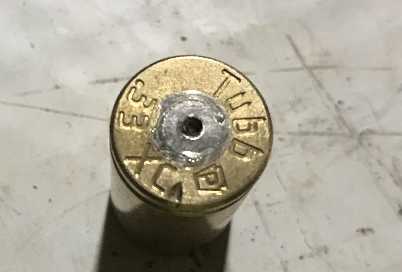

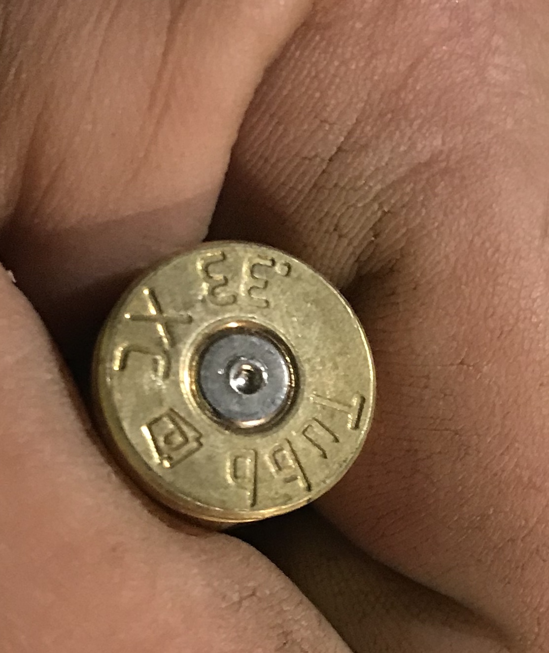

Today I loaded up 2 pressure tests. One with 350gr smk and the other with 361gr flatlines. Both started at 111gr h1000 virgin brass
Shot all the smk’s with out issues. No web expansion gravy extraction. Very first flatline Pearce’s the primer, very high pressure! Case head separation and now I got the front half of a peace of brass stuck in my chamber 🤬. Case broke about inch above the head.

This is true. And the lack of ejector Mark is odd as well. With a round that hot I would expect to see it. Another thing that has me thinking is the case broke at all. A properly fitting case to chamber shouldn’t break. I’ve know guys to lock a bolt so tight we hand to take the barrel off and the case was still intact. There is something else going on with that case other than just the extreme high pressure that’s would very well be caused by a little large bullet/ little tight barrel; or a combination of both.
Well I got the case out of the chamber. Looking it over I see the neck sealed nicely right at the neck shoulder junction. If you remember my chamber is .030” long. I’m thinking the firing pin pushed the case forward, igniting the primer, neck expanded and sealed holding brass in place. Then pressure spikes stretching case back to the bolt face and pushing primer out, case stretch’s in one spot and separation occurs while smashing primer. This was virgin brass. Thinking the smk doesn’t have as high a pressure so the case stretches more evenly.
