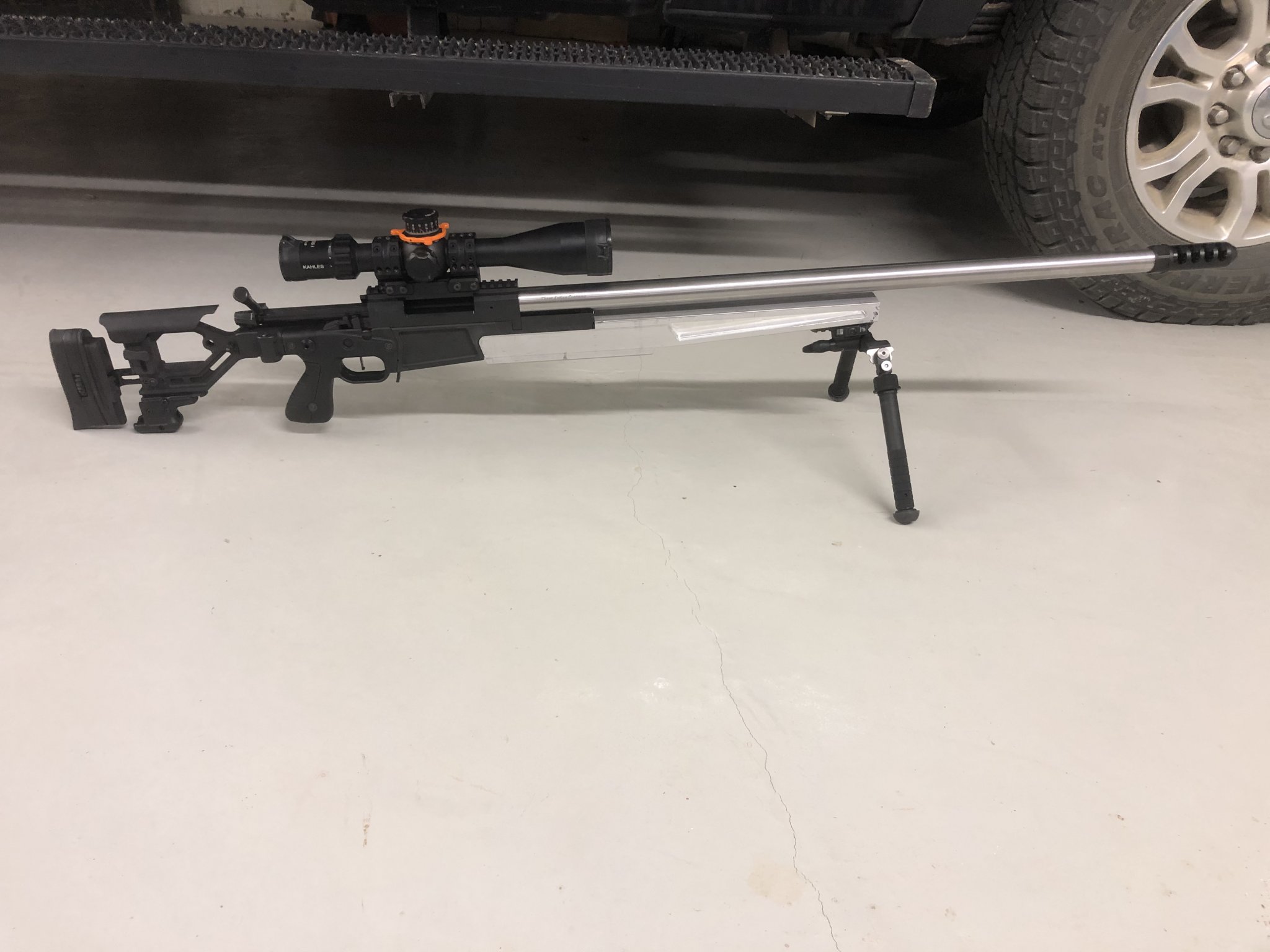

37xc build I’m finished up. Had to make a forearm for the AX chassis since the barrel OD was to big for the ID of the AX handguard. Hoping to get it out in the next few days and start load development.
1581xl action
K&P 1-7 twist 33” barrel done by SAC
AX chassis
Apa brake
TT diamond
planning to start with 400gr flatlines and 8133

Look at the Badlands 400gr icbm2 1.125g1 and about 1/2 the cost of flatlines

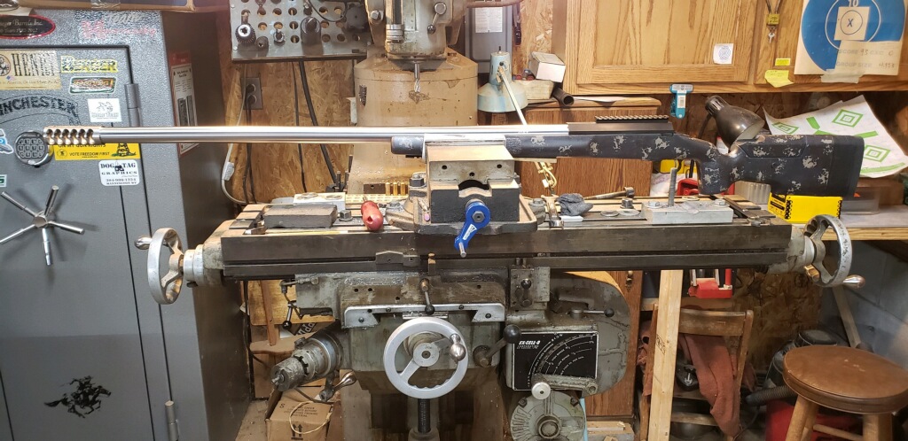

Finished mine up.
Bat model L 1.75 multiflat. 1.5inch for 10 inch to 1.25inch at muzzle 39 inch barrel. 1 in 7 twist. McMillan a5 supermag stock full carbon heavy fill. Bix and Andy competition trigger. Going to place my March 10-60 high master on top. Terminator t5 brake. 27.5lb bare rifle. Changing butt spacers to steel to add weight. Balance point bare rifle is 1 inch in front of action.
Probably run my f class accutac bipod for now. Should rock the coyotes and groundhogs with ease I assume. Range day next weekend.

Looks great
And by rocking coyotes and groundhogs with ease.....you mean at 2 miles right ? 🤣😁
