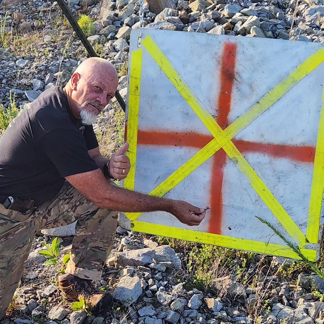

I posted some pics of hits on a 24x24 plate we use out to 2450 yards. 338 Berger’s vs Badlands vs Warners. I can see my hits and misses w the scope w Berger and Badlands, both leave a nice splatter on target! The Warners being a much harder alloy are hard to see the hits on plate but that’s what a flasher is for.

I took the 365 gr Badlands out for a spin this weekend. They definitely improve the splash/target mark. I need to do some load dev and further testing, but initial impression is very positive.

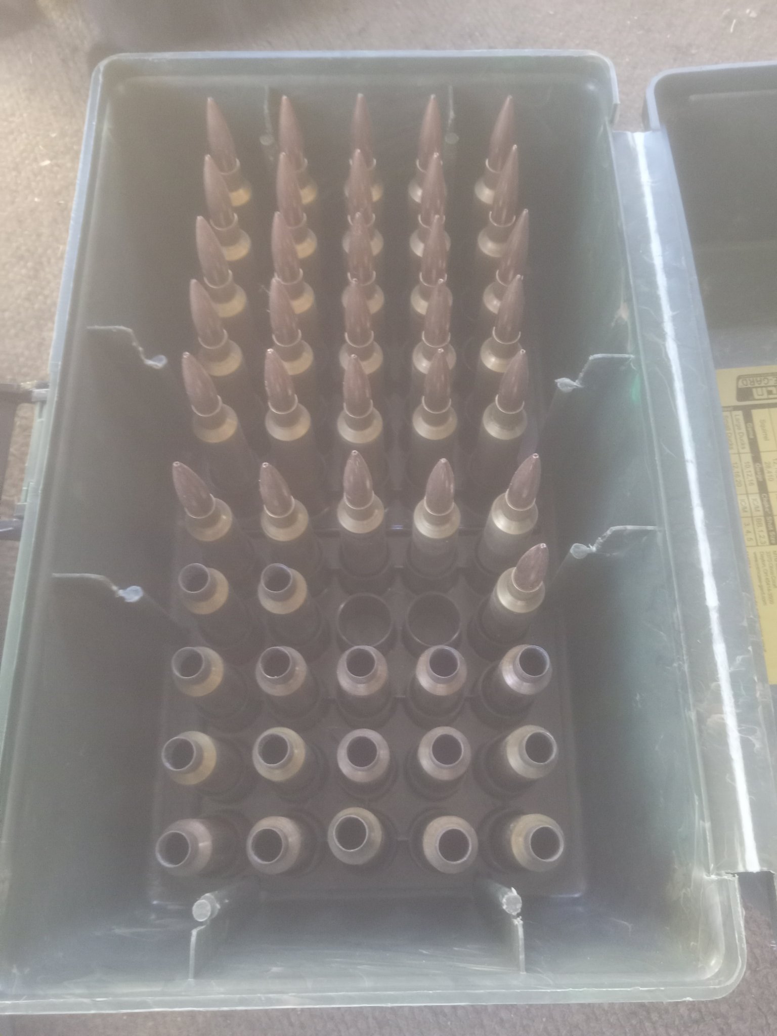

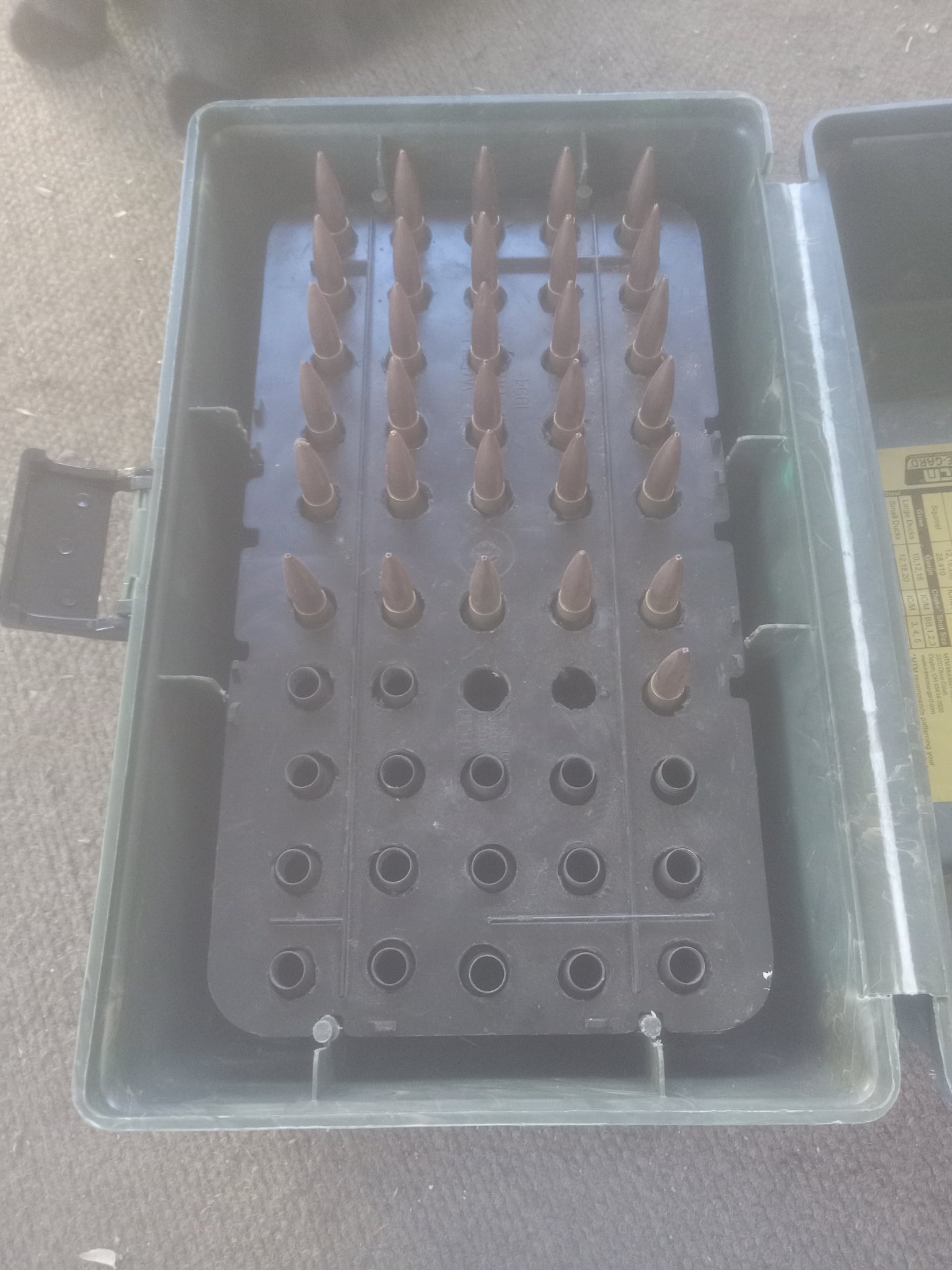

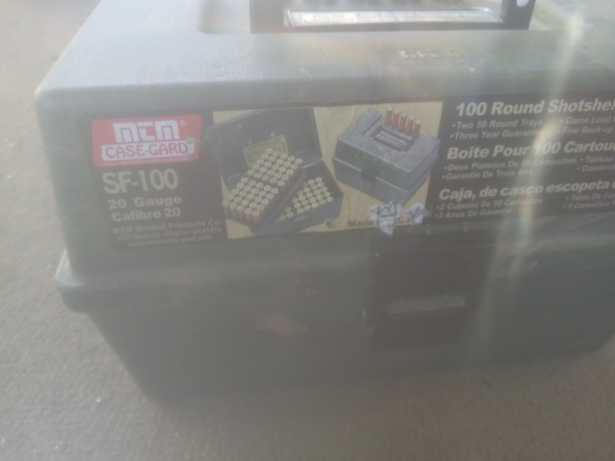

I use MTM 28 gauge shotshell boxes for my ammo as they are much cheaper.
You can also invert the tray to hold your ammo from falling out of the bottom tray.
can you link the case you are talking about. I'd be interested to see which one you are talking about? I can't figure out which one on their site would be long enough to hold ur ammo. I actually ordered a DNA case but haven't got it yet.
It's a 20 gauge box mtm# sf-100 that normally holds two trays each of 50 shotgun shells.
I drilled the top tray so it sits on the shoulder of the case and nothing falls over.
Inside height is almost 6 inches.
Pictures are bad because my lens is cracked
Ammo in the box is 338 Snipetac
