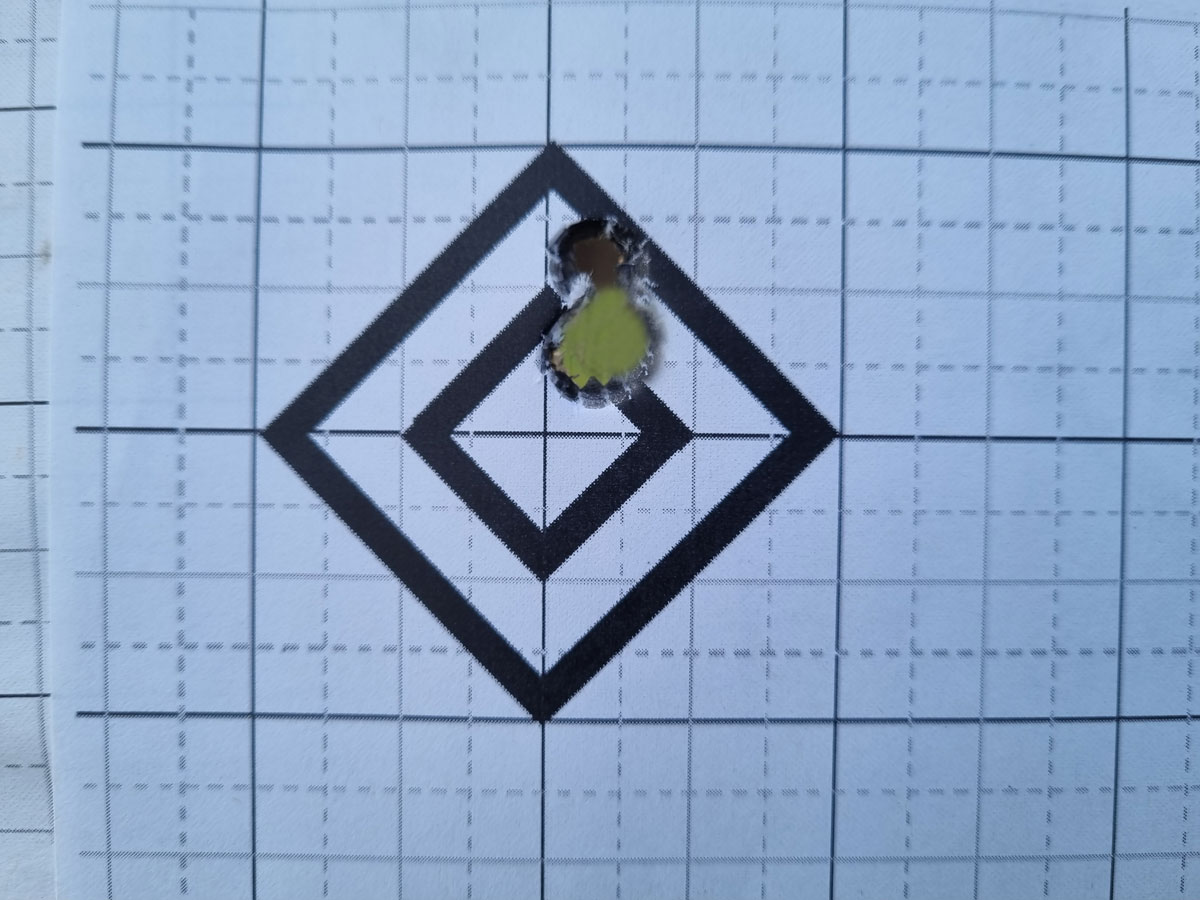

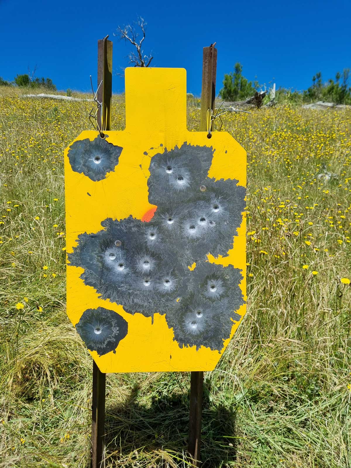

1 mile......... same grd 350 Plate...bit worse for wear here!!! :LOL:
Atips...

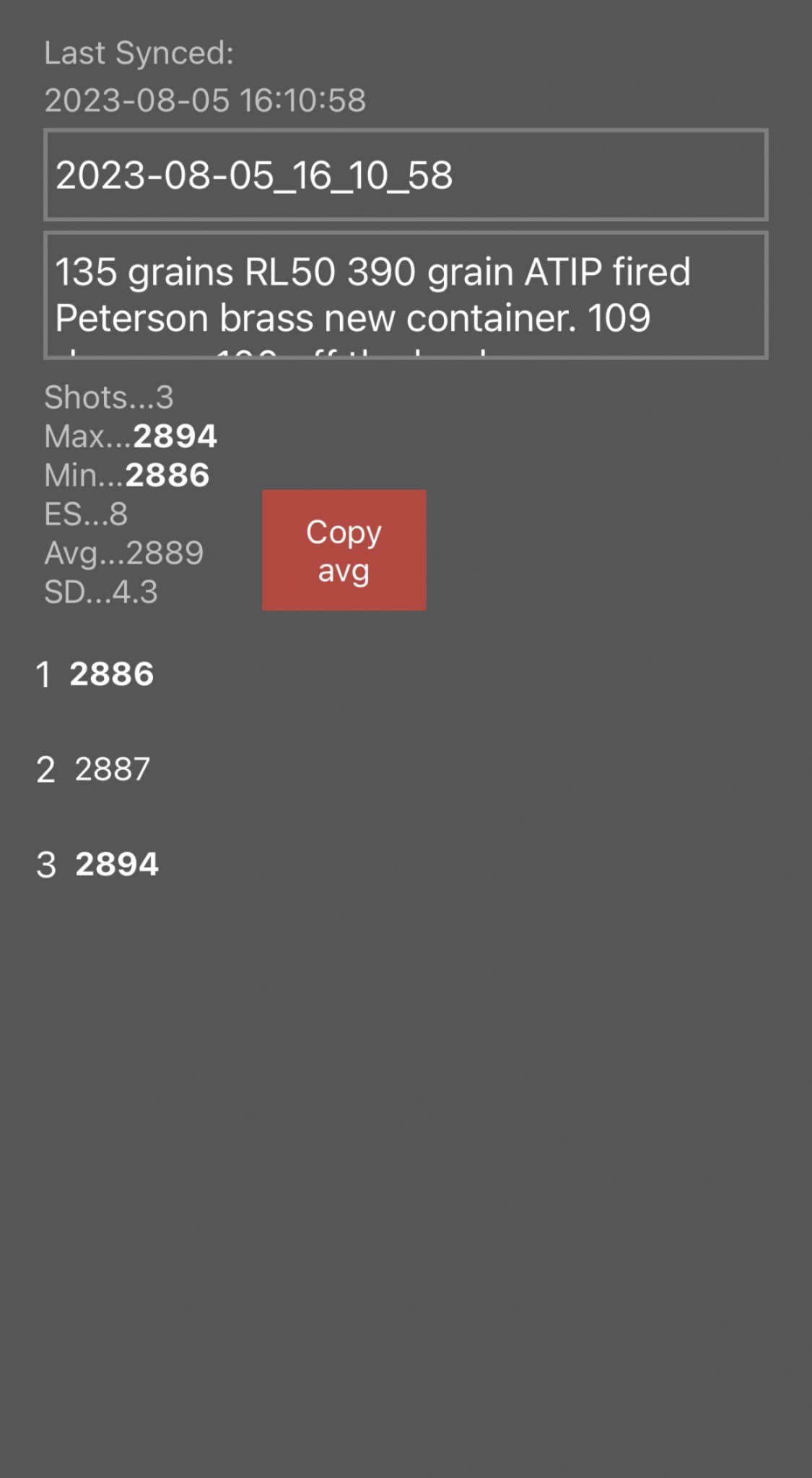

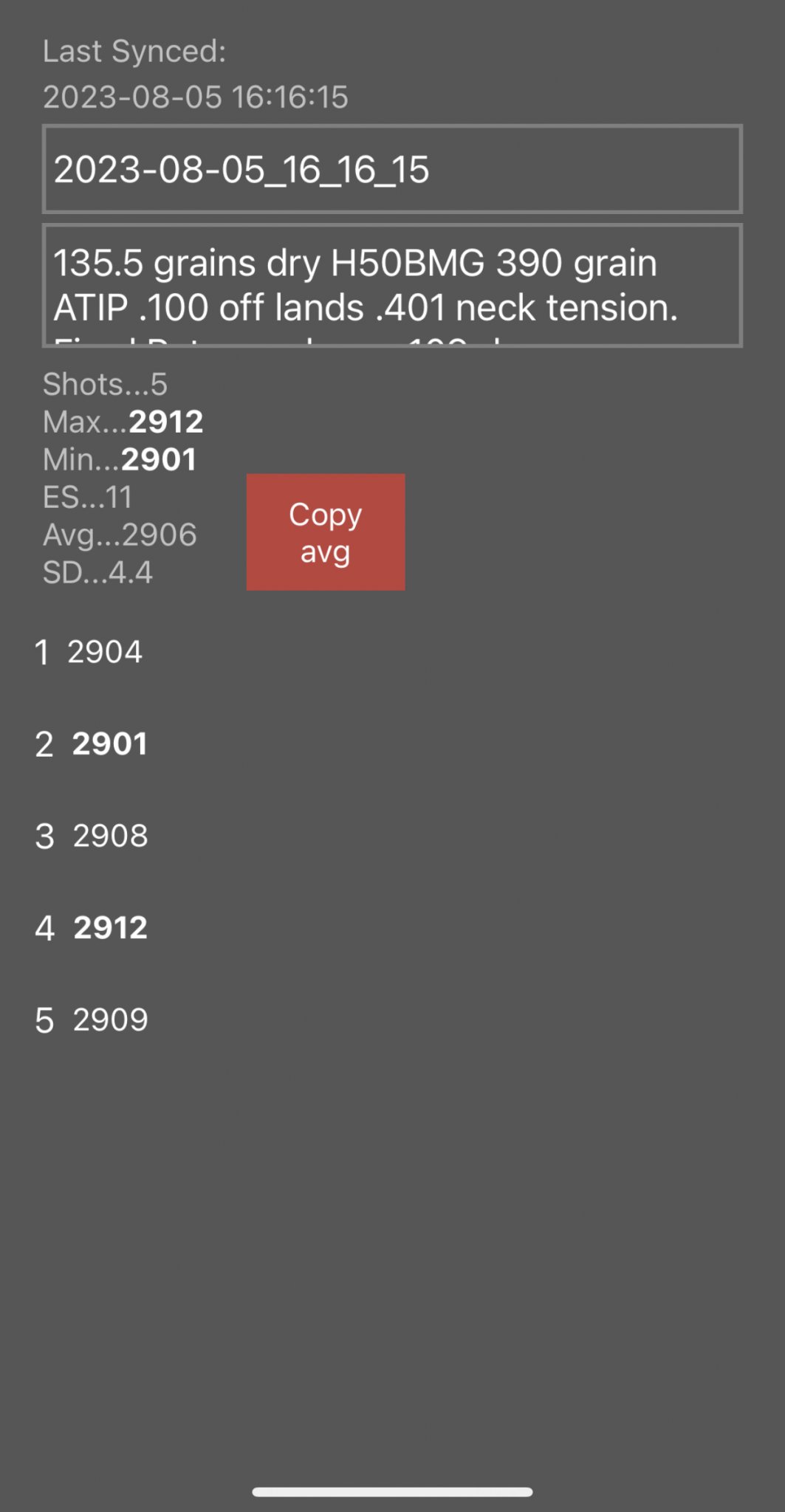

I put a .401 neck bushing on my load and dropped the charge down to 135.5 grains of H50BMG. It dropped my ES a bit, but still not in my desired single digit range
I did some testing with RL50, Peterson Brass and ATIPS. I opened a brand new container of RL50 and this is what I got. No additional neck tension.
The good part of RL50 is it would seem so far that it’s fairly resistant to powder humidity effects on velocity. Last week’s pressure test yielded 2901 at 135 grains. Today I got an average of 2889. Only a three round sample but I’m slightly optimistic (although I shouldn’t be because I have shitty luck)
Hot as shit today at the range, 109 according to the range thermometer.
