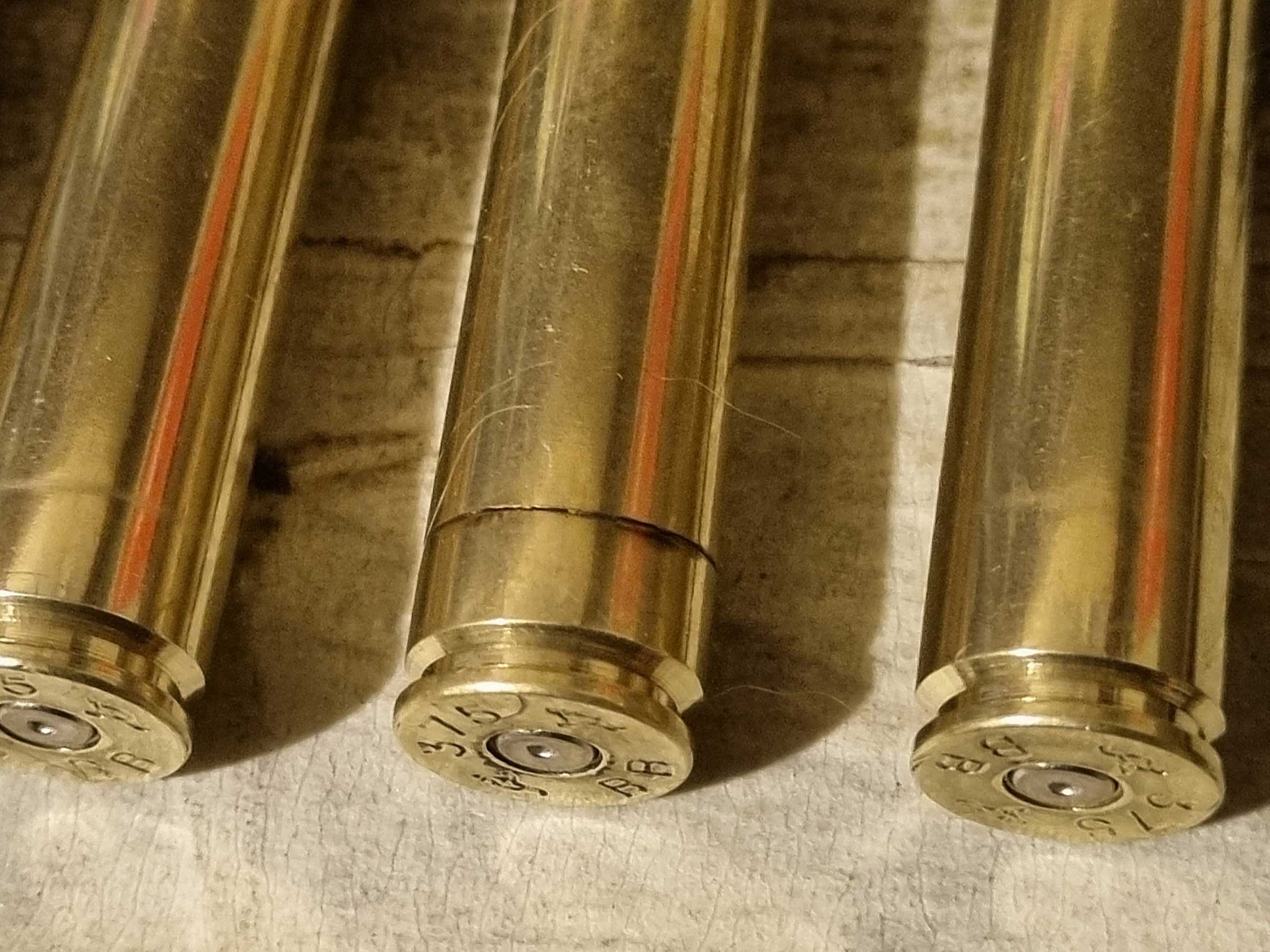

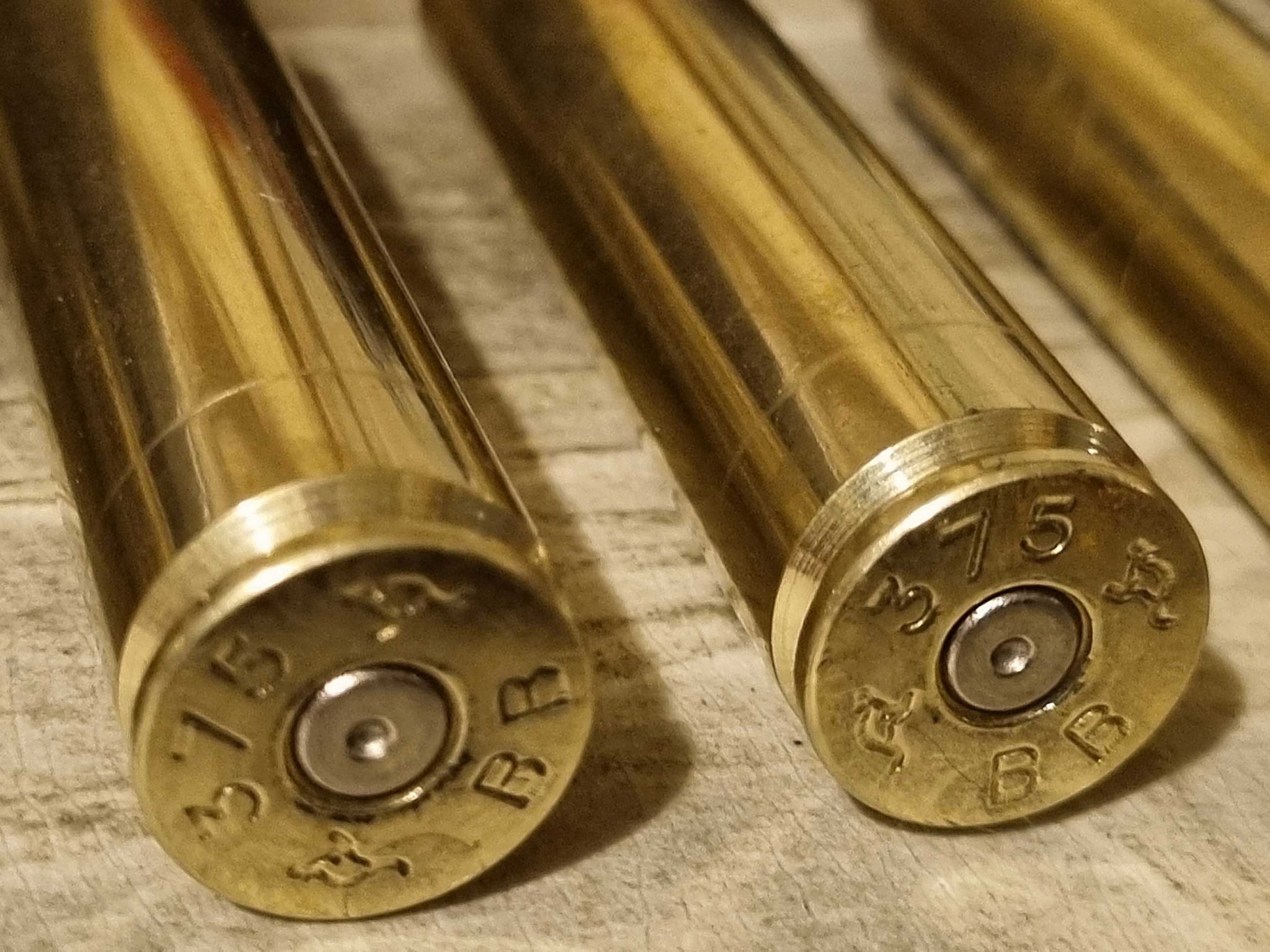

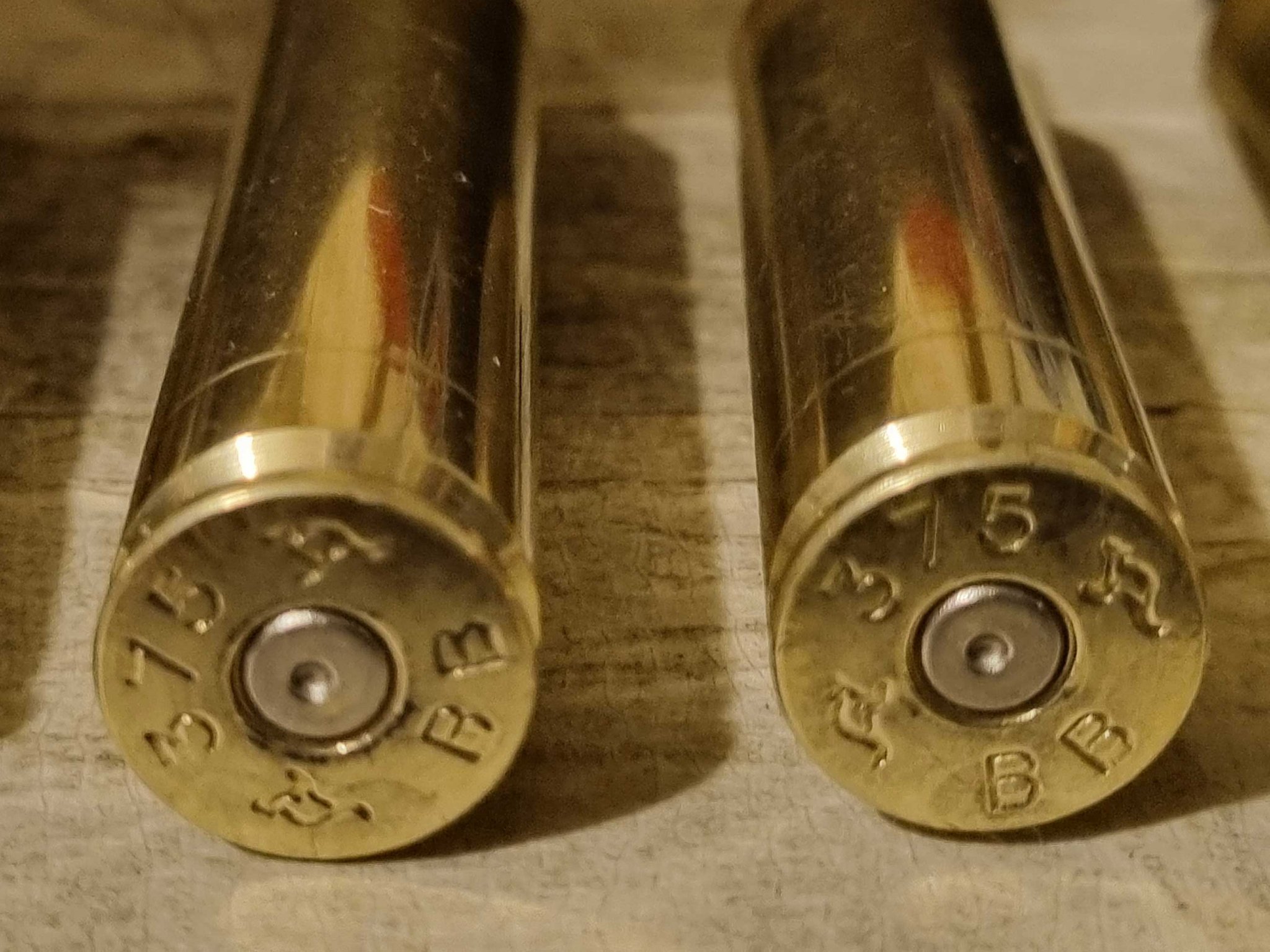

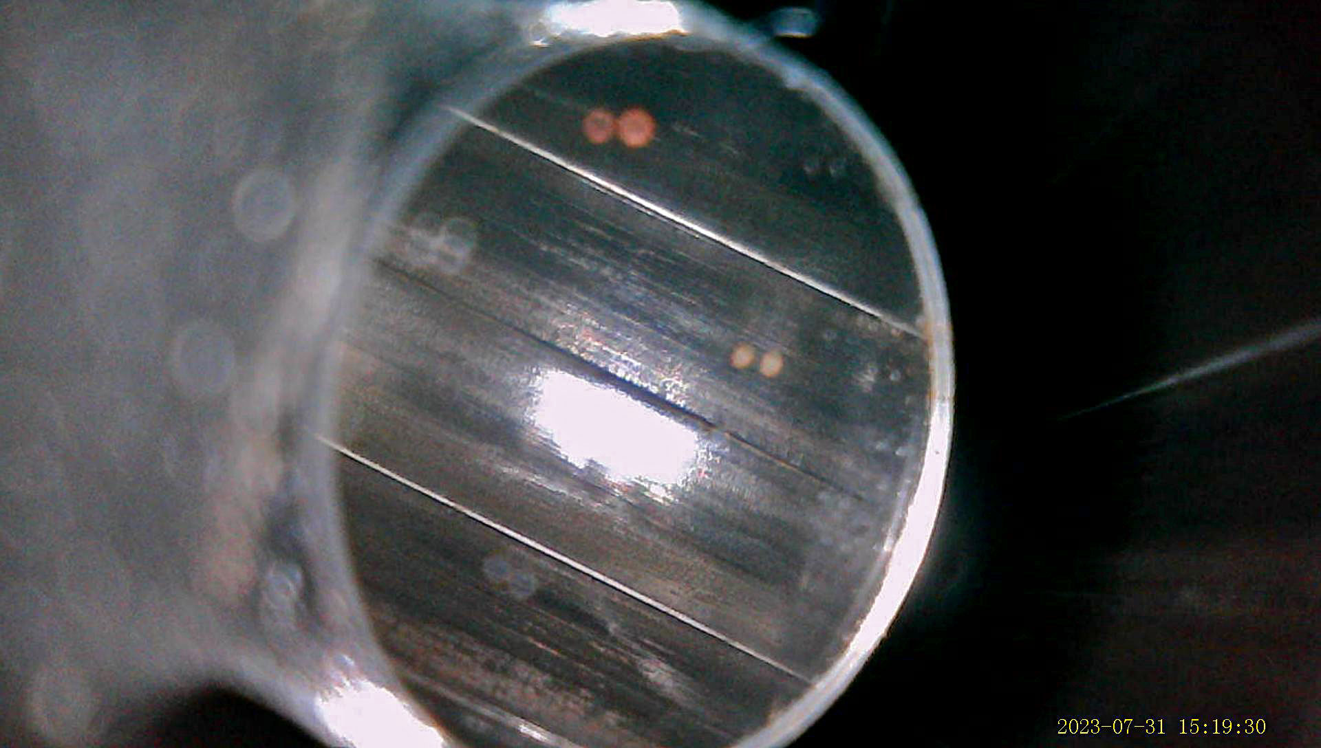

I’ve had a couple Bertram lately with Headcase separations. I was bumping the shoulder by about 5000 because I had two different chambers one of which was retired, and I wanted to make sure that I sized enough for the random pieces that got in there from a different chamber. some of them would come out having been bumped to 7000. I don’t think that’s enough to cause a case of separation but maybe it did. I’m inclined to think they were just a little thin at the edge of the web.
Well...its been a great run with this batch ( 50) of Bertram brass....24 loadings in total..
Realistically should of retired them around the 20 loading's mark... Lost 5 with split necks and just now had the first head separation, and after inspection most look look they are at that point.
Just ordered 500 new .
I have also just received my batch of '4000" 390gr A-tips...
I have 3 New Desert Tech 375ct barrels to wear out!! Fun times ahead..

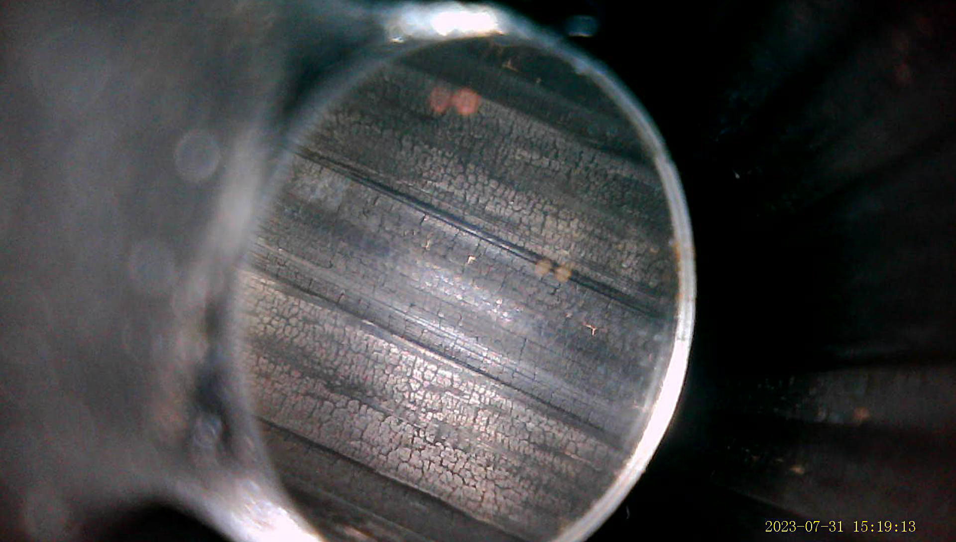

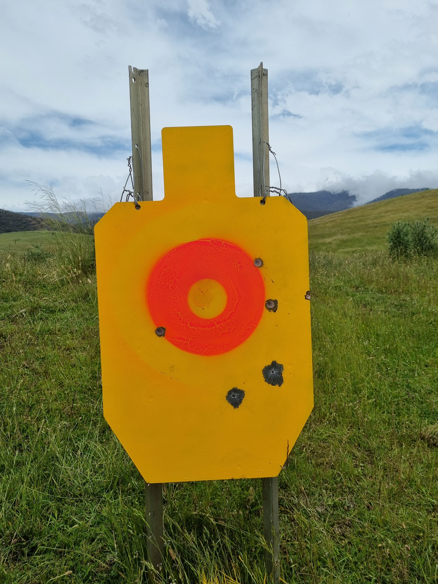

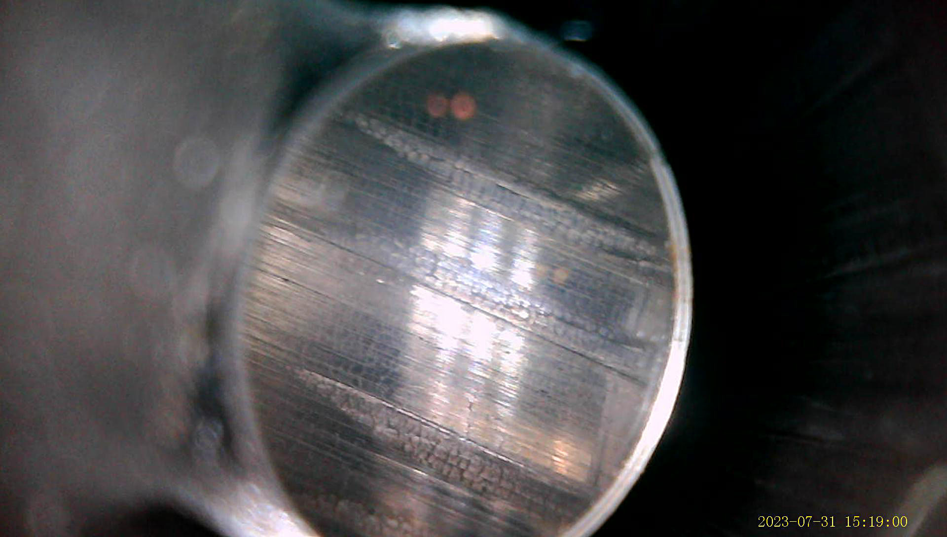

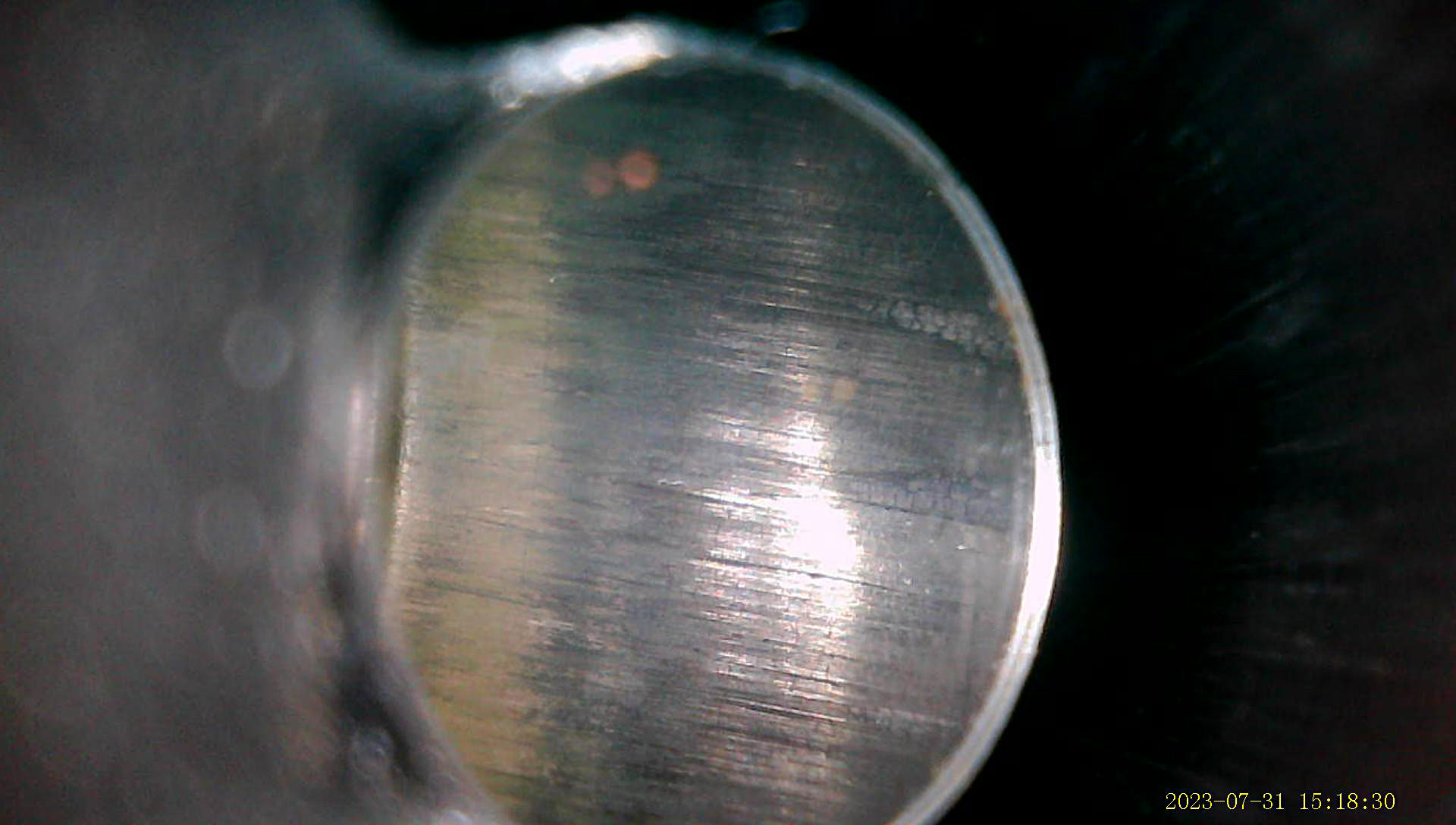

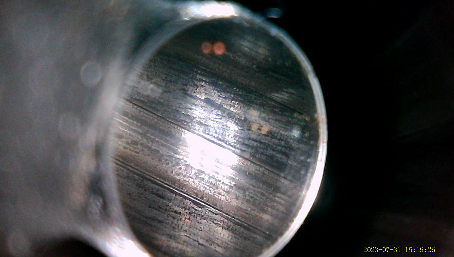

Just for interest...

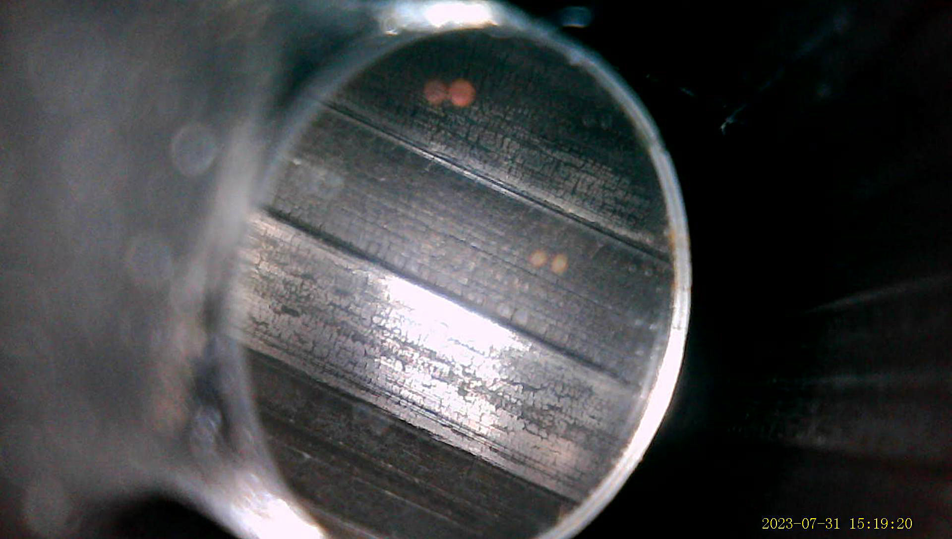

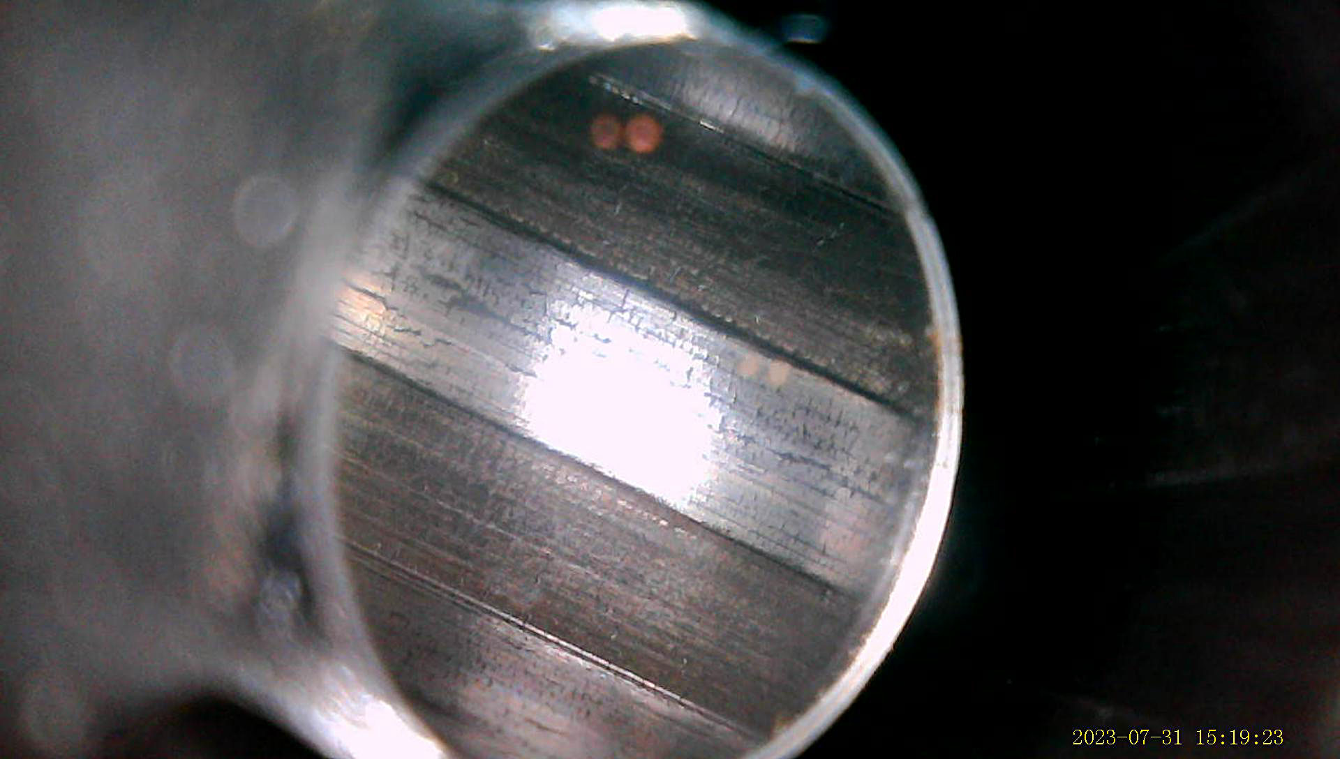

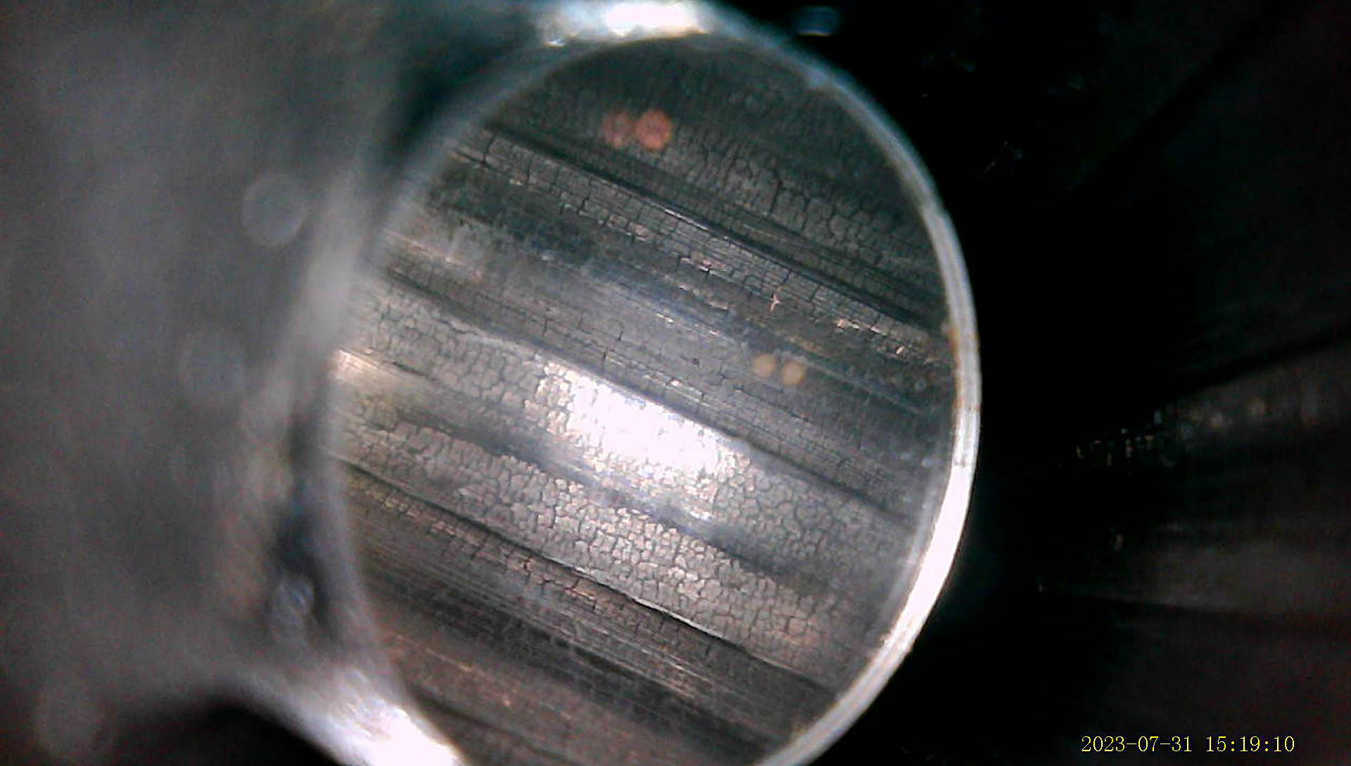

My factory DT 375CT barrel at 1300rnds......still shooting 1/4 moa !!!!!!

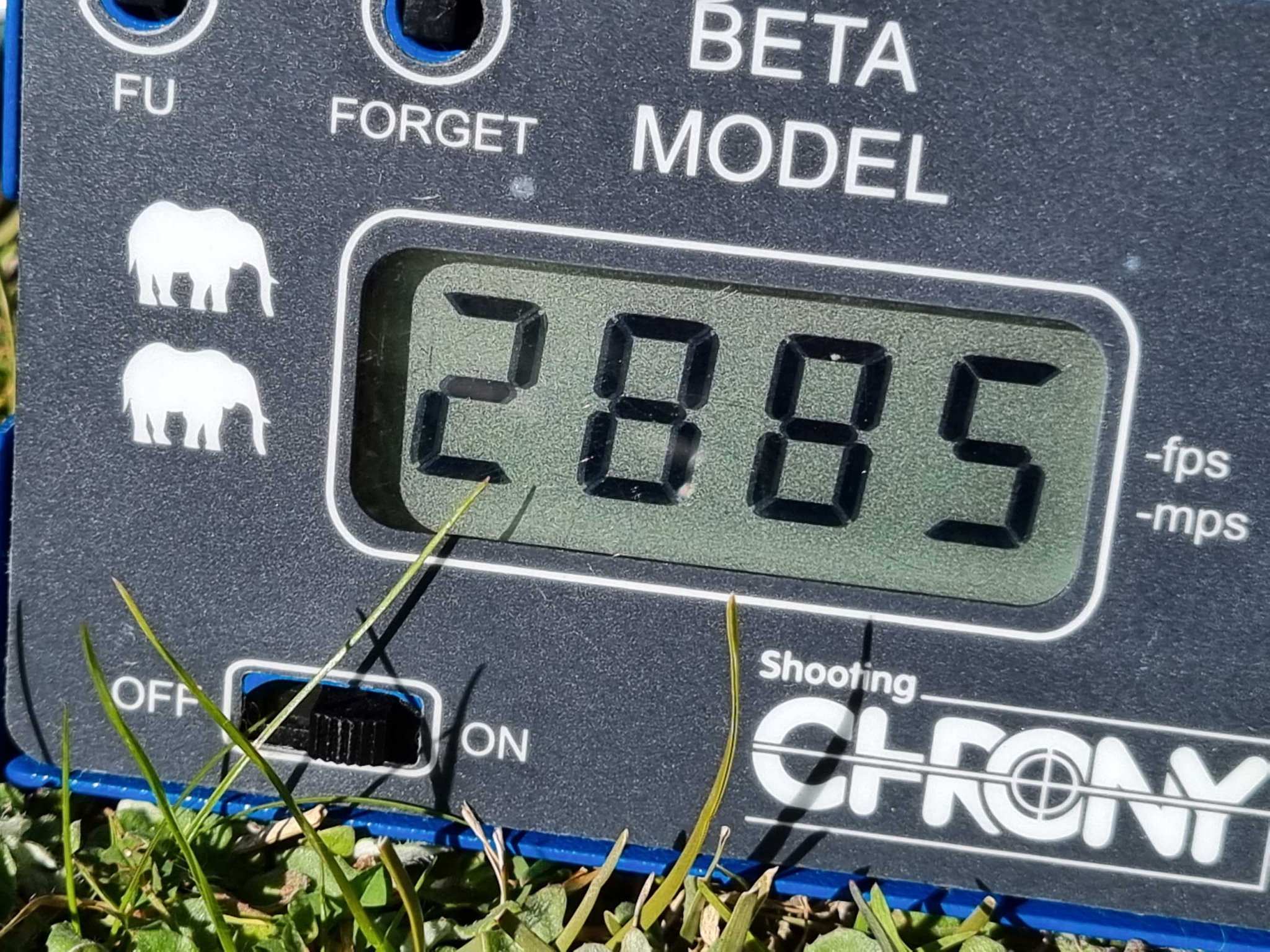

What’s your ES on that 2880ish load you have?
Reason I ask is with this 3rd barrel mine seems to like that speed with H50BMG and Peterson brass. It takes me 136 grains of H50BMG to get there as of now.
