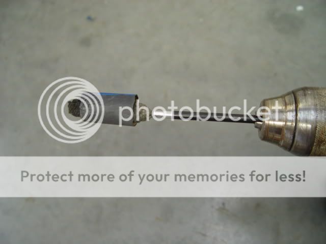

Wrap a strip of 320 grit emery paper around a snug fitting swab, secure it with a piece of tape. I use a couple of full turns so as to cover the tape.
Chuck the rod into a medium speed hand drill and polish the chamber....keep it out of the shoulder area, just polish the straight, parallel walls of the chamber.
This will help with extraction and brass life.

The 320 grit is pretty fine, you are only POLISHING the chamber, not removing any measurable amount of metal.
Also, the soft swab will not allow you to push too hard in any one spot.
No Problems!
Re: 4. HOW-TO: Ultimate AR Chamber Polish
I'm sure no pro but I know I've been told and have read more than once that the brass should "grip" the chamber during firing thus the reason you make sure there is no oil in the chamber. Brass sliping exerts unneccesary preasure on the bolt face, least that's what I think I've read. That would be my only question with polishing the chamber walls. Just a thought.
