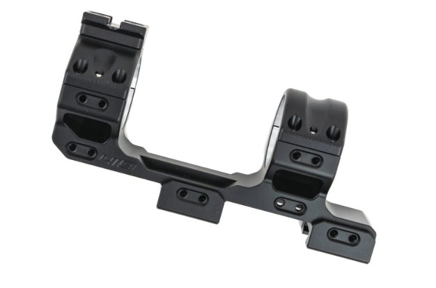

Currently running the standard 419 mount on the K540, but needed a little more eye relief as I shoot a short LOP.
Received the 419 mid cantilever yesterday, and noticed the cant portion has some flex as that connection has a relatively thin profile.
Should I be at all concerned? I’m guessing not as the 36mm scope body will add rigidity?
Am I over thinking this?
Flame suit on (in case this is perceived as a newb question).

It's interesting that the mid-cant does not have a center stiffening "beam", I guess they thought you didn't need it, but I have to admit if I could see/feel flex in the mount, that would concern me. Lots of guys are running them and I don't think I've seen this come up before. Might be worth asking the Area 419 folks, I suppose it's possible a batch was not heat treated properly.
It does seem like the connection to the main flat from the leading ring is pretty thin, and just overall on the mid-cant the flat that the rings connect to is very thin compared to the longer cant option or the option that has no cant at all.
Top to bottom: no cant, long cant, mid cant. You can see how much thinner the mid-cant is than either of the others and lacks the stiffening spine. It's hard to imagine that the mid-cant would not have the most flex of the 3.

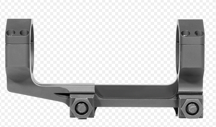

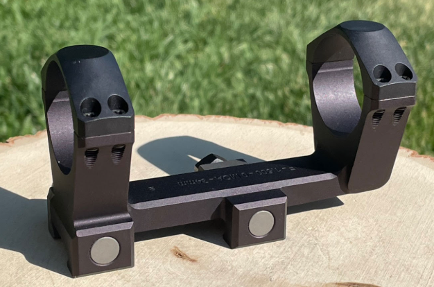

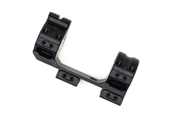

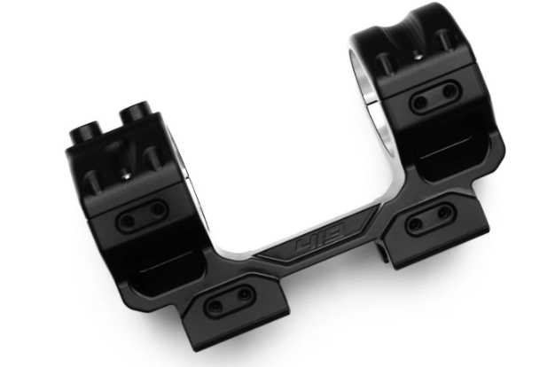

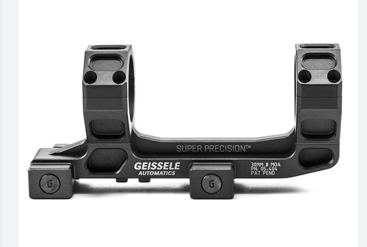

Especially when you start comparing that to the thickness in that area from competitors.
NF Unimount
Badger Unimount

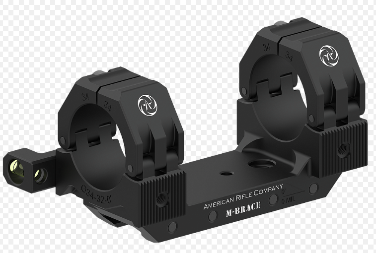

Mbrace (probably similar thickness underneath the clamping/picatinny area, but it has massive stiffening beams down both sides the entire length.
Geissel

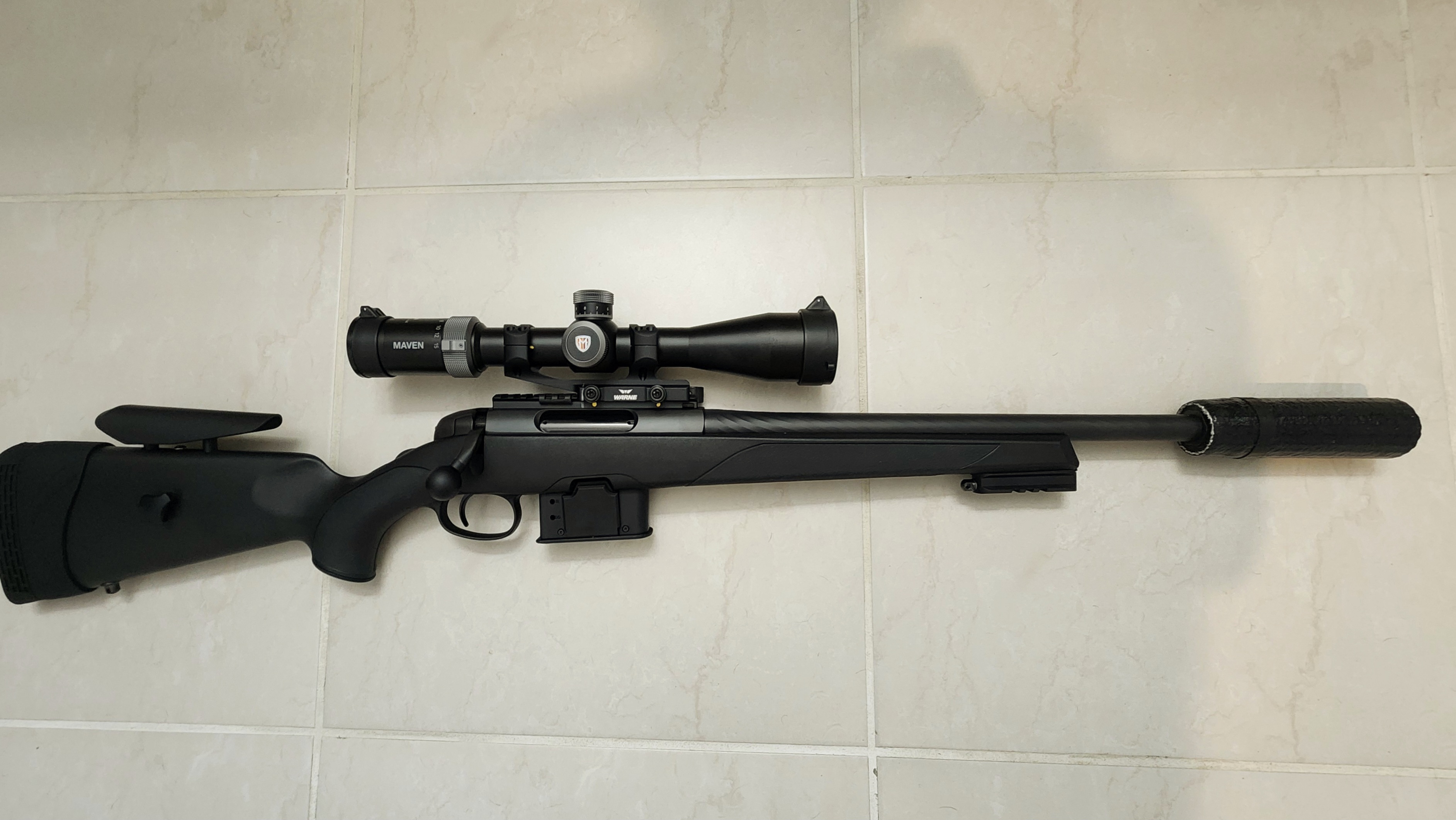

I run a Warne QD 30mm skeletonized mount on my bolt-action Steyr THB SX. I prefer Warne because it lets me shift the scope and mount weight toward the rear, perfectly balancing the 16-inch heavy barrel. I also run it backward as It gets the QD levers away from the bolt and I can keep my dominate hand on the rifle at all times. Plus, since it's also my thermal hog gun, a quick-detach (QD) mount is an absolute must.
I noticed this thread just before I recieved this mount and thought hum. But when my mount arrived I tried flexing it in various ways and could not get anything without applying an amout of force that I feared would damage it. I assume I must be misunderstanding what the op is describing but if anyone else has a concern the mount is rock solid for me. Yes its thin in the middle but stiff enough that I haven't given it a second thought.
