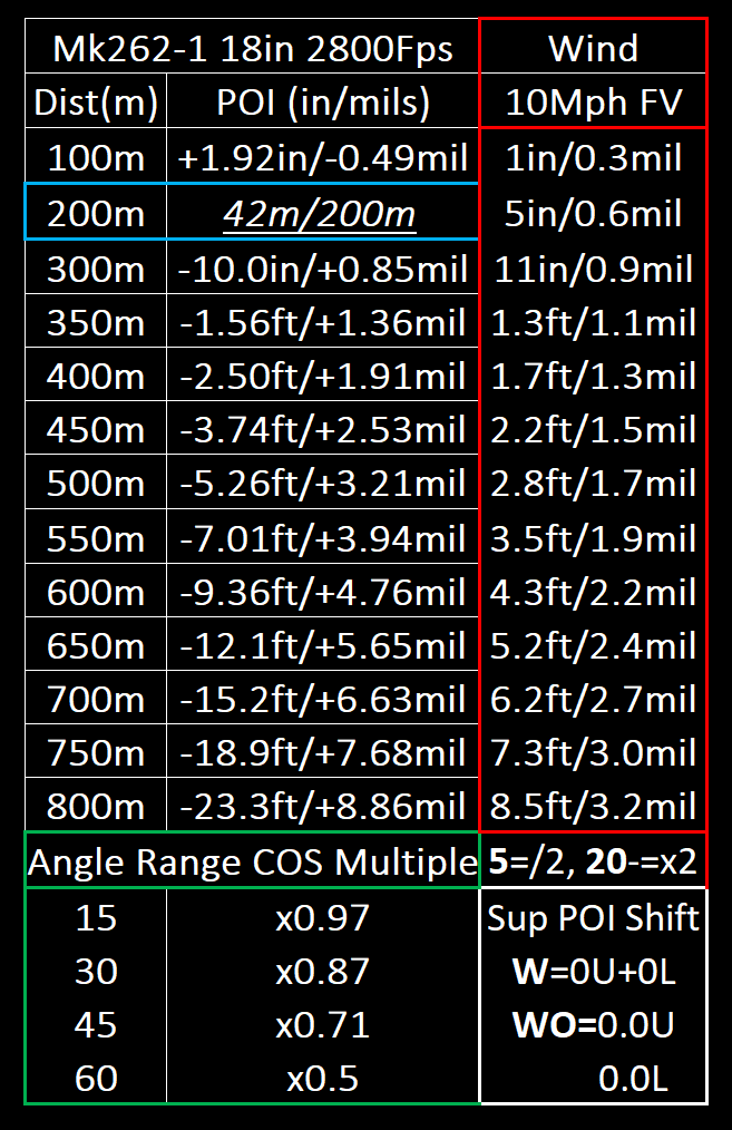

Here is a dope card that you can copy & paste to add to the buttstock of your rifle. Condition for creation:
1. 18in barrel is roughly 2800FPS
2. Mk262 Mod 1
3. Elevation 0ft, Temp 59F, 50% Humidity.
4. Sight HOB= 2.685in (ADM Recon Mount)
5. You will need to adjust the Suppressor POI shift, tailor it to your equipment.
2. Mk262 Mod 1
What did you use to make this card?
