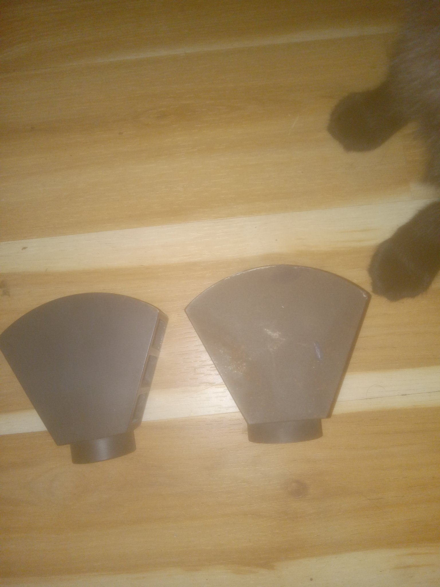

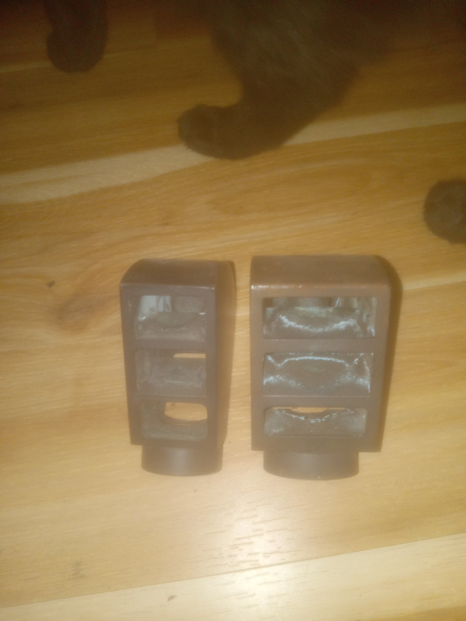

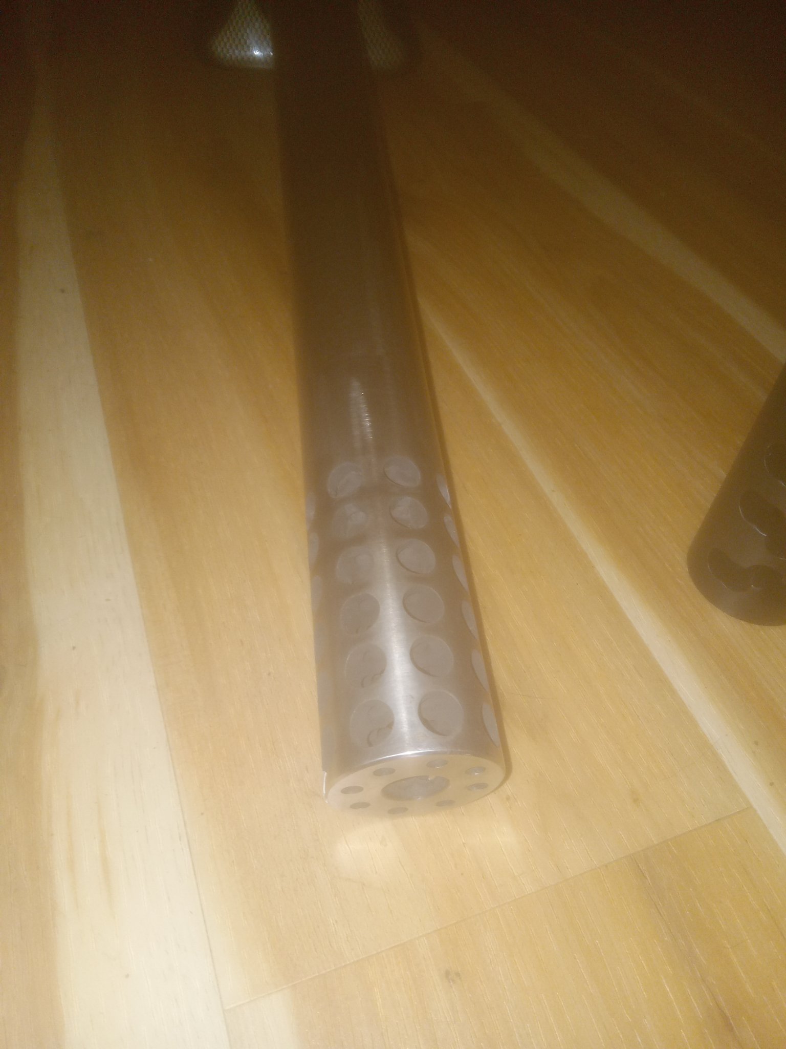

We did a test years ago when Barrett first started selling ammunition.
We tested the rounds at Circle S Ranch and we let the general public shoot the rifles not seasoned shooters.
K-P and Armalite both got the most likes.
K-P was hard to aquire but worth the wait Armalite was easy to aquire and cheaper with no wait at all.
The Vais brake on my latest heavygun has no sinus issues from the concussion but after 120 rounds of a FCSA weekend you feel beat down from the recoil.
I tell all 50 shooters to spray Afrin in the nose 1 hour before shooting to get rid of the headaches and sinus issues.
The skinny K-P brake is on a 375-50BMG or Mach V

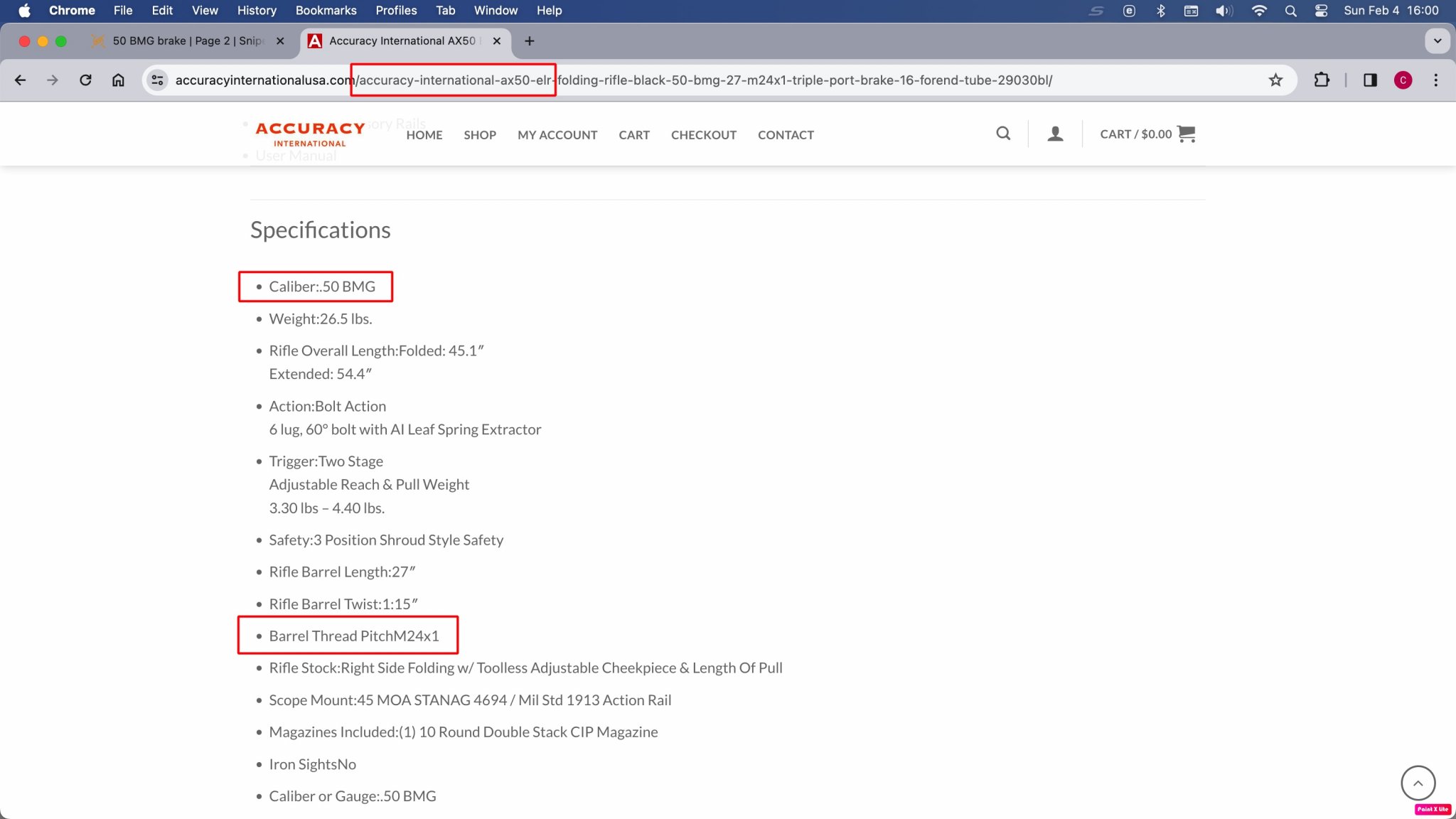

I have the AX-ELR and an AR-50 and was surprised how well the AX brake performed on the lighter rifle. There are not too many people making brakes threaded M24x1, I did find this one https://terminatorproducts.co.nz/t6-brake/ but their own video shows that it actually increases recoil over the factory brakes tested...
I searched real hard. Where did you find M24x1 for the MRADELR? If that is in fact the factory spec, then have an extension built, threaded for whatever you need.
BTW, Barrett is normally 7/8-14 or 1-14 thread.

cast1 started this conversation referring to his AI AX50 ELR, the spec I posted was for an AI AX50 ELR, where did I mention MRADELR? They probably took the YT vid down for the reason I stated.
