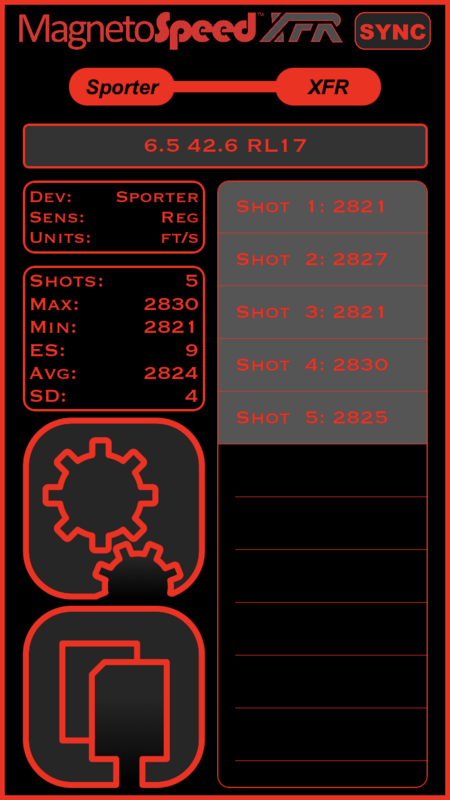

Currently running 140 RDF, Hornady brass, CCI 200 with 42.6 grains of RL17 with a base to ogive 2.1625
This load is out of a factory RPR 24in barrel .070 off the lands.
