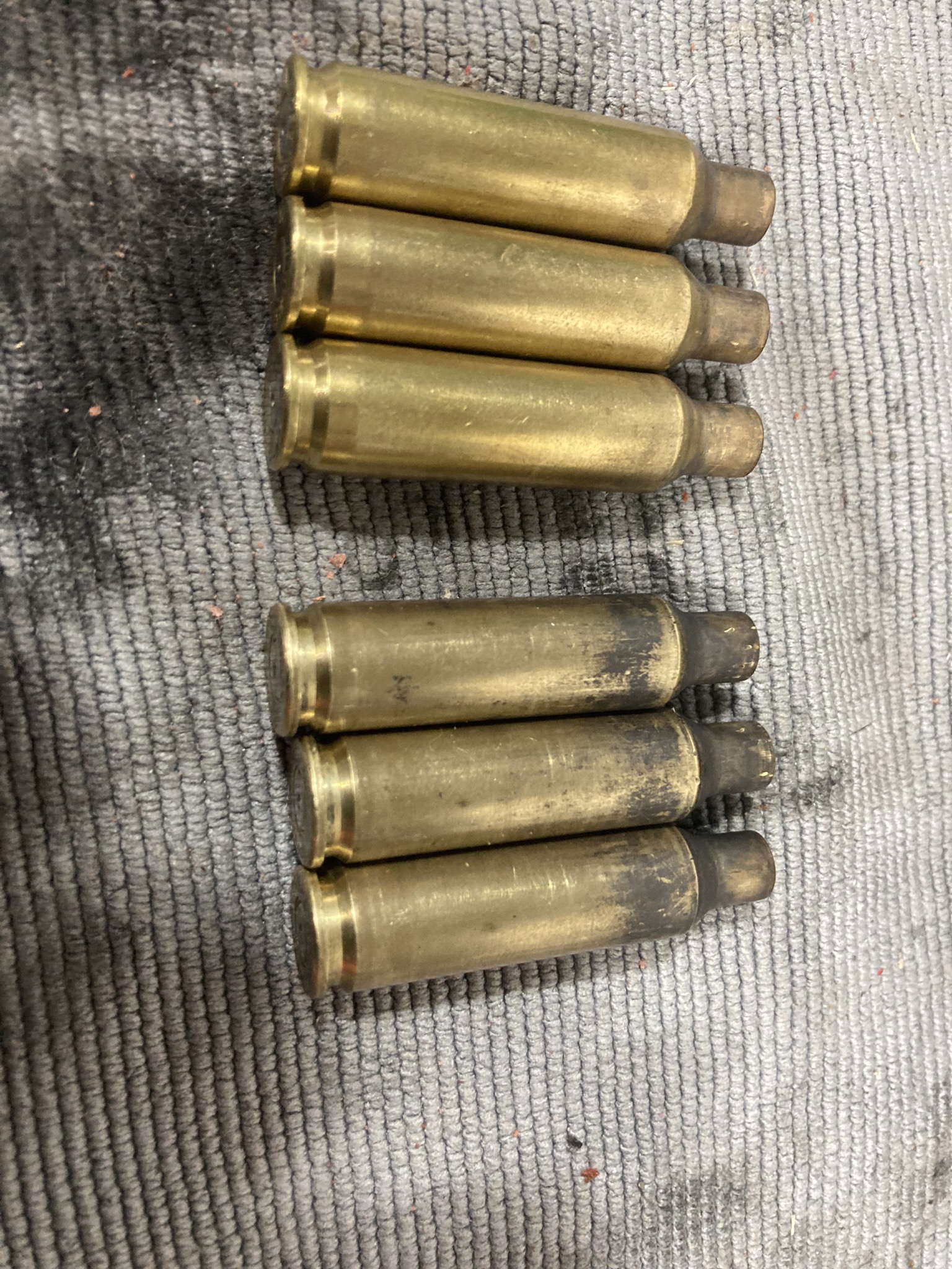

Ok fellas, need some help understanding what I'm missing here. Went to the range today. Shot a load that was .1 gr under the hornady listed starting charge, and it chrono'd 60 fps ABOVE the velocity for the MAX charge.
Rifle details:
24" x-caliber, 1-8 tw, 5R
KVP 5.6oz buffer
Sprinco orange buffer spring
Load details:
Hornady 130gr ELDM
41.0grs H4350
Brand new Hornady brass
FGM210M primers
2.800" coal
I had loaded some of these a while back, and shot them up to 41.9grs, and began getting burrs from the ejector swipe. Didn't understand it then either, but thought I'd come home and figure it out. Obviously, I haven't figured it out. The only guess is have is Hornady has incorrect data listed for that load. I shot other loads with different bullets and powders, and they were running where they should have been, within reason.
Ihve shot loads with 6.5 staball and VARGET and they were fine.
I swear, I'm not losing my mind.
Edit: The hornady manual list 41.1grs for a starting charge, with 42.8grs as max, for the 130gr ELDM. I was shooting 41.0grs at 2760 fps avg.

The Hornady load data for this specific combo is fucked up. I went through this same dance. It shows h4350 as one of the slowest powders for the 130gr. 42.5gr seems to be the magic number for most people, myself included.
Second, running 42.5gr with a 130 Berger OTM. Haven’t gotten a chance to speed check it but no pressure signs in multiple rifles.
What kind of velocity are you getting? I'm at 2760-2770 with 41grs. 41.9 gives me some nasty ejector swipe burrs.
The spring and buffer will help, but can you adjust the gas? My first 6.5C AR10 ran like a clock with just an adjustable gas block. Still does.
My second I had a 6mm Creedmoor that would give pressure signs at any loading. Swipes, craters, pierced and blown primers. And this was even with the charges at yes lowest on multiple tables.
Got tired of messing with it and rebarreled to a 6.5C. Craters and hit and miss piercings with swipes with just gas block running. An H2 config of the buffer along with the heaviest buffer spring and tuning the gas now has that rifle running upper end of the tables with no signs whatsoever.
Friend is working through similar issues with his AR10 right now, but his is 7-08.
AR10’s are a different animal and throwing different calibers at them exhibits weird function and signals.
Not an expert on anything, but cycle/timing seems to be the key with this gas platform. Hopefully you find an answer. I have both my 6.5’s and love them. Shoot them all the time suppressed and not. Never a hiccup. Thinking I will build another upper with the 6mm barrel and see if that can be tuned to behave or if it’s really the barrel/chamber.

My condition is similar. It doesn't burr every case, but enough of them to concern me. I do have a primer pocket gauge, but haven't had time to check them yet.
Weird that it only happens with 4350. That has been real stable for me. I am running the RCA HP BCG in my newest 6.5 and it works well. The other has a JP HP bolt in a toolcraft carrier, but even with a standard bolt it never left a mark or messed with a primer.
I am not versed on sprinco springs, I have JP SCS's running in mine in H2 for both. The newer 6.5 I had to use the heaviest spring that came with the SCS.
SLR gas blocks on both, neither more than a couple clicks above bolt lockback function. The older 6.5 has a 22" barrel with standard rifle length gas and like I said, never a problem. The newer has a 22" barrel with a +2 gas and it would still beat on cases until all the combination tuning.
I'm just about out of adjustment. The only thing that I haven't tried is a heavier buffer. Another member on here spoke of an 8 or 9 oz. buffer he was running, but I don't know where he sourced it from. I am running the strongest spring that sprinco offers, a KVP 5.6oz buffer, and the block adjusted open just enough to function.
I guess if I want to keep from chewing up my brass, I'll either have to load below starting charge, or use a different powder. Varget nor 6.5 staball has done this, at roughly the same velocities.

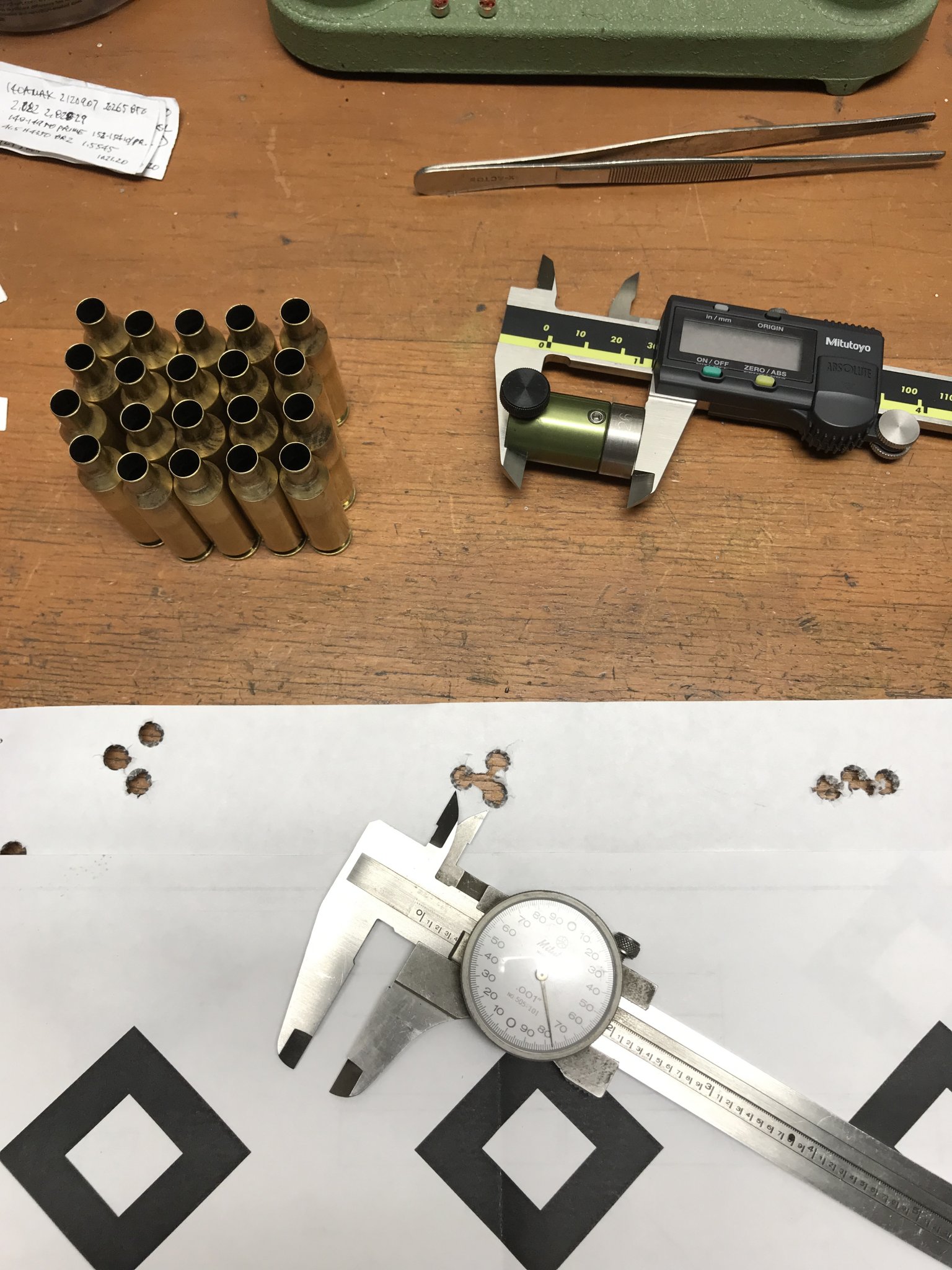

So, I just checked the primer pockets on the cases with burrs. They checked good, still very tight. I also measured the case body at the web, just above the extractor groove. I am seeing .003" growth at the web, versus brand new, unfired cases. What amount of growth points to high pressure?
I looked at my data from my last range trip (yesterday), and I shot some 145gr barnes match burners at almost the same velocity (2730 fps), but loaded with 6.5 staball. Not so much as a swipe on those cases. I'm stumped.
Have you shot any of this brass that has experienced the pressure signs more than once? Or more than twice? Guessing the webs on your brass grew from.467 or .468 to .470 to .471. Depends on your die but you may end up with cases sticking in your chamber. .470 is usually the standard web diameter of most chambers. I don't necessarily know how much expansion is a sure sign of high pressure but I have over-pressured brass this way. Over .470 I had to get a small base die to fix that brass.
It would be telling to compare the web measurements of virgin brass(if you still have any), brass that was fired out of that chamber with StaBall, and freshly resized brass that was fired with 4350.
All of the brass was new. The brass in question measured .469" after firing, the staball loaded brass was slightly smaller at .467"-.468". Virgin brass measures .466"
That's not bad then. I don't think that's enough pressure to expand the webs. Might definitely be early unlocking. But the best takeaway here is StaBall is the large frame 6.5 CM MVP. It's what I use. 43.5gr. 140gr at 2740fps out of a 24" Proof.

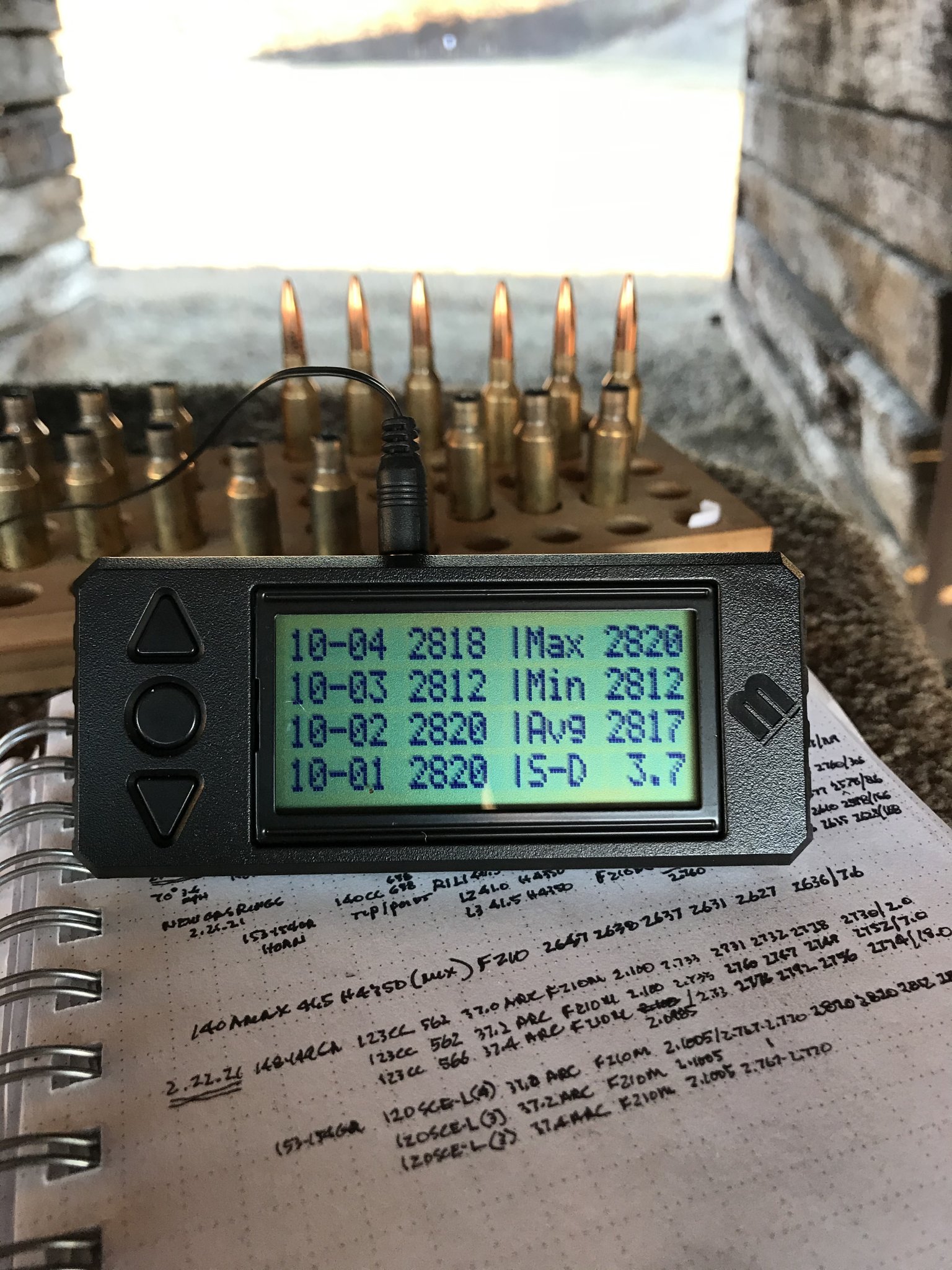

More data:
Everything fired out of an SP10 with TBAC Ultra 7 suppressor
