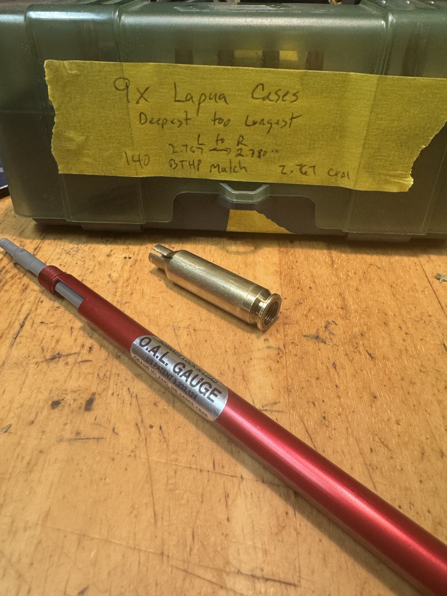

I had to put a little work in for this one… I stayed focused lol. Using a fired case I drilled and tapped (lathe) the primer pocket for my o.a.l. tool gauge, modified the case neck to allow manageable neck tension. I have never really had accurate numbers with that tool in my bolt guns in the past but it def exceeded my expectations on this job. Thanks for your time and attention to this matter, bamf like you keep me inspired 🏴
I used to slit the neck of the case but found inaccurate readings do too slippage of tension . So MY cases are neck turned so as to make sure cartridge is centered in the chamber . I'm not 100% certain it's necessary but did two cases for each of My chambers in various calibers . I correctly bump shoulders 0.002" for Measurement purposes only and squeeze turned necks 0.002" also for bullet tension .
Seems to work for ME ,as bullet tends to stay inside the case and not stuck in the lands. I also use a swab of LU708 Sprayon PTFE dry film lube inside MY chamber and throat Lede .
Not unlike yourself ,I also chucked up cases in My Lathe turned necks and drilled primer pockets with a 7.30mm bit ,so as to get a properly tapped straight hole ,for that 5/16"x 36 ,which is an odd duck .
I seem to be getting consistent measurements ,so must have done something correctly :)

Yes, In the past I had found the spent case from the chamber (when drilled/tapped for my gauge) had a neck tension that was to loose to properly hold the projo without it slipping, getting stuck, inaccuracy. I had an extra 65cm case made up from a previous rifle, a decade ago when the cm debuted… found that sucker and modified it sense I’ve no experience with the factory hornady production caliber cases for their oal gauge. This modified case was FL sized and after the slit was cut, de burred,I ran a neck mandrel of .003” nt, verified concentricity.. surprisingly the projo never once got stuck in the bbl! I had repeatable readings everytime, and this case now works awesome for setting up my seating die when changing projos!
To my surprise, the barnes match burners with the biggest jump, grouped the best out of the 140 match, 140 SST (good groups, sub min) & the 145 match burners. tested with lapua and peterson brass. Thanks ExE6 for your reply!

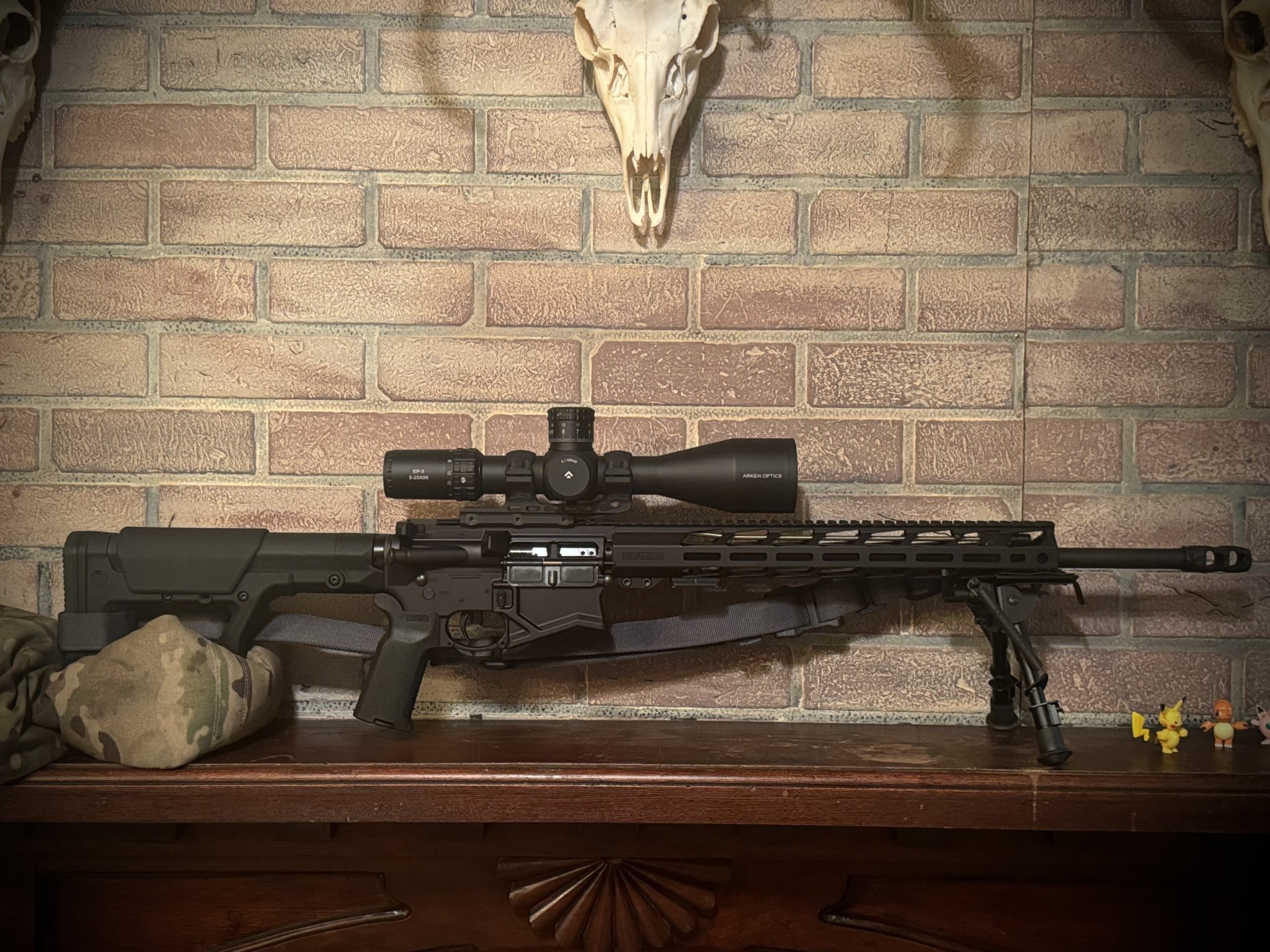

This is my Aero M5 in 6.5 creedmoor. It has a faxon 24" match barrel, timney trigger, vortex strike eagle and a captured buffer. using 140 gr hornady eld-m bullets with h4350 at 2825fps im getting <1" groups at 100 yards. SD is like 15 so there is work left to do. being an AR style its hard to figure out the seating depth. Rumor is eld-m bullets like be close to jam. I'm like .020 off the lands and it seems like it could be better.
I used my go gauge CBTO measurment with a S.A.C. comaprator as a starting point for seating depth. for whatever reason I dont trust OAL in the SAAMI spec as it feels to arbitrary with different construction bullets and tips that seem to vary in length.
Reactions: Ex E6
I agree, less than an inch is pretty damned good. I doubt you’ll improve much more in a gas gun unless it’s a high dollar match rifle. Load, shoot, and be happy! 😃
^^^This is the truth right here. I have the 20” version of that same barrel and I’m getting similar results. I measure jam length to make sure I’m not past it loading magazine length, but don’t worry much as long as they fit in a mag, they are not jam length, and they group less than an inch.
