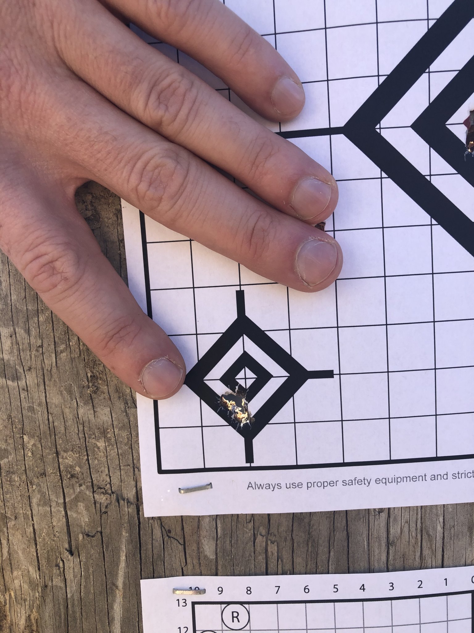

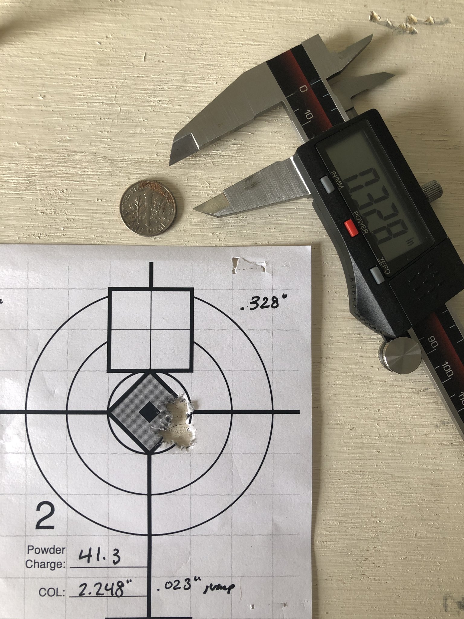

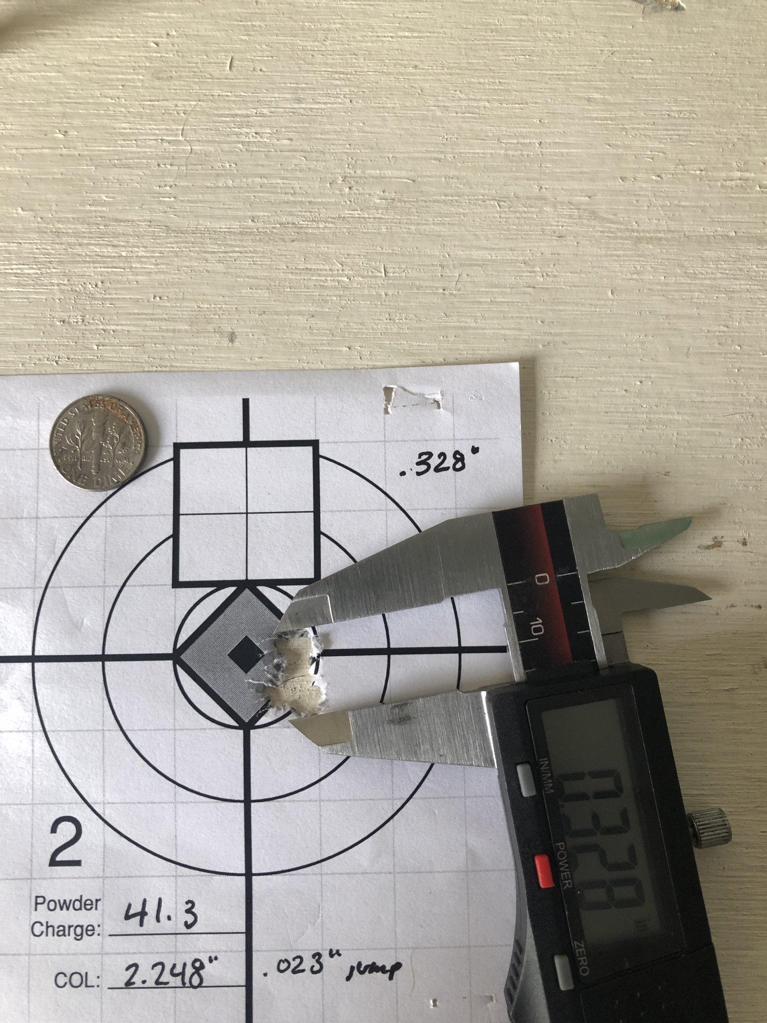

6.5 Creedmoor
Hornady brass
41.3g H4350
CCI 200
140g ELDM @ .023” jump
2760fps avg
No weight sorting. No primer pocket prep. CM Lite to powder. Seated at 2.248” bto
Hornady brass
41.3g H4350
CCI 200
2760fps avg
No weight sorting. No primer pocket prep. CM Lite to powder. Seated at 2.248” bto View attachment 7499321

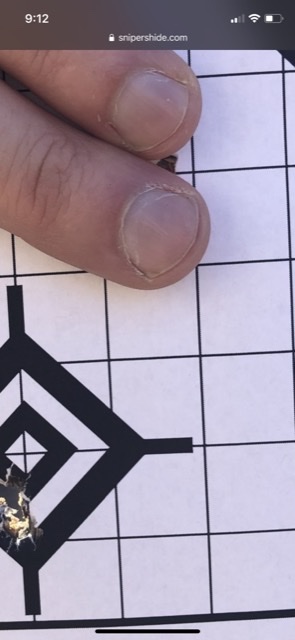

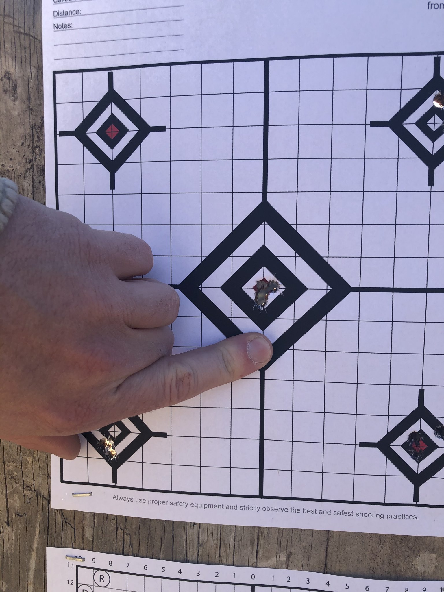

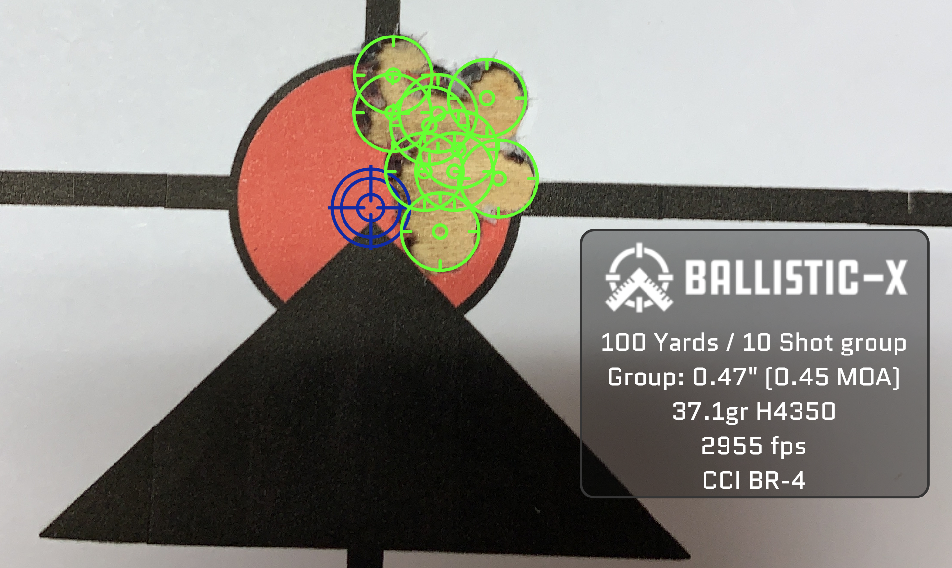

Bahahahahaha whenever I see shot group photos with someones hand in the picture I try and guess how many "fliers" they're covering.
Lol this work better for you👍🏻 The group was low left from my suppressor vs my brake. POI Shift is large due to using my Saker 762 which is heavy... rifle hammers.View attachment 7499896

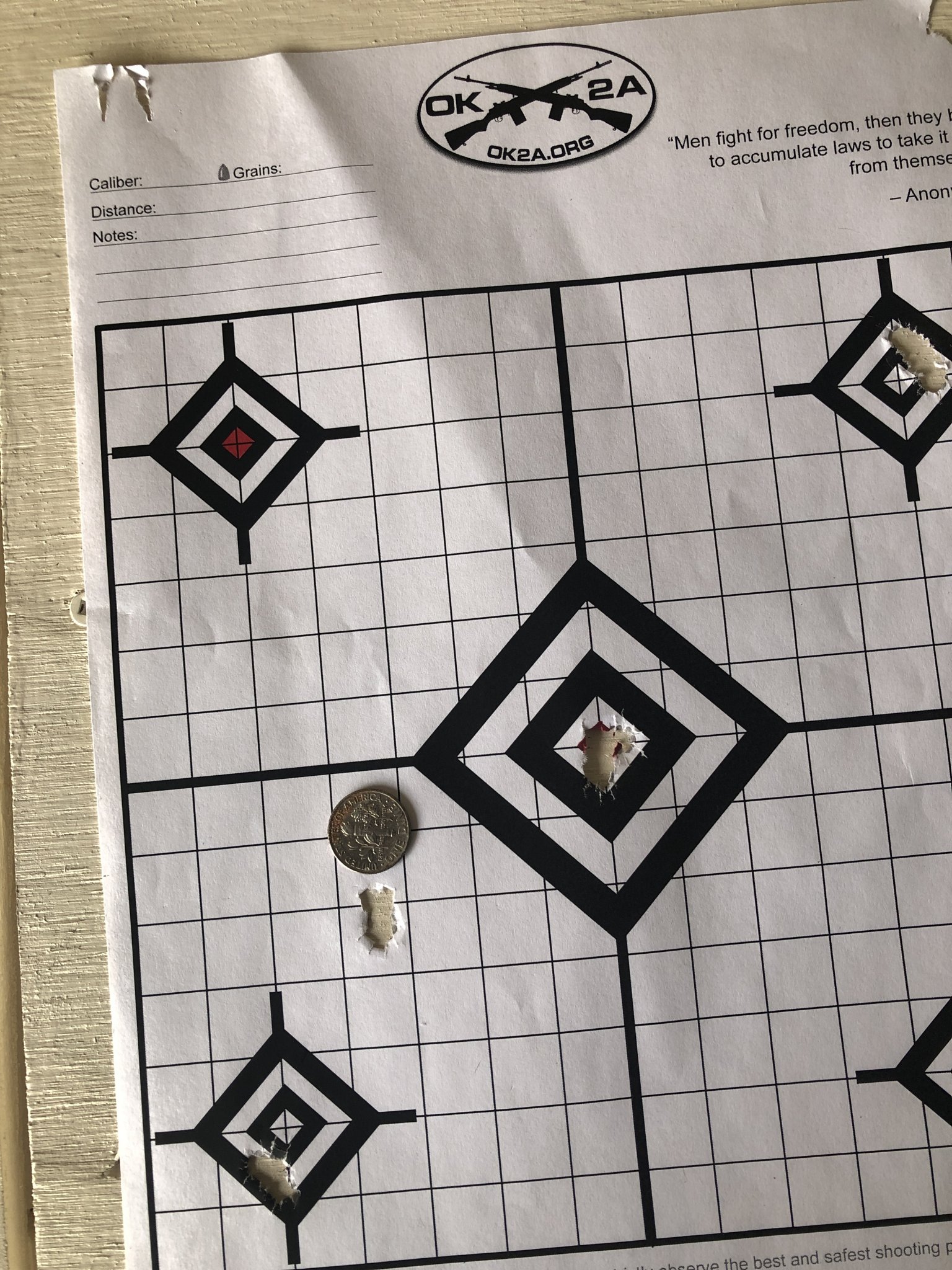

I mean if we are being picky and since you asked.....what’s under the dime??? 🤣
Use ballistic x
But at the end of the day you do you boo-boo 😘 and forget what we think!!
