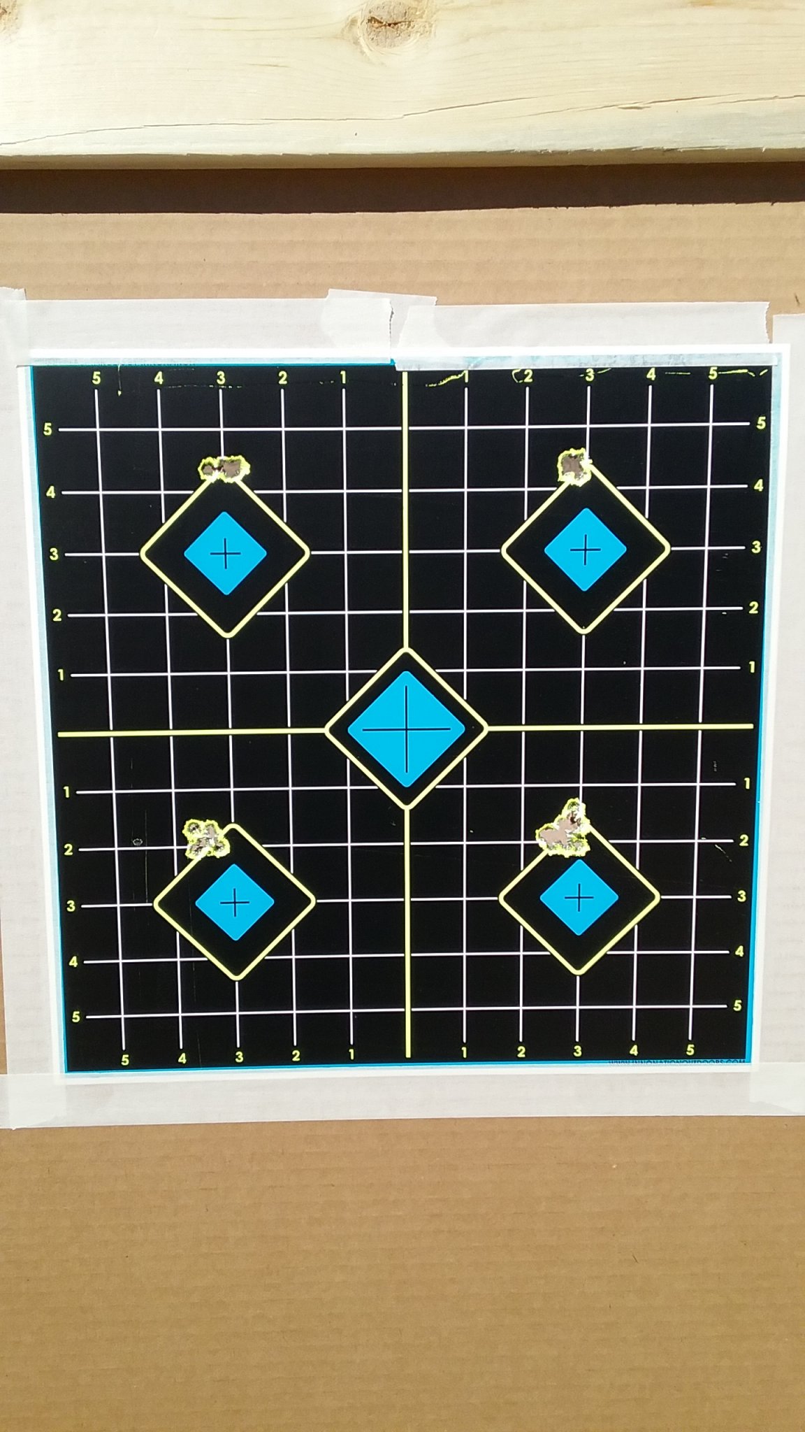

When H4350 was in short supply I developed loads for H4831sc and later RL16. All three worked well, but I'm sticking with RL16 for now.
Fired and sized Hornady brass - CCI 200 Tikka T3x CTR, 24"barrel 1:8
H4831sc - 142g SMK - 45.5g - 2689fps
H4831sc - 140g ELDM - 43.5g - 2712fps
H4831sc - 147g ELDM - 45.1g - 2711fps
RL16 - 140g ELDM - 42.1 - 2737fps
YRMV Pic is 7 shot groups with the RL16 during load development, (except lower right which is 14 shots when I forgot to move to the center)..
