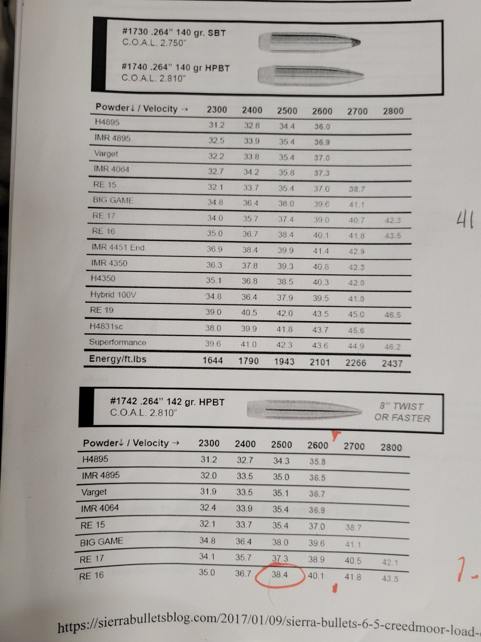

What bullet is this? Looked back through the thread but it is not clear to me. I have some RL16 and 140gr Hornady BTHP that I am going to work up a load for, but can't find much data. Alliant lists 42.6 gr for 140gr SST so was going to use that as a maximum and start at 41.8gr working up from there. Does that sound reasonable?
Probably a little too high. I would start a grain or more lower. Hornady’s 11’th edition manual lists the max RL-16 load for a 140 gn as 42.1 gn, and says it is good for slightly better than 2800 fps.
Minimum load is 35.3 gn.

I have the Hornady 10th edition which does not list RL 16. And Alliant's site does not list the Hornady 140gr BTHP with RL 16. As I mentioned earlier Alliant shows 42.6 gr for the 140 SST and 43.8 gr for the 140gr Sierra SBT. Does not specify that this is max load, so I am assuming this is their accuracy load?
Anyway thanks for the info as the combination I want to try does not seem to be listed anywhere that I have found. Might have to pick up a Hornady 11th edition.
Reactions: NamibHunter
Sure thing. Alliant data is max load. I have run a lot of RL16 in Creeds, my favorite powder. I would start around 41.4 and work up. Last barrel was 42.4 in Peterson with 144 berger running 2885. Barrel went around 1400 but it was a lights out shooter.

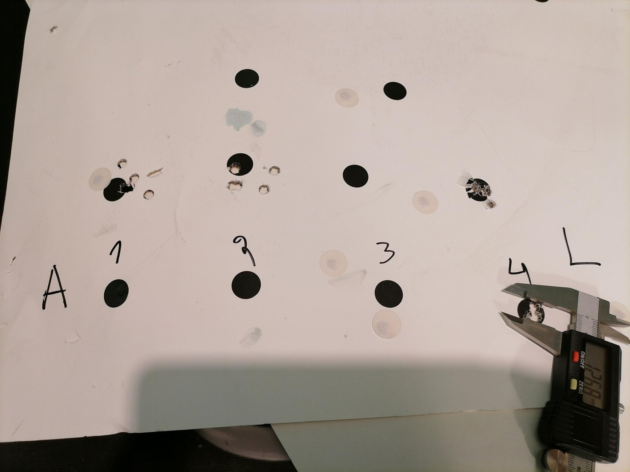

I have 2 loads for Lapua Scenars, with Vihtavuori powder.
123 Scenar and VV N150 38,6g.
This bullet is easy to load, 2mm off the lands and it work, do not go to the lands, because it will ruin the accuracy.
But then the 136gf Scenar L is 0,5mm off the lands, this bullet is like Berger and needs to be closer to the lands to make it work.
VV N555 and it works fine with 43gr and 44gr loads.
That 43gr would be even smaller than 44gr, but one flyer came, it was because hot weather and mirage from the ground was like grazy.
44gr was 0.2 MOA.
Krieger barrel 21".
Tikka T3X action.
KRG Whiskey chassis.

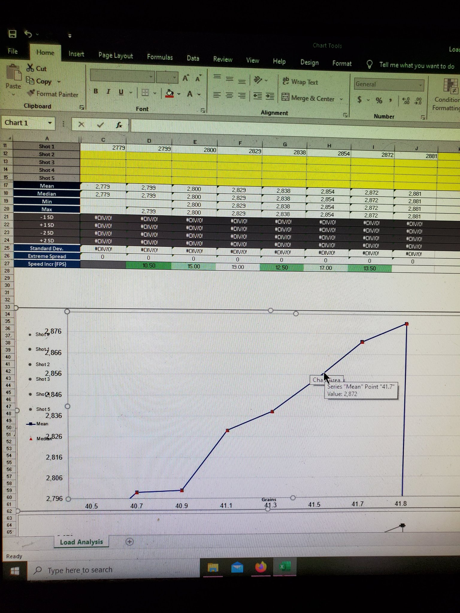

well i did a load test on some berger long range hybrid today to see if there is any flat nodes. seated at 2.80 oal. hornady brass cci large primer with h4350 powder. this was the speed test.

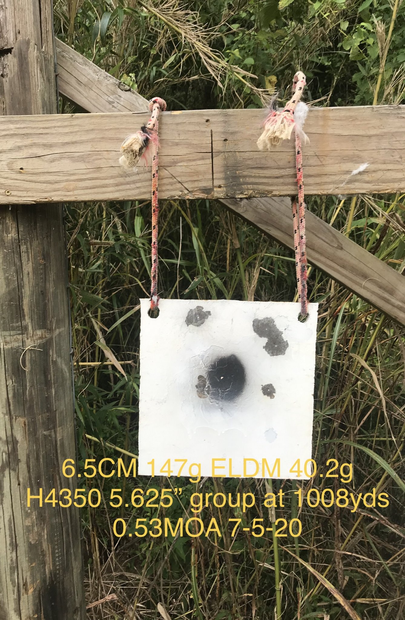

Does anyone have a preference between 147gr ELDM vs 144gr LR Hybrid Targets? I have both... thinking about just running the 147s and selling off my LR Hybrids. Not shooting much these days...
Haven’t tried 144gr LR Hybrid Targets, but I did play with 147gr ELDMs when you could find them.

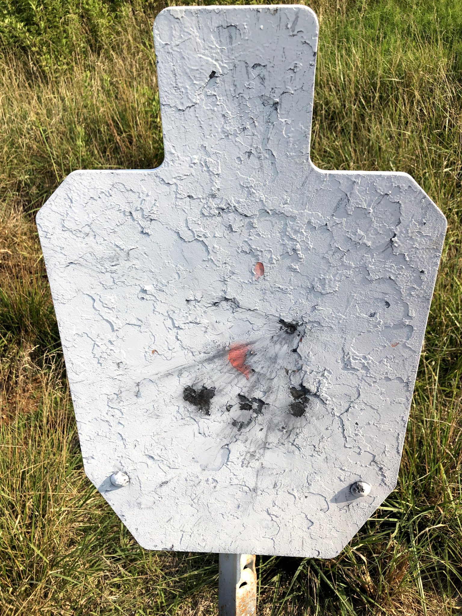

This pic was out of a stock Ruger Precision Rifle with multiple fired (Not annealed at that time) Hornady Brass. FL Resized 2 thou under fired Hornady Headspace Comparator reading, loaded essentially to mag length. Fed GM210M Primers. H4350 powder. Bipod on front, squeeze bag on rear.
This pic was out of a stock Ruger Precision Rifle with multiple fired (Not annealed at that time) Hornady Brass. FL Resized 2 thou under fired Hornady Headspace Comparator reading, loaded essentially to mag length. Fed GM210M Primers. H4350 powder. Bipod on front, squeeze bag on rear.View attachment 7645764

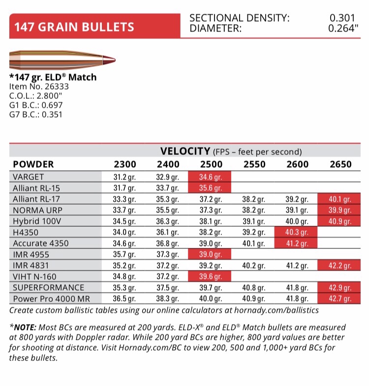

Can’t remember exactly what my MV was on the 147s, but was loading just under Hornady’ published max. I researched the 147 ELDMs a good bit before I triem them, & I did see a bunch of complaints from folks saying the 147s were prone to bowing up, but I did not find that to be the case in my tests. I didn’t load over max, & since Hornady is usually conservative on their published max data, maybe I just got lucky?
