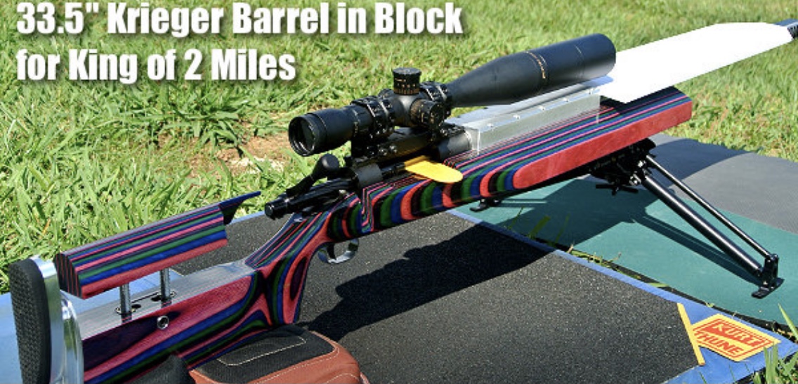

Example of a custom barrel block rifle (not my rifle!) built for King of 2 Miles. The block is firmly bedded to the stock, and the shorter section of barrel beyond the block acts (vibrates) like a short stiff barrel. Action is also free floated, so not touching the stock. Benefit of a long barrel in terms of speed and wind drift, but mechanically it behaves like a short stiff bull barrel rifle.

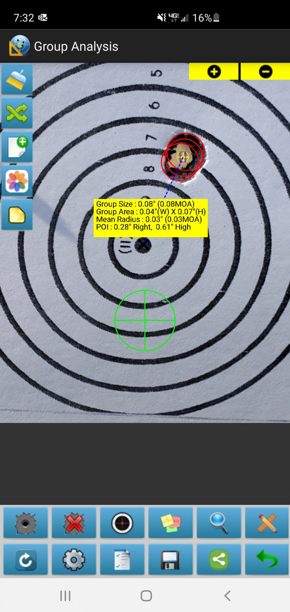

imr 4451 140 gr hornady bthp m bullets 42.0 gr 2737:max 2719 :min and 2729 :avg sd: 9.3 es: 18 I was shocked my starting load gave me that result I was thinking it would be far too slow a powder but was pleasantly surprised just another powder you might choose and from a 26'' barrel ,
how far off the lands do you go i'am at 10thou off the lands how far are you?
Man, I hate to say. I honestly don't "really " measure off the lands. I do the Eric Cortina style. I loaded a round and kept seating in deeper until bolt close was what I wanted (smooth). Then used his method on seating depth tuning (and then used his tuner brake as well). As far as a measurement, I use BTOG.
