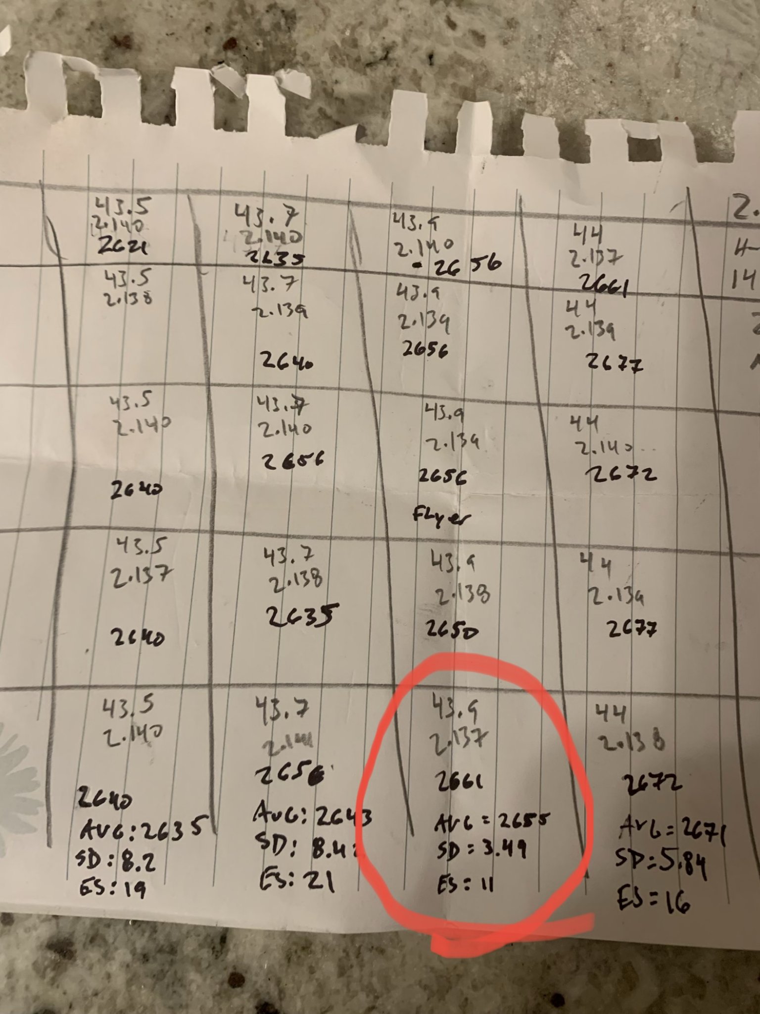

I am working up a load for my 6.5CM shooting the 140berger hybrids, Norma brass, FGMM 210M primers, H4350. 2.125 CBTO and jumping about 0.080.
My rifle is a Terminus Zeus action, Bartlien Med Palma cut to 19.4inches. I am shooting the ladder test with my TBAC Ultra 9 on it.
I got up to 44gr, 2,668fps, and no pressure signs. Bolt opened easy too. This is the first I’ve done for a 6.5CM. I’m very surprised. I feel like I saw a lot of folks saying they stopped lower. Heck, my 6.5x47L stopped at 40.3grs.
I am going to keep going up. I am trying to get 2,740fps to make the NRL Hunter Power factor.
Does anyone else have a load at like 45gr of H4350 for 140gr Berger hybrids?

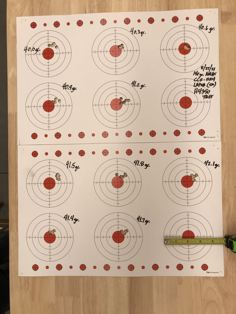

Popular load for the 140s in 6.5CM is around 41.8-42.0grs. Haha jeez you are up there. My load is 41.8gr AR2209 (H4350) I get 2850fps out of 26” barrel and Ultimatum action. Cheers

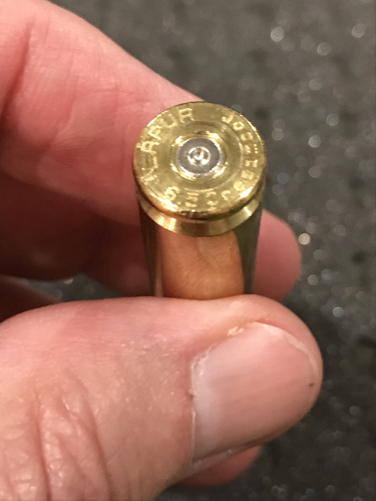

That is high for a SAAMI chamber. And very fast for a sub-20” barrel.
Unlikely - but possible explanations:
1) Could be that your chamber or freebore dimensions might be rather roomy. Could be the chamber is oversize, or the freebore is longer than normal, or a bit of both. Maybe check your twice fired brass (diameters and case head to shoulder datum) against fired brass from another factory rifle in the same caliber. Could also measure water volume with a scale as long as overall case length is identical. Range pickup might be a place to start if you don’t have a buddy running the same caliber.
2) Could be that your brass is thin skinned. Very unlikely as Norma is usually rather thick and strong brass, and tend to pressure out sooner.
3) You could be the lucky recipient of a “fast barrel”. Bartlein tends to produce a few of those every week. [It seems they don’t know how to reliably replicate this happy accident, so don’t call them and ask for a fast barrel...]
4) Your powder batch might be off on burn rate. Back off two or three grains and do another pressure test: Ask a buddy to load say a 5 round ladder for you using his (different) batch of H4350. Load a 5 round ladder test for his rifle using your powder. Should tell you somethig!
5) Your primer batch might be on the weak side. Very unlikely. Of you want to be sure, switch primers and repeat your pressure test. I would not bother with this.
6) Bullet diameters are generally very accurate because the dies that are used to make them are precision ground. [Major safety issue if these dimensions vary too much, so the QA folks watch these carefully]. Have seen some manufacturers that make sequential batches that vary 0.1 or 0.2 thousands of an inch. Could not detect a speed change as a result. Easy to check if you have a micrometer, but incredibly unlikely for Berger bullets.
7) Not to be insulting or anything like that, but you might have subtle pressure signs and you might be missing them. Many rifles need to be seriously over max pressure before bolt lift becomes tight. Extract say 10 primers, put them under a magnifying glass with good lighting, and see if you have “muffin tops”. You want to see good radius on the primer edges. Or take a sharp photo with a macro lens and zoom in, alternatively use your bore scope, that works well as a cheap macro lens. Primers often provide the first pressure sign. Some rifles will show primer cratering due to the firing pin hole not being a tight fit, some will not.
A cautionary tale: Have used Lapua brass for years now. Superb quality and very strong. Found a 41.5 gn load of H4350 that shot the 140 gn Hybrid very well. Never seen any pressure signs with that load and used it for months. Then on a whim decided to square the case heads as an experiment to see if that made a difference to my results, as i already had the equipment (LE Wilson mini lathe, and all the cutters). Case heads lost some of their lettering as the case heads were (apparently) not perfectly square. [Or the Wilson case holders are not perfectly concentric, a real possibility.] Post tumbling, i suddenly realized that half the cases had clear full circle ejector marks on them. Not bright shiny marks, but still a full round circle, but it was a very shallow indentation. These marks were too feint to be visible on the lettering before. Now they were very visible. The load was probably slightly over pressure, i just did not know it. Backed off 1.0 grains and the ejector marks went away (and sadly group size opened up to 0.7”), eventually found the next lower node around 50 fps lower down.
And nope - squaring off the case heads made zero difference to my group size…. I don’t think the Wilson setup is accurate/concentric enough to do this properly. [Messing with powder charge did make a (very negative) difference!]
Btw: Have three rifles in 6.5 CM, and when new, all of them hit max pressure below 42.0 gn of H4350. The older barrels with 2,500 rounds (or more) on them need 0.5 gn (or a bit less) to hit max pressure, and speed is mostly similar to what these barrels delivered after 200 rounds. More freebore lowers pressure due to the erosion of the lands, allowing for more powder.
Do you know your freebore, was the barrel throated for 140 Bergers Hybrids - or something else?

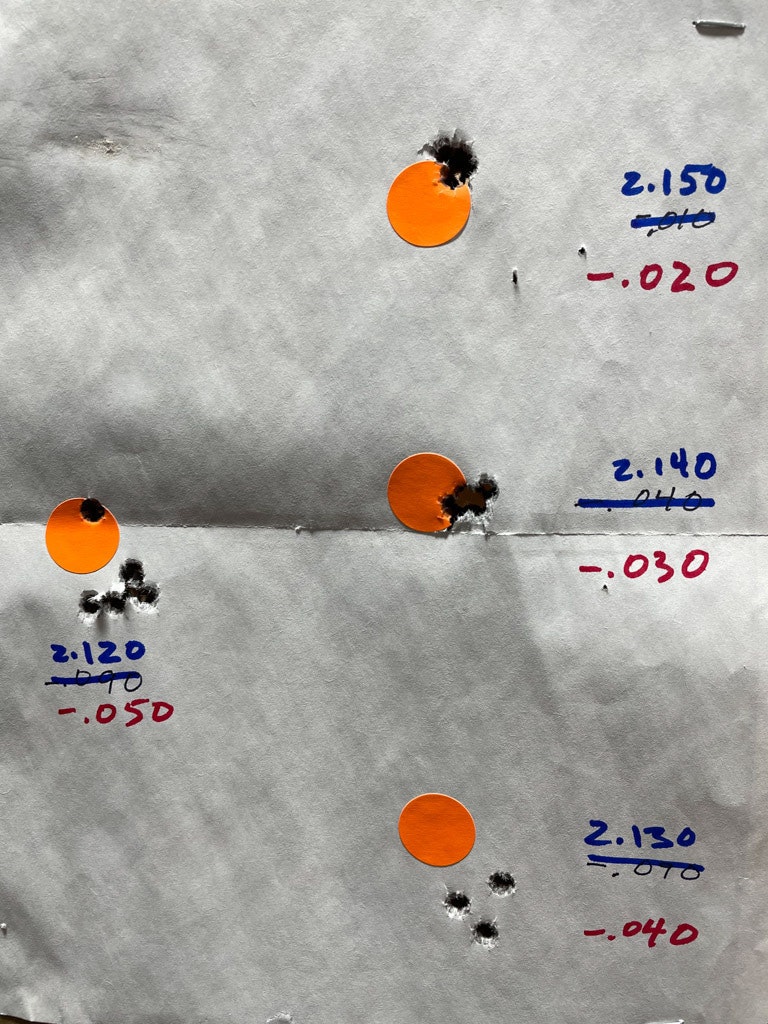

I went to the range today to find a for sure upper limit. I found it and I saw ejector marks. I didn’t get to the speed I was looking. I saw them at 45gr and around 2,730fps. I stopped.
I did load some ammo and adjusted the seating depth based on previous ladder test. It looks like I am going to shoot 43.9gr.

The VLDs like to be close to the lands. It's very easy to see with a ladder test.
I started with 5 rounds at 0.020" off as 0.010"off does not fit into my mags.

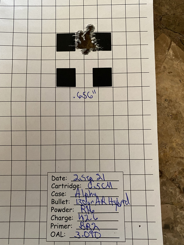

I’ve had good luck with 123gr Scenars, 130gr VLDs, and 130gr AR Hybrids launched at 2900 - 2975 from my 24” Bartlein barrels. In those bullet weights, I prefer Varget, but did just recently work up an accurate load using R16 and 130gr AR Hybrids. Haven’t had the opportunity yet to verify velocity.
This is a ten shot group. Subtract 1” from shown BTO. That figure includes my Sinclair hex nut comparator.
Update to add velocity.
Took this load out to 900 yards and calculated the velocity with Ballistic AE. It worked out to 2883 and the group was stupid good, about 5” horizontal, and less than 2” vertical.

Having some concerns with the initial load development with my new AIAX in 6.5CM and asking for opinions.
I'm experiencing faint pressure sings (ejector swipe) with new Lapua small primer brass on every charge I've tried. Did 50 rounds, five rounds each in 0.3 grain increments from 40.0 to 42.7 grains. Obvious accuracy nodes were between 40.3-40.6 and 42.4-42.7 but I'm concerned with the higher charges based on what I'm seeing. I loaded another 5 at 40.6 and ran across the chrono and they averaged only 2,417 fps with the 140gr Amax and that just plain sucks. Am I just paproid? Should I focus more in the 42.4gr area and just expect fewer loadings on the brass?
Here's a pic of the faint pressure sign, semicircle thought the "LA" in Lapua.
And a pic of my groups, 5 rounds at 100 yards (those labeled 41.4 & 41.7 are actually 42.4 & 42.7, I'm a moron).

I’d say you’ve got an issue unrelated to powder. Unless your bore is finished like sand paper and somehow manages to make huge amounts of pressure without any velocity to show for it, there’s something else at play here. Under “normal” circumstances, at 250 fps below spec you’re nowhere near MAP.
ETA:
You know, as I go back and look at this... I can't figure out where your powder is going when you ignite it. My experience with IMR 4451 is that is typically takes a little more powder to get the same effect as H4350. 42 grains of 4451 in Hornady brass pushes 140s around 2675 for me out of a 22" barrel. I'd guess that's about 41.5 grains of H4350 or equivalent. Which is a long way of saying that your powder charges are probably about where they should be - stout, a little above book max. Your velocity is waaaay off, and I don't know why.
