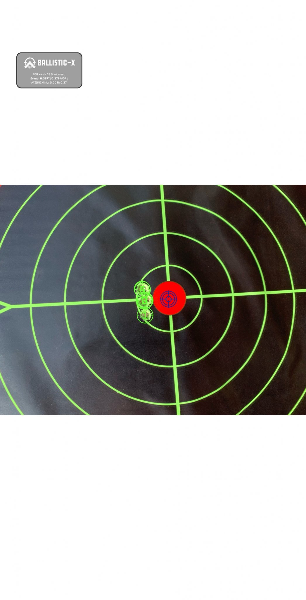

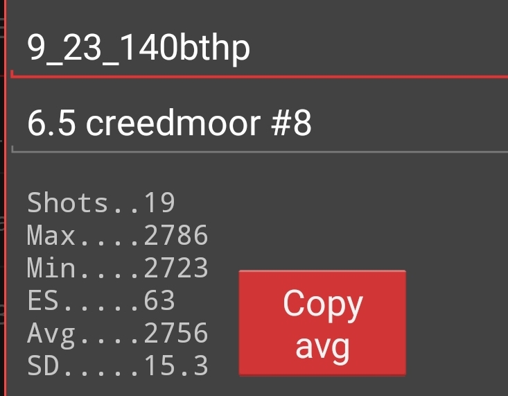

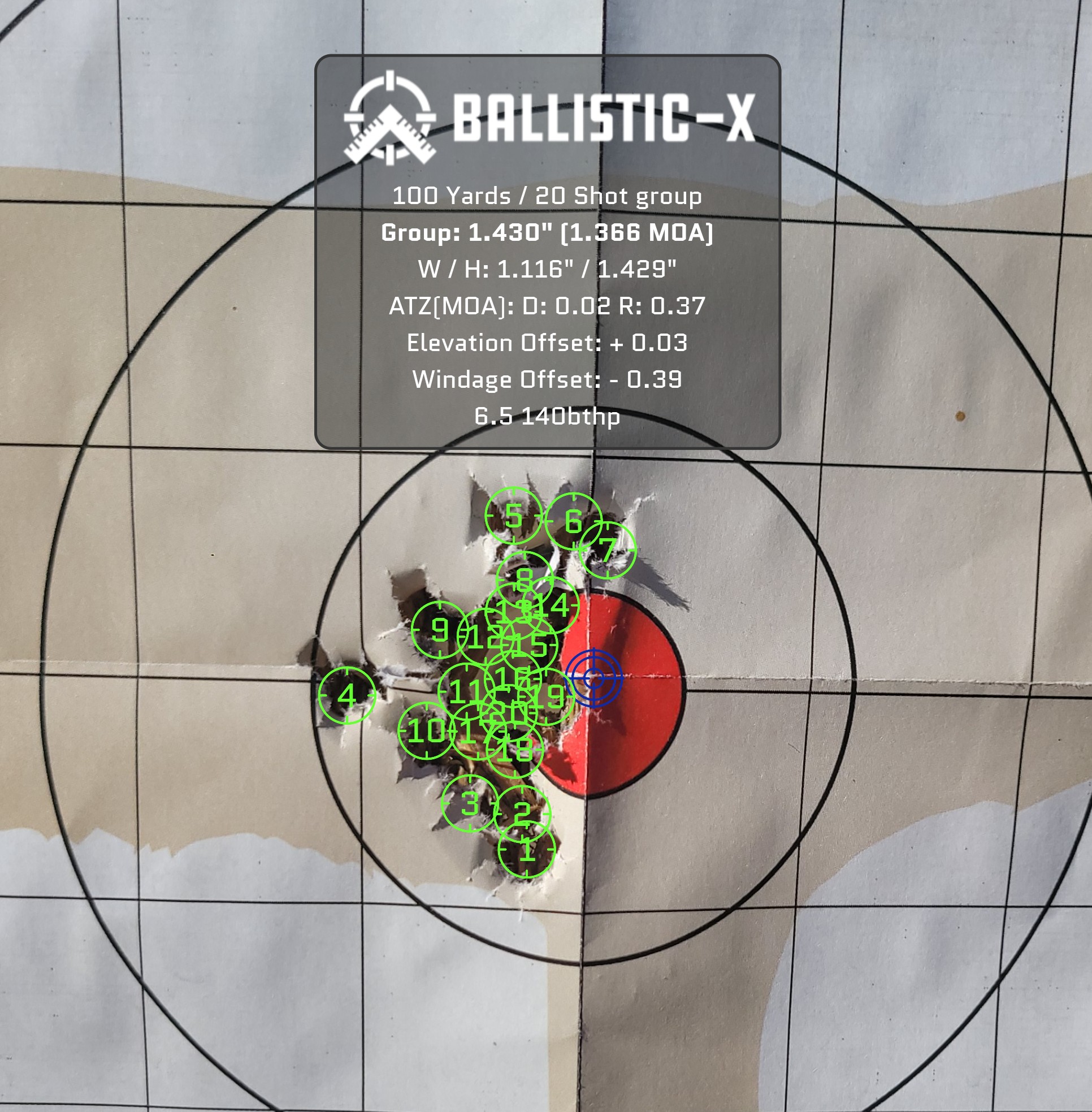

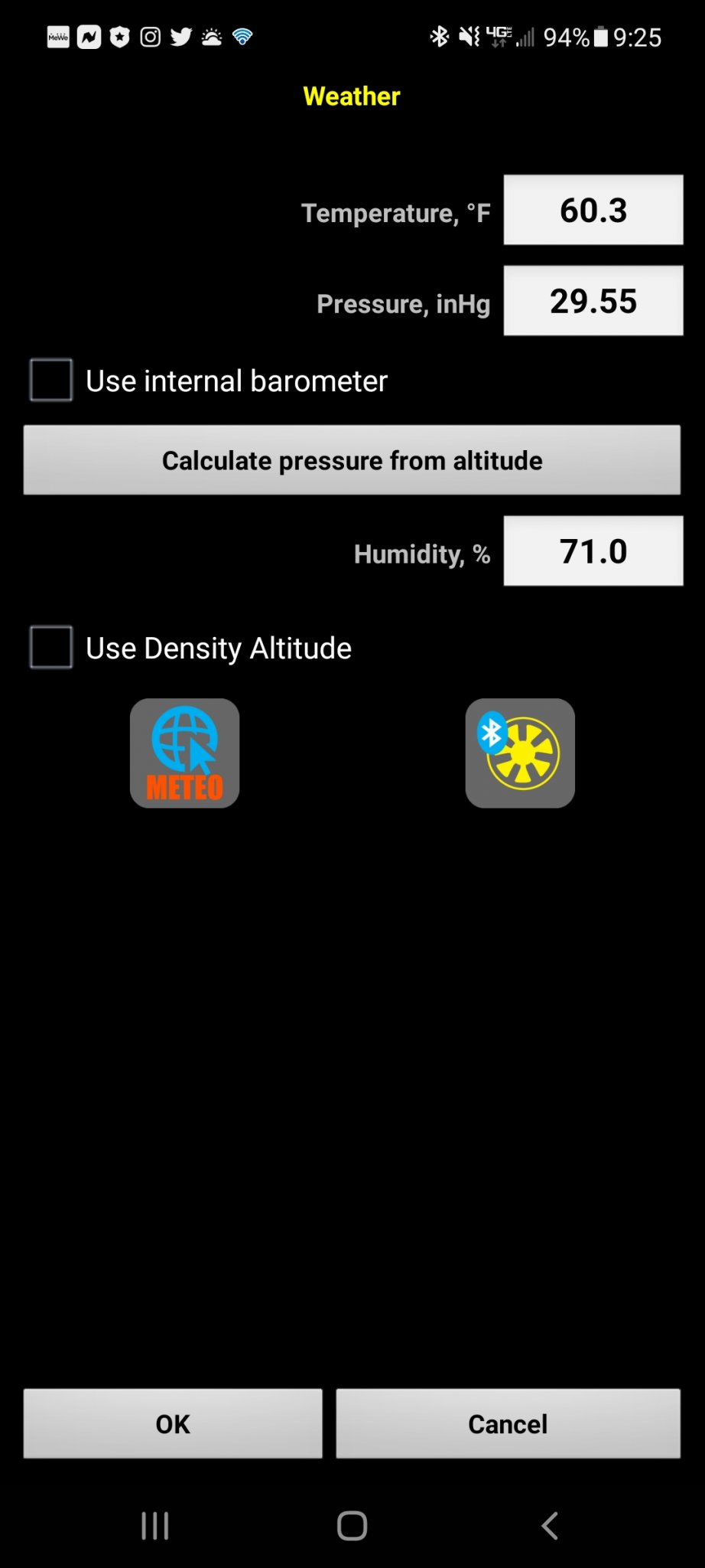

While waiting to go to therapy for my elbow today I went to the range. Had to shoot from a caldwell fire control since I can't get my rear bag under the gun with my arm. Slick bench tops so kept having to move it. Wanted to see how much better my sd is since switching to the intellidropper. For hornady brass and dies I'll take it. Not match winning loads but neither is the nut behind the rifle
140bthp hornady
Hornady brass
43.2 h4350
Bto-2.690
22 inch Columbia River arms barrel with 360 rounds at beginning of session.
  • Ballistic-X-Export-2021-09-23 10:00:11.788453.jpg
