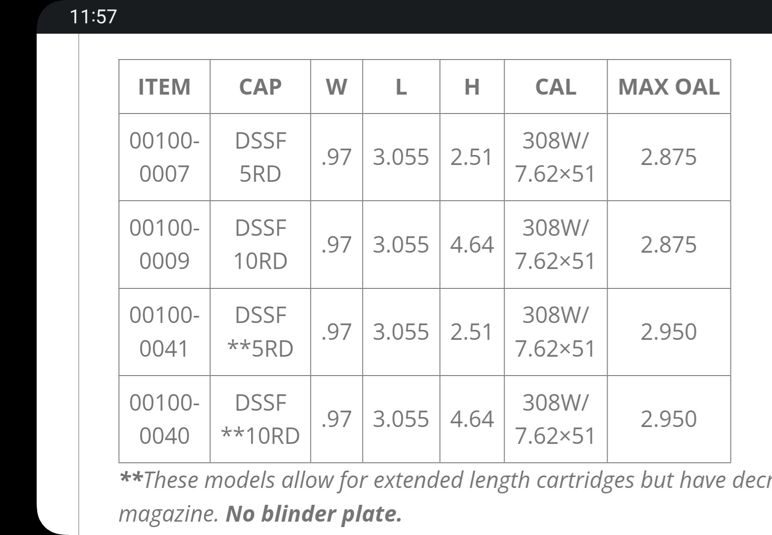

MDT non binder plate mags take 2.95 internal coal, American Rifle Co AICS mags take 2.97" internal. Even Accurate Mag non binder take 2.95. Pretty sure AI AW mags will take 2.96 or so. Here is a screen from accurate mags website, notice they have a short version and an extended non binder plate. You also have to ensure your action can handle the extra OAL. Heavy Eldm bullets in a creed usually start touching lands around 2.88 so the extra room isn't of much use but bergers/smk can be loaded over 2.9" before touching. This just gets the bullet out of the powder space.
