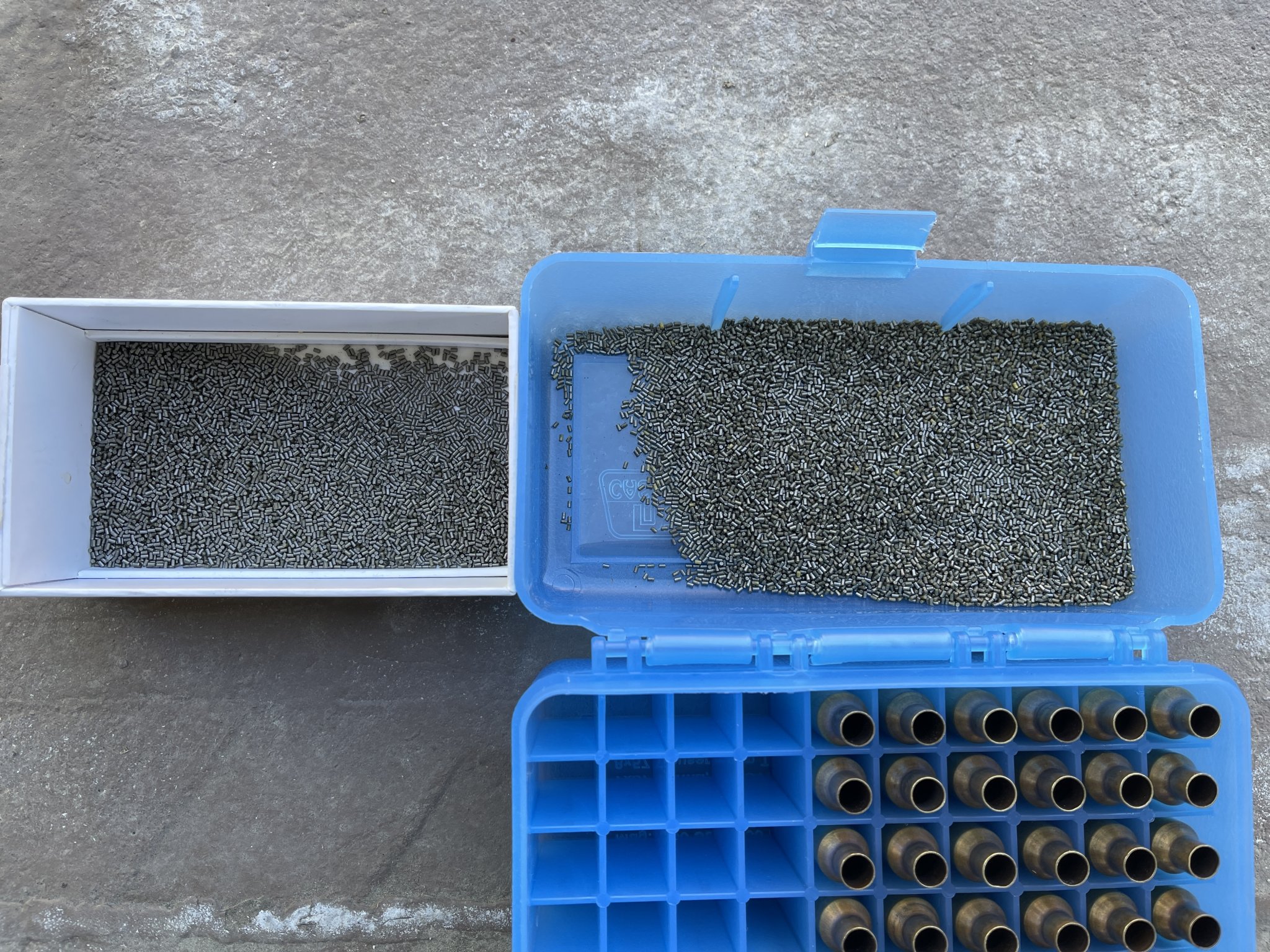

I pulled the bullets from 8 of the failed rounds and it looks like the primers fired in all of them. the bases of the bullets all have a brownish color. (photo1).
the powder from these failed rounds (right hand side of photo) also has yellow discoloration and some are much darker than the rest. for comparison purposes, I also pulled 5 rounds that I did not fire and the powder from those rounds is on the left of the photo. (photo2)
and here are the 5 bullets from those rounds. the bottom look look brand new, unlike the 8 that failed. (photo3).
Okay. I'm not sure that totally eliminates the primer as the problem, but it does lead me to believe that either the primers or the powder was contaminated, probably by case lube. I suggest loading another batch paying close attention to how the primers are handled. Don't use anything but dry graphite lubricant inside the case necks.
If powder is discolored ....the primer fired ... but failed to reach pressure to cause full powder ignition.
To little primer flash, too little neck tension. Primers not seated fully, too much headspace. The Large rifle primer makes a larger flash....
Take a fired case that does not chamber in your rifle of the same caliber, partially size, won't chamber, turn the die down 1/8 turn size again...repeat until the bolt closes...if it closed hard, go down another 1/16 turn. The bolt closes easily...that is the correct headspace for that brass with your chamber...no gauges needed but they can surely help, and how we did it before the fancy new reloading tools. Now the primers should fire 100% if seated in the primer pockets.

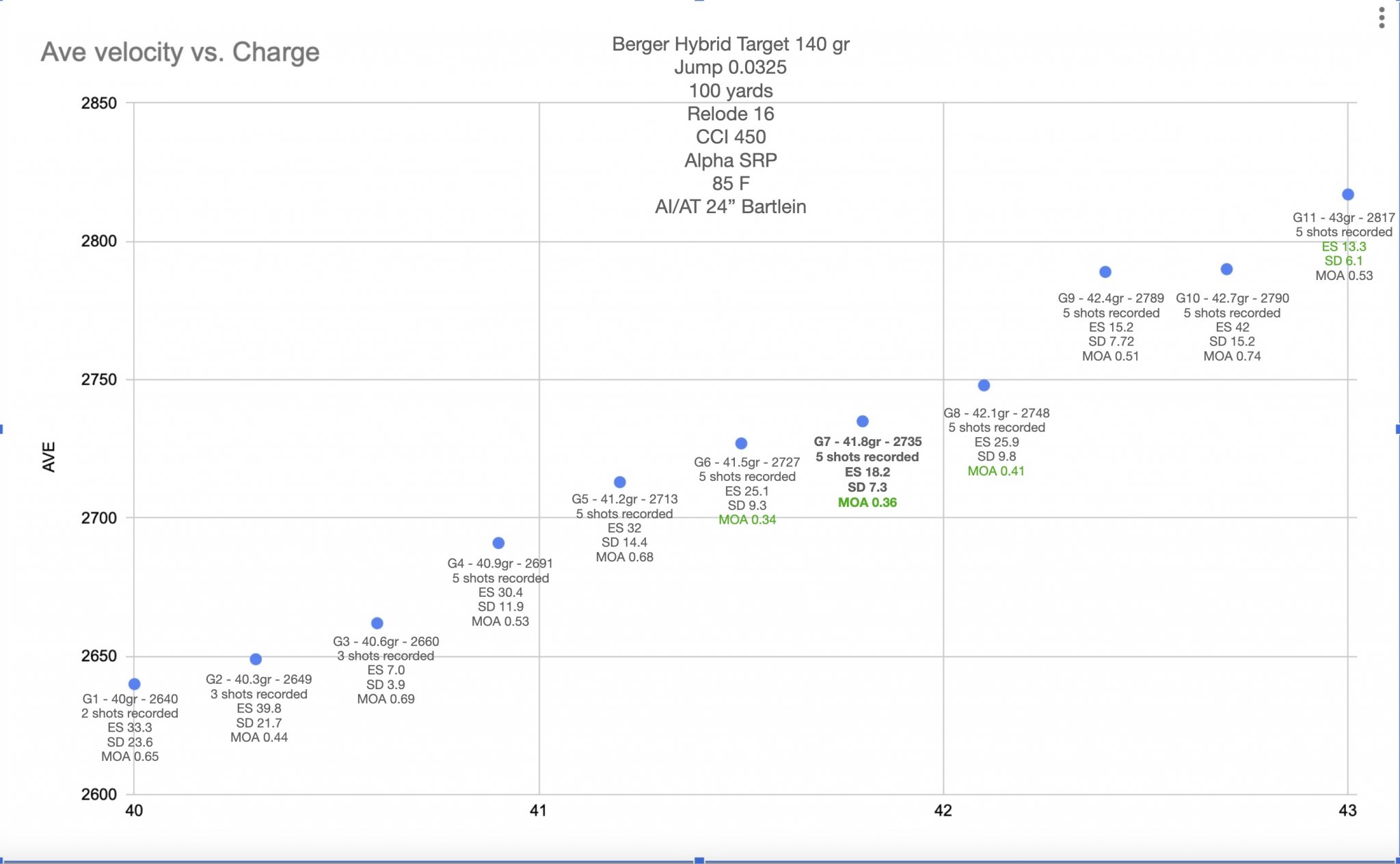

hi all,
so I just did seating depth test today. (all rounds fired this time - must have been the case lube :ROFLMAO:). I did a 5 shots group for each jump . below are the results. the velocity is all over the place SD: 10-17, ES:27-47. so I guess I need to do the power charge weights test again. which jump would you use for the power charge weight test (based on the photos below)? thanks.
6.5 CM
Berger Hybrid Target 140gr
H4350 42.6 gr
Alpha Brass Small Primer
CCI 400
AI/AT 26" (Bartlein barrel)

Shoot the best 3 or four groups and see if the relative speeds and accuracy are somewhat consistent. I have been in this position before.
I wound up with a new scales (+\- .005 grain) and a review and serious changes to my case prep. Consistency throughout the process is critical to consistent shooting. I even critically reviewed my shooting “process” and changed up some of my habits. Zero Force Firing Position (ZFFP) became my mantra lol and that’s a mouthful. I got sloppy in my processes and it showed. It’s funny how that can happen a little at a time and when I bought a new rifle it showed. Decades of reloading and shooting resulted in a slow accumulation of small errors. It had reached a point where load development was a nightmare.
When I started the journey there was no internet until 20 years had passed. It took another 20 for me to look into reloading and shooting resources on the net. The net can be a seriously excellent resource. I blather. Sorry!
Good luck with your process! I hope my journey can offer some help.

I think they all look pretty solid. Bear in mind that 1/2" at 100 yds. equates to .003" at the buttpad (according to Ted Karagias). I'd pick the .020,
find the most consistent powder charge, and don't change anything until you see a velocity drop.
Reactions: markl323
The variability in muzzle velocity may not be noticeable at 100 yds but out at 700 yds those nice groups will be all over the place.

Hi all,
I did a powder charge test today using a good jump seen in the last seating depth test (post #3143). 5-shots groups. This time I switched to RL-16 and CCI 450. My ES and SD got cut by half! Group sizes seem to get a bit better as well.
There appears to be a node at 42.4 - 42.7gr? but since the ES & SD for one of the groups is not so good maybe I should skip this node?
However, the ES and SD for Group11 looks good and there are no pressure signs yet. I'm going to try 43.2 and 43.4 next weekend and see if there's a node there.
If there isn't a node there, I'm thinking of picking G7 and be done. ES & SD seem stable and low enough between G6-G8. What do you think?
I think you should just pick your speed that you want to shoot that is within a safe pressure and just load it and shoot. I’m guessing what your POA is and they seem to be mostly with the same POI, from everything I’m reading and my own learning and experiences, your ES, SD should tighten up with measuring to the granule with powder and keep consistent loading practices.

If this was my gun, I'd try a load at 41.9 or 42.5 (assuming no pressure signs) based on your groups vertical placement. Pick the speed you want and fine tune seating depth.
