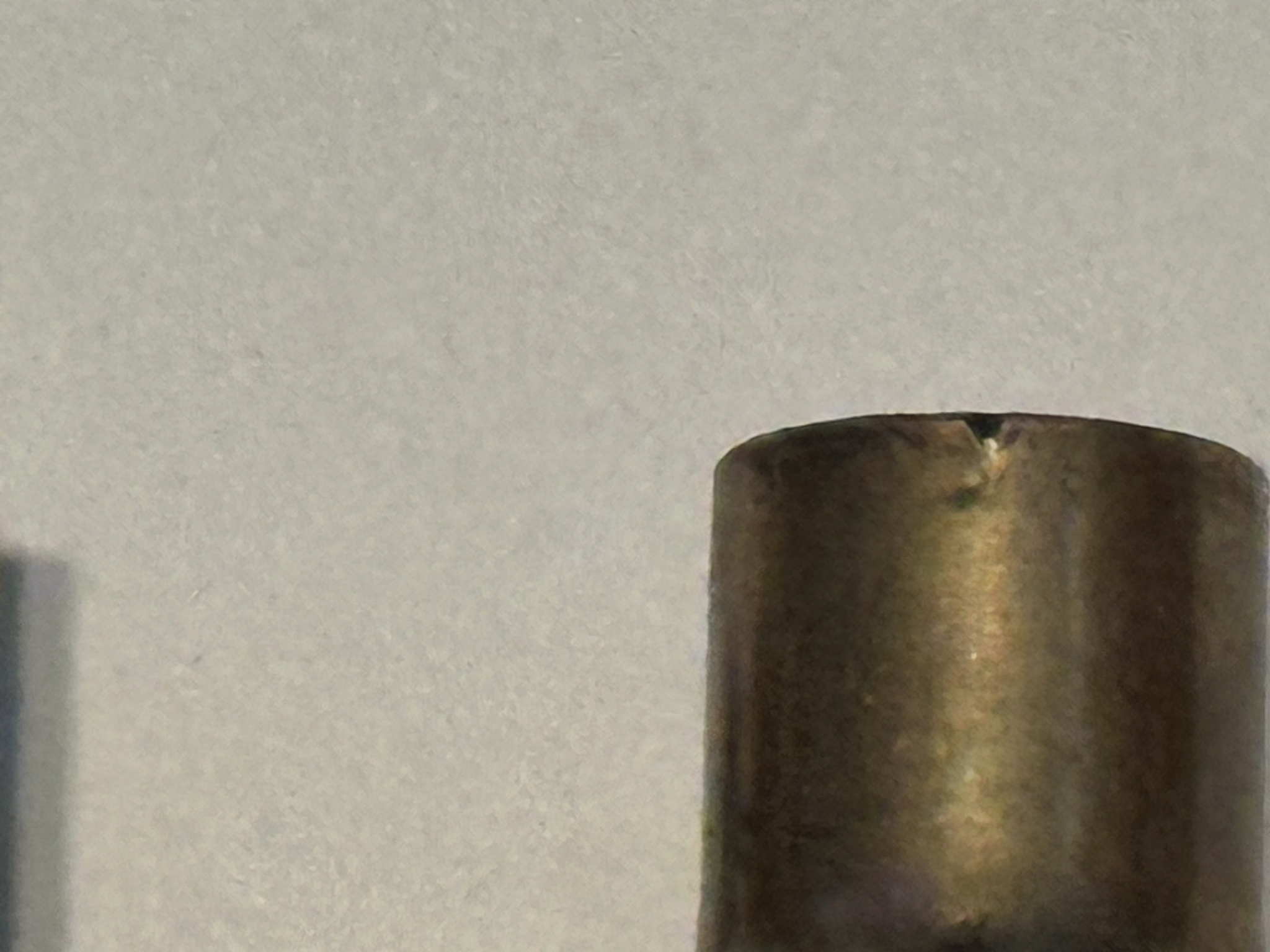

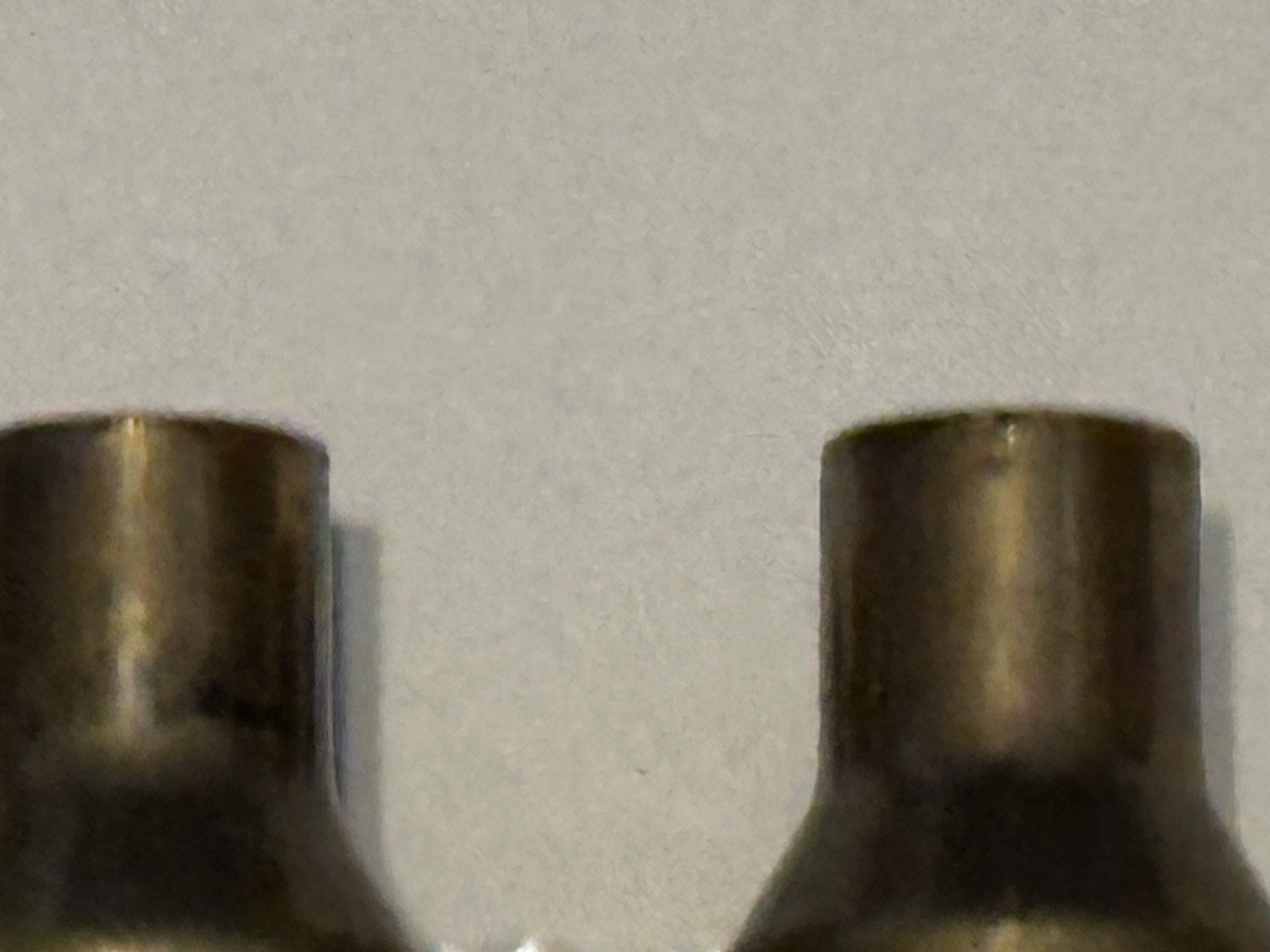

Still new to reloading, and need to know if this an issue I can fix or is this normal. The cases are once fired Lapua 6.5 creedmoor 140gr hybrids 41.5 grain h4350.... 60 cases have the same "nick" in the case mouth after a day at the range.... is this fixable? Normal? any help would be great. Rifle is an AI AT 24" 1:8 barrel suppressed....

Look in the ejection port on your action to see if that is were the case is making contact and causing the knicks.

I'd also do a close eyeball of your chamber especially the locking lugs back side . It's not uncommon to find a bur or having the case nick it's self off the lugs upon extraction . Try removing 0.015" off a case then re load it and see if that's the cause or perhaps adjust gas if you have an adjustable gas block .
Had that issue on one of MY .308's and changed powders and it went away .

My question is pretty simple: does this happen only with your reloads or does it also happen with factory rounds?
