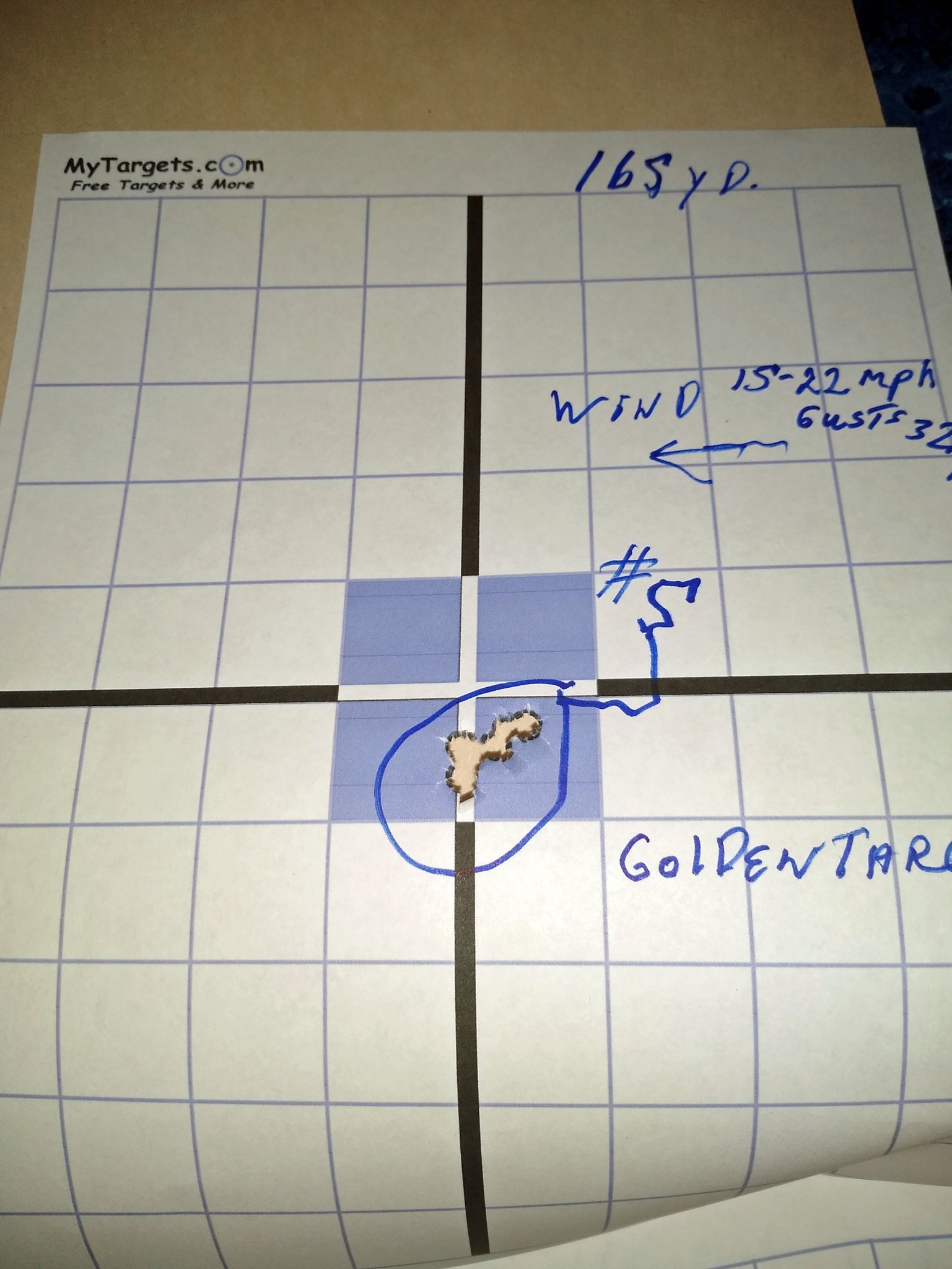

MY $0.02 worth of advice ,near any reputable Match ammo is gonna be Great Brass . I had 0 brass for 6.5 back when and found a deal on Norma Golden Target . Their Brass is near every bit of Lapua ( I've run comparisons real world tests and find NO fault with either ) .
When I secured 6.5 Norma it cost Me $22.50 per #20 ,so pretty reasonable in MY book for New ammo and Once fired Brass in MY chambers .
Compare once fired or range pickup and You'll understand immediately that reasoning . First #5 I ran back July 2023 at 165 yd. out of MY self built Aero Precession , so I was happy . Especially seeing as it got Better when the wind died down . Fyi : I don't even own a rifle rest ,just a sandbag :)
Reactions: worm304

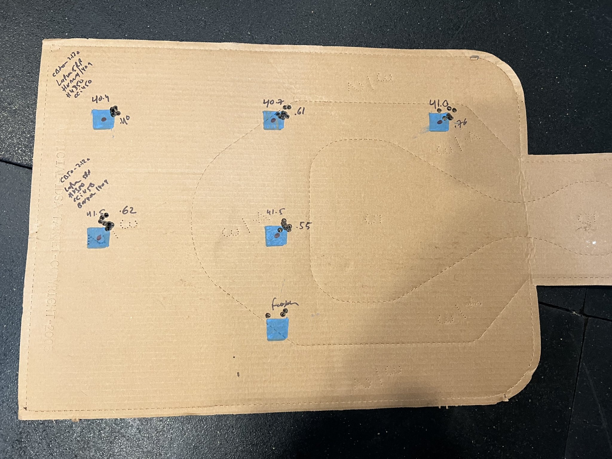

Looking for a little advice from experienced reloaders. All of these are 10 round groups and are both seated .015 off the lands.
Top row is Hornady 140g Eldm, lapua srp, cci450 and h4350.
40.4g
sd=6.5
Avg-2709
Es-20
40.7g
Sd-6.7
Avg- 2732
Es-22
41.0g
Sd-5.5
Avg 2752
Es-16
Berger 140g hybrid, lapua srp, h4350
10 round numbers
41.5
Sd-3.8
Avg-2797
Es-12
20 round
Sd-7.0
Avg-2795
Es-29
So my question is which of the two would you pick to run solely. I’m looking to pick one and just run it for a while and start into prs.
Top left. Just run it and go, work on the positional stuff. I wouldn't chase it any more than that, it meets the need for PRS stuff.
Reactions: Kevin H
Test them farther out to see if the groups hold. 100 yard is a start but not the end in picking a load. I would test them at at least 300 yards also.
I’ve shot them both out to 400 on steel, that’s all my rang goes too. Both were solid. Point of aim and point of impact. I need more range which I’ll get soon to true everything up.
400 is far enough to see if the group size holds together. If they both shoot just as good as the other than it’s your pick.
Reactions: WyomingShooter

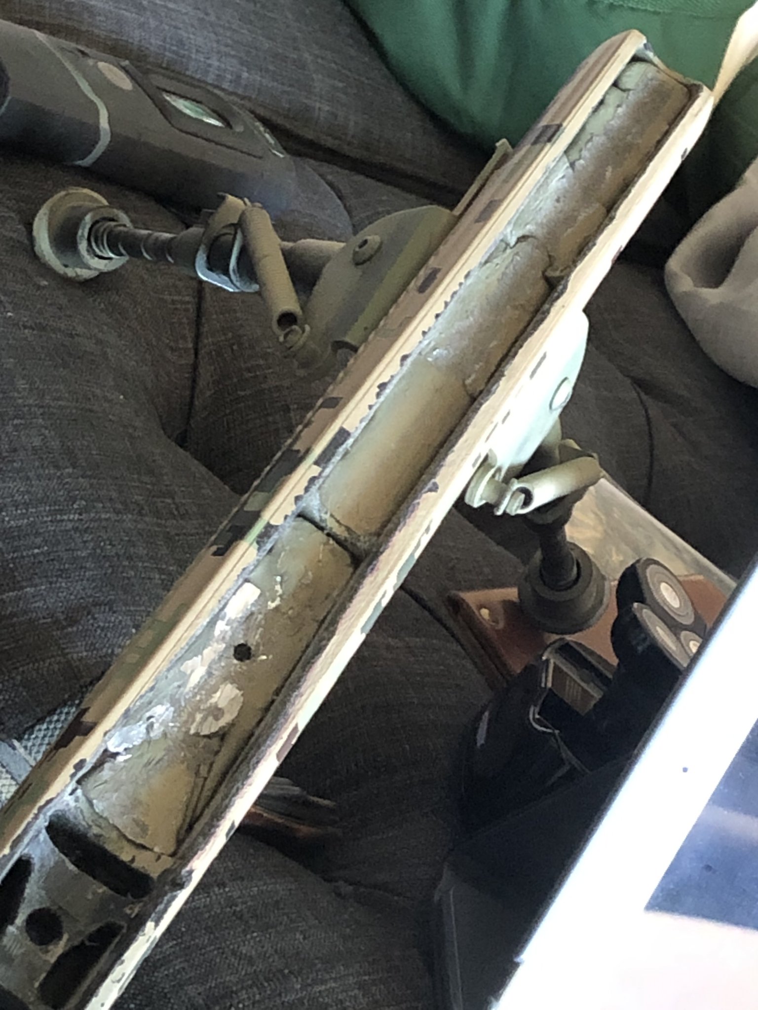

I need weights
I just ordered some lead ingots from Amazon and melted them in an old small pot. Pouring was a bit trickery so make sure you are in a safe area, nothing interesting under it, and go slow. I used a grind bit to smooth it out. Added about 2.5 lbs
I need weights
Shortly after the lead addition I went ahead and bed the action, mainly the posts using stainless steel posts. Shoots <1/2 moa. My actions screws are torqued to 55# vs the 30# before bedding the posts.
Love it. After I burn out the barrel I will replace that with a bull. I expect this is my last rifle. 👍
