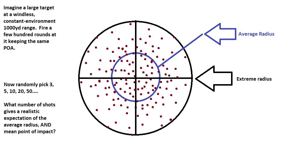

Dispersion effect. Even 10 shots is insufficient (although much better than 3 or 5) for stable and accurate statistical analysis.
It’s like talking to 100 random people and using that data to predict an election.
So are you saying the dispersion effect isn't real or that you would need to talk to 10 million people to have an accurate data sample that might predict an election?

Sounds good! The reason I asked is related to the dispersion pattern that results from shooting like 100 rounds (such as you did).
Essentially a cloud pattern where any 5 random from the pattern could be any group of 5.
Not sure I described that well… Based on your reply it sounds like what I would expect when I shoot, but I generally don’t shoot that many at the same time to compare, and I don’t really compare one trip to the next. I tinker with seating depth as part of my experimentation.
