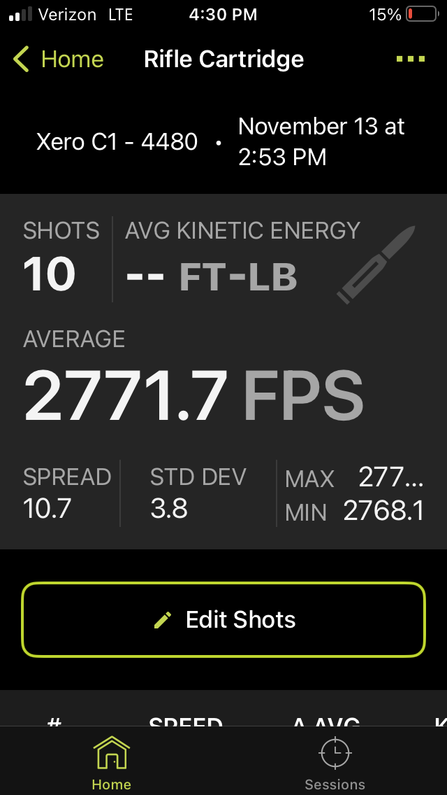

I just opened a fresh 8# jug of h4350 and my velocity was 70fps slower same everything else for what it’s worth.
It's the opposite for me.
Last year or the year before I bought 3 jugs of H4350 on the same day with the same lot number.
I've been consistently getting around 2758fps using 139gr Lapua Scenars and 140gr Hornady ELD-M with 41.2gr in Lapua brass with BR-4's
On Sunday I cracked opn the new jug and loaded 20 rounds and brought them to the range.
My average velocity was 2796fps. This is in 45F weather.
I thought that I may have accidentally loaded 42.1gr instead of 41.2gr so I kept 1 bullet and took it apart when I came home.
It was exactly 41.2gr

Not sure if this is relevant, but shooting 140gr ELD-Ms seated at 2.820 oal out of my 26" Savage I am getting sub moa (.5 to .6) with 42.4 gr of H4350 with an average velocity of 2840fps and an SD of 5.
These numbers are averaged over multiple 5 and 10 shot groups at 100 yds over the last 6 months or so.
Last summer, after getting wind and elevation dialed in, this load was consistently center lining a plate at 1240yds.
