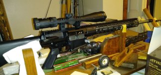

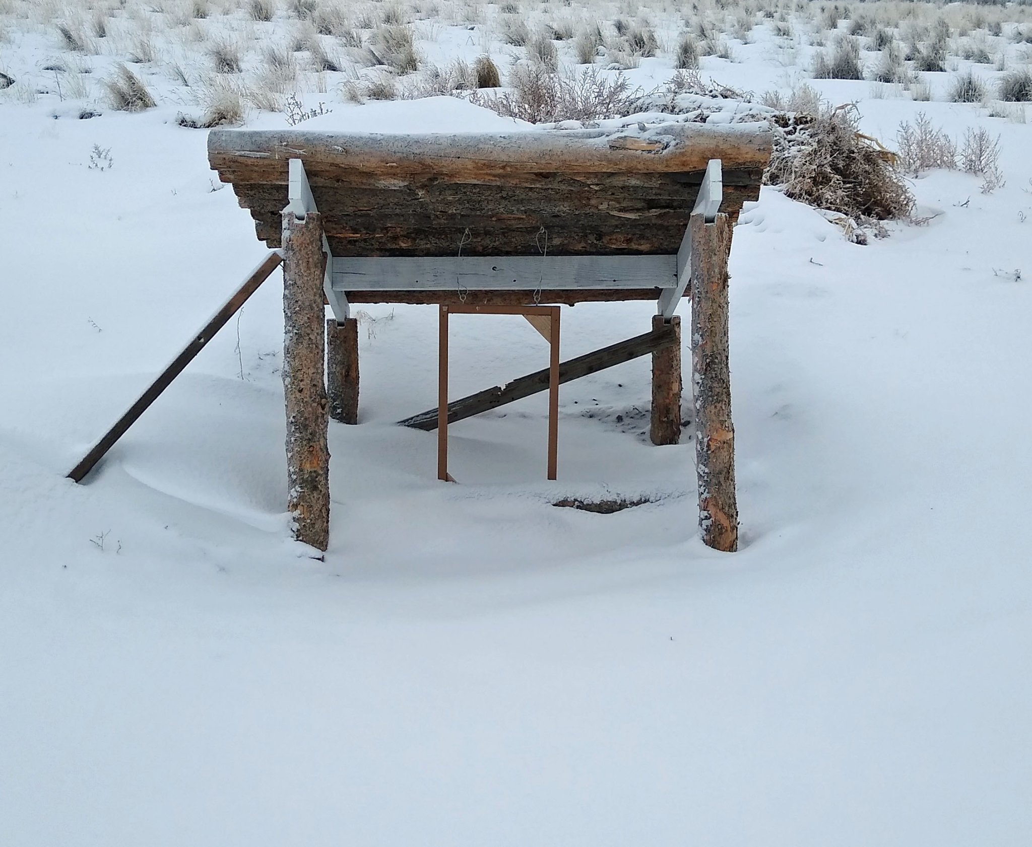

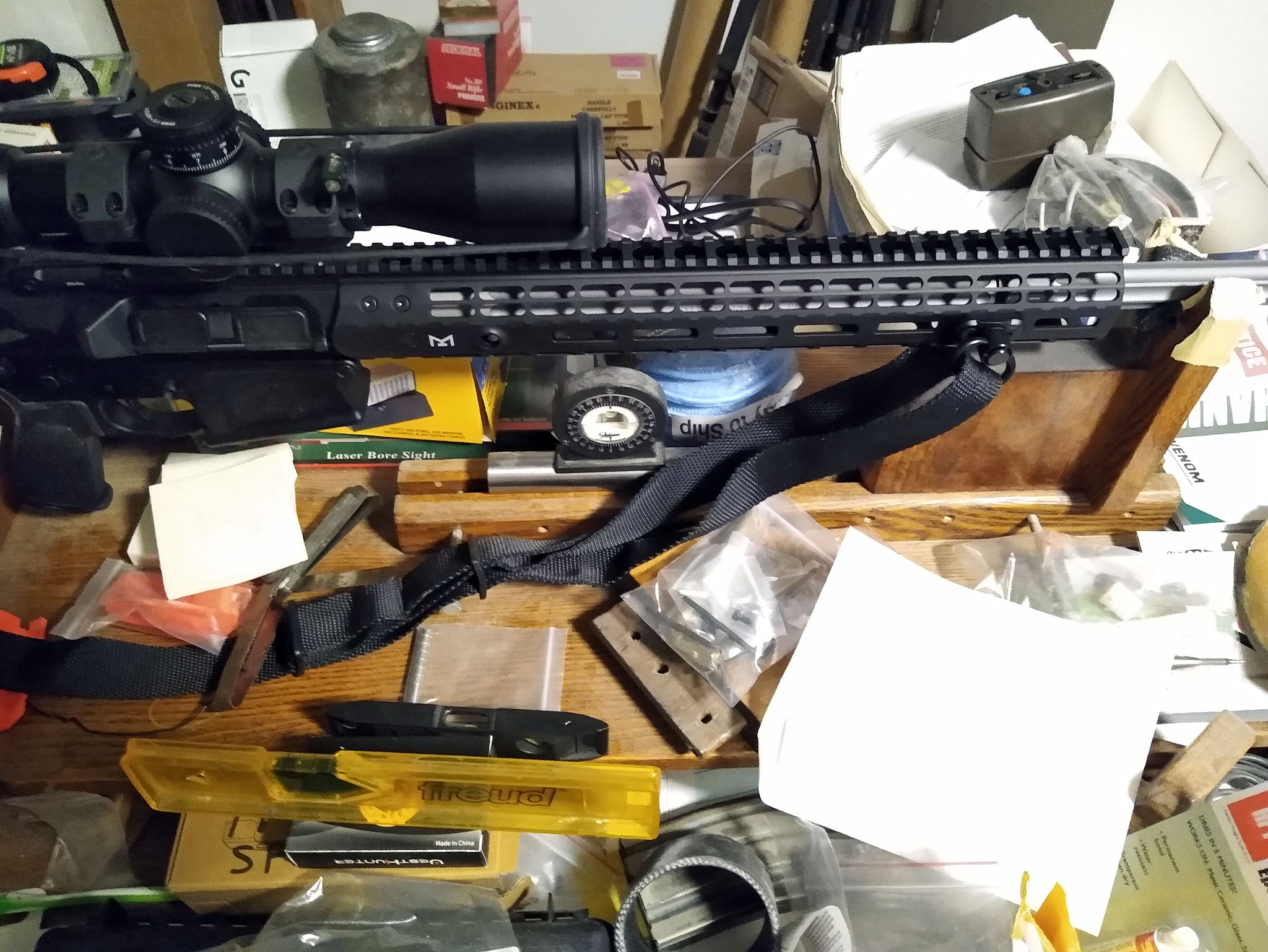

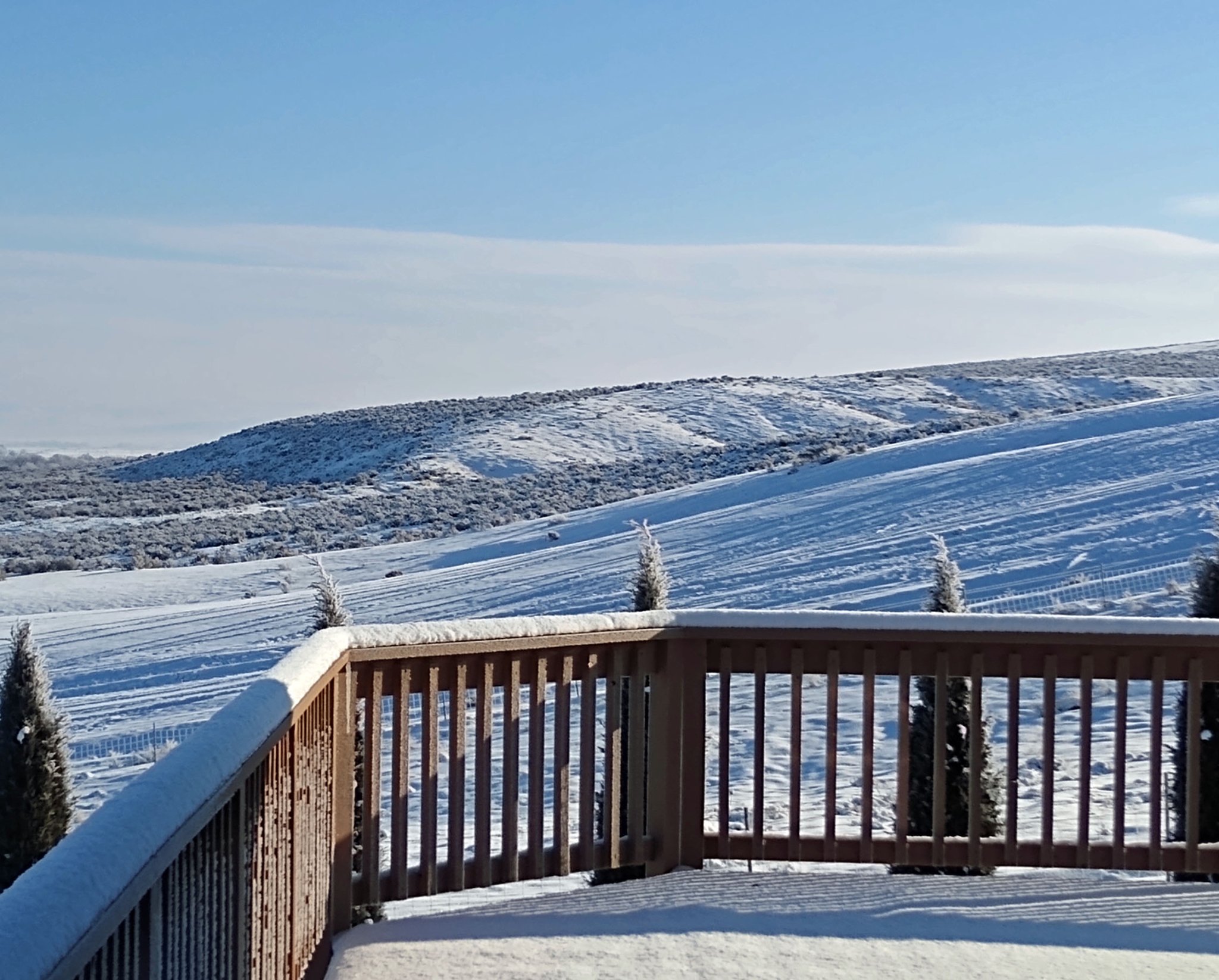

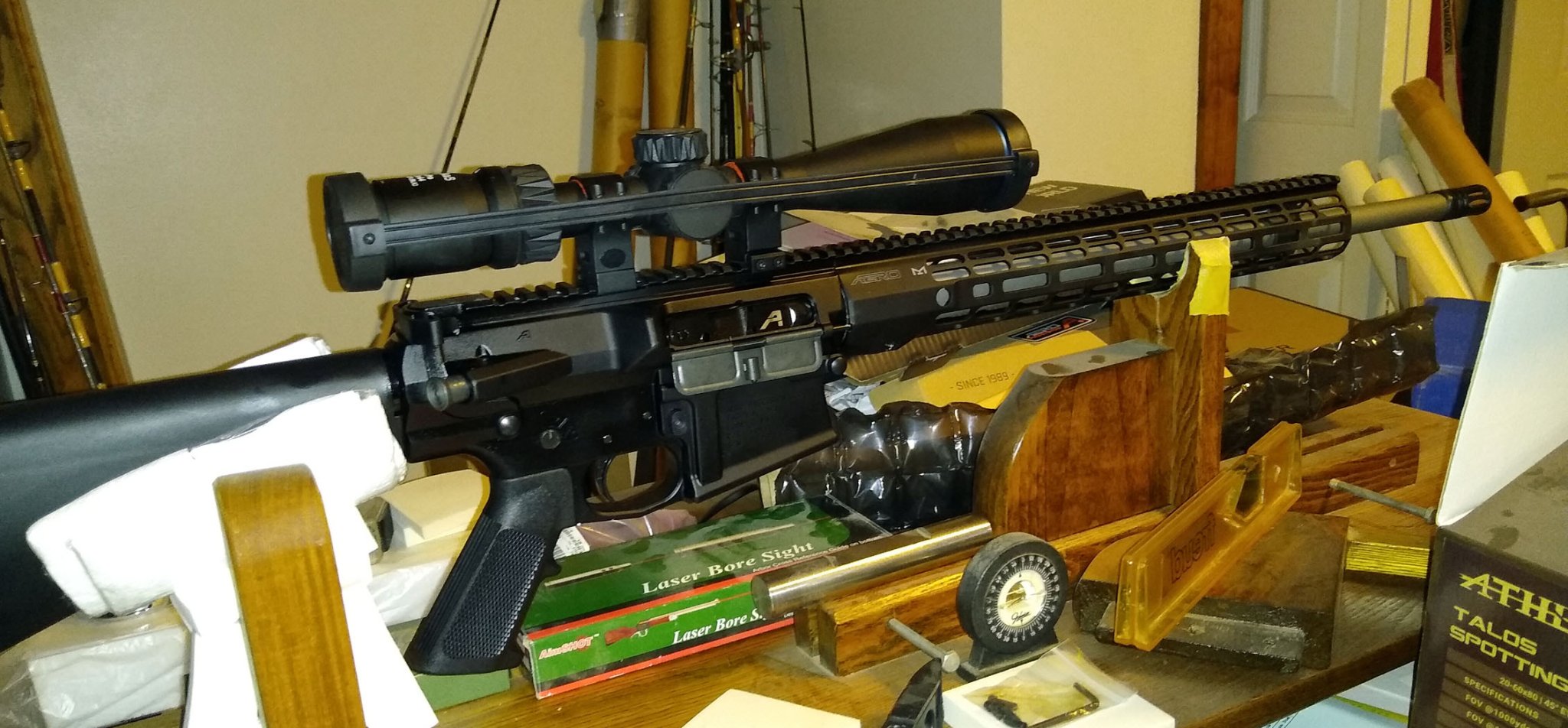

NO secrets , it's one of my assembled Aero Platform 6.5 CM. 22.5" barrel . A bad crown 24" was available and I had them re-cut it .
I built #4 target sheds like pictured ,because of terrain and snow you're unable to see them in the distance . 165 yd. closest ,278 yd. 340 yd. and 635 yd. Far hill is 1044- 1177 yd. with #6 #14" steel plates at various locations hung with SS aircraft cable between T posts .
I have a shooting bench with another 0-75 yd. pistol range and is pretty level ,rifle range is 90 degrees opposite direction .Otherwise I sometimes pop a sand bag on the handrail and shoot off the deck . Spring April 2022 is the Rifle which did those groups .
The New 6.5 CM fluted barrel has yet been sighted ,as I'm finishing another long overdue project first . ALL MY AR Rifles wear A2 KAK stocks ,as I've never liked hockey sticks or putters for furniture . Just ME ;)

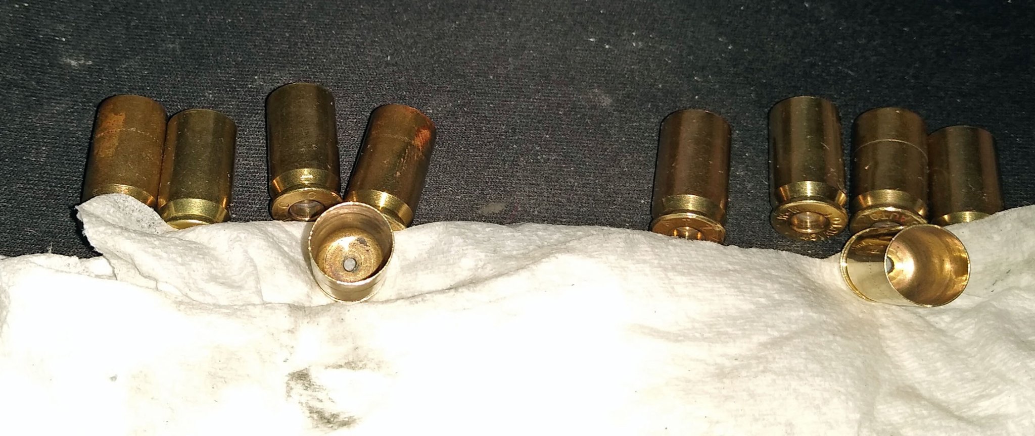

I don't always wet clean . Most of the time especially pistol cases ,9mm .45 even .44 Mag . I'll just de prime and toss em into the big Dillon vibratory ,with a mixture of walnut shells , plastic triangle , tethedrons with pieces of Polishing Compound .
Makes pretty sparkling cases . I also have SS pin and tumbler . Yet nothing I've ever come up with cleans more thoroughly inside and out faster or better than that 3 transducer commercial ultrasonic .
So when the gang has been real dirty ,into the ultrasonic ,then the dryer or if necessary partial annealing ) measure and trim ? . Then either Vibratory or Pin tumbler . Depending upon degree of shiny I choose .
I prep Large volumes of cases and often vacuum pack #250 - 500 packs as I do K's . Once or twice a year . Ultrasonic baths are mostly for gas guns as they definitively are dirtier in nature (y)

Can you recommend a ultra sonic cleaner? Also what you use for solution?
I've had excellent results with : https://www.ebay.com/itm/235537263060
You just need to determine the size which fits your needs .
As for solution well homemade ; Gallon solution : I prefer Tide 1 Tbsp. , Dawn Ultra , 2 Tbsp. , 3 Tbsp. Citranox ( or powdered citric acid ) White vinegar 5 ounces can also be substituted .
What I do is different from what others do : My ultrasonic is large enough to allow a Pyrex baking dish to set inside the tank . I place cases in it , then fill dish with cleaning solution ,surrounded by plain water. I also never run my ultrasonic longer than 3-4 minutes in that solution . I remove Pyrex dish strain and drain solution through a filter and it returns to the gallon jug . Baking soda water solution ,cases quick dunk ,remove and rinse in plain water . I then toss my cases into de-ionized water where they set for a spell . While I clean up and setup my drying station . I then place cases in a mesh bag shake em around and toss them into the drying tub .
It may sound like a lot of trouble but it's NOT ,it's like doing laundry yeah it's a pain but doing it twice a year isn't the end of the world .
I ONLY do really filthy cases and if doing normal fired rounds I'll dilute solution 50% . I've been using same solution for #4 years now .

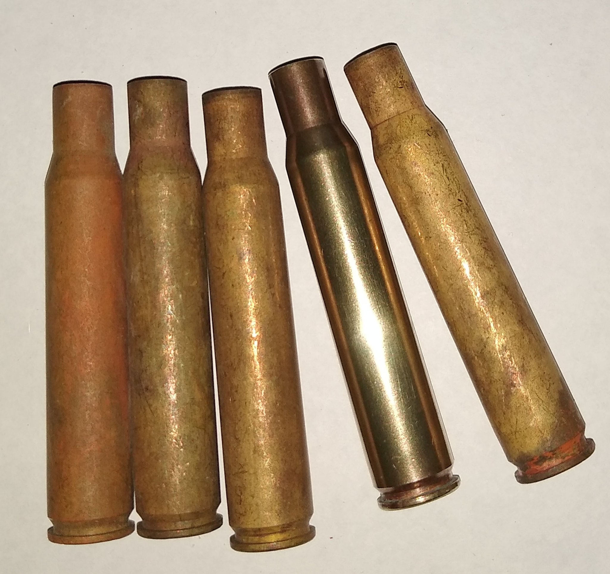

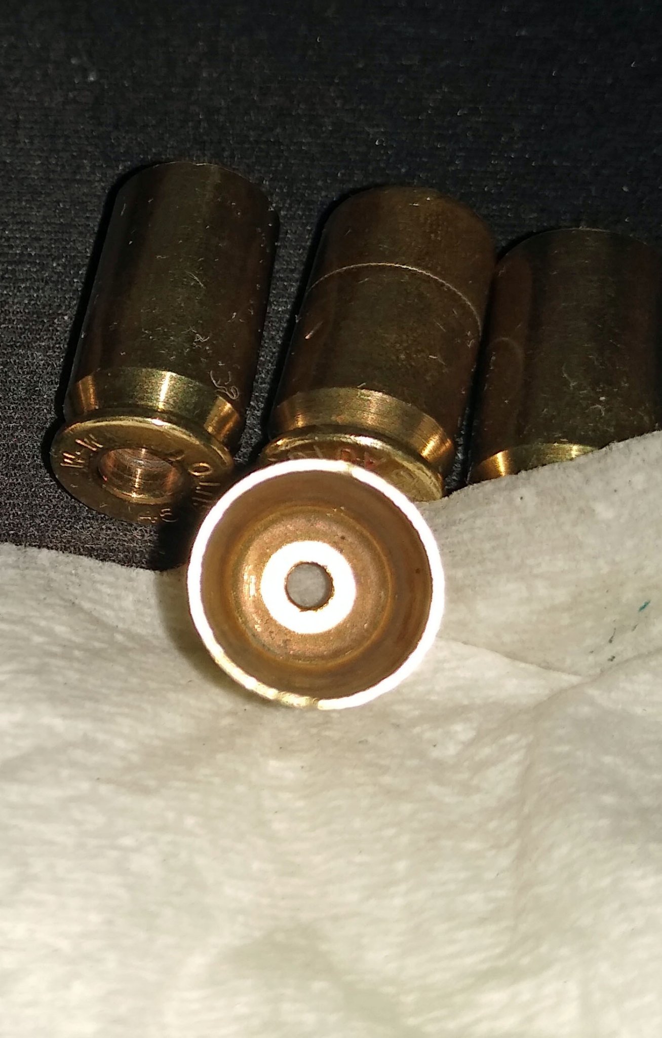

First photo original once fired cases 1942-43 M2 .30 Cal. and 1954-56 7.62X51mm . Both set to the weather 65 years before I obtained them . I've gotten #50 firings out of one of My Garands and didn't lose a single case . Partial annealed every 4 Th. firing .
Although low due to a stripped pinion ,all #8 are there out of a 1943 Springfield matching #'s Garand battle Rifle at 165 yd.
Learning to shoot Magnum Rifles most certainly didn't hurt MY aiming ability .
Pin tumble last photo on left group ,ultrasonic on right group .clean is clean . Polished jewelry is in vibratory or long time pin tumbling .
My chambers have NO eyes and could care less as long as ammo is Clean and they seem content :)

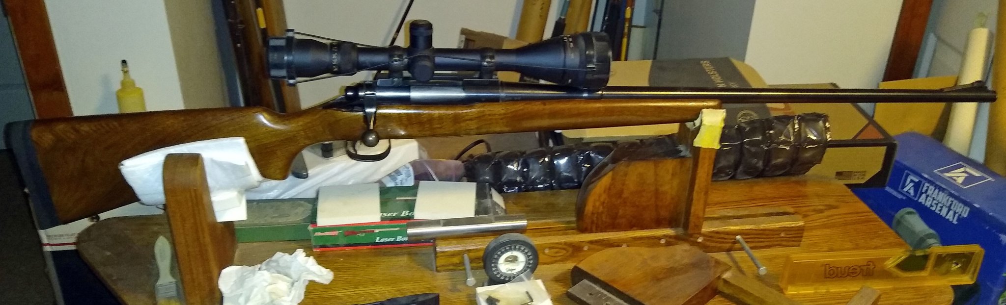

NO I was speaking of gas guns and generalized . I also own a fair # of Bolt Rifles ,but no longer own real BR Rifles .
A few of MY Bolts are accurate enough . Here's a dandy little 1955 Remington Model 722 . 222 aka Triple Deuce and it's a fine prairie dog shooter . Recoil actual and perceived can be negated to an extent depending upon butt stock and weight ,along with cushioning and or dampeners installed .
Point is not all is equal between Rifles but sure can be made to seem the same . San Diego County .

Again it depends upon the level of cleanliness one desires . I only clean really dirty brass one time chemically ,as 65 years of setting to the weather on a Military range dirt mud and God only knows what else got on them , made them undesirable . So when 10's of K's of WWll and Korean .30 Cal. cases came up for sale not many wanted them . Yet I knew they could be cleaned ,what I was unaware of was there durability in reloading .
I would have never bet on #50 reloads on 1942-43 SL & LC Military brass . Yet when I began testing them , I became a believer without a single torn rim or case separation . Good cases are difficult to come by reasonably for M1 Garands these days . Garands extractors are Not gentle nor are M14's .
Back in the day MCAS Camp Pendleton , I could work a deal and get Match ammo . Unfortunately when Clinton screwed up surplus sales ,that went bye bye . I nearly cried when I realized how many tons of M2 .30 Cal. Match 1962-1968 ,along with M118LR ,M852 were dumped into a 40 ft wide X 400 Yd X 20 ft. deep trench . There were scads of artillery shells powder bags ,as the magazines were being cleaned out and updated . So Ordnance was told and instructed to Burn it all . Served the bastards right ,caught the Base on fire !.
As I was a contractor for the Base and knew some of the Brass so to speak ,I was given a case of mixed 1962-68 173 gr. Match .30 Caliber . However unable to purchase any and that Gift was prior to the order of destruction .

Here's a group I shot back in early 90's at a LEO demonstration ,using Winchester white box crap and MY hand loads same POA .
One fouler fired intentionally low left quadrant . Using a bone stock Bushmaster 5.56X45mm 20" CR lined no less XM-15 E2 other than Nikon Monarch scope . Off the dirt without mat or support ,just sling choke and every shot dirt flew believe Me .
You can clearly see 200 Yd. with bulk 55 gr. Winchester bullets 25.5 gr. BlC-2 ,I ran #3 groups of #5 shots which a dime covered ,after firing that laughable string wonder of white box Winchester crap . Purpose of demonstration was to show how hand loading was a huge advantage in accuracy .
The Sheriff's Dept. made Me an Honorary Swat member and boy did I make a lot of ammo for a number of years .

I’m not talking about all that. I am speaking to normal brass being reloaded by shooters. Not 65 year old range brass.
Understood ,that's why I clarified I only do real dirty brass that way . Regular reloaded or factory brass , I dump cases in wash water agitate 20-30 minutes then tumble force dry . Time 2-2.5 hr. total . Works for ME . (y)

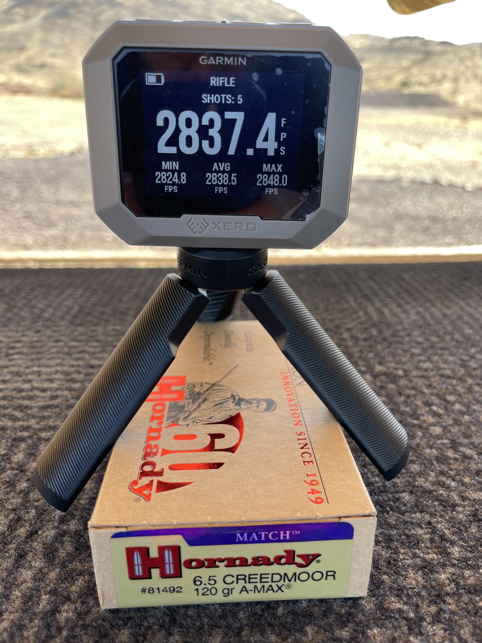

That is interesting, a buddy gave me a box of AMax 120gr and it called for 39.9gr of Varget.
As I said that’s the original loading from 2008 as you can see in the serial number. They used H4350 for a few years and then started changing the powder used. It’s been a few powders over the years including Varget as they slowed it down as the 120 turned into more of a mid range load.
That’s awesome that you recall that from 2008!

I was asking because that box of AMax was one ragged hole from my surgeon and I was hoping to replicate it.
Well it was new and I took a bunch of pics of the first lots sent out. Just kept them around for reference. Also if you look it references a 28” barrel which was also changed to 24” as that is what most factory rifles where coming out as at the time.

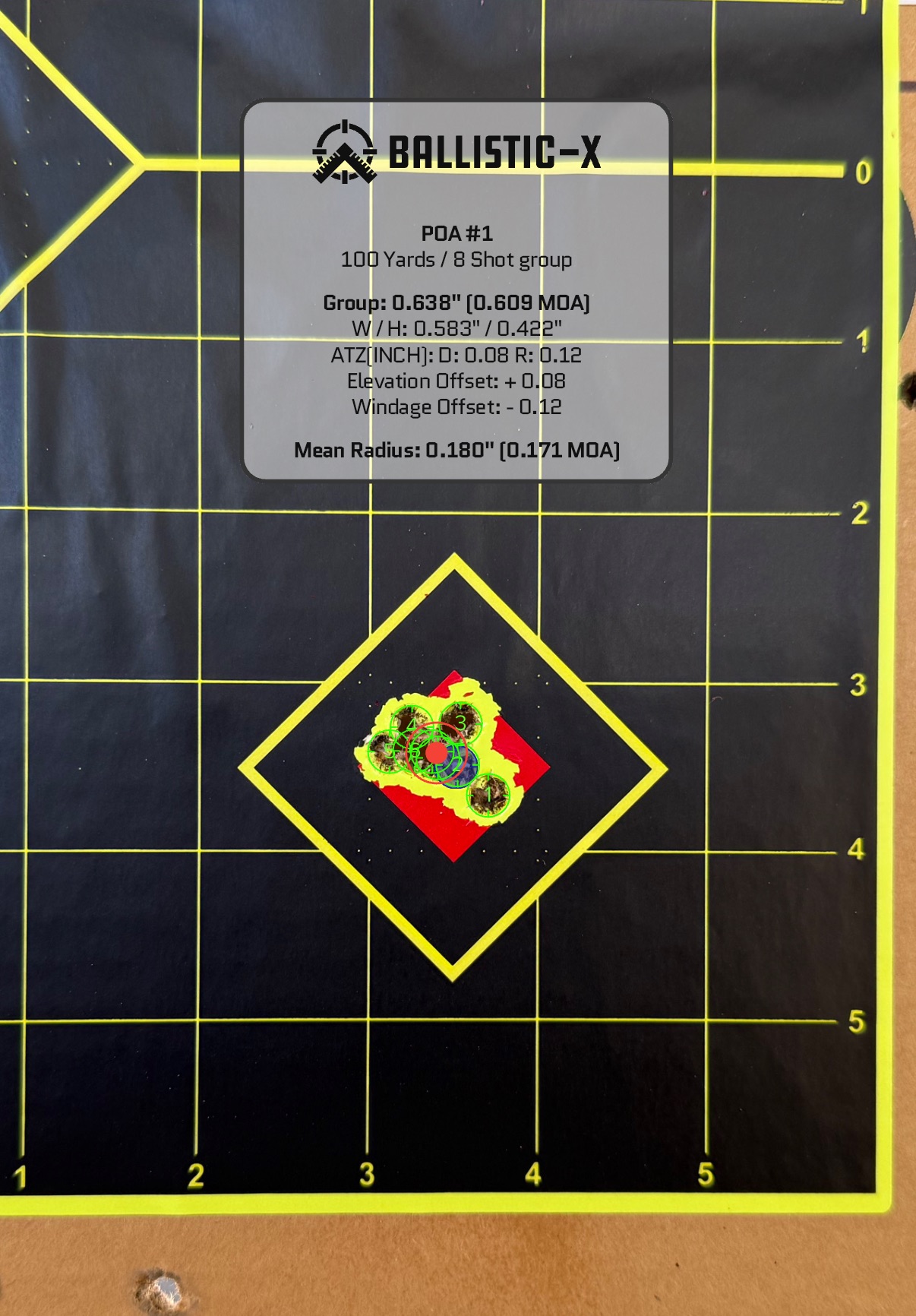

Over the last 6 or 8 months I switched from 147gr ELD-M to 140gr ELD-M in my 26" Savage.
I have settled on 42.4gr H4350 and I get, consistently, 2830 fps average and a .6 moa average over close to 500 rounds.
I will be taking this round to a long range precision rifle course this summer where we can shoot out to 1240 yds to see how it works.
