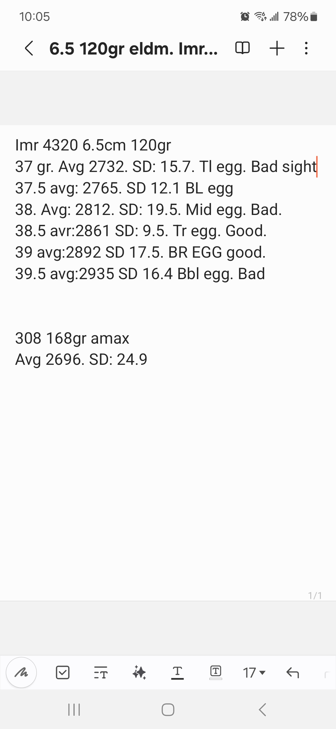

Yesterday I was able to shoot some loads of 120gr ELDM's with IMR-4320. Couldn't find any load data for it since it's been out of commission for a while but found that it's right in between varget and Win748. Both has almost identical load data for the 120s. Used Hornady brass, temp was about 76, and almost no wind all at 100 yards.
I started my load at 37gr and went to 39.5 in half grain increments, using 5 shots per load. the first string i wasn't hitting paper then realized that my dope was set from the last competition for 400 yard. but the last two shots didn't show any promise anyways.
Some were absolutely horrible while others showed some promise. i have an issue with my eyes getting blurry the more i shoot and also didn't have the luxury of time on my hands to really let the barrel cool as much as i wanted. Speeds were good and didn't get any signs of over pressure.

What's your process to control neck tension? Also are you getting consistent CBTO measurements during seating?
I would also double check the diopter if things go blurry on you. Unless you have other eye issues, that is your eye getting tired from being behind the scope for long periods.
My controll process is simple, size it through my hornady dies and that's it. They are all trimmed to length, and ran through the sizing die, then SS cleaned again. Seating is all done on my hornday die and once it's set to the proper COAL, that's all I check. I know I can get more into the weeds on it but I don't.
As for the eye things, it's just fatigue. Doesn't matter which scope I use, it's all the same after a while.

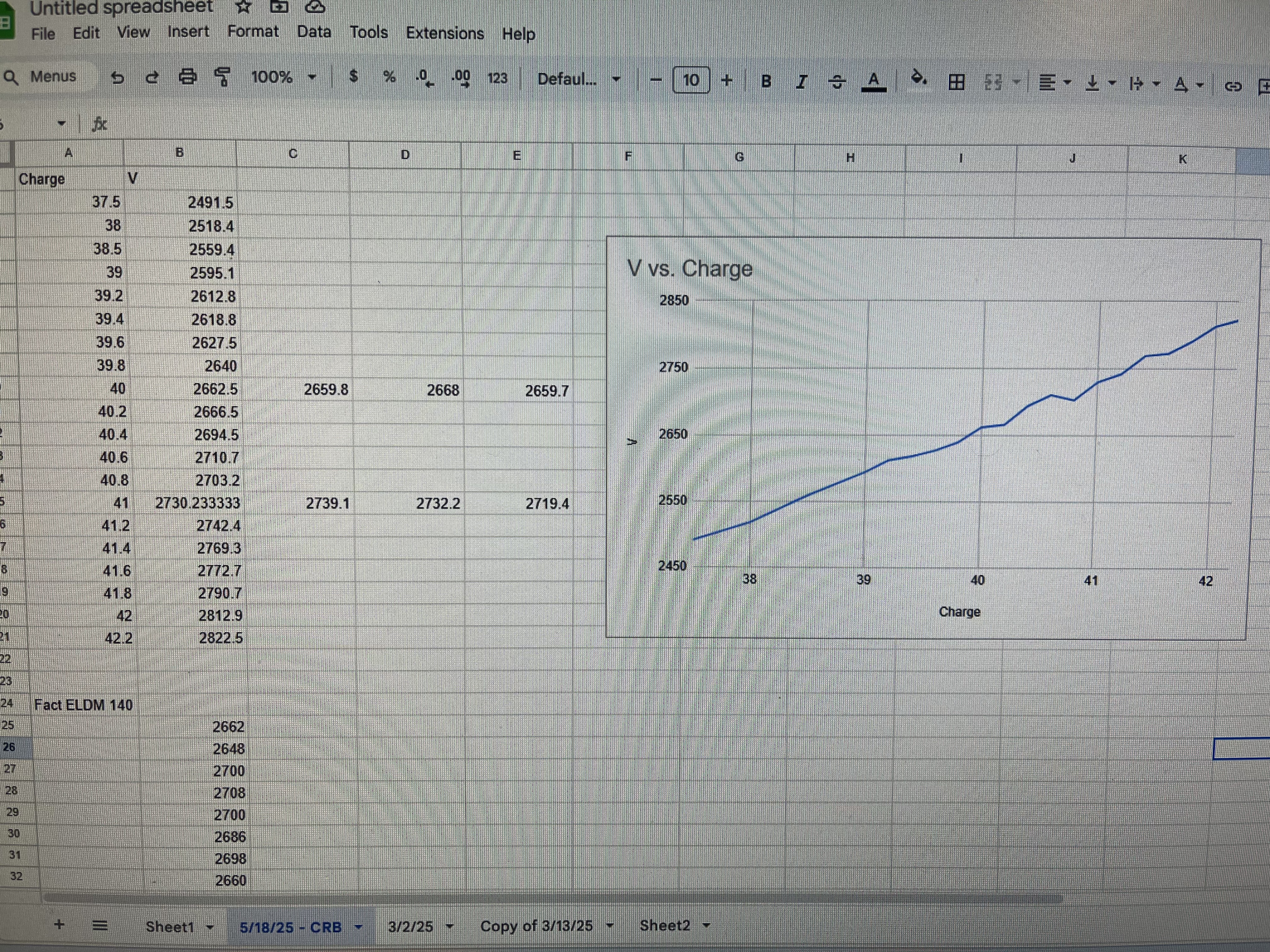

I tested the new barreled action out today.
26” CRB Comp 8tw on a Impact 737R
Lapua SRP
CCI 450
140 ELD-M seated to 2.800” COAL
Started out at 37.5 and went up to 42.2gr. Bolt lift seemed to get just a hair heavier at 42.0 and 42.2 and really trying to inspect I see what may be the ever so slightest ejector mark on those two, no primer cratering. Anyway, 41.6 gets me to the max velocity I wanted to be able to get up to so I’m set.
Barrel now has 42 rounds on it so I’m going to load up 40gr as the group seems promising for what I have now and +\- .2gr would have been in the same hole and send it for a local one day match or two and see how it does to get it broken in and start developing the load seriously.
