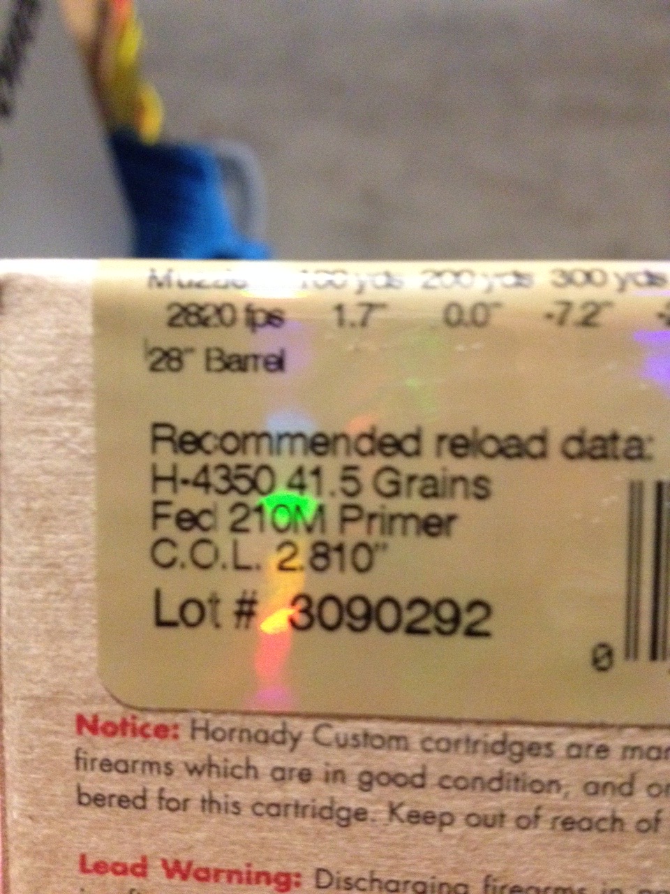

H4350 works well with 153s also. I use 40.6 grns and get 2680fps with the 153 ATips. Also works with the 147 ELDs.
I tried the 144s with h4350 not too long ago and got up to 2800 without having any pressure signs so it works there too. But I probably won't be running them that fast. I'll back down to 2760ish or 2780ish to preserve brass life.

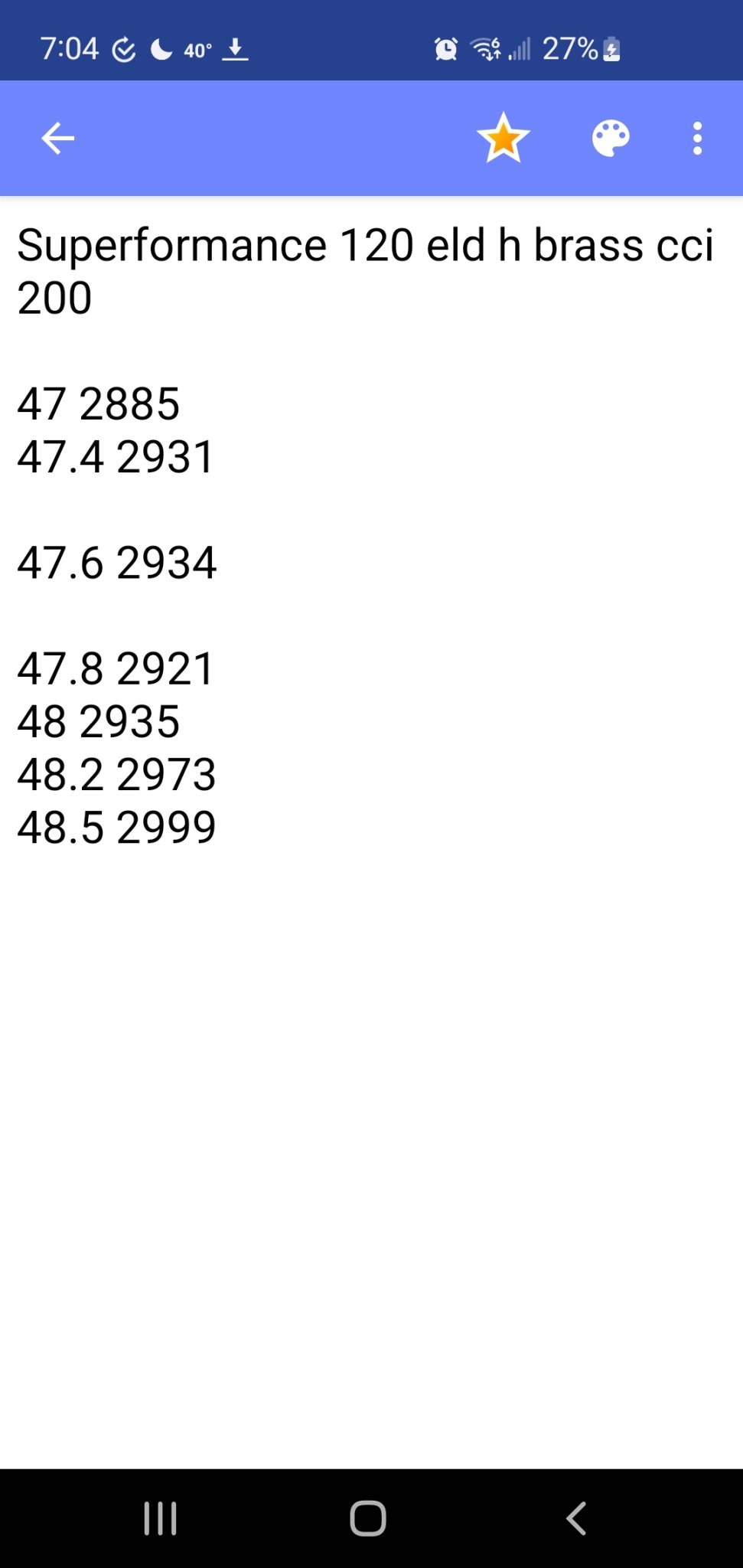

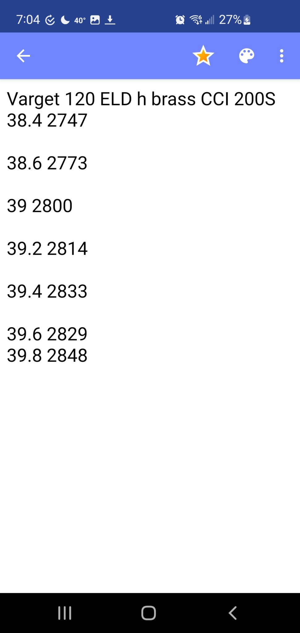

Here are my results with Varget and Superformance, Hornady brass, CCI 200s, 24" factory tikka. 5,000ft, 50f.

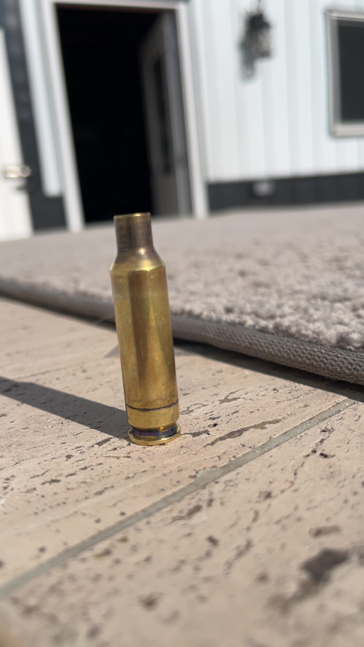

Had my first head separation over the weekend, goes about 300 degrees around the brass and is above the sizing die mark. Looking for some input/advice to look out for.
2x fired hornady brass, this was the 3rd firing. Picked up 300 once-fired brass from gunwerks (not doing once fired anymore, I know) and 200 factory hornady brass from my gun that I am loading. Second loading on all brass was done with a lee full length sizer with ~.002” shoulder bump. Annealed after the 2nd firing and all sizing for the current (3rd firing) loads was done on a SAC die with bushing and mandrel for .002” bump and neck tension. Not running a hot load, cci 200 with 42.5gr staball 6.5 with 140gr eld-m @2650 fps in a 24” bergara HMR.
Is it possible I just got one piece of bad brass? I shot ~80 rounds and this is the only one I saw this on. I visually checked all the brass before loading and looked fine though (I am pretty conservative and turned any I had any hesitation on into dummy rounds that were probably still fine) did not do the paperclip test though as it was only the 3rd time it would be fired. I checked half of the ones fired the same day and some of the ones I have not loaded yet with the paperclip test (dental curved pick) and none seem to have any groove forming inside. I have reloaded a lot of hunting ammo but only up to 3x so far, but with starting PRS shooting, is there anything I am missing that I should be doing besides running the paper clip test? This one scared me a little.

It could be bad brass, but 90% of the time it is caused by excess head space, either in your rifle or the one your "once" fired brass came from.. If your loading for more than one 6.5 Creed your technique is great, since they have to fit multiple chambers. However, if your reloading for just one 6.5 Creedmoor, your bolt action Bergara, then the best case gauge is your rifle's own chamber.
To do that you must neck size only. Then test a dummy round to see if it fits. If it does, it does not need a shoulder bump yet. If it does not fit, then do a partial FL resize, in small increments, until that case just fits.
You may have a chamber that's on the large end of SAAMI tolerances and a resizing die that's on the small end of SAMMI tolerances. At least this is a easy and inexpensive way to check how your brass fits before you bump it back .002 or whatever. It's trouble shooting 101.

So, the second loading was actually .003” bump. I had been full length sizing with a .002 to make sure I have reliable feeding. I figured if It were still growing it would grow on the second firing more than half what it did after the initial firing. The fired brass will fit in the chamber and the bolt will close. After sizing, it does not fully fit in the lyman case gauge I have. Should I be looking to neck size only or setting no bump on the first loading?
I took these measurements on headspace:
Factory ammo new - 1.557-1.559
Factory ammo fired - 1.5635 (grew .0055)
Once fired sized - 1.5615
Once fired shot - 1.5645 (grew .003)
Twice fired sized - 1.5615
Twice fired shot - 1.5645 (grew .003)
Twice fired that separated 1.5660
To do that you must neck size only. Then test a dummy round to see if it fits. If it does, it does not need a should bump yet. If it does not fit, then do a partial FL resize, in small increments, until that case just fits.
And yes, I only have the one 6.5 creedmoor right now. All shooting I have done is with this gun, then whatever the “once fired” brass was from. I mixed the brass like an idiot so no way to tell if this was that or my original factory also the last time I’m messing with once fired.
I added a piece of scotch tape to the end of a piece of fired brass today which is .002” and tried to feed it, bolt was very snug. two pieces at .004 the bolt would not close. So this fired brass should be right at chamber size. I was shooting for .002” bump, I’m at more .002-.003” from that fired brass length headspace

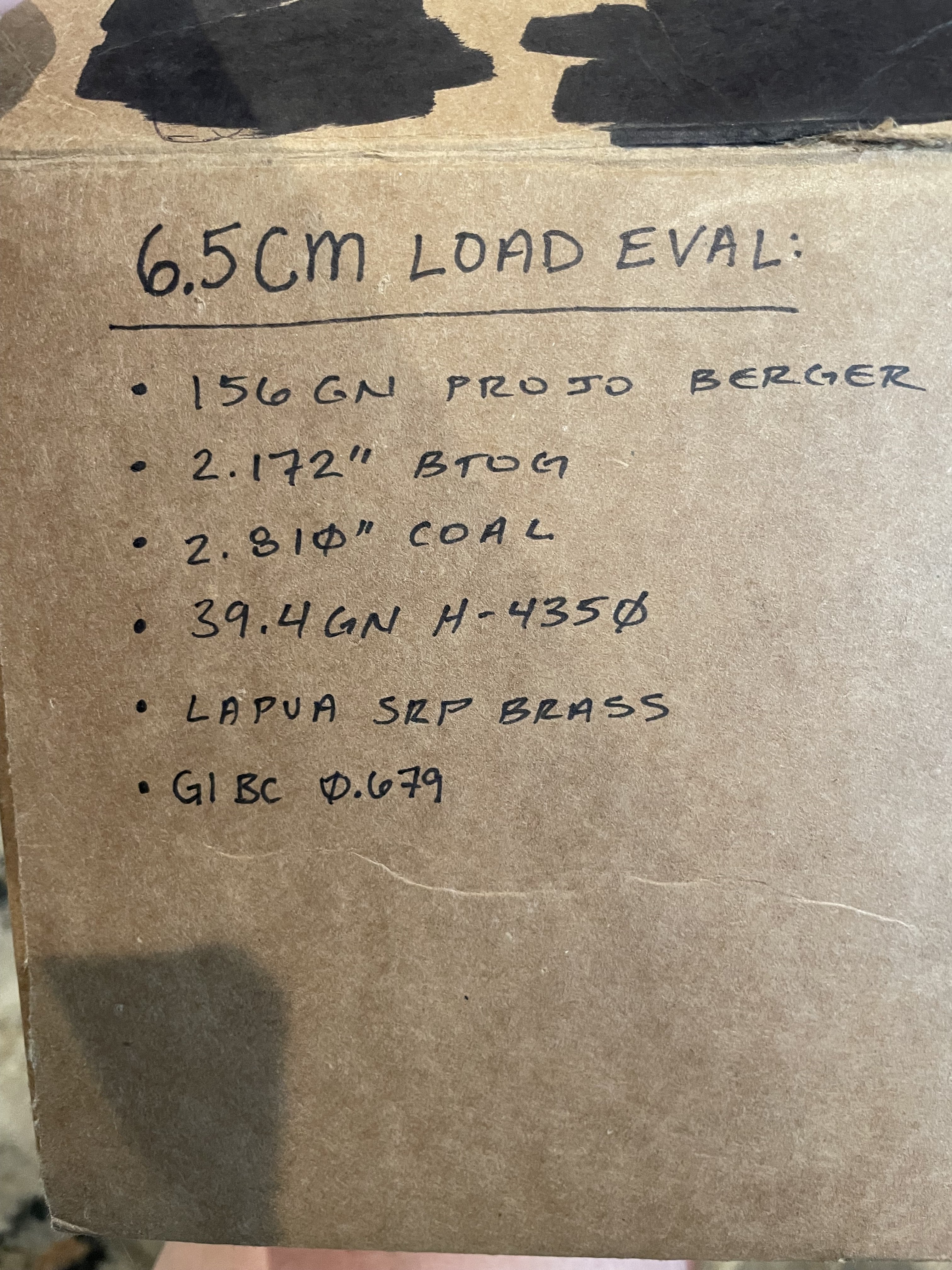

I havnt used it but it should be fine for 120s similar to varget and rl15. I used rl15 behind a 130 for a long time and it was a very accurate speedy load in 6.5 I would think you could start a low rl15 load and then work your way up from there. Maybe others will chime in.

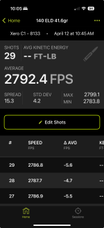

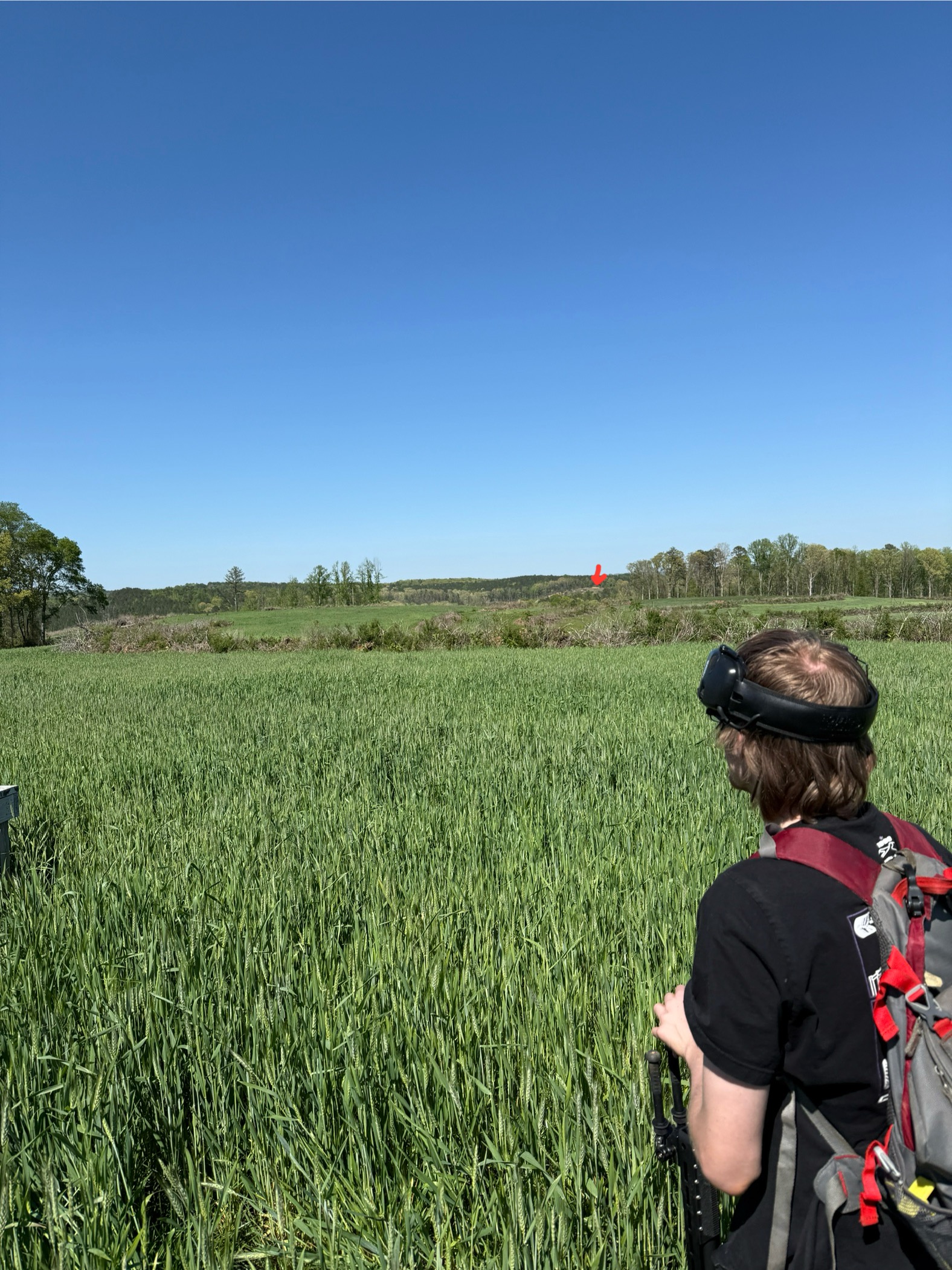

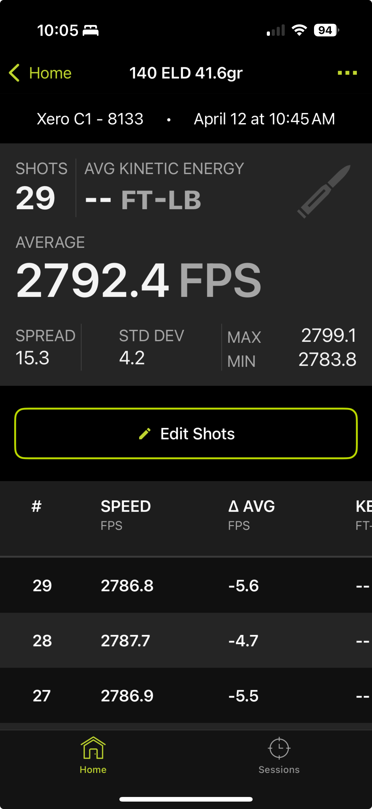

Made 2 impacts in a row at 1807yd last Saturday at Rifle Ranch in AL. First 10 shots danced around the target as we were dealing with a nasty tail wind. Winds calmed down and took 5 more shots and impacted with the final 2. Forgot to mil the target but it was probably 18" wide and 36" tall.
Alpha brass, CCI 450s, 41.6gr H4350 and 140gr ELD-M. I forgot my loaded Berger 140gr HT ammo at the house, damn it!
Factory MPA PMR Pro 2 with the Curtis action.
so I looked at a diagram that shows the speeds of powder and like you mentioned, found that 4320 is right in between Win 748 and Varget. According to thee Hodgdon load website and found that Win 748 has a load range of 36 to 40.4 gr for the 120gr bullet. Varget shows the load range of 36 to 40gr for the same bullet. BLC-2 shows pretty much the same thing. makes me think that it would be safe to use that same range as the other three powder for 4320
