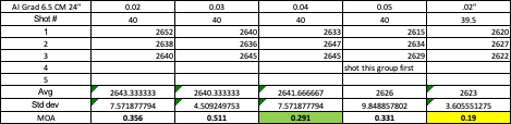

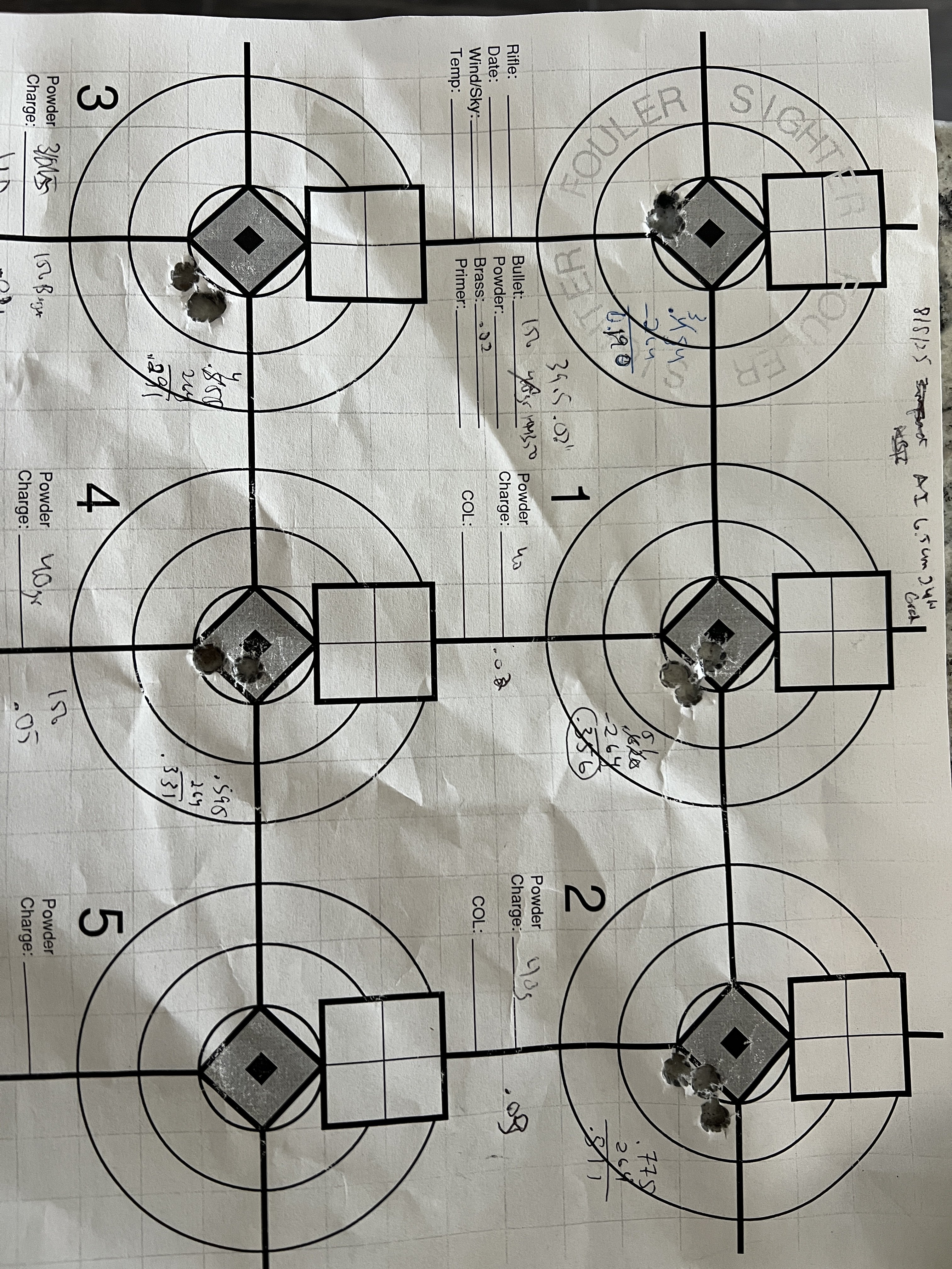

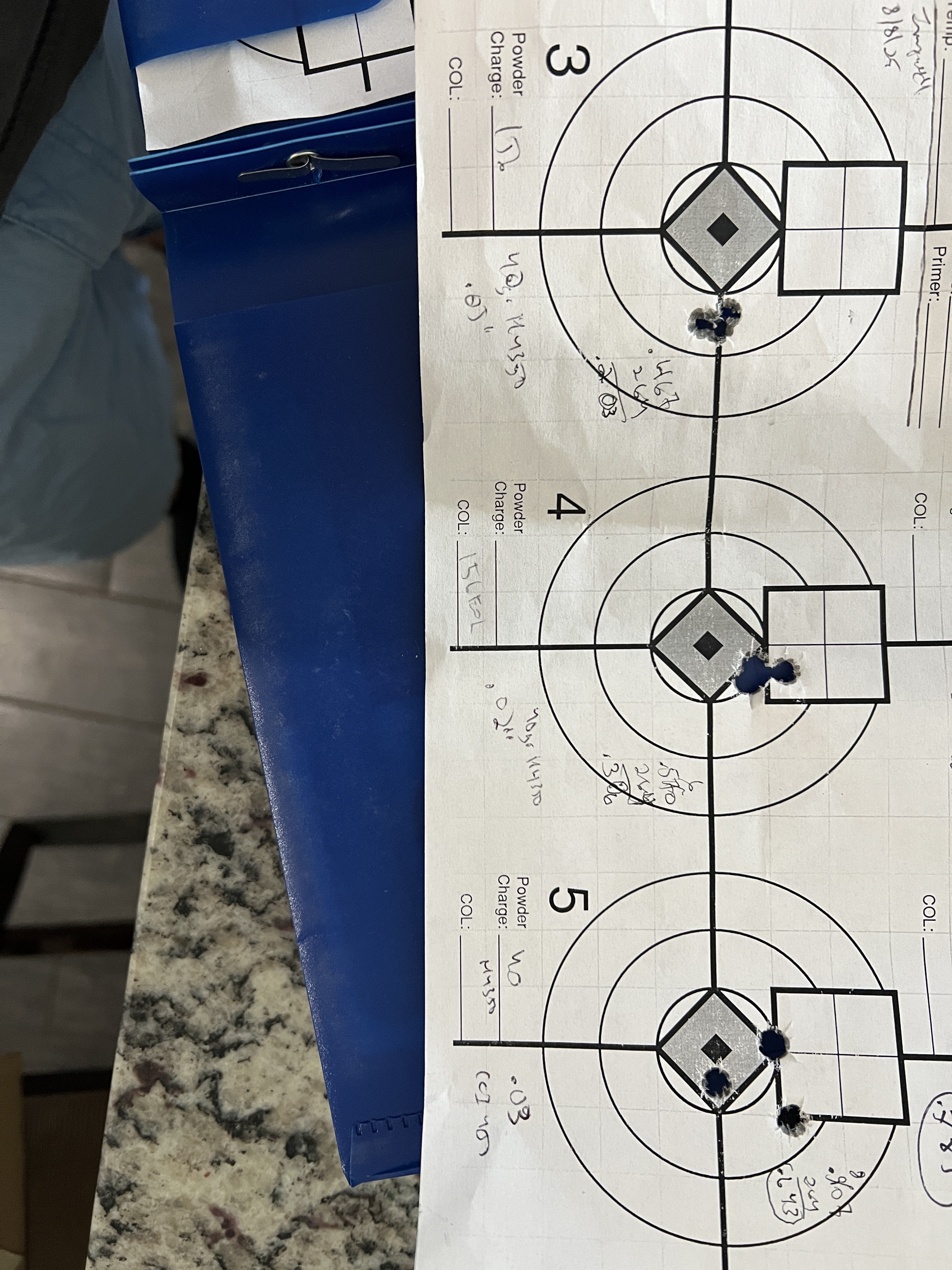

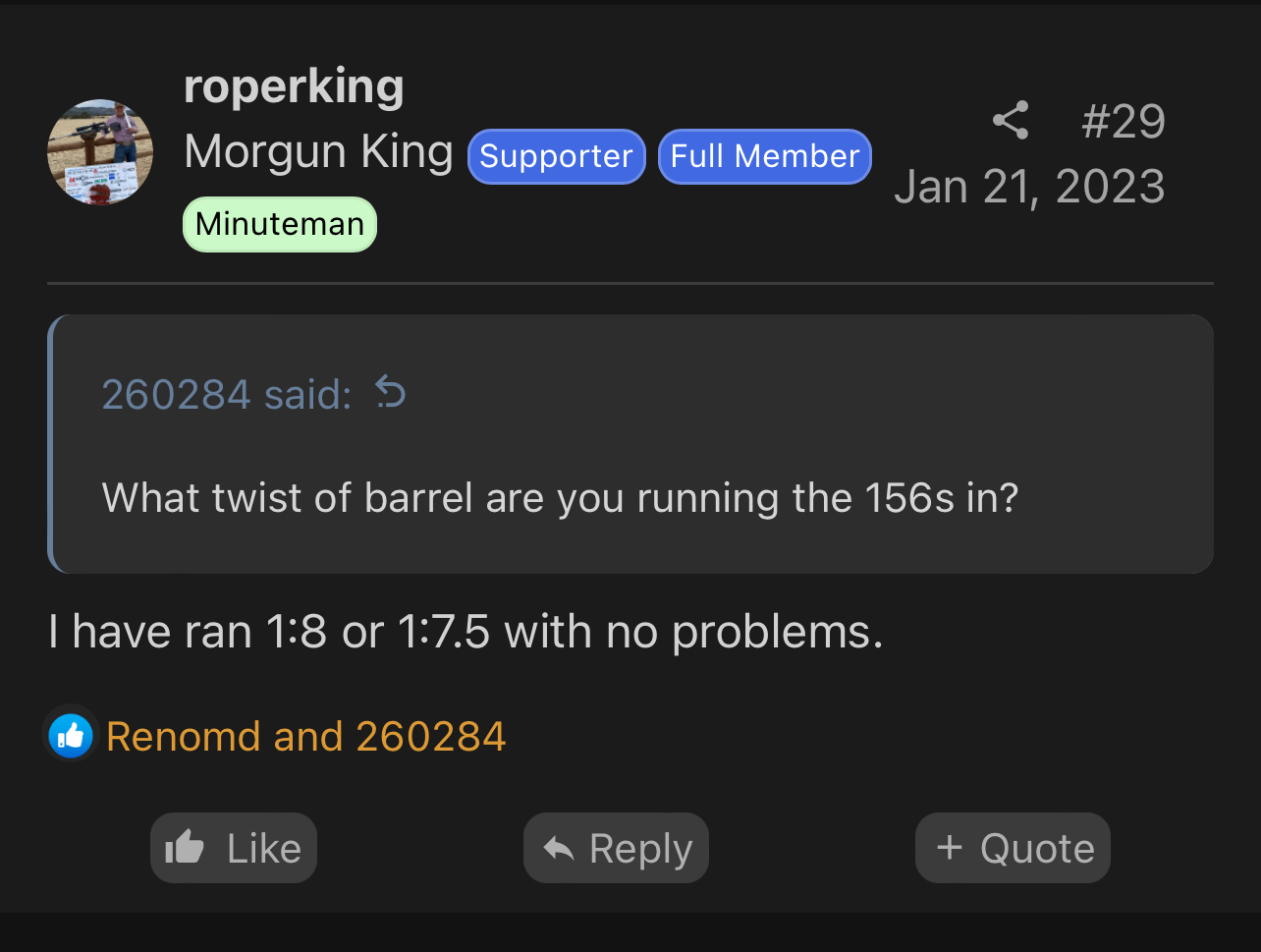

Hoping this helps someone for heavy bullets, there is some info out there but not a lot on the Berger 156 gr EOL in 6.5 creedmoor. Goal is to make power factor (which it does easily).
Powder: H4350
Brass: Lapua virgin SRP
Primer: CCI450
Platforms: 1) Accuracy international AX308 MC M27 Short action 24" Bartlein 8 twist by the one and only Robert Graduous 500 rounds on it prior to load workup SRS Ti Pro 4 muzzle brake 2) Impact NBK w/ a proof Lone Peak prefit carbon 24" 8 twist 1350 rounds on it before load development (headspace perfectly and fired dimensions are near identical to all of my other 6.5 CM barrels I've owned) MDT CRBN stock, TMB tuner brake 6.5mm.
Ladder, seated 0.02" jump on the AIAX, 0.045" on the proof Impact/LP (which is 2.945 COAL for both) b/c of throat erosion likely
What is crazy is the AIAX ladder shots were touching into the same hole but was .5" wide, I couldn't believe it given the velocity dispersion but demonstrates the accuracy of the AI platform, and how you can't rely just on group size at 100yd for long range consistency. I did not have any pressure signs on this test, 75 degrees at 4500 ft elevation.
AIAX: 41gr initially had the best group and SD/ES 2680 fps average, SD 5, ES 9, 3 shot group .211 MOA ; but, after going out for a seating depth test 41gr was much hotter and had heavy bolt lift at 2730 fps, so pulled the remainder of the rounds and backed it down to 40gr and one load at 39.5gr which all absolutely hammered! Bore scope did NOT reveal any carbon rings in neck of the chamber or in front of the lands. SD and ES on 40gr weren't the best however.... 39.5 though is great at 0.190 MOA seated .02" off the lands.
Impact NBK LP (lone peak) proof factory prefit carbon 24" 8 twist: Went w/ 40gr based on ladder satterlee test, w/ exception of 2 outliers the SD and ES's of this 40gr charge was great at 2603 fps average. Accuracy was pretty solid too seated at 0.045" 0.306 MOA, and .075" off lands at .203 MOA, using the TMB tuner brake at 0 setting. What worries me is the migrating 3 shot group could have been the nightforce NX8 4-32 but I had dialed out ALL of the parallax, hopefully its not the MDT CRBN stock which is not bedded but installed the impact correctly. I had a .03" seating depth off the lands that opened up to .643 MOA but I think this was me b/c I'm not used to shooting a fairy light gun.
As always workup slow and use this info at your risk. Everyone's powder lot is different and I'm shooting at 4500 ft elevation.

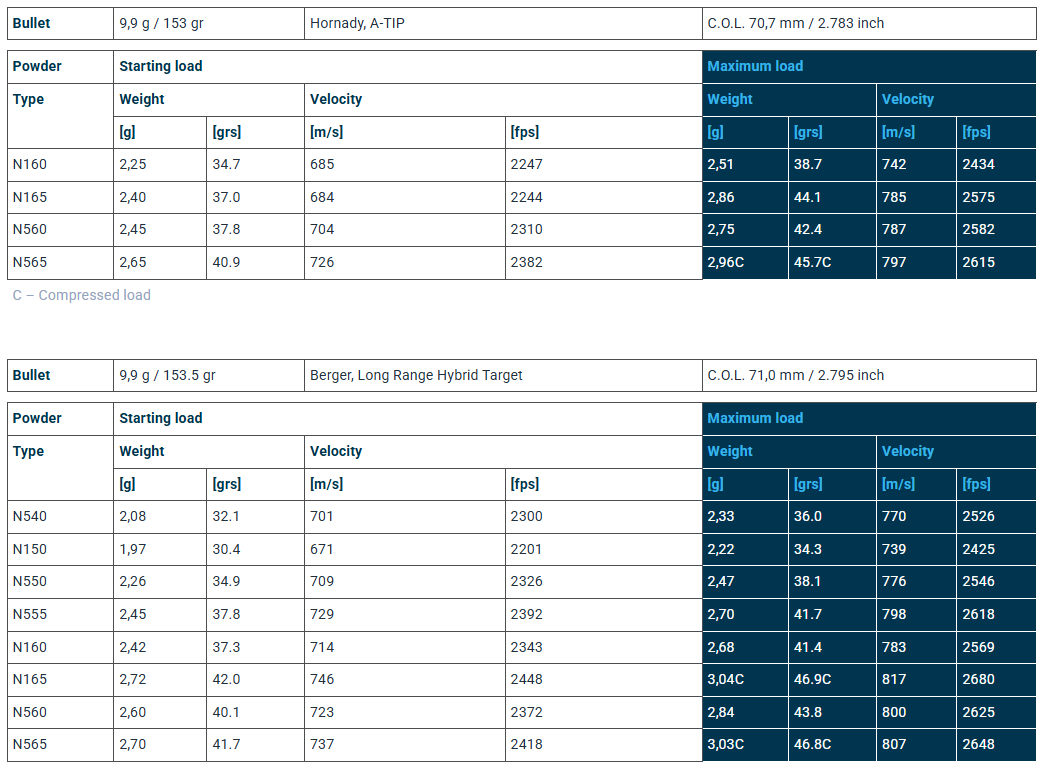

Was not getting stability factor I wanted with my 153 Atips in my 15in 1-in-8 twist barrel shooting 41Gr of H4350, ran out of powder trying to make things work.
ended up buying a KG of VV N555 and 200 of Lapua's new 144gr Maxrange bullets.
I will be using 4-time fired lapua SRP brass, CCI 450, N555, any pointers on nodes?
