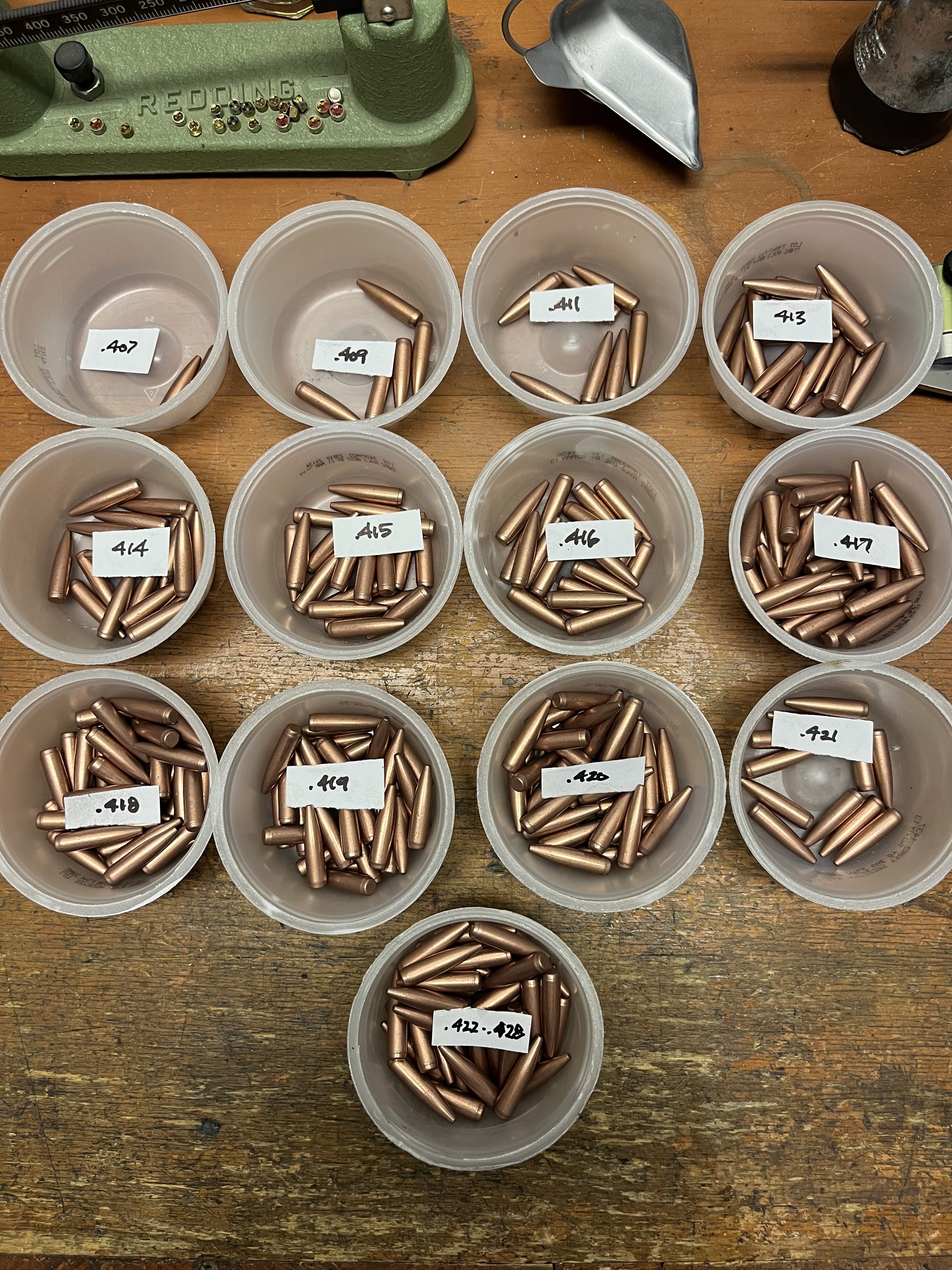

Just got a recent release of Speer 6.5mm 120gr Gold Dots to test and potentially load for a long TX deer season. Pretty respectable accuracy, a flyer or two, but SD’s running a bit higher than my usual 5-7’s for my 120 Scenar load.
Started seating over 27.3 AR Comp last night and decided to check BTO for the record and found .407 to .420 in last 15 rounds, which turned into yet another rabbit hole.
Ran through 315 rounds and got spread from .399 to .428, which may explain some of the SD variance being more than normal.
Where in the hell has QC gone at Speer-not a pinnacle of consistency on any day, but this is worse than buying Nosler seconds. Come on guys, you can certainly do better than shoving this into the market without any regard to expected tolerances.

Hadn’t had time to retest sorted vs unsorted, though would expect more consistency in group size, velocity and deviation after the sort process. Bullet has a good rep as a bonded hunting bullet-but won’t know for a couple of weeks or so. Just very disappointed with fact that there is so much variation in a single box, which leaves the one box reloader without option if they’re hunting consistency.
