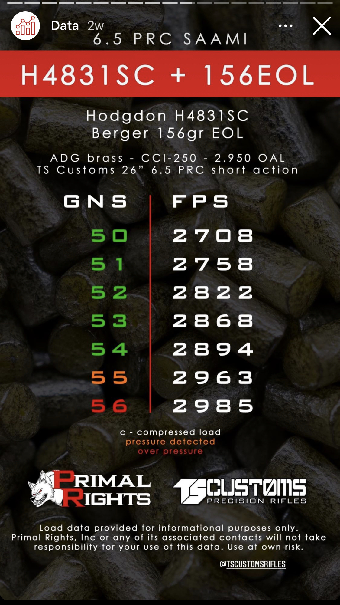

@orkan , I've been reading on a different forum where you've tested different bullet/powder combos in 6.5PRC. Did you ever test H4831SC and lighter bullets, and post results? If so, I'd love to have a look.

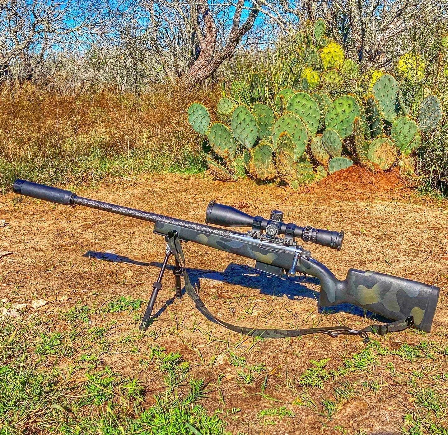

Settled on a Load...
18" Proof Sendero Lite with 7" TBAC Ultra 7
124 Grain Hammer Hunter
ADG Brass
57.2 Grain H4831sc
2.900 COAL
3030 fps
Had fairly benign wind conditions today, so was able to shoot longer ranges with good consistency. I got about 1/2 MOA accuracy at 100, but my groups tightened up to about 1/3 MOA at 400, 600, and 750. Pretty happy with this combo for my hunting setup, next up is some on game performance.

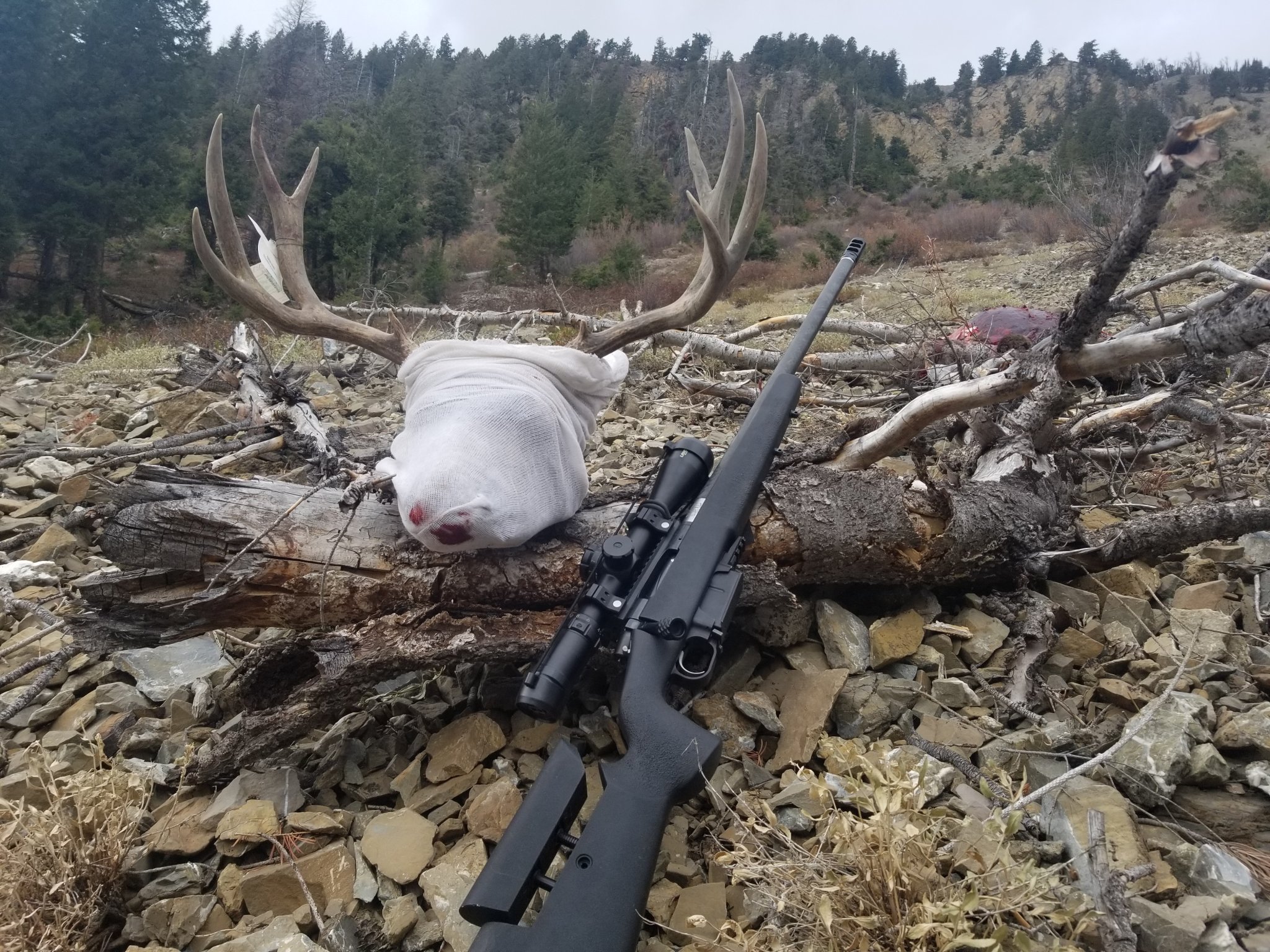

I used this combo this year on a mountain goat, and two elk. Worked well on all 3. Shot ranges were a couple in the low 400s, and the goat was further than that. All one shot kills, even though I shot my goat one more time just to make sure. Pretty good blood trails on all 3, which I am not used to. Great rifle and ammo combo to shoot, and just about perfect for 99% of the rifle hunting I do.
